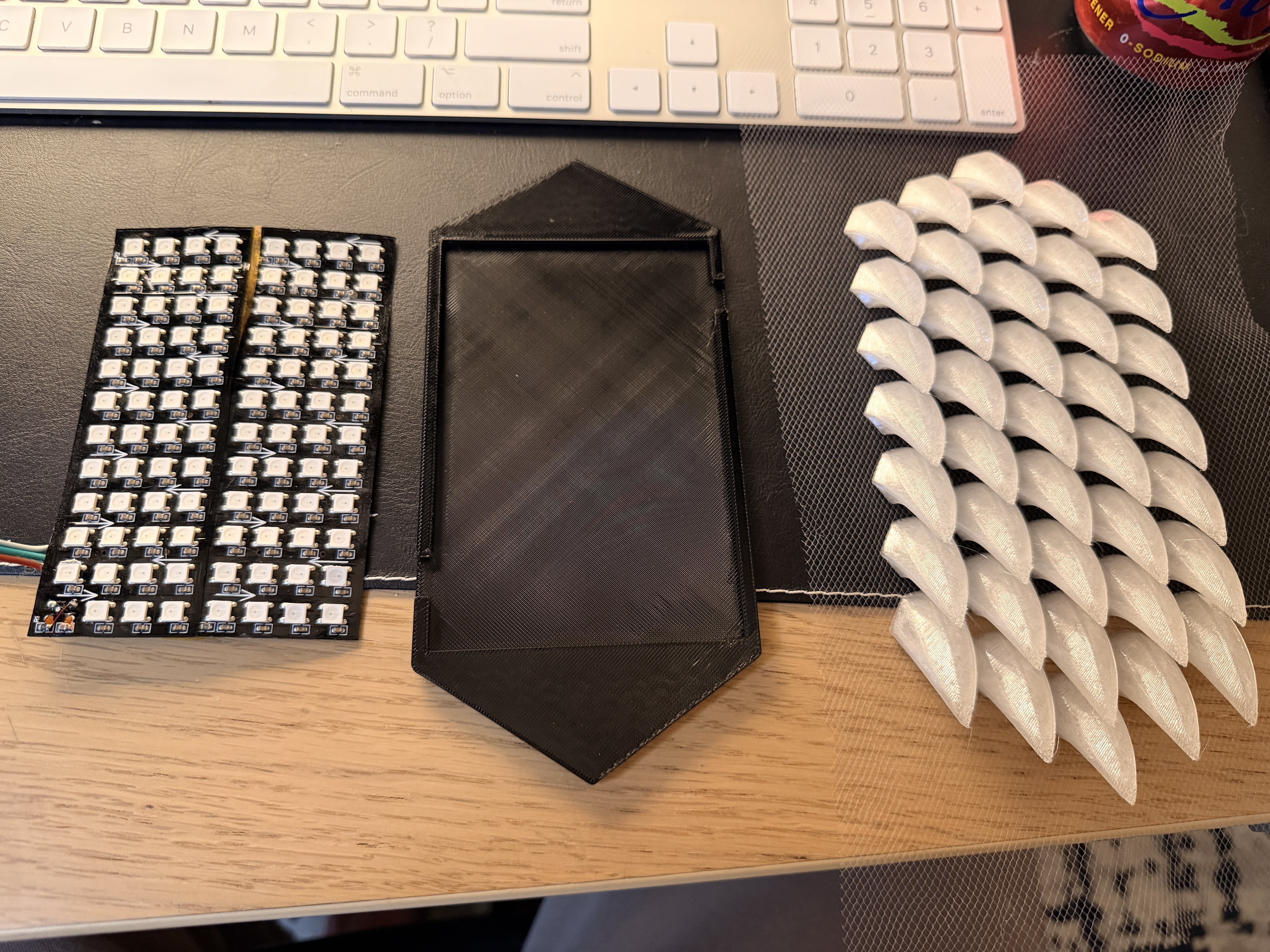

BOM:
- WS2812B Panel 4X12 48Pixels - QTY: 2 https://a.aliexpress.com/_mNoT8O7
- Black TPU 95A
- Clear PETG
- Tule Fabric
- B6000 Glue
- Velcrow stripts
- **`Dragon_Scales_Patch-Base.stl`** — a flat ~88 x 185 x 3mm tray with a
raised lip. Two small addressable-LED matrix boards sit inside it,
recessed enough that the scale sheet can lie flush on top.
- **`Dragon_Scales_Patch-Scales.stl`** — a ~94 x 203 x 20mm sheet of
overlapping scale shells. It is *not* glued on after printing — it's
printed straight onto a piece of mesh/tulle fabric using Shorey's
pause-and-embed technique (see below), so the whole scale sheet comes off
the printer as one flexible, fabric-backed piece.
- Light from the LED matrix underneath diffuses through the translucent
scales, and because the LEDs are individually addressable you get the
color-gradient/rainbow-chevron look shown above rather than a single flat glow.
