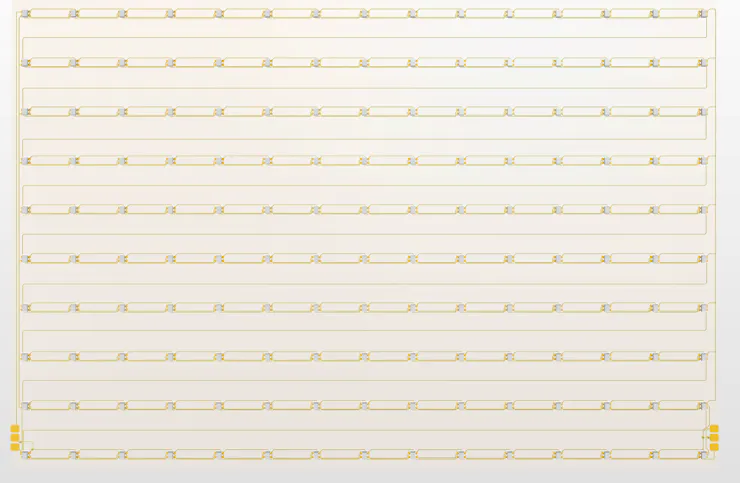

Design the Schematic & PCB
I started in Altium Designer by creating a straightforward schematic. The circuit consists of 150 WS2812B LEDs arranged in a 15x10 matrix. I connected the Data Output of one LED to the Data Input of the next, chaining them together, and tied all VCC pins together and all Ground pins together. I annotated the pixels from 1 to 150 to help with PCB layout.
For the PCB layout, I measured a 20cm x 13cm outline. I used Altium's PCB arrangement tools to distribute the pixels evenly across the board. I gave access to the first and last pixel's data pins, VCC, and GND so I could control and power the matrix.
Important: I did not use a ground plane to keep the circuit transparent.
You can access the Altium design files online here: Altium Project Link

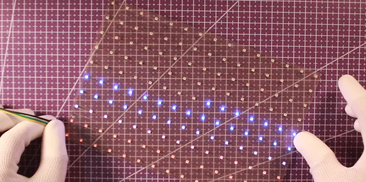

A few days later, I received the circuit very well produced and neatly assembled, with no residual assembly material. The PCB has a clean, transparent look—you can even see through to the copper traces.
Test the Matrix
Since I gave access to the first and last connected pixels, I could quickly test the matrix using my Arduino Uno board running a FastLED sketch. The LED matrix started displaying cool animations, and the pixels looked amazing in this transparent layout.

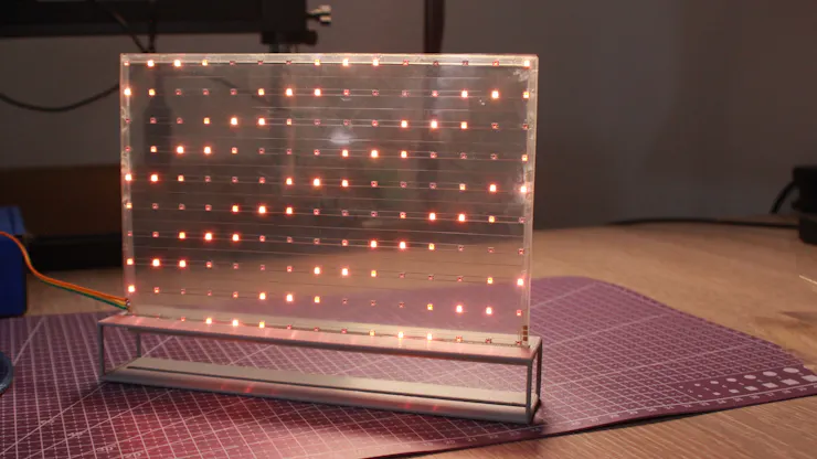

Mount the Matrix & Final Assembly

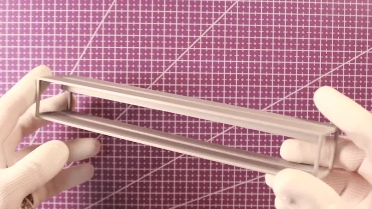

I designed a stand to stick the matrix to it and 3D printed it in PLA filament. Then I used a transparent flex frame to give the matrix more rigidity. I glued the frame to the matrix using super glue, and then glued the frame to the stand.
I can power the circuit and control it from the access port I designed. The matrix runs smoothly, and this design concept could lead to more ideas it could stick to surfaces thanks to the circuit's flexible material.
