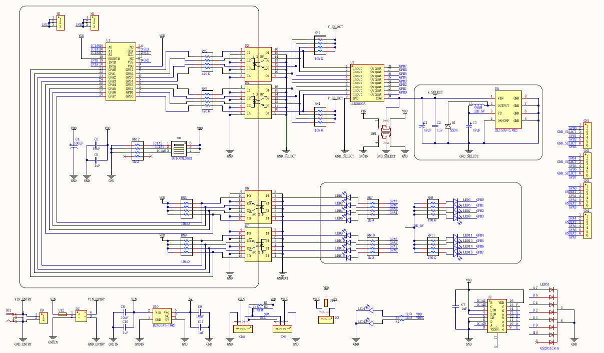

Schematic Design

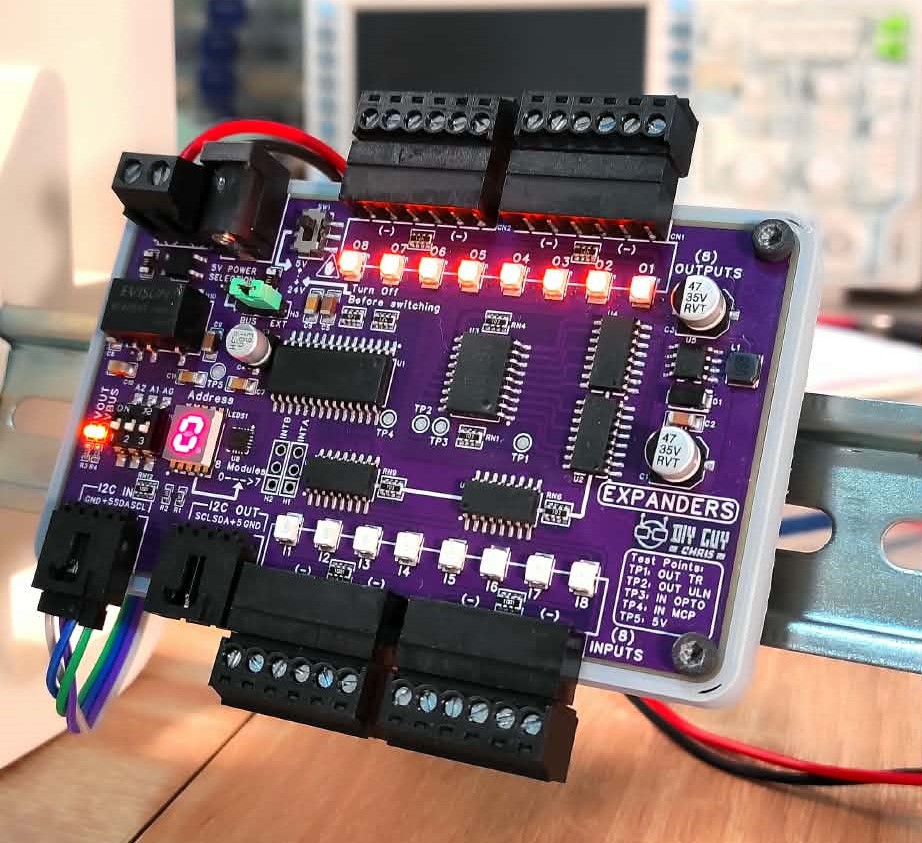

Design the circuit in Altium starting with the power entry: a bridge rectifier for reverse polarity protection, followed by a DC-DC converter to step down voltage to 5V. The MCP23017 connects to the I²C bus and drives 8 outputs through the ULN2803A.
For inputs, use TLP291-4 optocouplers to isolate the 8 input channels from external peripherals . Add a 3-position slide switch for hardware address selection (0-7) and a 7-segment display to show the address.

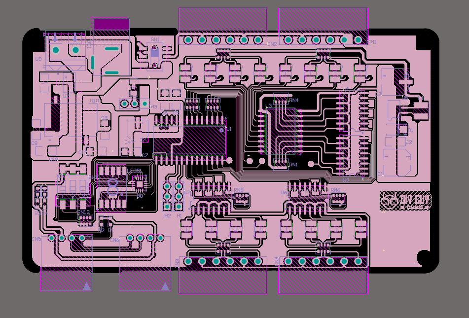

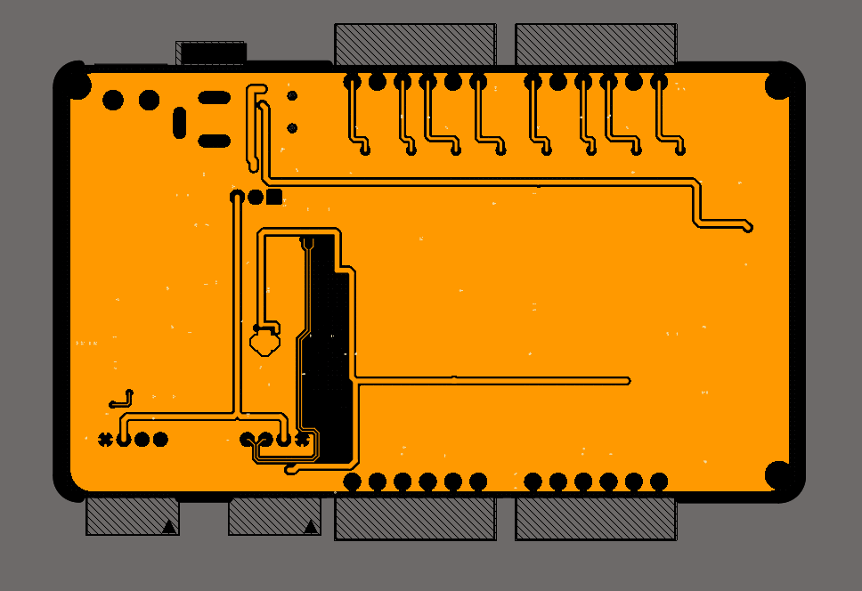

PCB Layout
Route a 2-layer PCB following industrial PLC standards: power entry at the top left, outputs along the top edge, inputs along the bottom edge, and I²C connectors at the bottom right .
The board measures 103×60mm and includes status LEDs for all 16 I/O channels. you can access the full project design files through my Altium Online Repository. For manufacturing, export Gerber files and upload them to JLCPCB.

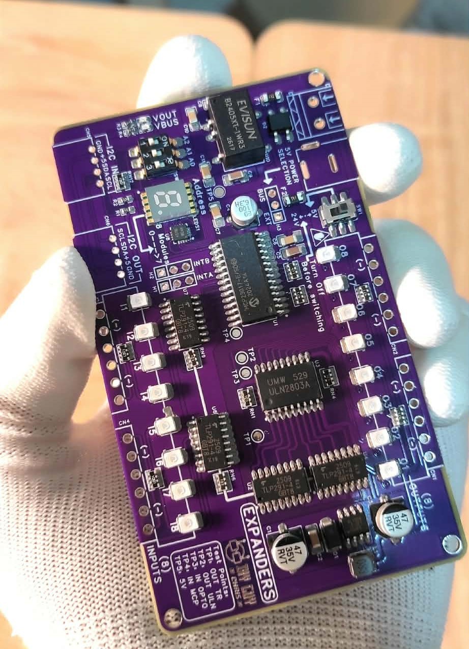

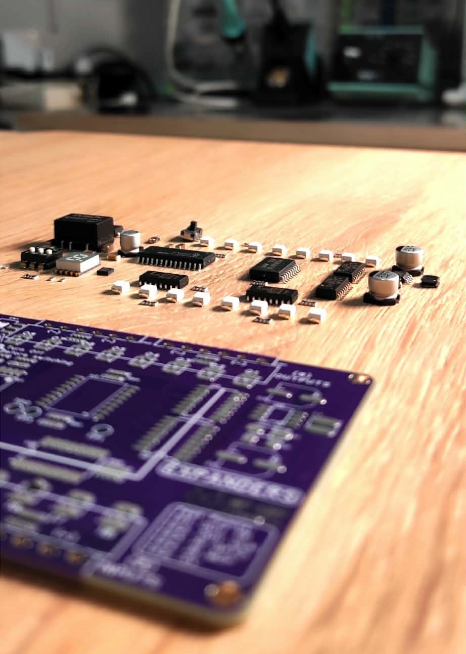

Assembly

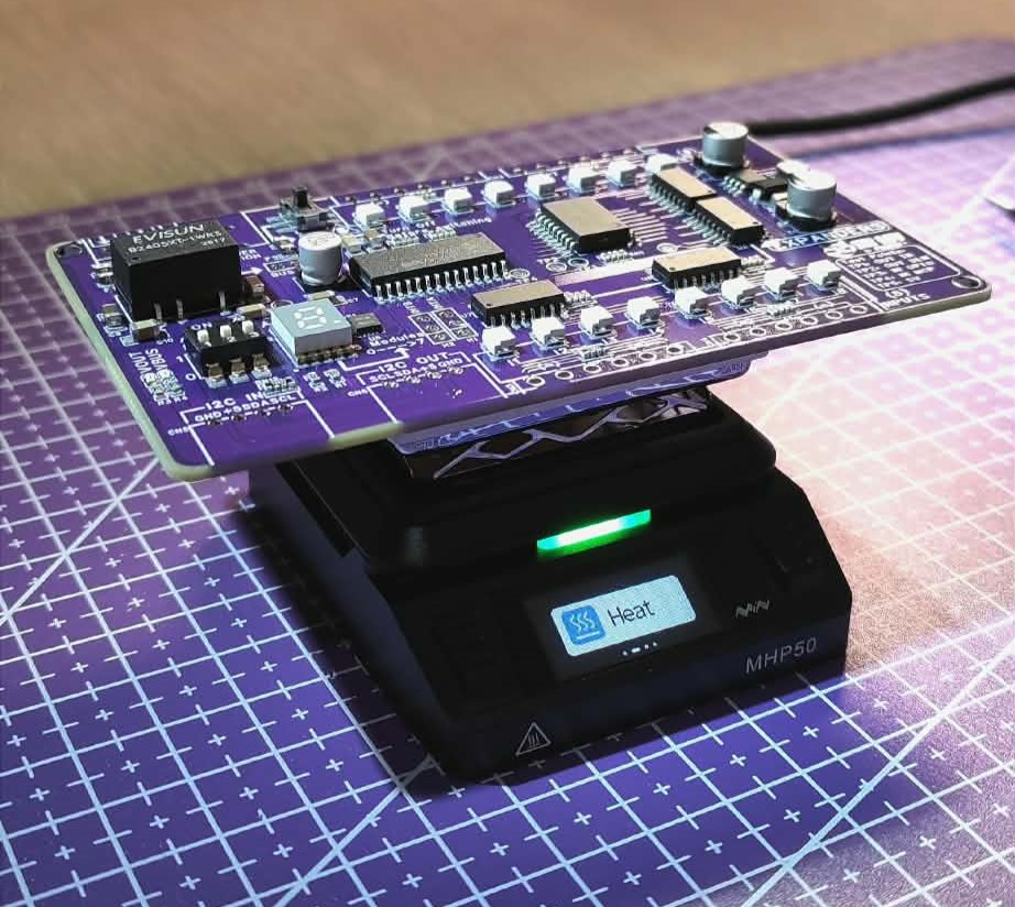

Apply solder paste through a stencil, then place SMD components (resistors, capacitors, ICs) using tweezers.
Reflow the board on a hot plate at 245°C peak temperature, then solder through-hole components (terminal blocks, connectors) with a soldering iron.

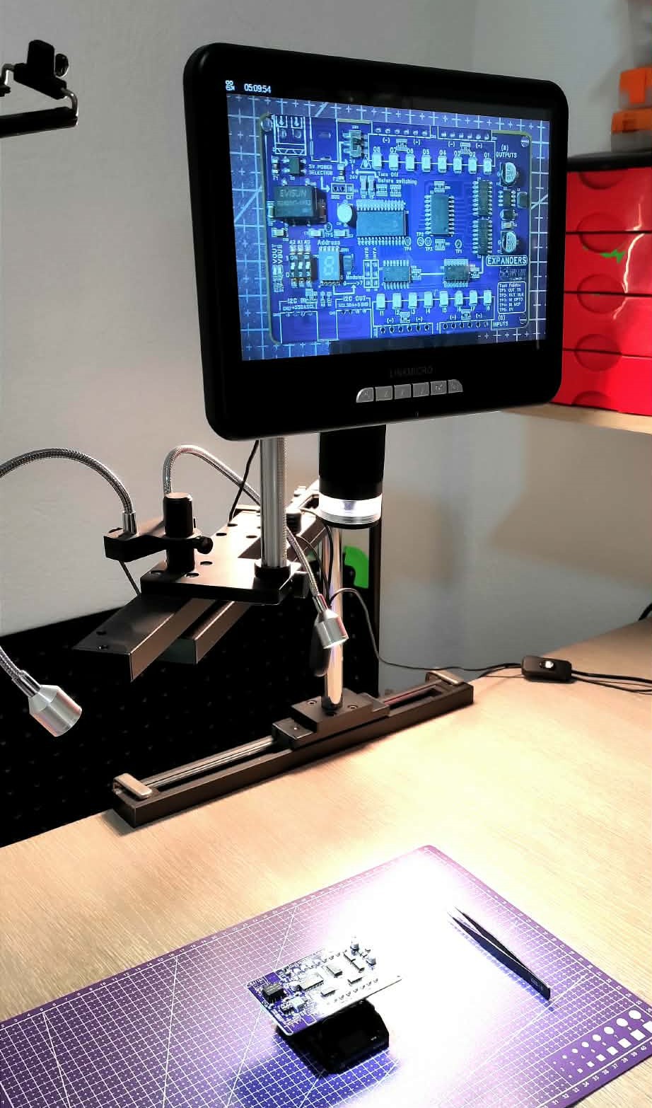

Clean the board with isopropyl alcohol and inspect for bridges under a microscope.

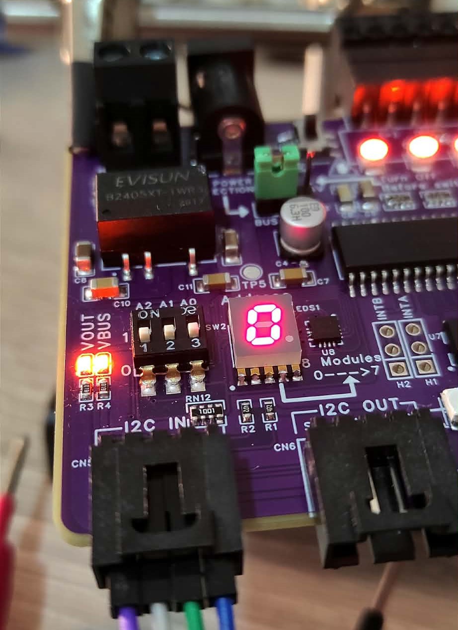

Testing & Enclosure
Connect the I²C port to an Arduino and upload a sketch to cycle through outputs. For inputs, mirror the input states to outputs to test all channels.
Set the I²C address using the slide switch and verify it on the 7-segment display. Finally, 3D-print the DIN-rail enclosure , secure the board with M3 threaded inserts, and attach a rail clip.
Mount the module on a DIN rail and verify all functions.
