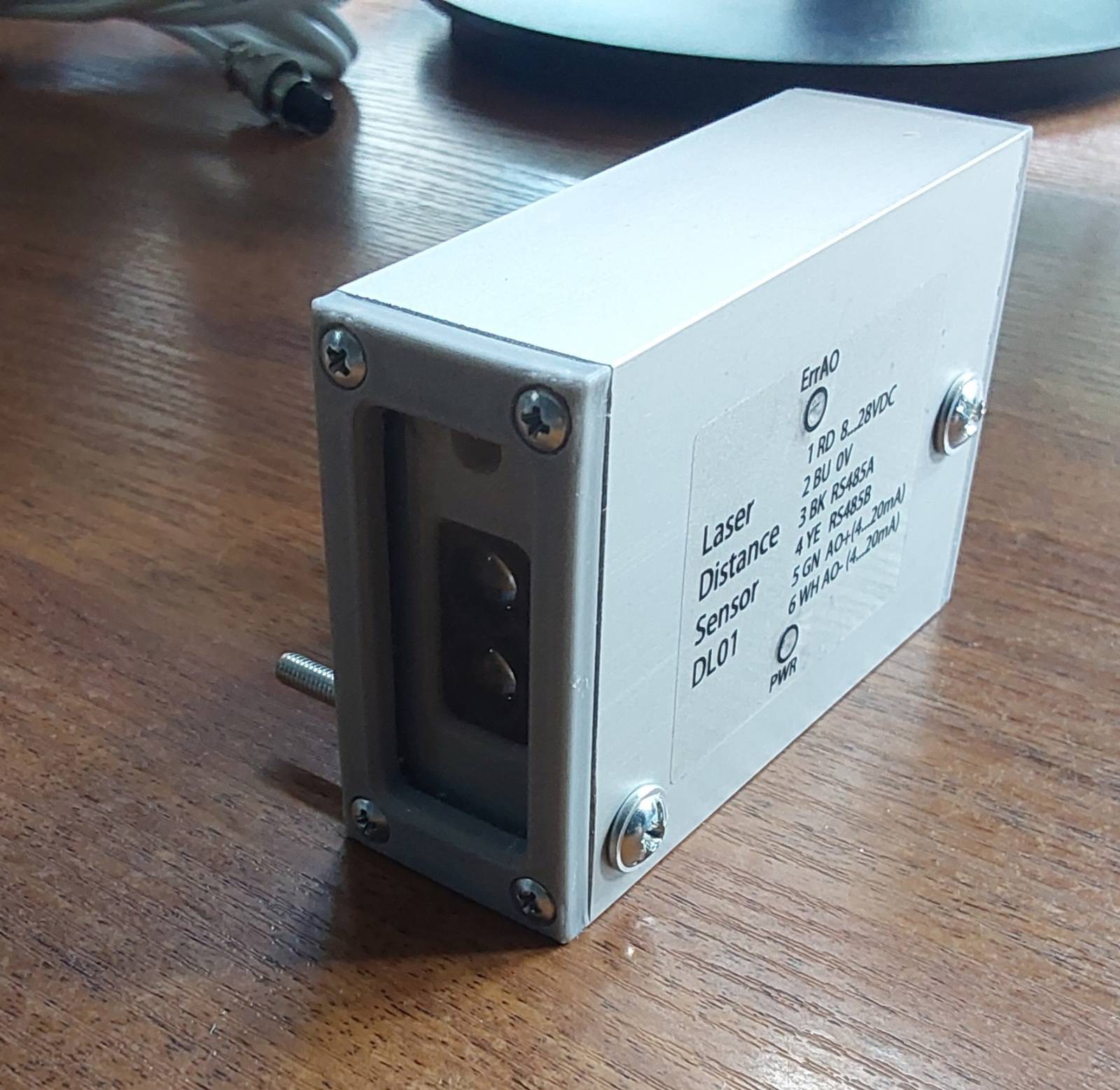

   However, the TF-Luna module itself is not designed for industrial use. Therefore, almost everything else had to be developed from scratch, including the controller electronics, firmware, RS-485 Modbus RTU interface, 4–20 mA analog output, digital filtering, calibration system, and enclosure.
   The goal was not simply to build a device around the TF-Luna module, but to create a complete industrial sensor that could be installed in an existing control system without requiring any changes to the machine control logic. The result is an industrial instrument designed for continuous operation in demanding production environments.

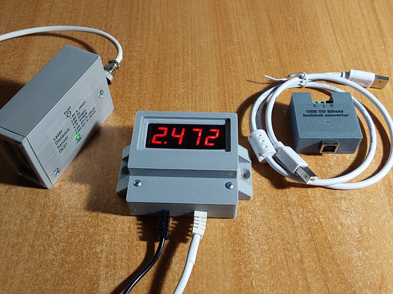

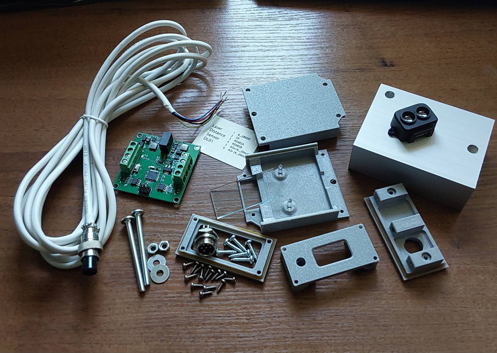

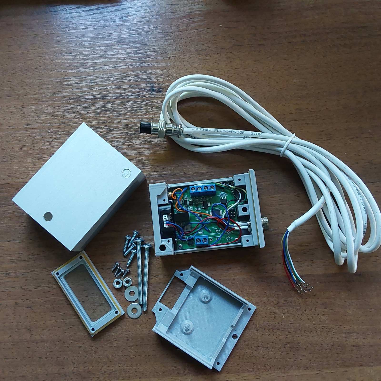

    To integrate the TF-Luna module into an industrial control system, a custom controller board was developed around the ATmega328PB microcontroller. It receives measurement data from the TF-Luna via the UART interface, performs digital filtering and calibration, and provides two industrial output interfaces: RS-485 (Modbus RTU) and a 4–20 mA current output. All calibration parameters and configuration settings are stored in the microcontroller's internal EEPROM.
   Mechanical Design

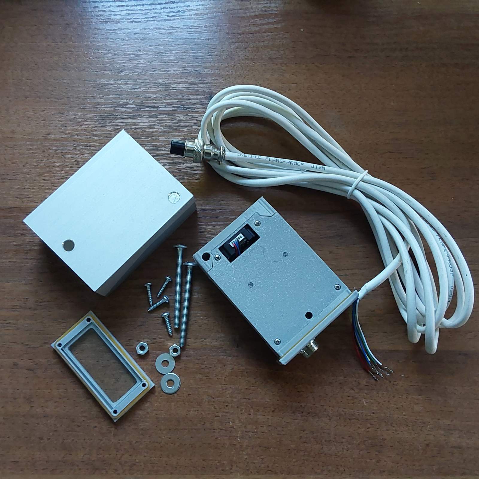

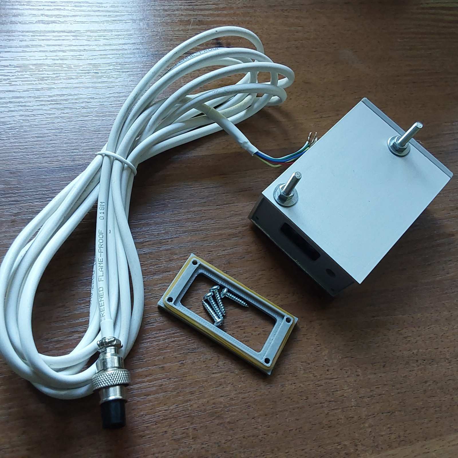

   The enclosure design also evolved through several iterations. Development began with a machined aluminum prototype used for laboratory testing.
   To simplify manufacturing and reduce production costs, the enclosure was redesigned in SolidWorks and produced using 3D printing with PETG.

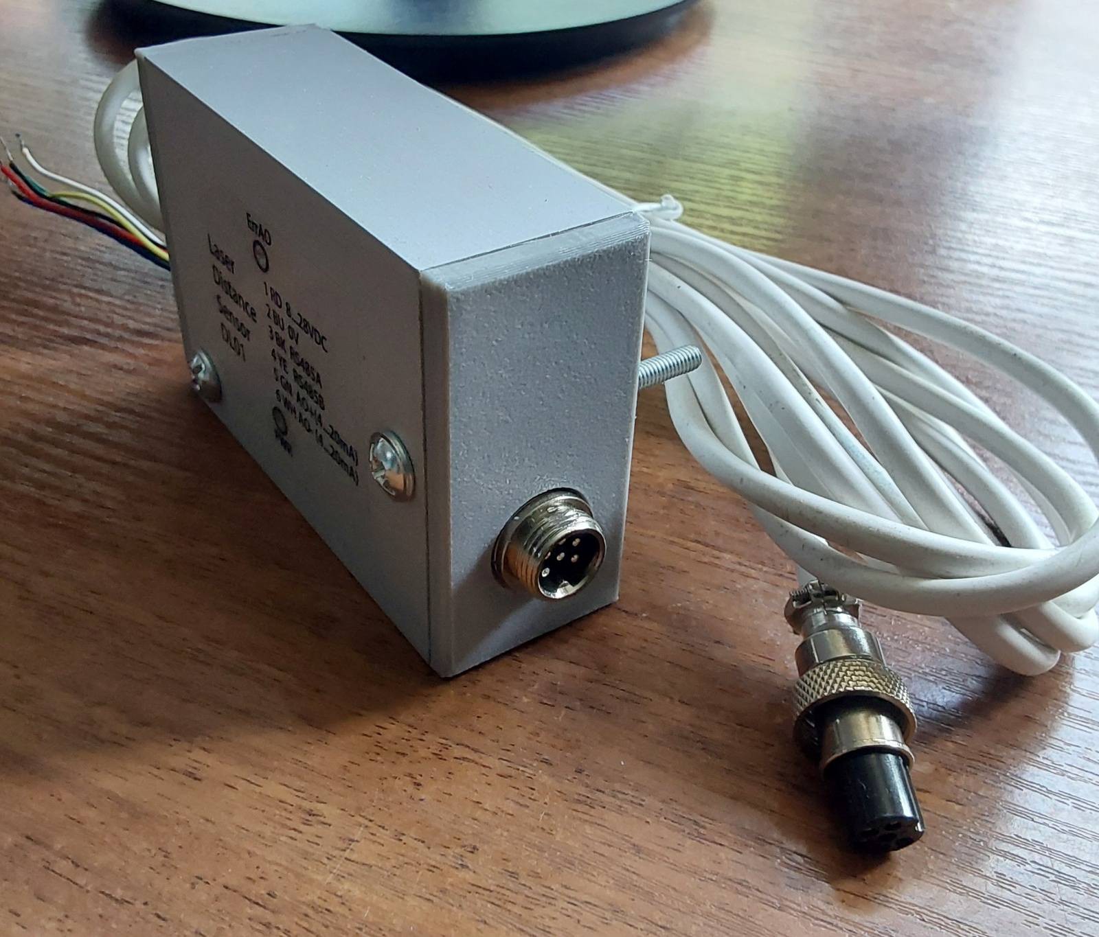

   A specially designed laser distance sensor for measuring concrete levels during the vibro-pressing process
   TF-Luna ToF laser module used as the optical sensing element
    Original laser sensor previously used in the production machine
   After laboratory testing, the sensor was installed on the second hopper carriage of a concrete block production machine, where it is used to control the dosing of the concrete mixture.
    It has now been operating continuously as part of the production line and has been successfully used in daily industrial operation for several months.
    The operator HMI displays measurements from both sensing channels. Channel K1 uses the original industrial laser sensor, while Channel K2 uses the custom laser sensor developed in this project....
