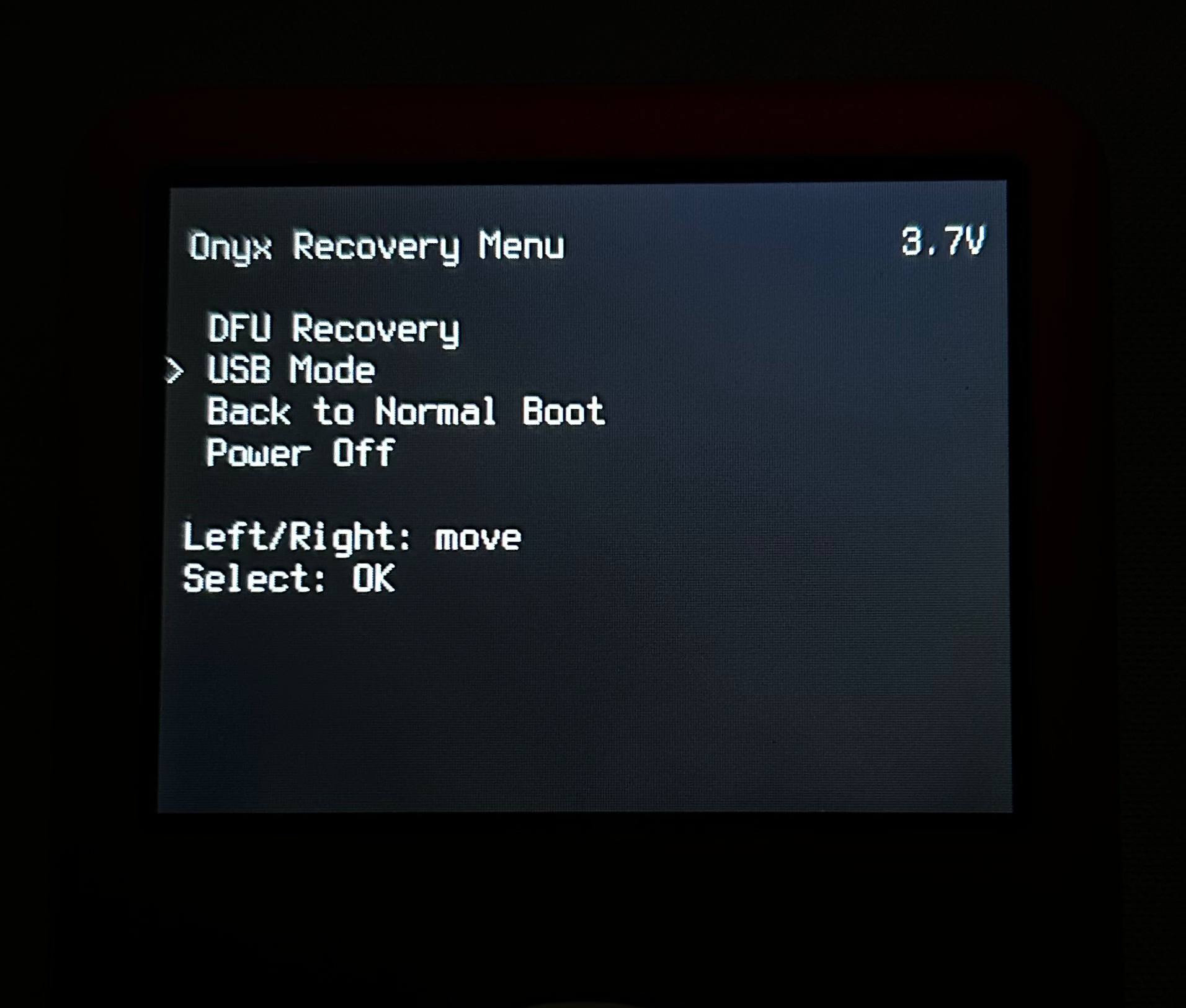

  • Log entry #2 - Bootloader
    Dream1iner07/30/2026 at 23:29 0 comments
    think bootloader is ready.
    For the past 2 weeks that's third time I think this way, but this time I think it's actually 90% done and no significant changes are expected.
    BL is different from ipodLinux and Rockbox, so I've added Recovery Menu, something familiar to Android users.
    Should be helpful if things go sideways.
    I've crashed my BL on purpose just to see how easy can I restore it and having recovery menu helps a lot.
    There won't be dual OS support, since I hate when ipod decides to go with original OS and then it takes minutes if you have big music library + not having original OS and dual boot option damaged partition couple of times, so yes, no dual boot.
    One thing that I always wanted to have is auto DFU - but I was not able to achieve that safely.
    Since I will build separate flashing tool, I decided to not proceed with auto DFU, at least for now.
