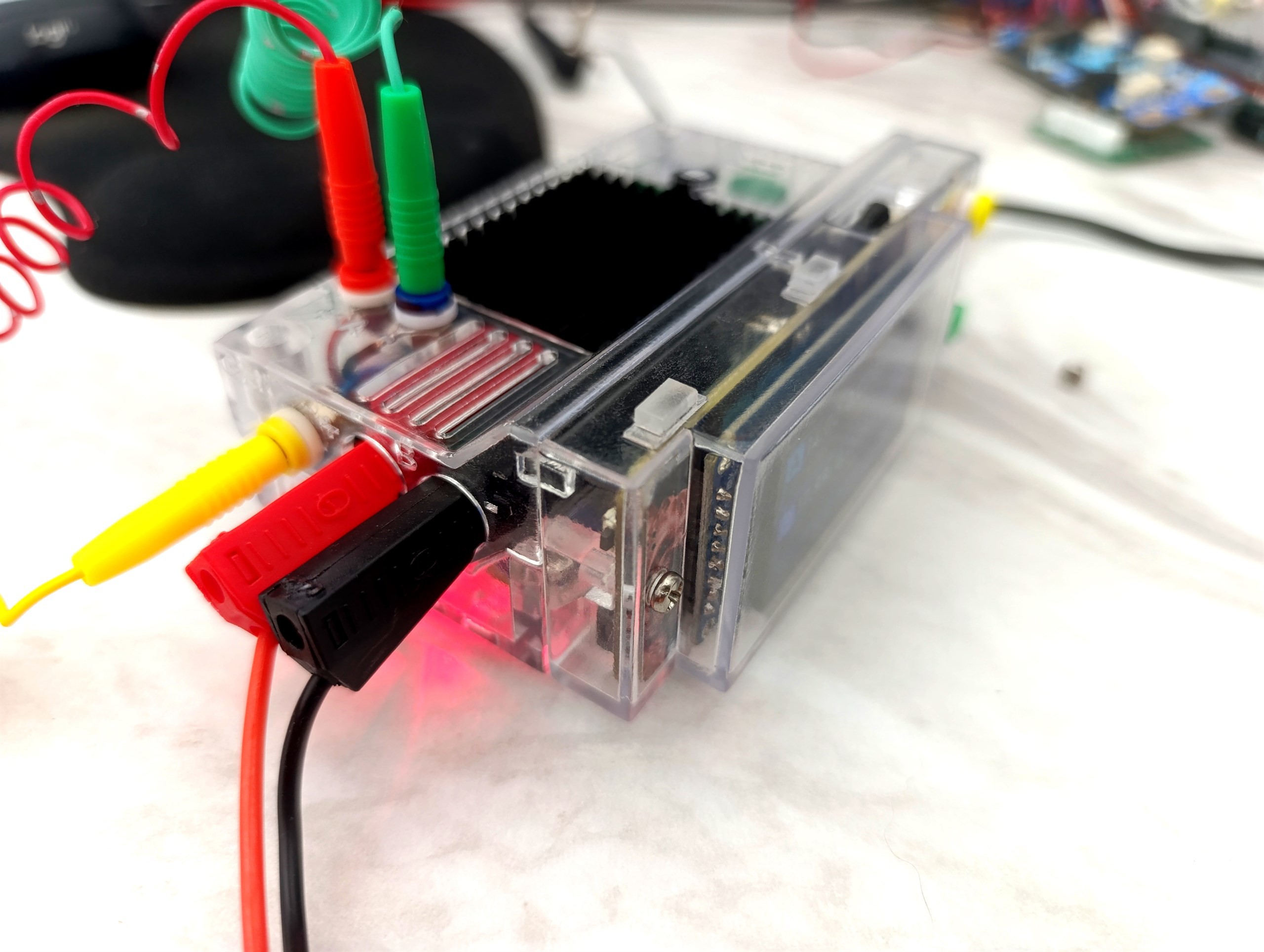

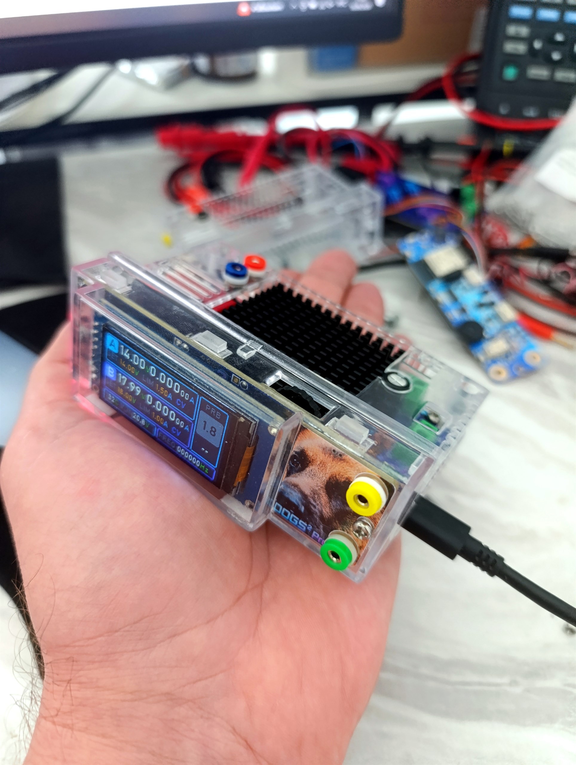

  • Enclosure assembled — ready for testing
    Sergei • 09/20/2026 at 13:33 • 0 comments
    All the enclosure parts have arrived, and I’ve now put everything together. It’s good to finally see the project assembled in its enclosure!
    I’ve also updated the repository to reflect the latest changes. With the assembly complete and the repository brought up to date, the main development phase is now finished.
    What remains is testing: checking how everything works as a complete unit and finding any issues that still need attention. There may be a few adjustments along the way, but the focus has now shifted from building to validation.
    I’ll share the test results in the next update.

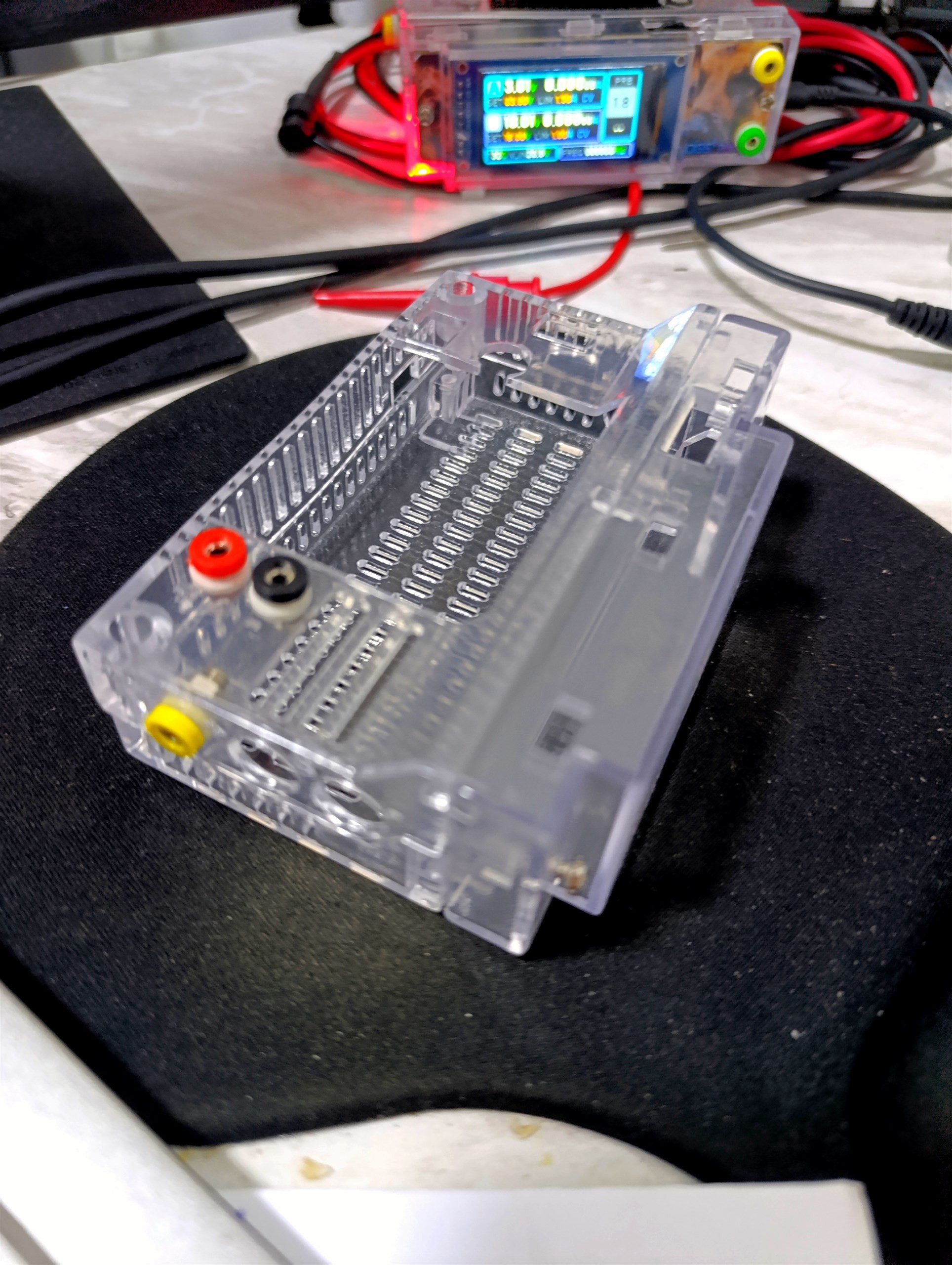

  • Well, I've completed another stage – the cases are ready.
    Sergei • 08/23/2026 at 09:22 • 0 comments
    They look pretty good and there aren't any major mistakes.
     The only thing is it took a really long time – they took about a week to print and then nearly another week to get to me.
    Anyway – take a look at how they turned out.

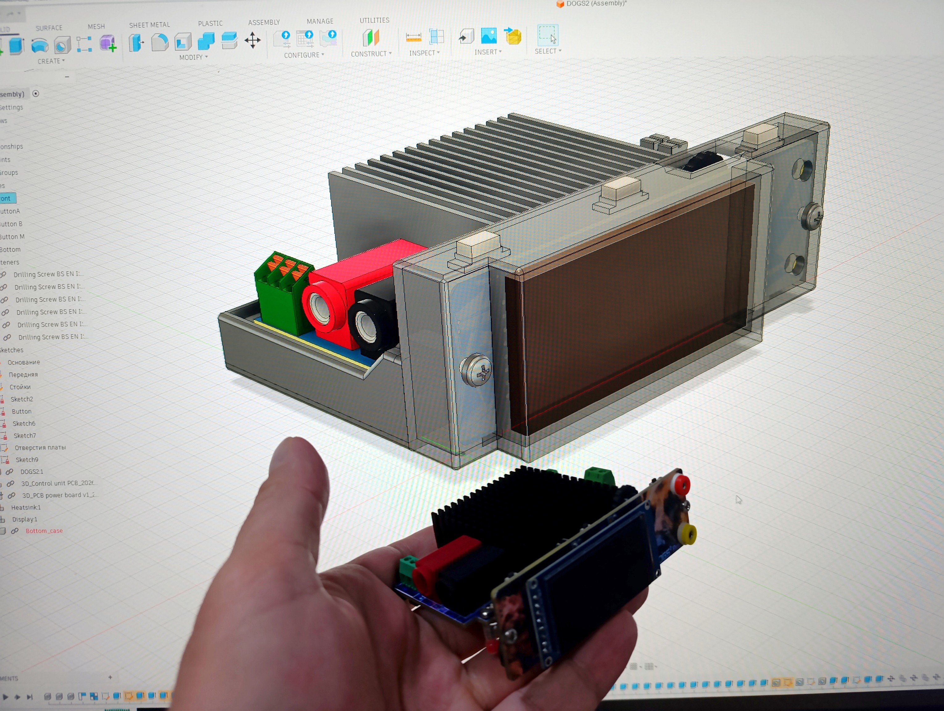

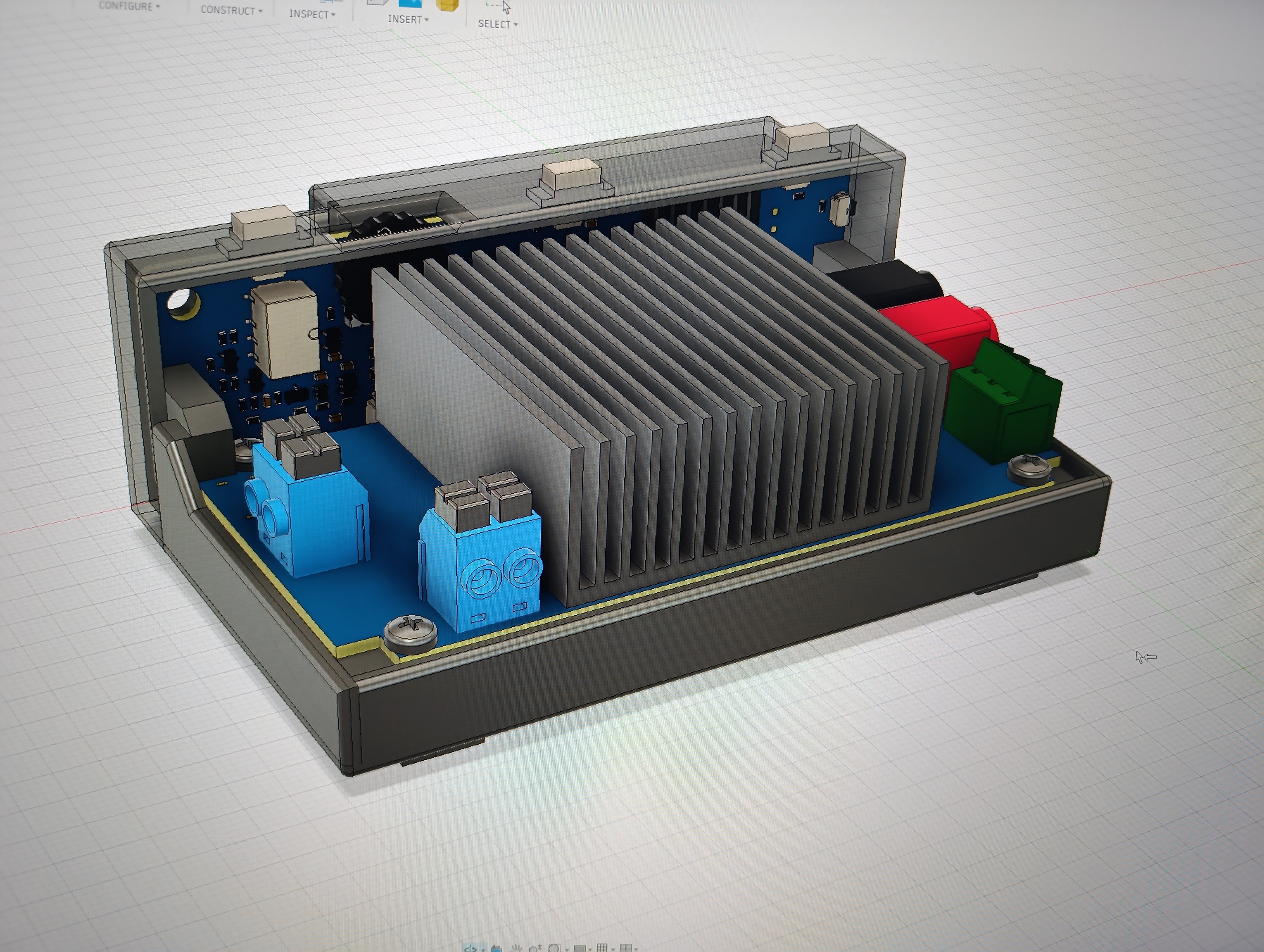

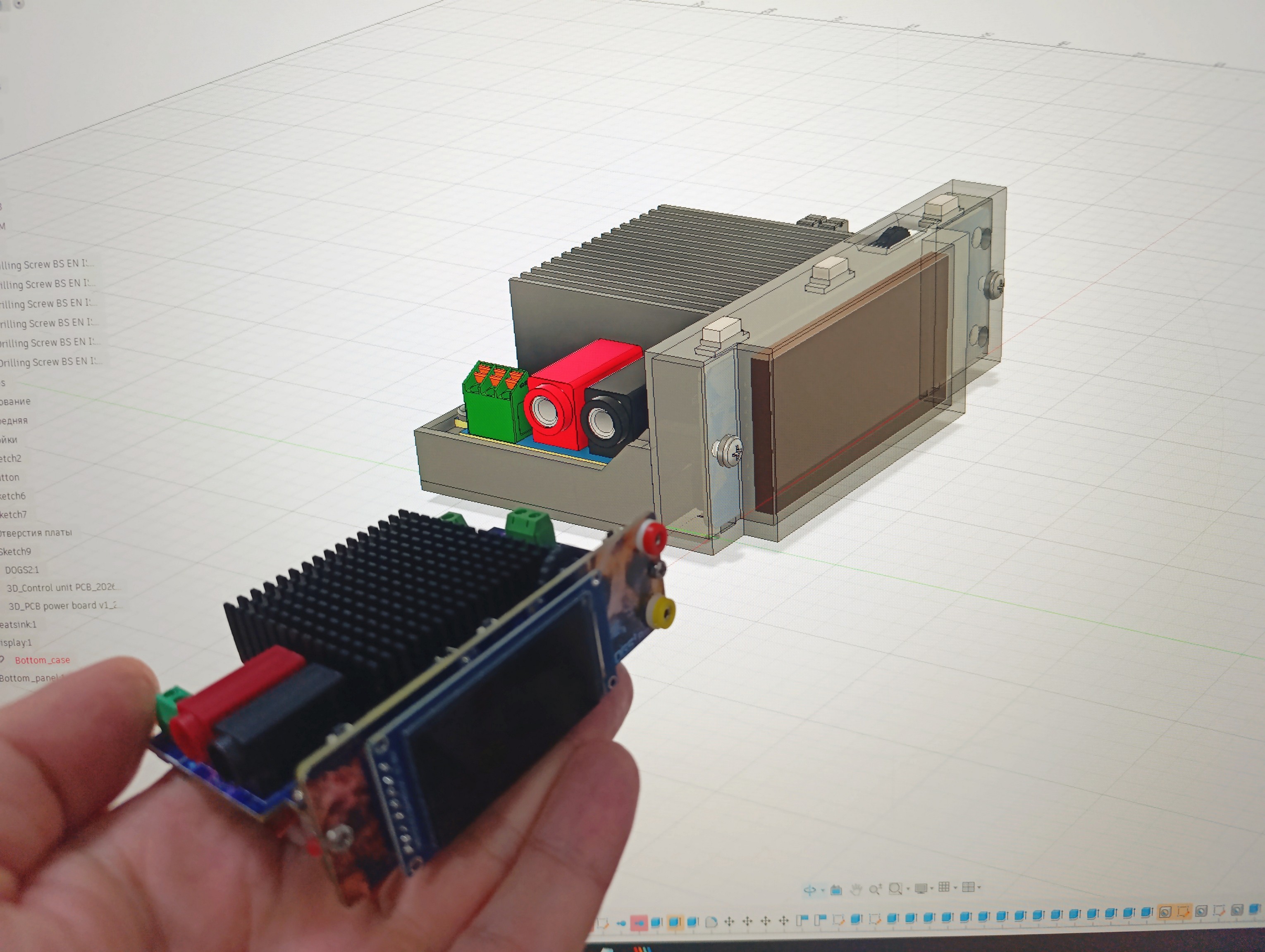

  • DOGS² Enclosure: Sharp Edges or Rounded Corners?
    Sergei • 08/05/2026 at 13:16 • 0 comments
    The DOGS² enclosure design has been completed as a 3D model. The images show the enclosure with the boards installed inside, along with two versions of its exterior design.
    The overall dimensions and internal layout are the same in both versions. The only difference is the treatment of the outer edges: the first version retains sharp corners, while the second adds fillets.
    I have not yet decided which version suits DOGS² better. I would like to hear the community’s opinion: which enclosure would you choose—one with sharp edges or one with rounded corners?
