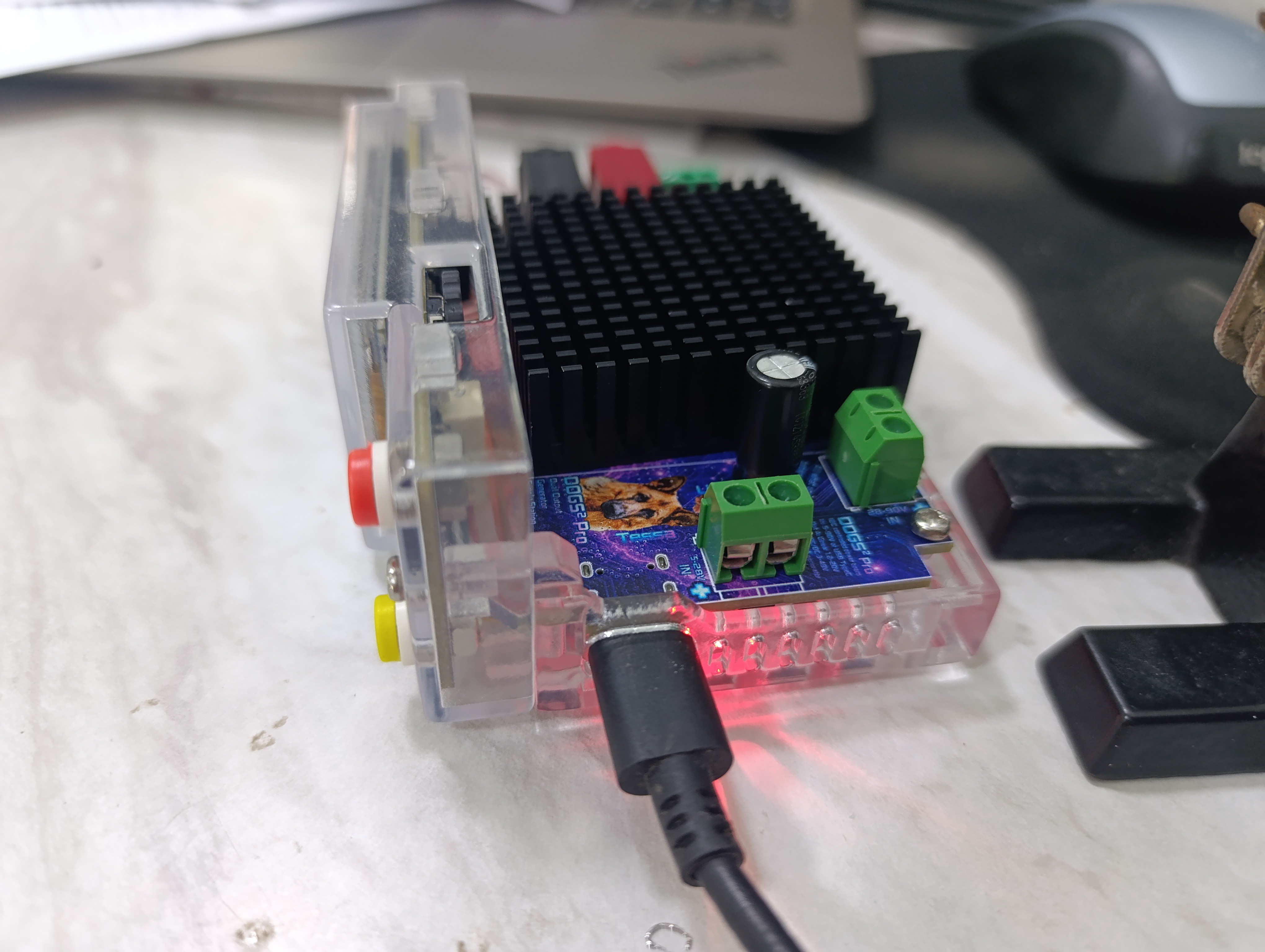

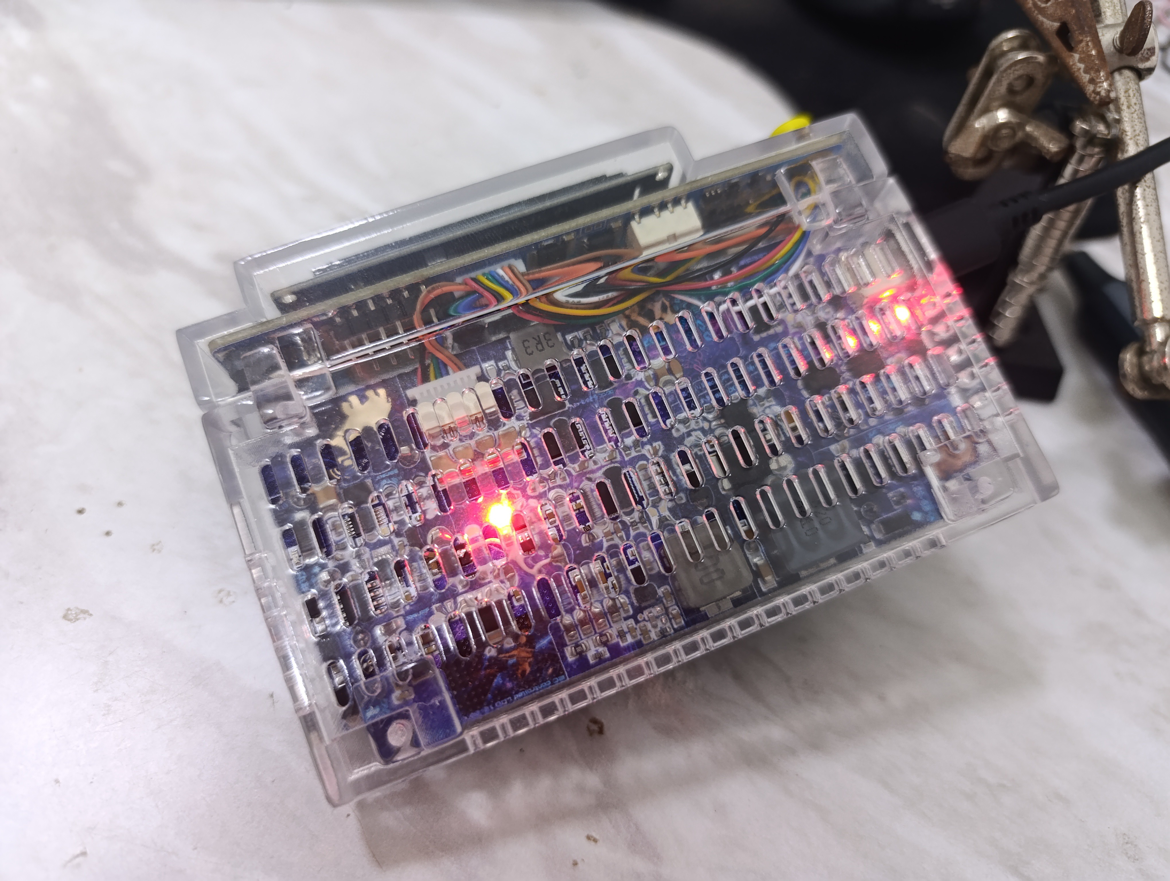

Well, I've completed another stage – the cases are ready.
08/23/2026 at 09:22 • 0 commentsThey look pretty good and there aren't any major mistakes.
The only thing is it took a really long time – they took about a week to print and then nearly another week to get to me.
Anyway – take a look at how they turned out. -

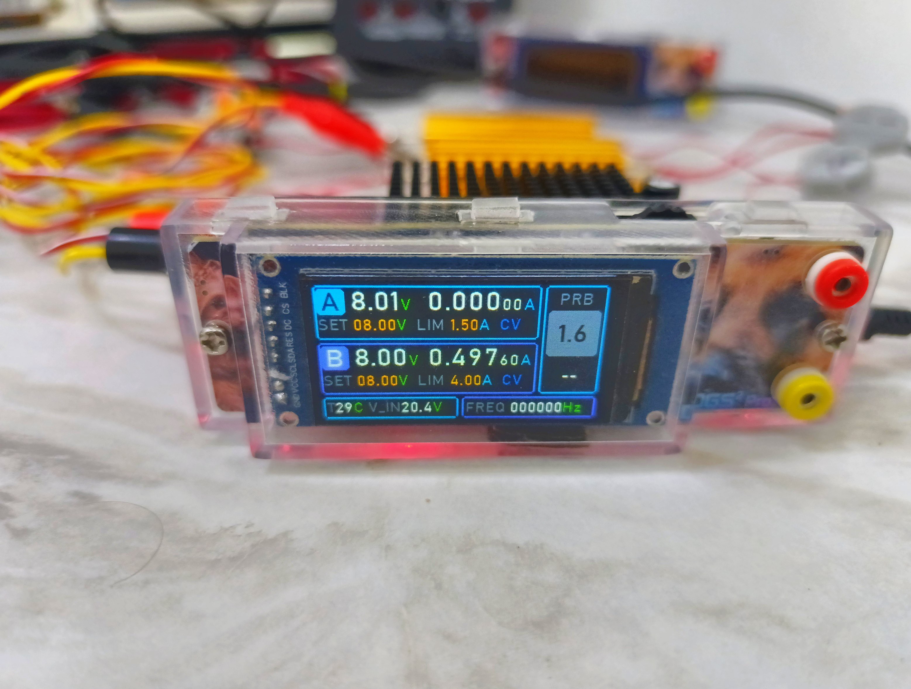

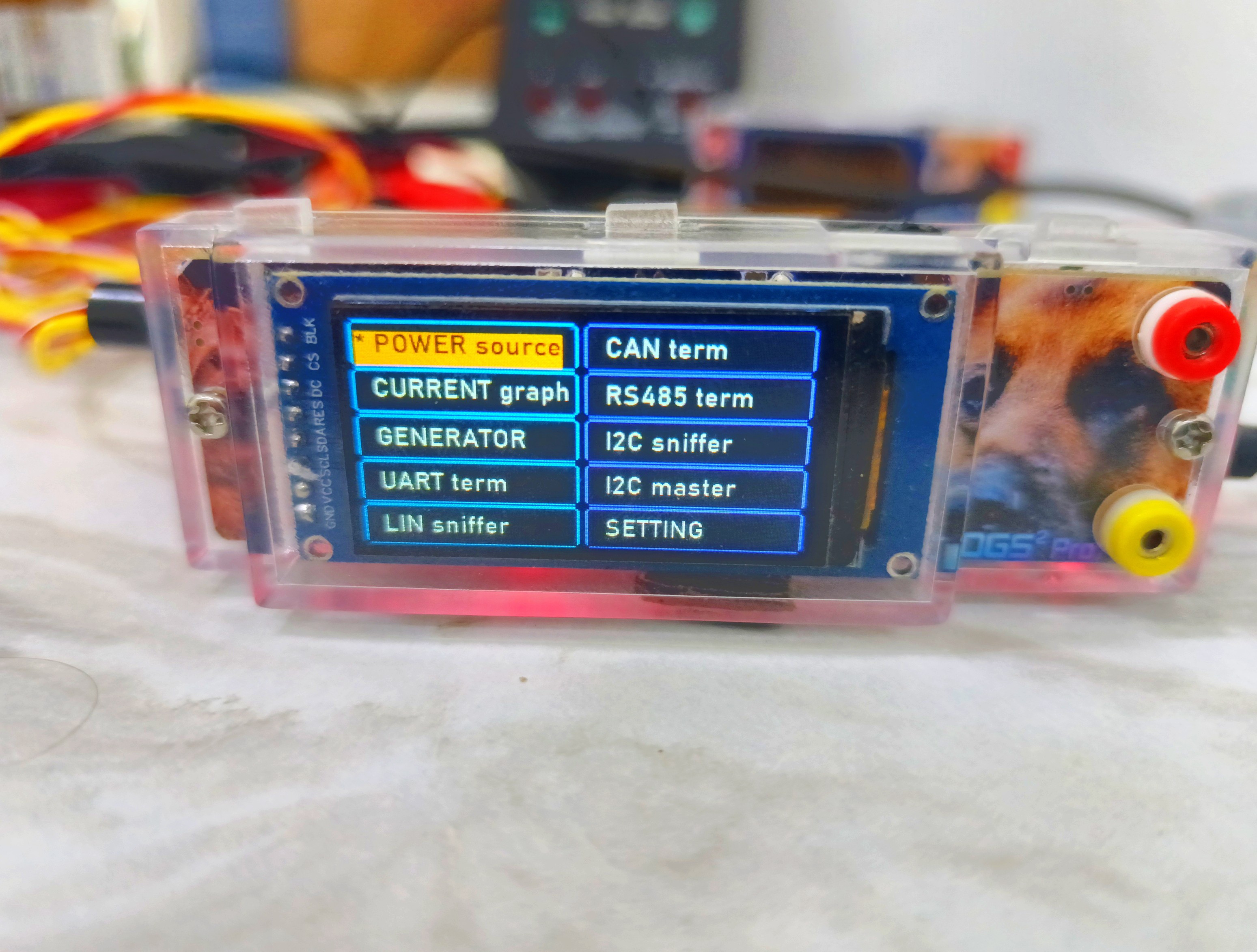

What works in DOGS² v1 today
08/01/2026 at 14:13 • 0 commentsDOGS² v1 is working engineering hardware, and the current prototype runs the latest firmware. This is not a finished product yet, but most of the functions that define the instrument are already operational.
![DOGS² v1 working engineering prototype]()
Working now
- Channel A: low-noise linear output up to 20 V / 1.5 A, with a current-measurement LSB of 12.5 µA below 400 mA and 50 µA above 400 mA.
- Channel B: switching output up to 48 V / 3 A continuously or 5 A for short periods, with a current-measurement LSB of 125 µA.
- Logic probe and voltmeter with measurement up to 25 V.
- Frequency counter up to 100 kHz.
- Square-wave generator from 1 Hz to 100 kHz, with 1–99% duty cycle and an output of up to 20 V / 1 A through Channel A.
- UART and RS485 terminals.
- Reception, filtering and transmission of 11-bit CAN frames.
- I2C master and passive I2C sniffer with address filtering.
- Bluetooth SPP for phone terminals and current-consumption graphs.
