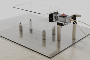

Hackaday.io Hackaday.io
Sign up Log in
OpenValve
OpenValve is a 3D-printed irrigation valve that runs from a rain barrel and waters only when needed. (open-source)
fabianFabian
Following Follow project
Liked Like project
Become a Hackaday.io member
Sign up with Github
Sign up with Twitter
OR
Forgot your password?
Just one more thing
Pick an awesome username
hackaday.io/
Pick a few interests
Choose more interests.
OK, I'm done! Skip
Join this project
96 views
0 comments
3 followers
1 likes
  • Description
  • Details
  • Files 0
  • Components 0
  • Logs 0
  • Instructions 0
  • Discussion 0
View Gallery
96
0
3
1
Team (1)
  • fabianFabian
Join this project's team
  • OpenValve
  • Project Website
ongoing project
Related lists
Satisfying Water Projects
A collection of projects involving water in one way or another.
This project is submitted for
  • Hackaday.com Tip Line
This project was created on 08/04/2026 and last updated 4 days ago.
Description
OpenValve is an open-source alternative to classic irrigation timers. Instead of watering on a fixed schedule, it measures soil moisture and opens when the soil becomes drier than a configurable threshold. OpenValve is suitalbe for little greenhouses, balconies, plant beds, community gardens and off-grid irrigation setups. At its core is a 3D-printable, bistable pinch valve that consumes power only while switching. It works with gravity-fed water sources as well as pressurized systems up to 4 bar, tolerates particle-rich water, and runs for approximately three months on a 9 V battery. The mechanical design, electronics, PCB, bill of materials, and software are open source, allowing OpenValve to be repaired, modified, or adapted for other sensor-controlled liquid-handling projects.
Details
Log In/Sign up to comment
Become a Hackaday.io Member
Sign up with Github
Sign up with X
OR
A sub-$10, zero-power water purification platform utilizing passive acoustics, bio-aerogels, and piezoceramic plasma.
Project Owner Contributor
Autogenous Capillary-Plasma System (ACPS) Sub-$10
charles-clark-lawrenceCharles Clark Lawrence
Open source irrigation for small scale agricultural operations.
Project Owner Contributor
EnviroFlux
sherveen-shokoohiSherveen Shokoohi
Open-source water loop system using UV-C, micron filters & solar. Modular, scalable, CC0-licensed & built from Amazon parts.
Project Owner Contributor
KidneyLoop: DIY Solar Water Purifier
polymath8Polymath8
Industrial water-from-air generator. Zero electricity, pumps, filters, or brine. Uses 1km deep-sea thermal liana. 100% Open Source solution.
Project Owner Contributor
The Skoog Buoy: Zero-Electricity, Zero-Brine
goranskoogGoranskoog
Going up?
© 2026 Hackaday
Yes, delete it Cancel
You are about to report the project "OpenValve", please tell us the reason.
Send message
Remove Member
