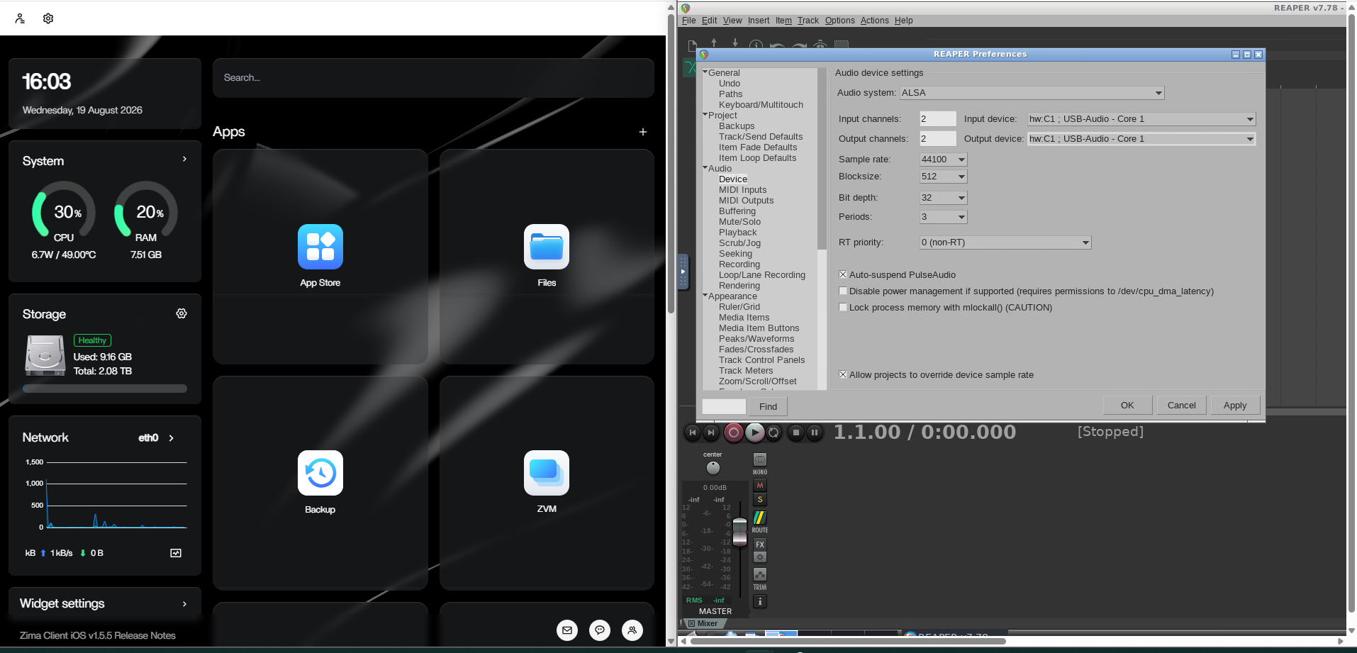

    Still buoyed with joy following docker containers saving the day, I wanted set up a little test audio interface ahead of audio testing next week.
    I plugged in my Alesis Core 1 interface ( a tiny, single input interface) and it appeared instantly in my DAW:
    I just need to install ALSA to actually allow the device to be used in Reaper, but it's coming together nicely. Next week I'll run a bog standard Dynamic mic (this interface does not support phantom power, so I can't use my usual condenser of choice) and some headphones and test it for real.
    My only concern at this stage is any latency added to the journey from mic>reaper>headphones, as a high latency can make recording extremely difficult if trying to record along to existing takes.

    Using ZVM, I found that running complete VMs put a lot of strain on the Zimaboard when using the stock images presented. I believe the OS is the same as what is installed on the all the boards, so these images make sense for the more powerful Zimacube which is targeted at that kind of workload alongside being a NAS.
    The Zimaboard 2 versions I have are the 832 models, which translates to 8gb RAM, and 32gb onboard storage.
    There's also a 1664 version which doubles those figures, which I think would be provide some more resources but would still struggle with the larger images as it still uses the same intel N150 CPU.
    I first contemplated looking for some other Operating Systems I could run as VMs, but when cycling through the Zima App store I spotted Portainer, and the penny instantly dropped - docker containers were the answer.
    I use Portainer to manage my homelab services, which are all hosted using docker (more specifically docker compose). Portainer provides a nice UI to managing the compose scripts, allowing you to manage your stacks of services.
    Docker is perfect for this kind of deployment, as there are a number of images which have been stripped of any bloat and unused services, allowing you to build an image of exactly what you need. The docker images are also not full OS images, which reduces both storage use and running requirements.
    To test the performance I selected an old image recommended on forums for its VNC integration, and set up a minimal environment to test the premise:
    services:
      reaper:
        image: dorowu/ubuntu-desktop-lxde-vnc
        container_name: reaper
        privileged: true
        devices:
          - /dev/snd:/dev/snd
        volumes:
          - /DATA/AppData/reaper/config:/config
          - /DATA/ReaperProjects:/projects
        environment:
          - TZ=Europe/London
        ports:
          - "6080:80"
        restart: unless-stopped
    Worked perfectly - connected via my browser to see the lxde desktop environment and install Reaper, my DAW of choice. System resources were barely troubled, jumping to ~25% at worst. When going for full VM the CPU was around 90% so this was a significant improvement.

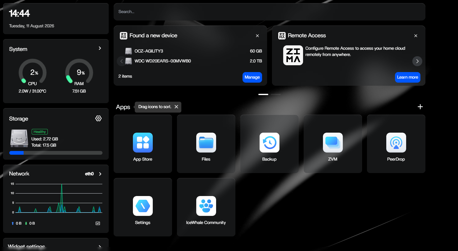

    This is not aimed to be a review of ZimaOS per se, nor is it a guide on how to set it up - there are some fantastic guides on YouTube over getting started.
    I must say - getting my first unit to the point of software installation has been so easy. I connected it to my network switch and powered it up, and used my router to find its IP address. You can connect a monitor to the display port, but it was much easier to check the router for new devices. Popped the IP address into my browser and was prompted to create a local account, then boom - I was in. Nice to see my two drives are already recognised from the off.

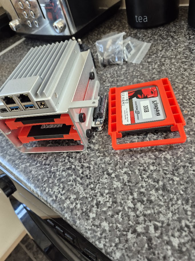

    The Zimaboard's NAS Kit is fantastic for what I need for my project. Both nodes require storage and need to be enveloped into one unit.
    The only issue for me is that, certainly for the mobile unit that will be moved frequently, I need solid state storage. The speed of the drives will help for editing over any network connection, and I'd feel much better carrying my audio on solid state rather than mechanical.
    The NAS Kit doesn't natively cater for 2.5" drives, just 2 x 3.5" drives. I picked up some cheap adapter sleds for some of my old SSDs for testing, and bored the mounting holes out for the Zimaboard thumb screws. They do the job, but aren't ideal. I'd like to design an insert for the mobile unit that spans both 3.5" bays, secures with the thumbscrews (to hold the PCI-e bracket on, although I may remove this from the mobile unit), and has better slots for 2-3 SSDs plus space to hold the mobile router.
    For the home-based server I'll use an SSD to work from and a HDD for archived projects.
