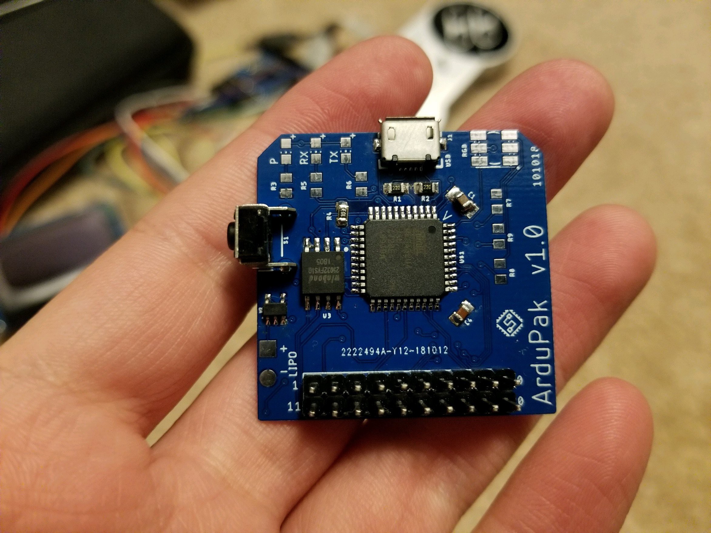

My homebrew clones served to improve on what I felt were a few shortcomings of the official hardware. Namely the original model's lack of swappable games and adding a much larger SD1309 display through my ArduCart Project:
The idea was to move the processing to a removable cart and the main console would only need power circuitry, display, buttons, speaker and battery. Basically I wanted to take the Arduboy and bring it back to its Gameboy roots by making it a cart based console. After the FX was released the limited game storage was no longer an issue so I added the flash chip to the ArduCart and rebranded it as the ArduPak.

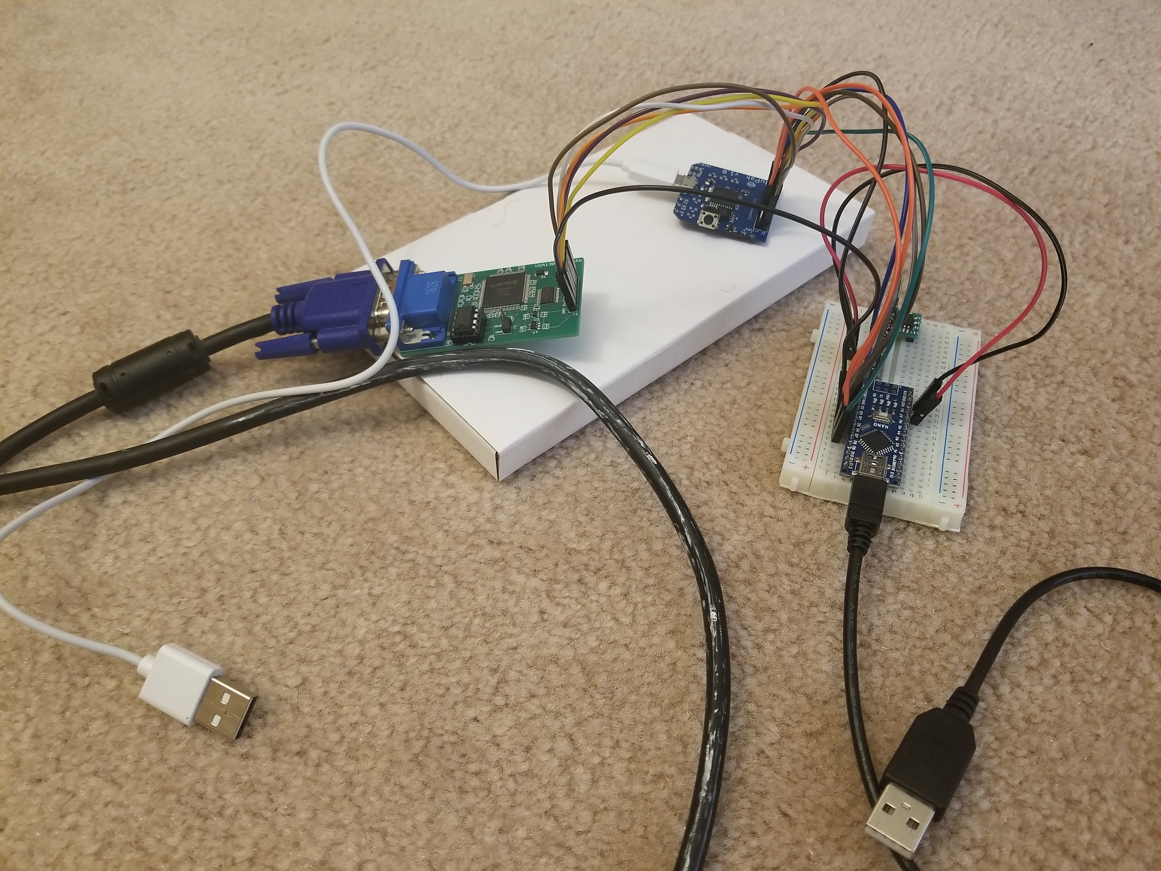

Another project I had was to turn the Arduboy into a full home console by adding VGA video output along with bluetooth control support. I demo a working prototype but the project never got past the breadboard stage.
