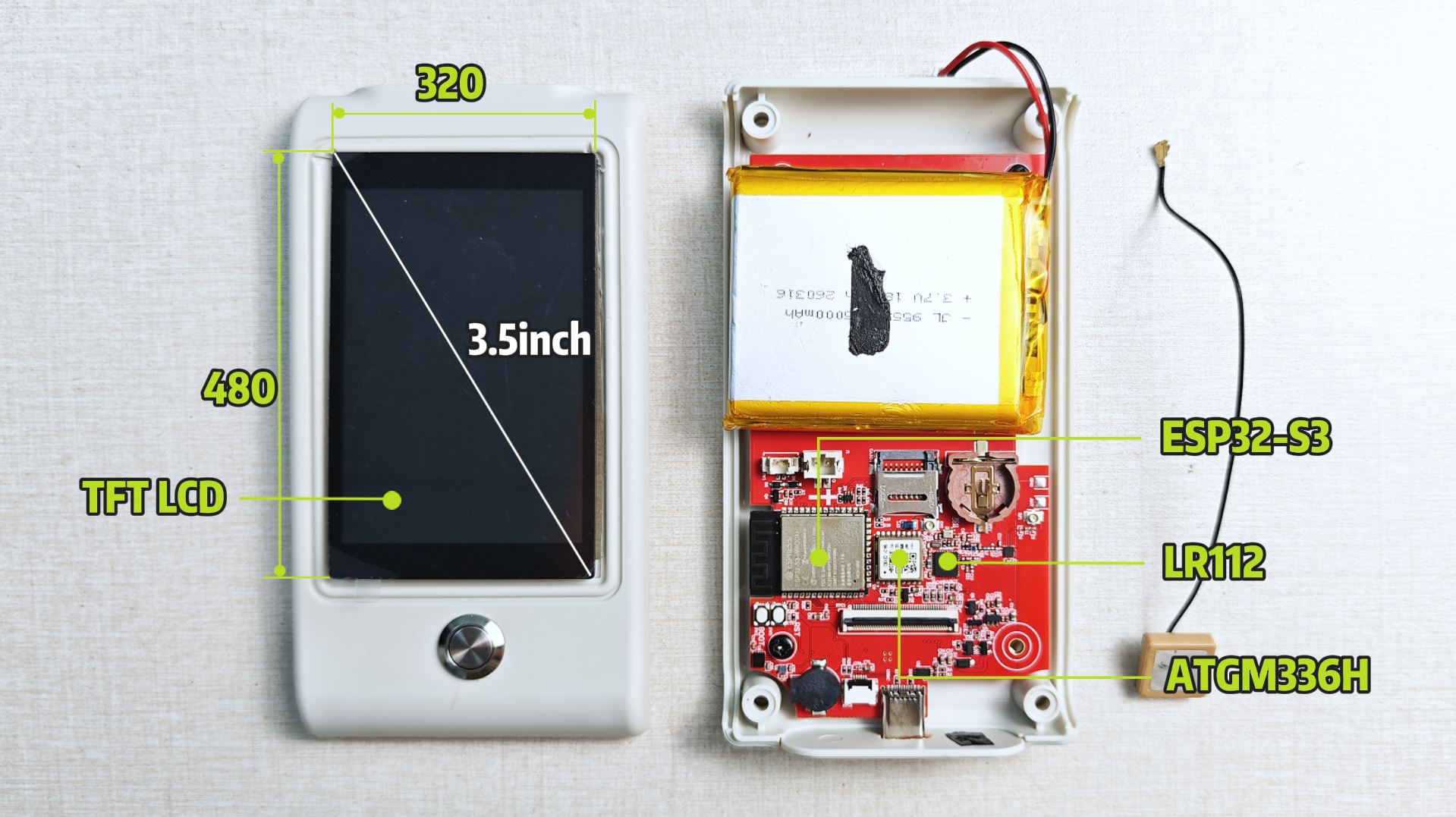

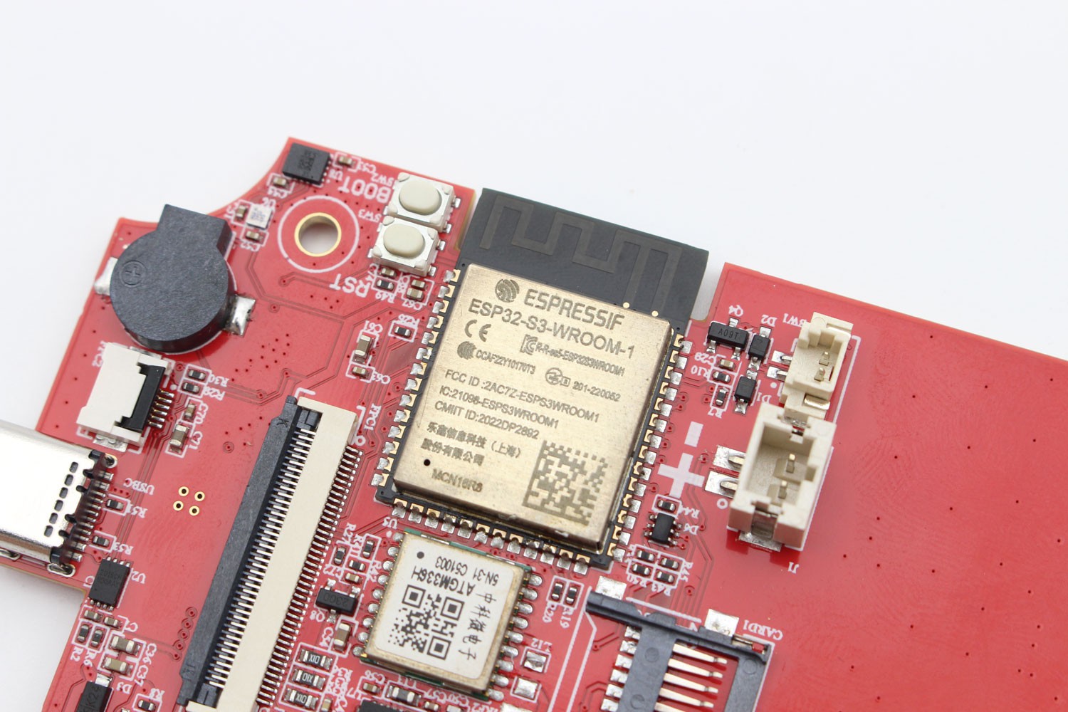

Nomad Touch is built around the ESP32-S3 and features a 3.5-inch capacitive touchscreen as its primary user interface. It supports development with Arduino, ESP-IDF, and LVGL, making it an ideal platform for rapid prototyping and product development.
For long-range wireless communication, Nomad Touch adopts the Semtech LR1121 LoRa transceiver. Professionally tuned RF front-end and antenna provide reliable communication ranges of up to 8–10 km in open environments and 2–3 km in urban areas
High-performance positioning is provided by the ATGM336H GNSS module together with an active GNSS antenna ensure reliable GNSS performance. The GNSS subsystem features an average operating current of 28 mA, with a cold-start time of 32 seconds and a hot-start time of 2 seconds..

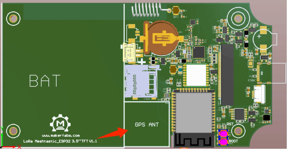

    During product development, we tested the GPS antenna performance of two design generations.
    The first-generation design was functional, but its reception performance was not as good as expected. Based on the test results, we analyzed the antenna placement and redesigned the GPS antenna structure for the second generation. This redesign improved the Time to First Fix (TTFF) from 8.2 s to 5.2 s.
    V1.0: Passive Ceramic Antenna
    The first-generation product used a passive ceramic antenna.
    To save space, it was mounted directly on the PCB, which made the product compact, but the actual GPS reception performance was not satisfactory.
    The display is positioned directly above the antenna, with metal components behind it, which negatively affects GPS signal reception.
    The battery and other components were too close to the antenna.

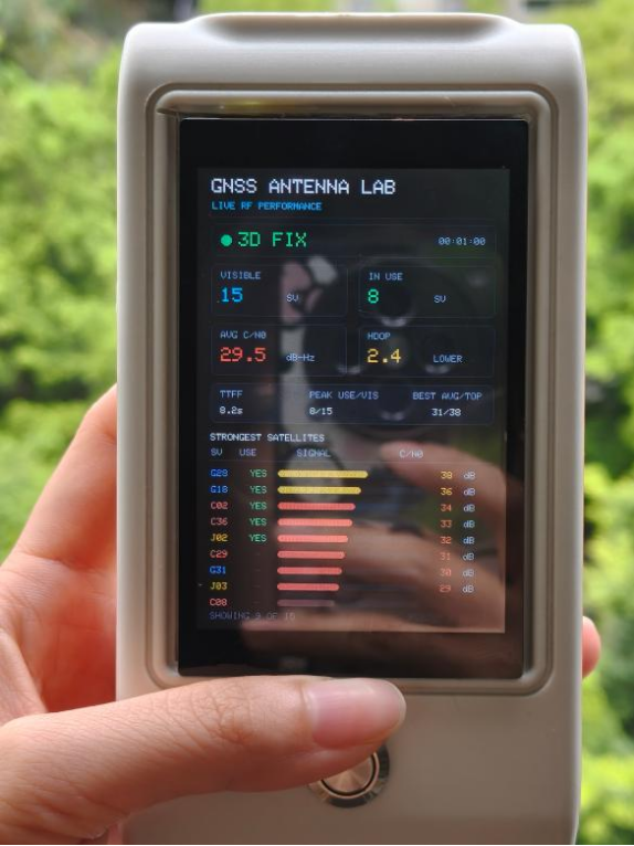

    The V1.0 test results were:
    • Time to First Fix (TTFF): 8.2 s
    • Visible satellites after 1 minute: approximately 15

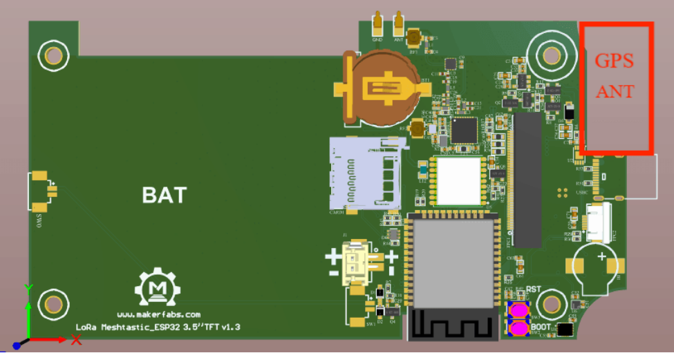

    V1.1: Redesign for Better Reception
    Based on the first-generation test results, we redesigned the GPS antenna structure for the second generation.
    The second-generation design uses an active ceramic antenna. Unlike a passive antenna, an active antenna integrates a low-noise amplifier (LNA) to boost the received RF signal before it reaches the GNSS receiver, helping improve reception in weak-signal environments.
    The antenna placement was also changed:
    • The antenna is positioned above the PCB and faces upward, with no major obstructions around it.
    • Whether the device is held in your hand or placed upright, the antenna remains pointed toward the sky.
    This redesign directly addressed the main limitations identified in the V1.0.

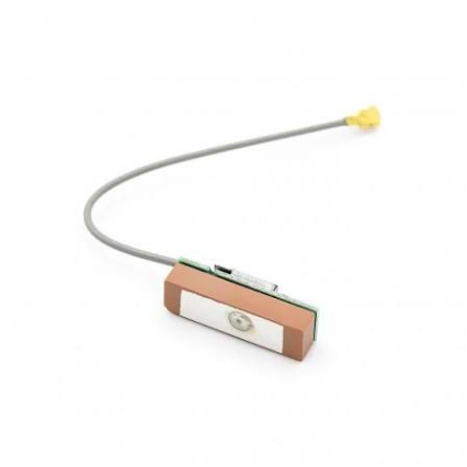

    Small active ceramic Antenna Test
    We first tested a small active ceramic antenna in the V1.1 design.
    The results showed a clear improvement compared with the first-generation passive antenna:
    • Time to First Fix (TTFF): 5.8 s.
    • Visible satellites after 1 minute: approximately 27
    This confirmed that the active antenna design and upward-facing placement were effective.
    However, the small antenna still did not fully meet our expectations. Although the performance was better, there was still room to improve signal strength and satellite visibility in some environments.
    For this reason, we continued testing with a larger active ceramic antenna.

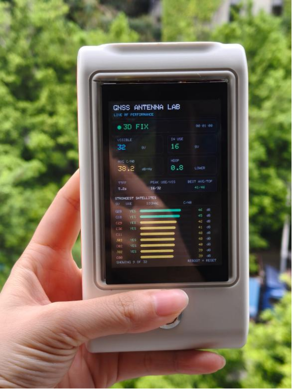

    Large active ceramic Antenna Test
    After confirming the improvement achieved with the small active ceramic antenna, we continued testing with a larger active ceramic antenna. Compared with the smaller antenna, the larger ceramic antenna provides a larger effective receiving area and can achieve higher antenna efficiency and better signal reception performance in our design.
    The test results showed a further improvement with the larger active ceramic antenna.
    • Time to First Fix (TTFF): 5.2 s
    • Visible satellites after 1 minute: approximately 32
    This result met our expectations much better than the first-generation design and the second-generation small antenna.
    Comparison
    All antenna versions were tested under the same test conditions using the same GNSS receiver and test environment. In our test, the TTFF improved from 8.2s to 5.2s.

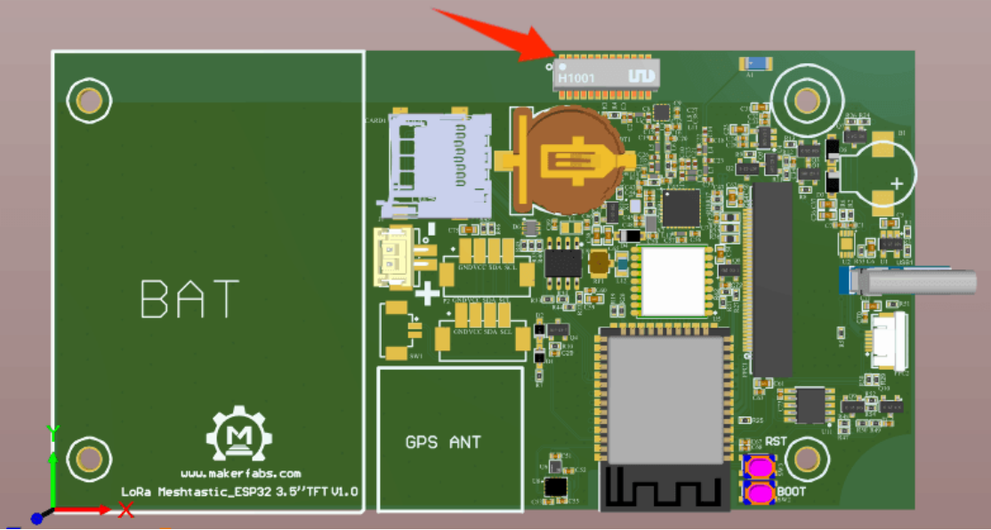

    V1.0--Ceramic Antenna
    For the first hardware revision, we used a ceramic antenna for the LoRa radio. The ceramic antenna was integrated directly onto the PCB, providing a simple and compact RF solution.
    Advantages
    Disadvantages
    Compact and easy to integrate
    Antenna performance is highly dependent on PCB layout
    No additional RF cable required
    Sensitive to nearby components and materials
    The biggest advantages of ceramic antennas are their simplicity, compactness, and ease of integration. For early product prototypes, this is a relatively straightforward solution.
    However, after assembling the complete device, we found that the ceramic antenna was located directly beneath the display module. The nearby conductive structures of the display caused antenna detuning and RF shielding, significantly degrading the overall antenna performance.
