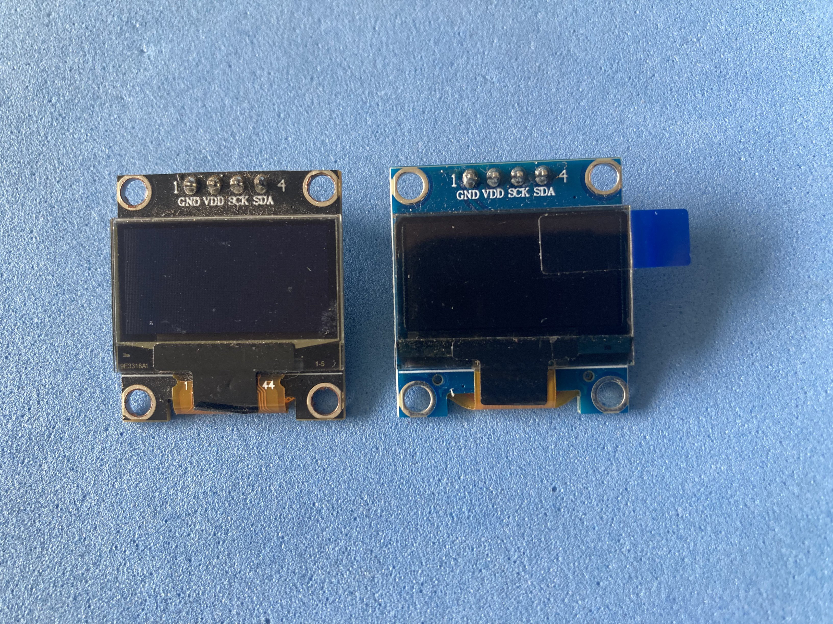

Small OLED modules look interchangeable at first glance, but mounting holes and the panel cutout needed for the display to show through rarely match between vendors. A clean panel installation usually means a precise display window plus four accurately placed screw holes. Those dimensions change from one module to the next.
Subtle differences in distances between displays from different manufacturers

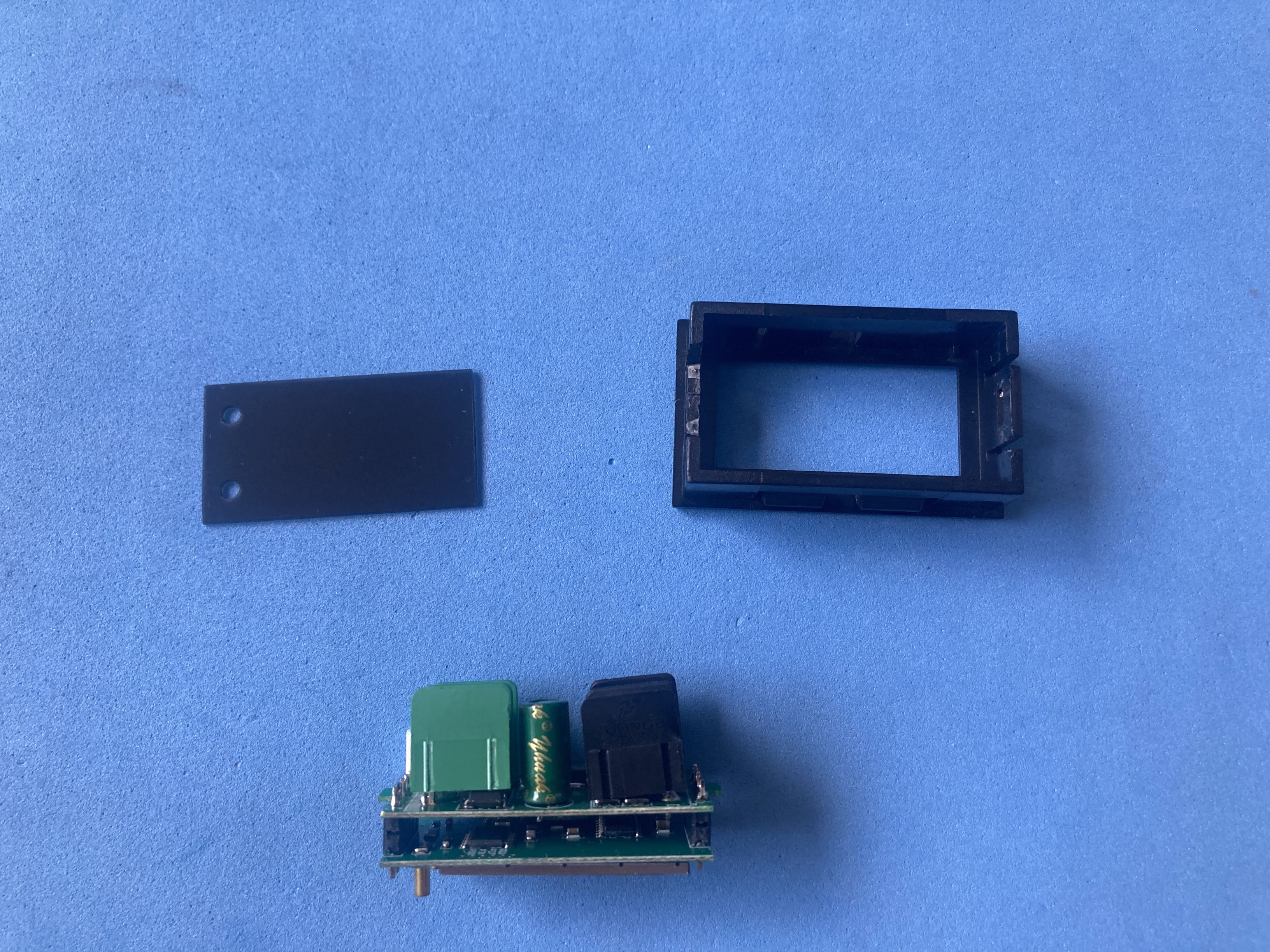

Inside the 9-in-1 meter
Core component: 0.96" OLED 128x64 bare screen I2C.

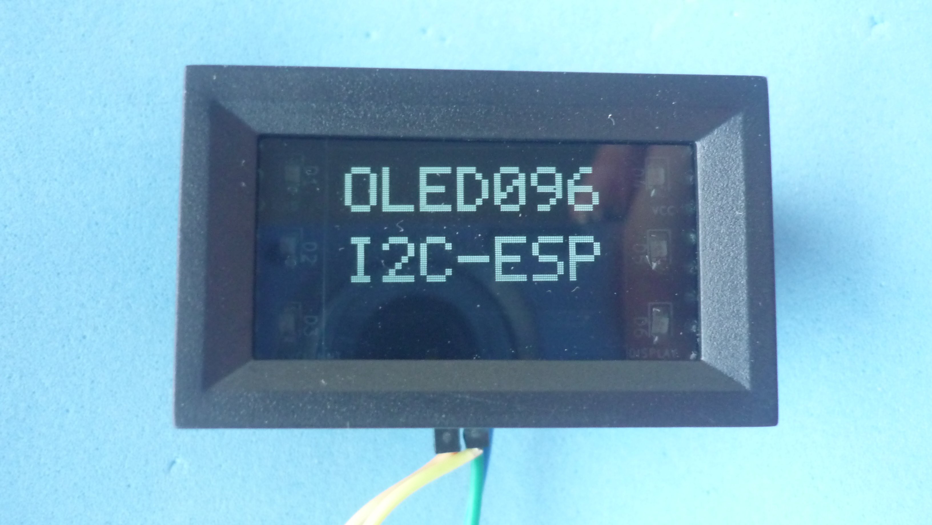

Panel-mount OLED module assembled in 48x29 mm enclosure

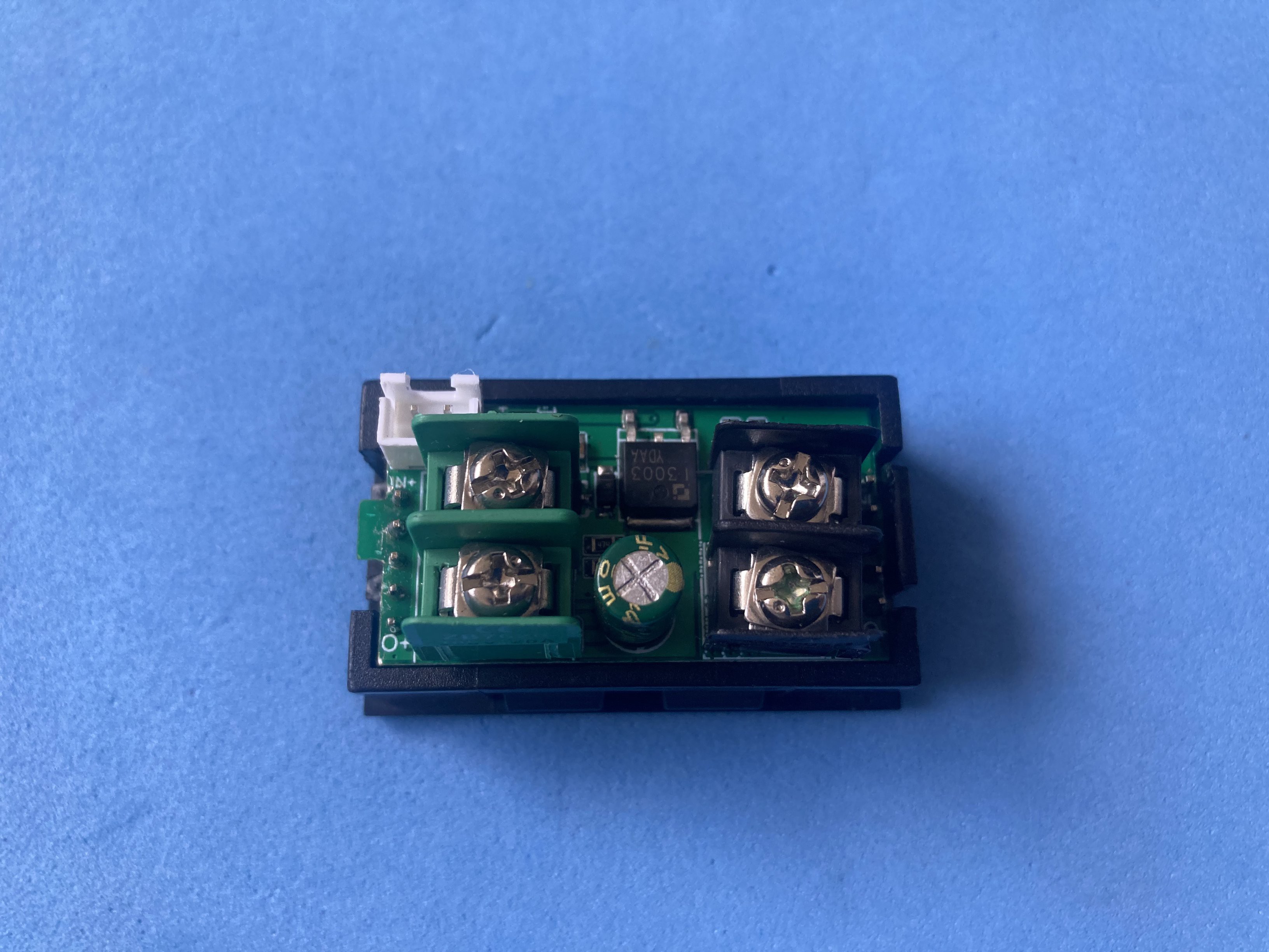

- Double-level 3.5 mm screw terminals for solid wire, stranded wire or Dupont leads
- Two-board stack: solder once, rewire many times across projects

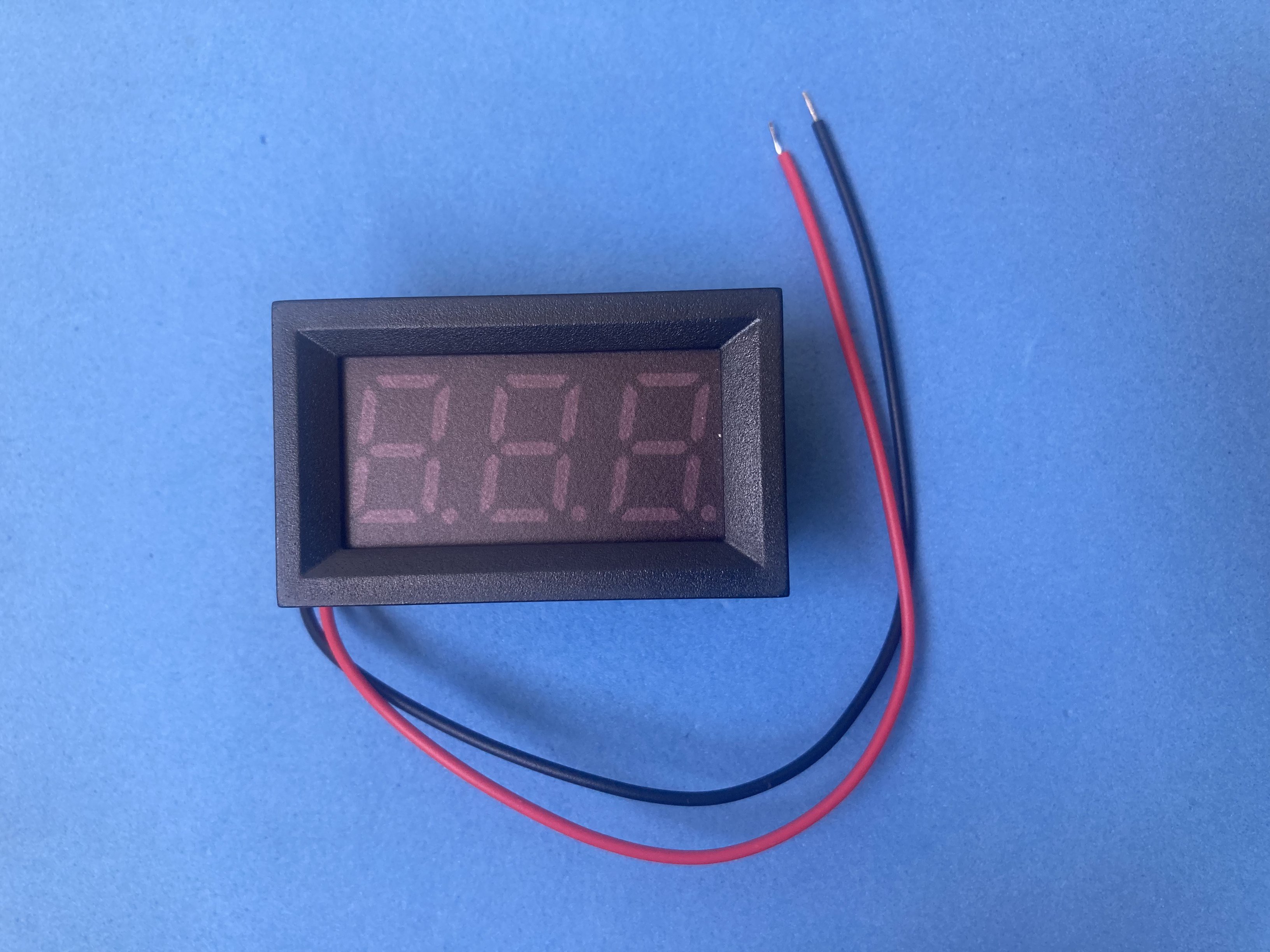

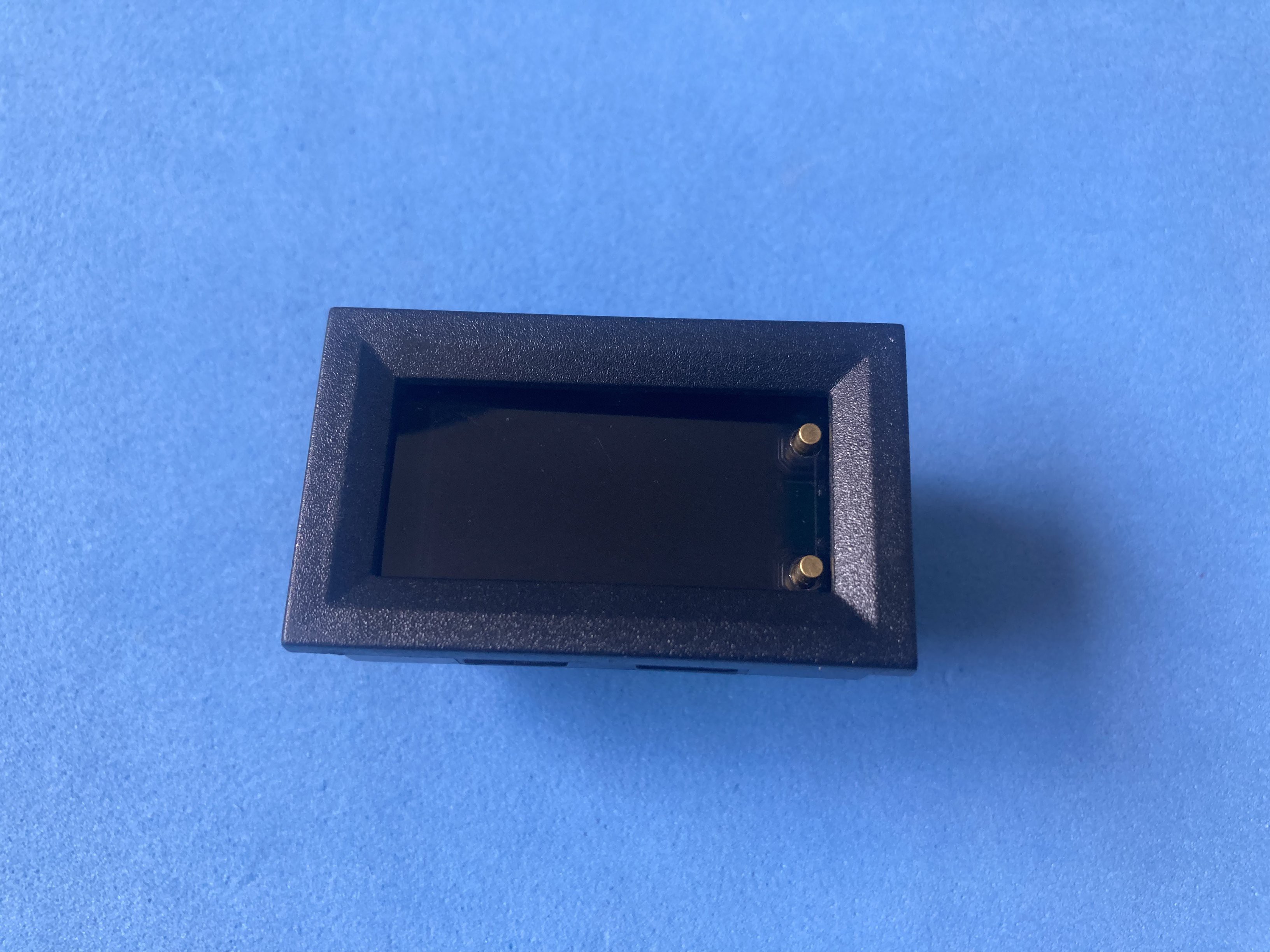

The electronics are the easy part; the enclosure is where the time goes. Empty 48×29 mm cases barely exist in hobby quantities. The realistic move is to buy the cheapest panel meter you can find and strip it. For the front window, everything was tried: the donor voltmeter’s red sheet dims the OLED too much, and green or blue pieces did no better. The grey translucent lens from the donor multimeter looked best (or dark translucent acrylic up to 1 mm if you cut your own).
One reassuring detail: the panel cutout does not need to be perfect. The bezel hides rough edges and internal clips hold the module without extra screws. Dupont plugs on the bottom terminal row are a snug fit (not the most comfortable row to work with), but once seated they stay put even if you tug the cable.

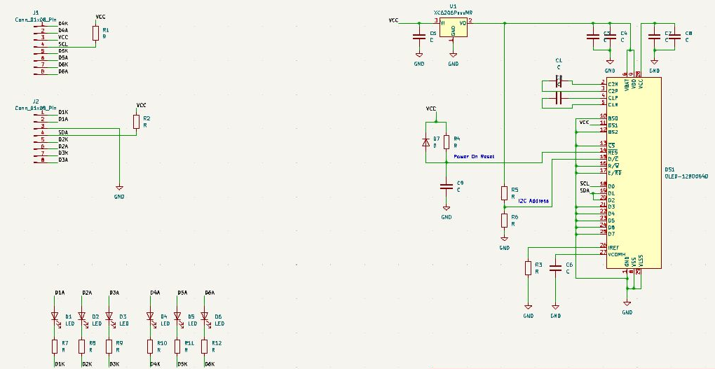

Electronic design
The design splits functionality across two boards joined by a 1×8 header. The display board carries the XC6206 3.3 V regulator, the OLED auto-reset network, I2C coupling, some capacitors used by the display's internal DC/DC converter and six indicator LEDs with independent terminals. The connector board only routes to the double-level screw terminals. Full schematics and design notes are in the GitHub repository.
Schematic (display and connector boards)
