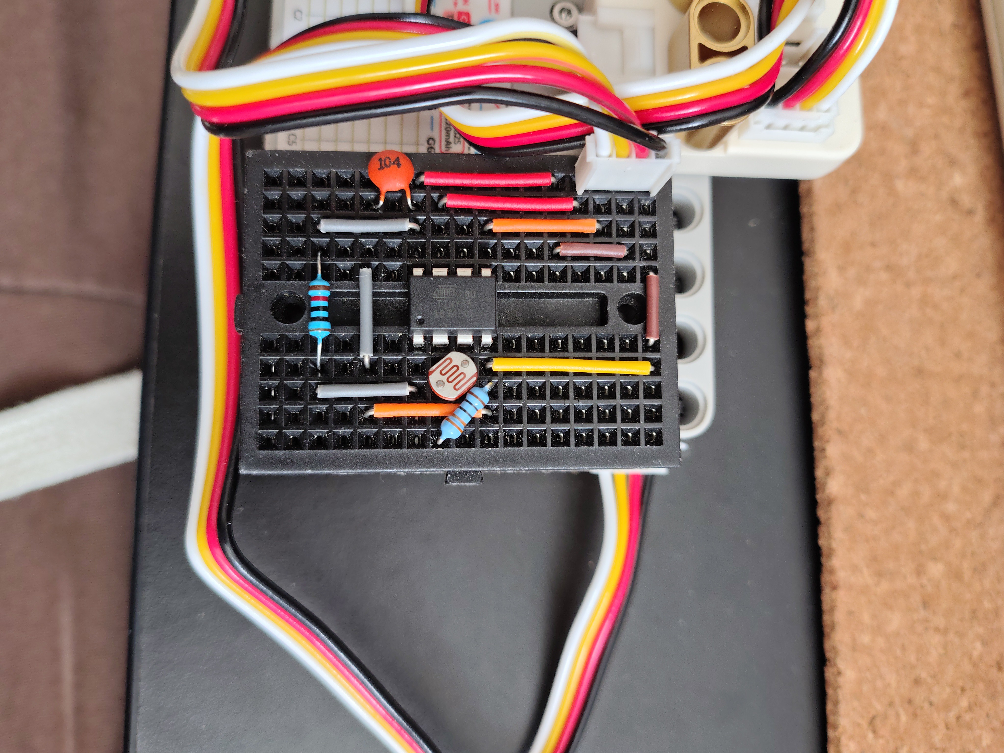

Being primarily an I²C device, the Cardputer doesn't conveniently expose an analogue input that I could connect an LDR to through a simple voltage divider. I did, however, have a handful of ATtiny85s in my parts bin.
So I had the idea of using one of those instead. The ATtiny85 could read the analogue voltage from the LDR circuit, then pass the resulting light value to the Cardputer over I²C.
I prototyped a small circuit on a breadboard - I'd planned to transfer this onto veroboard but ran out of time so I kept it as is. I left a long lead on it to enable me to choose the best position for the sensor.
I used an Arduino Uno to programme the ATtiny85 and, after an evening's coding and one small mishap involving a chip seated the wrong way around, got the two devices talking.
The ATtiny85 measured the voltage from the LDR circuit and converted it to a single-byte value (0–255), which it sent to the Cardputer over I²C. The Cardputer then timestamped each reading and logged it to a CSV file on its SD card.
I didn't have any useful specifications for the LDR, so choosing the resistor for the voltage divider was by trial and error. I tried several values and looked at the range produced between my approximate versions of "dark" (thumb over the sensor) and "bright" (phone torch pointed directly at it). Once I had a useful spread of values across the 0–255 range, that was good enough for the experiment. As I was looking to observe 'relative changes in light level' I didn't do any kind of calibration or conversion to anything like 'lux'.

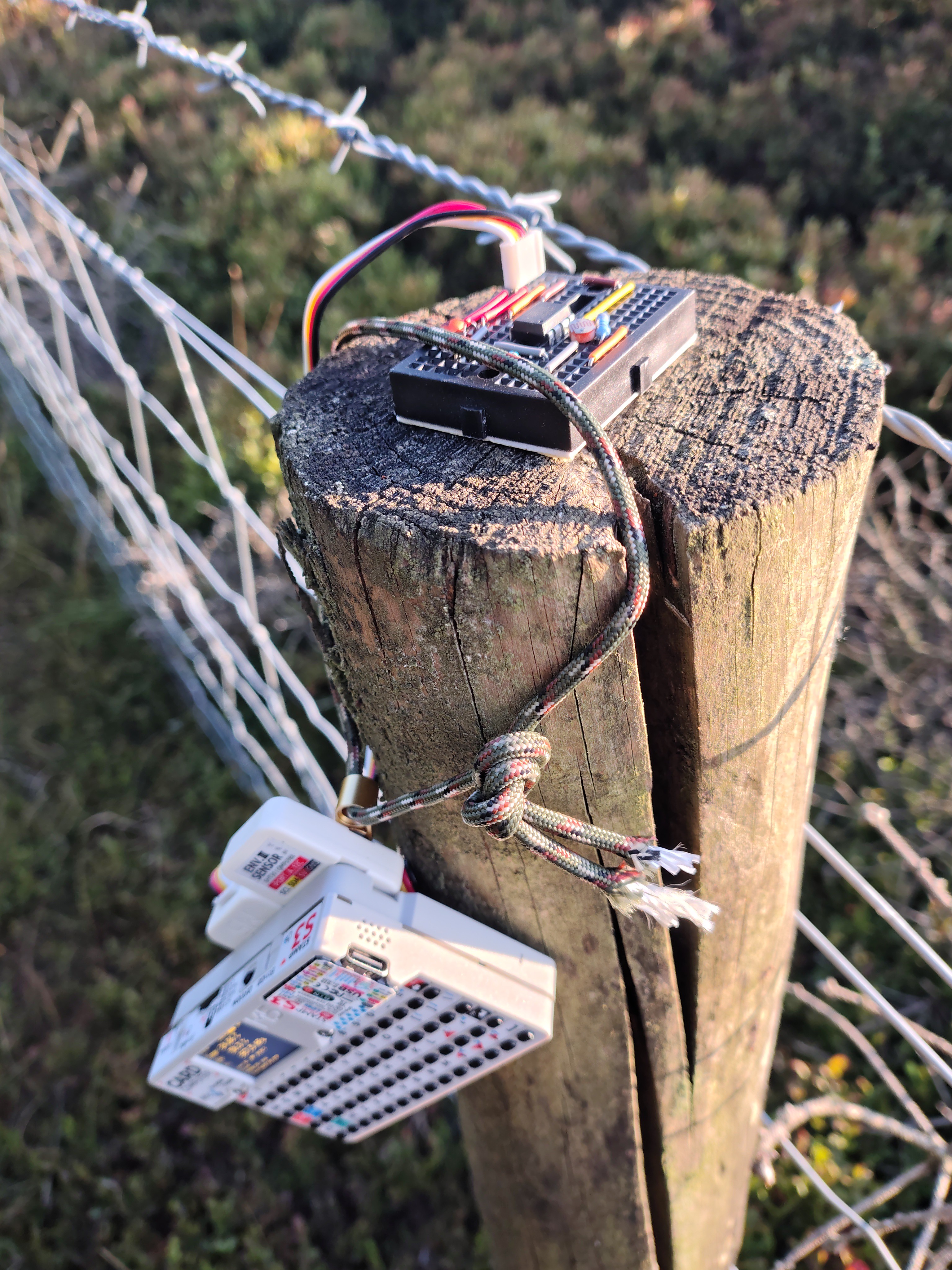

I headed out into the Dark Peak, with a forecast of hot weather and clear skies. After spending some time rehydrating after the hike in, I climbed to the top of the nearest hill and hunted around for somewhere to deploy the logger.
I found a fence post in an ideal location and secured the light sensor on top, pointing directly upwards at the sky. I suspended the Cardputer and the other sensors underneath with a length of paracord, keeping them out of direct sunlight.
I set the Cardputer to take a sample every 60 seconds, started the logger and then left it alone to do its job while I watched the eclipse.

The eclipse itself was a surreal experience, watching the Moon slowly take a bite out of our nearest star. At 19:10, at its peak, the light had a strange quality to it, casting an odd glow across the trees.
A quick glance at the Cardputer's screen showed a much lower light-level reading, which was reassuring, although I'd have to wait until I got home the following day and plotted the CSV data to really know how well it had performed.
