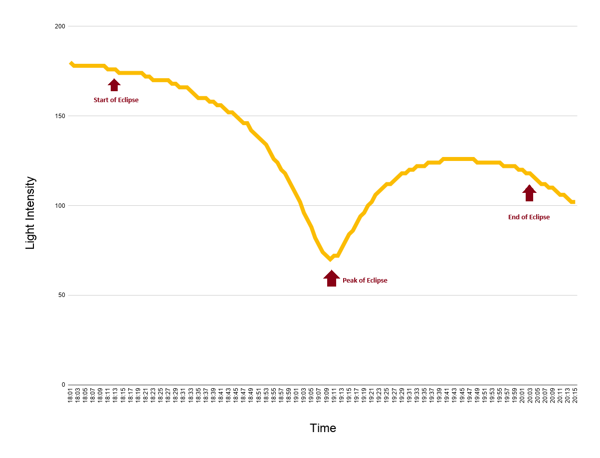

After pulling the SD Card, crossing my fingers and importing the CSV into a spreadsheet...
It worked! Look at this superb plot...!
The overall background light level was already falling as the Sun got lower in the evening sky, but you can see the eclipse carved a very obvious valley into that underlying trend. The light level fell rapidly as the eclipse progressed, bottomed out, and then climbed again before resuming its overall downward trend towards sunset.
Best of all, the lowest light reading was recorded at 19:10 - lining up exactly with the peak of the eclipse.
For something measured with an uncalibrated LDR pulled from my parts bin, I couldn't have asked for a more satisfying result.
