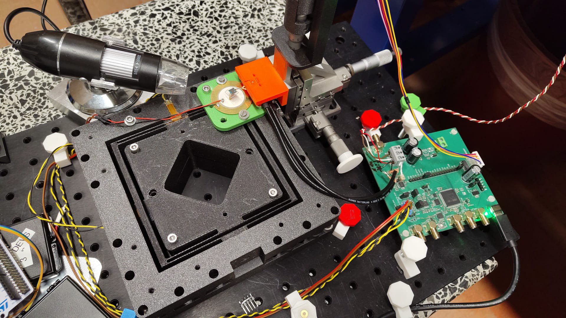

- The custom PCB was fully designed by me and is aggressively cost optimised and will be further cost optimised again to reduce the cost further. The fully assembled price per PCB stands at something like 150ish bucks from JLCPCB. It's still a working progress as there are some things to optimise but as it stands it works really damn well. Software is really the magic here. I implemented a digital lock-in amplifier with its own DDS signal generator as well as PID for amplitude modulated (AM) and PLL frequency modulated (FM) AFM. Additionally, there is also Q control to dampen the tuning fork if someone wants to operate in AM mode in vacuum. The lock-in is implemented using the STM's own included peripheral ADC and DAC making this extremely cheap since the uC chip costs like 7 bucks. I actually have more than one lock-in channel as I might add closed loop control to the stage for ultimate precision.
-The stage is a fun one. For the testing stage in the pictures, I have a 3D printed flexure stage. There are 2 linear 3D printed flexure stages stacked on top of each other forming the x and y axis. The z axis is a piezo buzzer. The flexure stage is based on the work of Eric Clot who realised hepatic feedback piezos are great cheap precision actuators! His project is linked here https://hackaday.io/project/202424-haptic-piezo-for-high-precision-actuation I want to design a flexure stage and have this CNC machined by JLCPCB (Wire EDM is very expensive...). There are currently some piezo hysteresis issues I am trying to sort out (lines outside the calibration grid squares in the images) but I am looking into this so this can be close to a commercial educational system for <1/20th of the price tag.

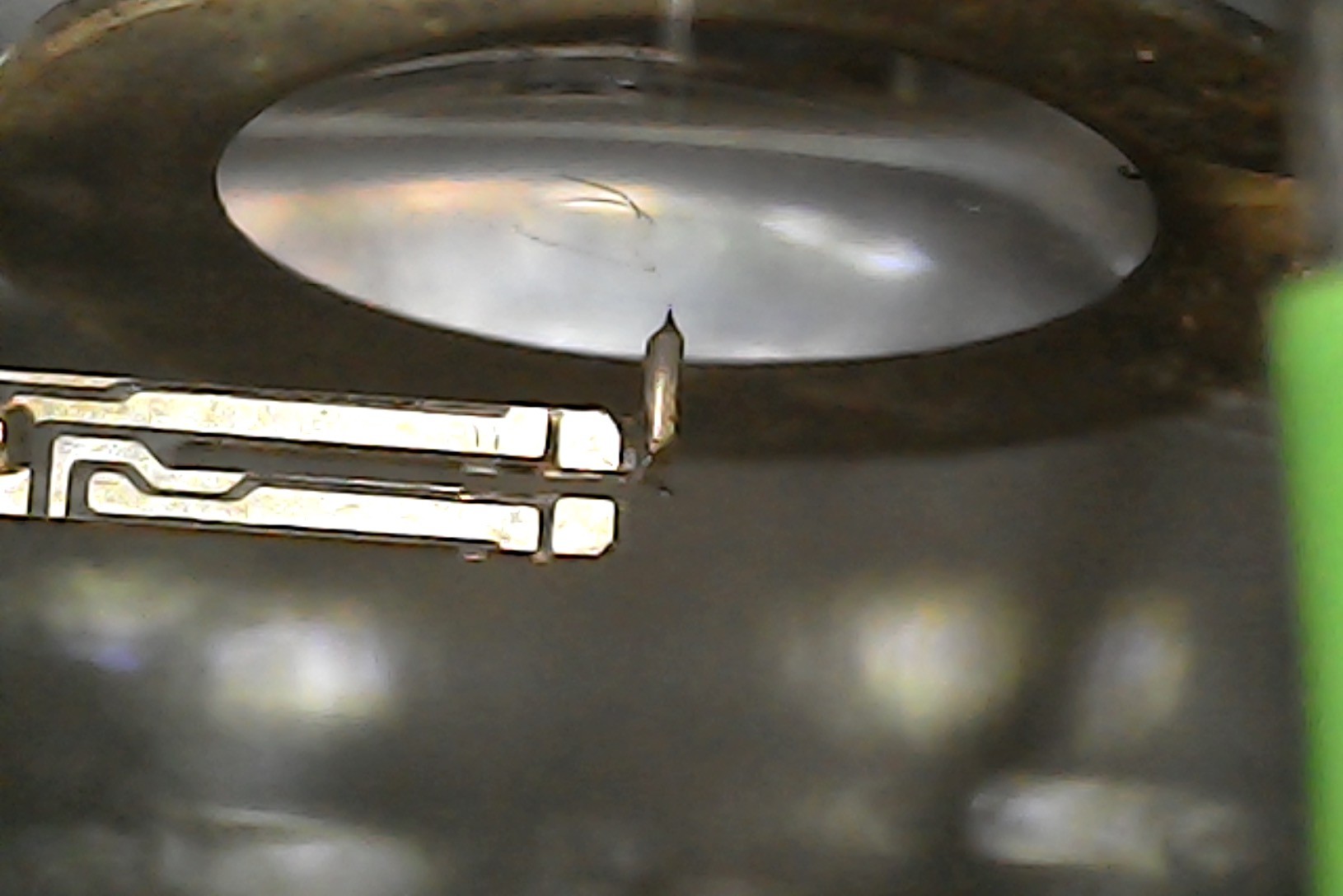

    I have now managed to get the tip making process working and it takes me about 20 min to make a tip from scratch. Usually with DIY or even professional AFMs, one would have to buy the cantilevers as is the case with the famous DVD optical pickup unit AFM by Prof. Edwin Hwu. With professional quartz tuning fork AFMs Akiyama tips are the standard but these cost around 80 dollars per tip. The tips I will outline here have a cost of cents in materials. The only thing needed are standard tuning forks and tungsten wire. A bag of 100 tuning forks can be had for a couple of dollars and 1-2 m of tungsten wire is around the same cost. I believe any thickness works and the thinner the better to prevent loading of the tuning fork and thus a decrease in its Q factor which will lead to worse sensitivity. This being said, I have used 250um because I had it laying around and it's easy to handle and it works great even the low Q factor tuning fork is sensitive enough. Therefore, this means the AFM is fully DIY now including the tips. Below is an example tip made using the method I will outline.

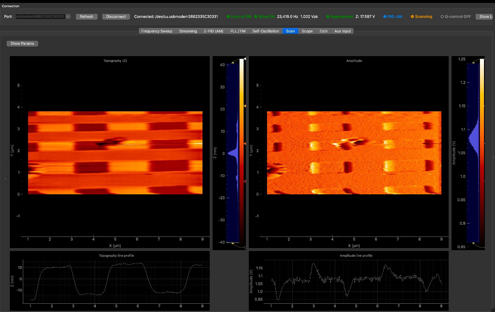

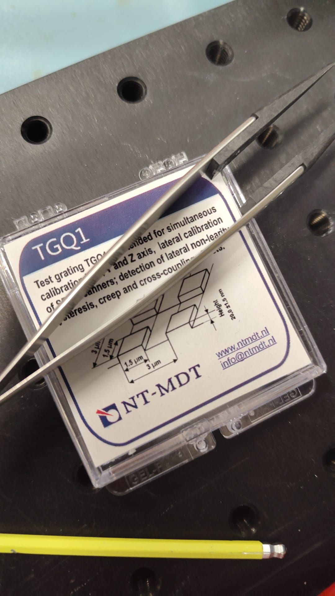

    Images taken with this tip loop very good. I have since implemented a scan that takes the forwards and backwards scans and separates them into separate images to more or less eliminate the hysteresis which was causing the previous comb line artefacts. Here is an example of a forward scan image of a 1.5 x 1.5 um and 20nm high square AFM calibration rating, the result looks very similar to our AFM in house 3D printed stage distortions aside. I repeat 20 nanometers!! This is a screenshot from my GUI also showing the amplitude image, I also have the pose image it's just not shown here. The phase gives you interesting information about surface properties due to dissipation do it can be thought of as some sort of friction due to viscoelastic effects (e.g. water layers on the surface). You can see the noise level is basically in the single nm level (I need to enclose the AFM to get better than this as I think I am limited by some environmental vibrations).
    AFM grid imaged here
    image of calibration grid with tip
    The setup looks like this. Black 3D printed flexure stage, um stage holding the tuning fork with the driving shielded black wires and this sits on top of a granite slab that sits on top of you guess it a bike inner tube for damping. the um stage is for moving the tip in x and y, and the z is motorised of the auto approach which is now also working great. the PCB is my control board and the start of the show it does the digital lockin, stage driving, tuning fork amplifying etc.
    current janky setup

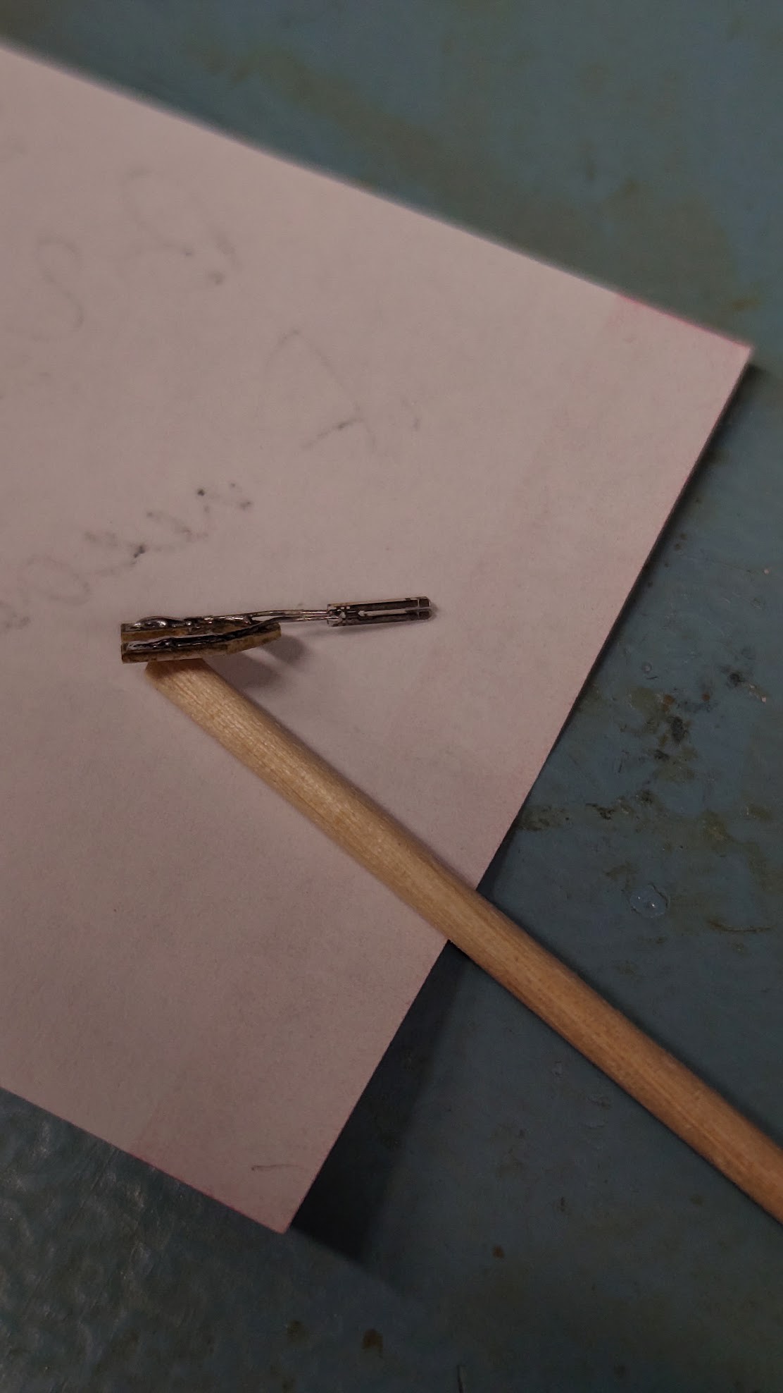

    Tip making process: For this one has to start by decamping a standard tuning fork 32768kHz resonator. The look like this
    10PCS 32.768 KHz 32768HZ Tuning Fork Watch Crystal 12.5PF 3mm x 8mm
    Vacuum encased off-the-shelf tuning forks
    These are easily recapped with some care. I take a pair of flat pliers then around where the wires are coming off, squeeze carefully until I hear a little crack, this is the resin for the vacuum encasing of the tuning forks. I then go around with the pliers until the resins is fully cracked and and then the tuning fork just pulls out. The tuning fork connections to the wires are very fragile when the tuning fork is out therefore I usually solder this to a little PCB I have but you can use any holder just make sure to do major handling while the tuning fork is encased to prevent breaking the connections, I learned this the hard way...The tuning forks then look like this soldered to a PCB to hold them
    Decapped tuning fork.
    Then comes the gluing of the wire to the tuning fork and the etching. For these I made this little tip making station. the tip making method is based on the mad city labs method https://www.youtube.com/watch?v=K_k5UsHlwN4. Note the foam under the mini scrap optics breadboard (also from the bins haha) This helps immensely...

    Now for the cool stuff. The images shown are from AFM calibration grids one has steps of 20nm which really require a decent AFM to see. I also tried to image a graphene device with some wires coming out. Bigger calibration grid is quite easy to see. Some examples of images are below
    This is the image below
    as you can see the forwards and backwards scans during the raster scan have different sizes (the backwards scan is stretched in comparison with the forwards one) I believe this is the piezo hysteresis in the stage. This is fixed by scanning in a single direction. That is, once you reach the end of the forwards scan, you lift the tip move it back reengage the PID and scan again, this unfortunately adds some time to the scan but fixes this issue more or less.
    New images I took are now with improved noise from shielding on the tuning fork wires leading to the transimpedance amplifier (TIA) and below you can see a 20nm step from the calibration grid with 20nm high 1.5um wide squares
    Here is an example of the 20nm step with improved noise. The previous steps looked like this:
    With the improved shielding on the tuning fork wires to the TIA the same 20nm step is much cleaner. I believe now I am limited by environmental vibrations due to my damping being a bike inner tube, to see atomic layers, I likely need and enclosure and the setup suspended by springs with eddy current damping from magnets similar to Dan Berard's STM. but I would say this is pretty good already for most applications like looking at cells or DNA.
