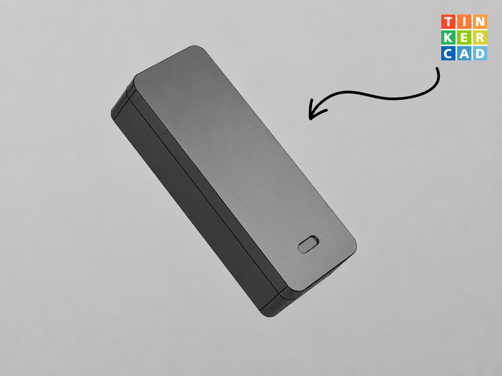

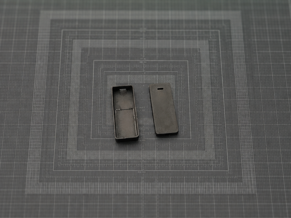

    We wanted the enclosure to be cute, simple, and minimal, with a clean form that matched the character of the project. We designed it from scratch in ThinkerCAD, keeping the enclosure compact while making sure there was enough space for everything.
    After finalizing the CAD model, we 3D printed the enclosure using black PLA filament on our Bambu Lab P2S 3D printer. The result is a clean, compact enclosure that keeps the electronics protected while giving Heat Sentinel the simple and polished look we were aiming for.

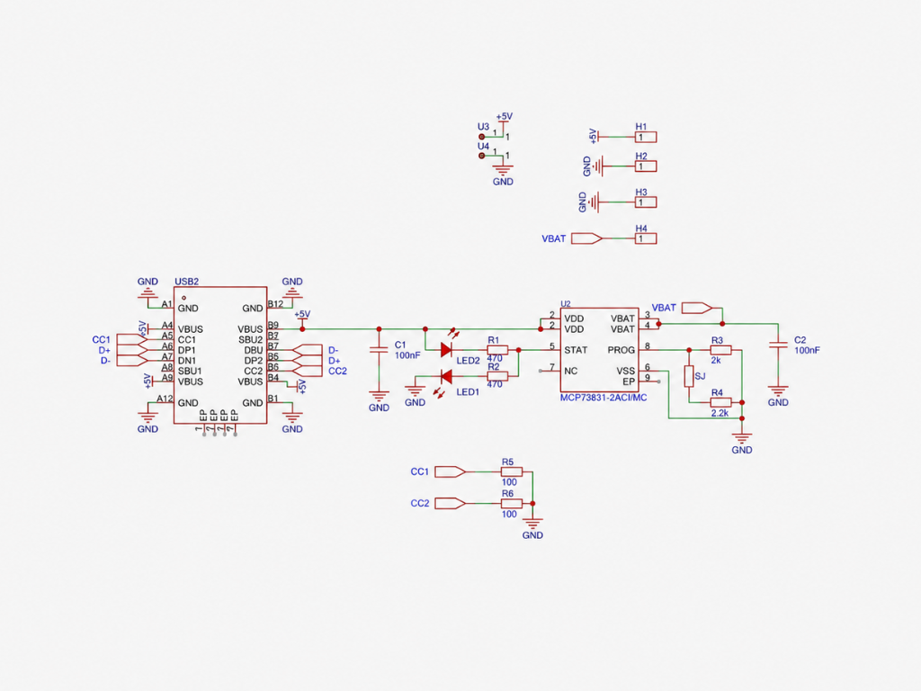

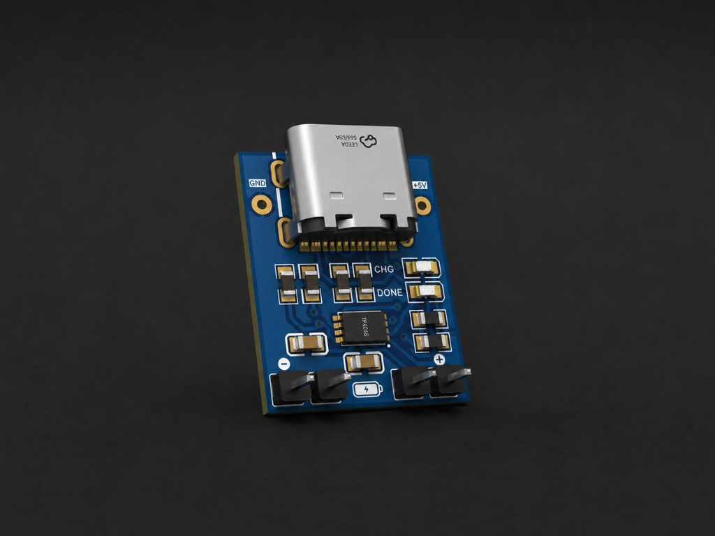

    The charger was designed from scratch in KiCAD, with an MCP73831 Li-ion charge controller. We also included charge-status LEDs and the required battery connections and supporting components.
    The focus was to keep the circuit small, clean, and reliable while making it easy to integrate directly into the Heat Sentinel enclosure. The final schematic gives us a dedicated charging solution designed specifically for the project.

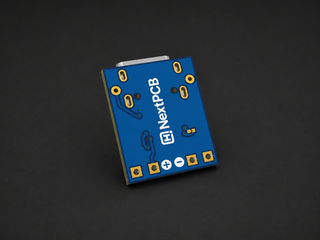

    With the design finalized, we sent the charger PCB to NextPCB for manufacturing and assembly.
    A big shout-out to NextPCB for supporting Heat Sentinel. The PCB fabrication and assembly quality was excellent, and the overall finish was genuinely impressive—especially considering the price point.
