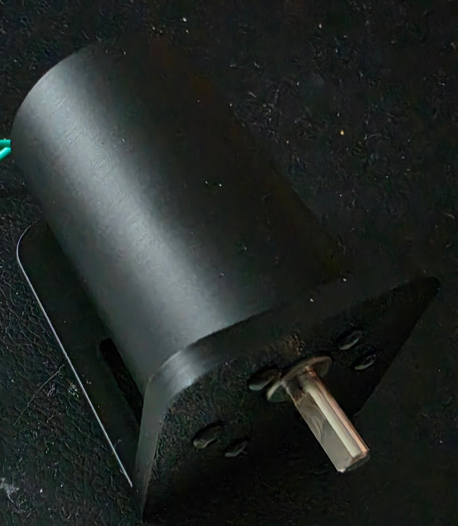

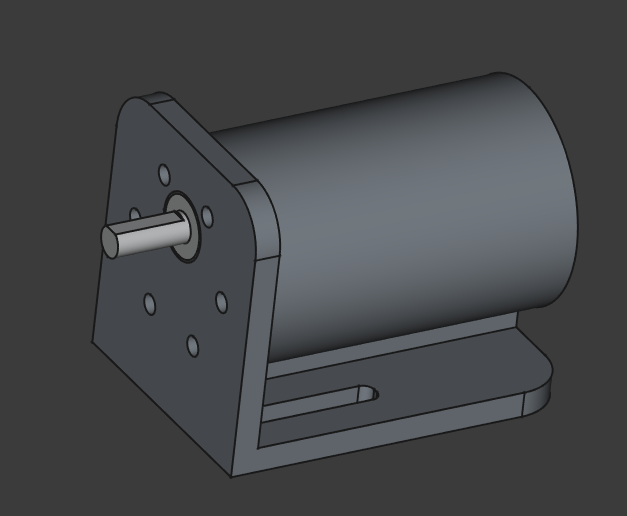

    I have started to design and test print the motor holders for the main body. After testing a few prints and forgetting the screw size is M3, I managed to come up with a nice design as shown below. Thankfully I was able to find a model for the XD-37GB520 motors from grabcad.
    The result came out really well in the end. Using M3x12 screws, the motor fits really snug inside the holder.
    The idea of the bracket was to give me an idea of how far the wheels need to come out to make contact with the sphere. One thing I will be looking at is angling the wheels if the contact is not great.

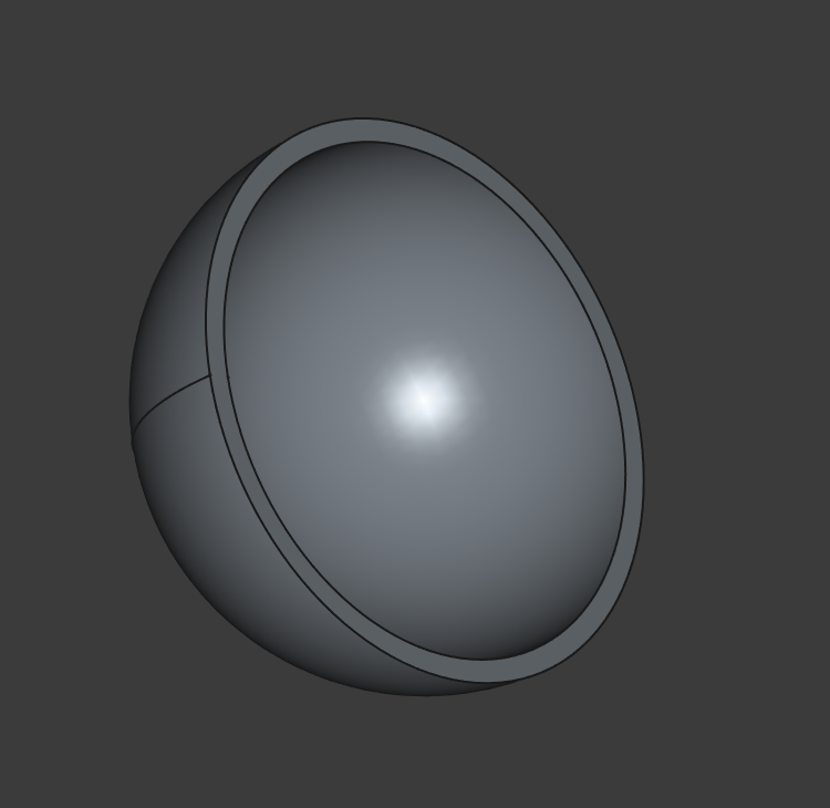

    The main sphere pieces I have started to print for test fitting. One thing I might need to invest in is a bigger nozzle due to the print times being silly for the A1..19h at .4mm is not great for testing things fit.
    I shall be designing the main bracket unit next to hold all the electronics e.g. ESP32+Motor Controller+Battery components.

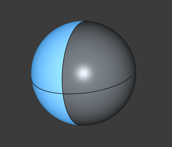

    The next step was to start working on getting the sphere started that will house the RC frame to move the ball. I went with a 220mm size sphere to avoid not being able to print this on my Bambu A1.
    Next steps is to get a few holes added around the ball to be able to mount them together. Once that is done, I shall be moving onto the frame that will house the motors, controller, battery, ESP32 etc.
