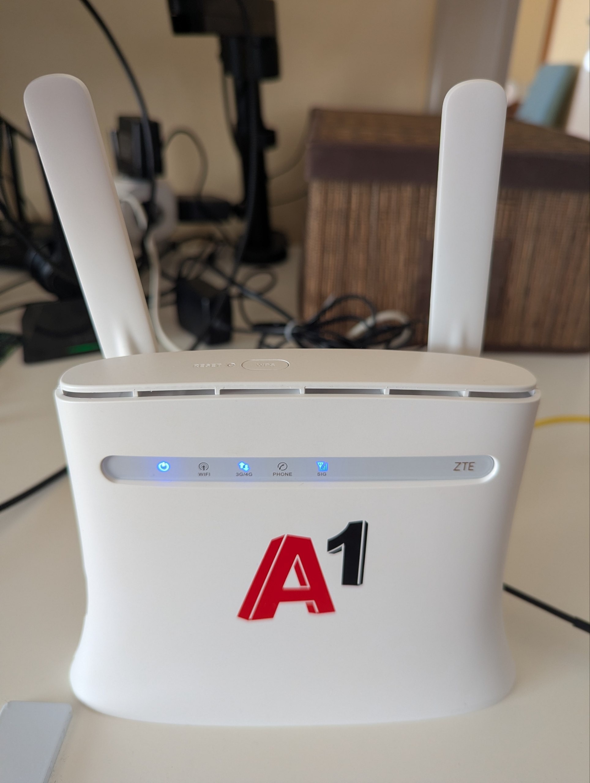

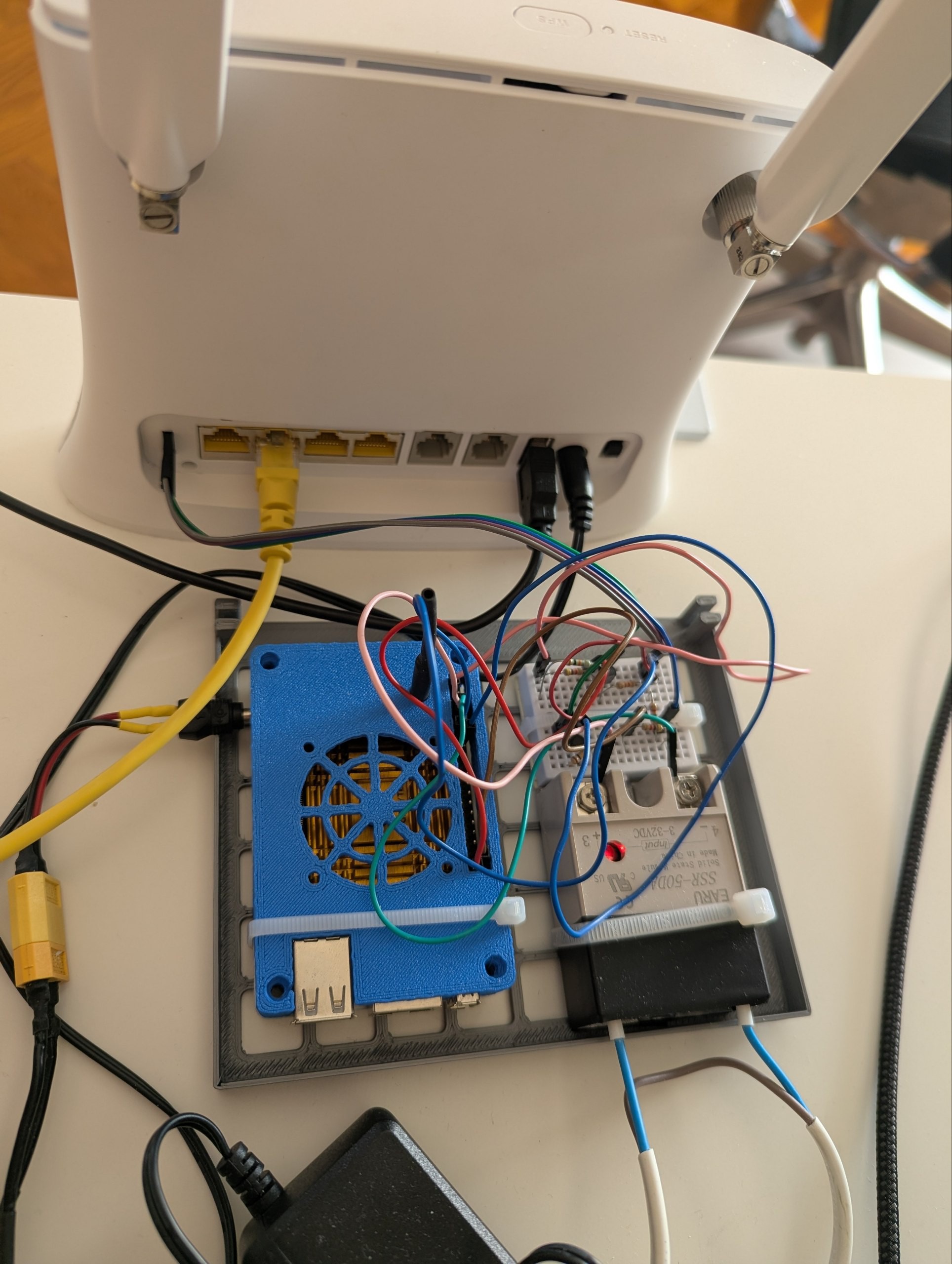

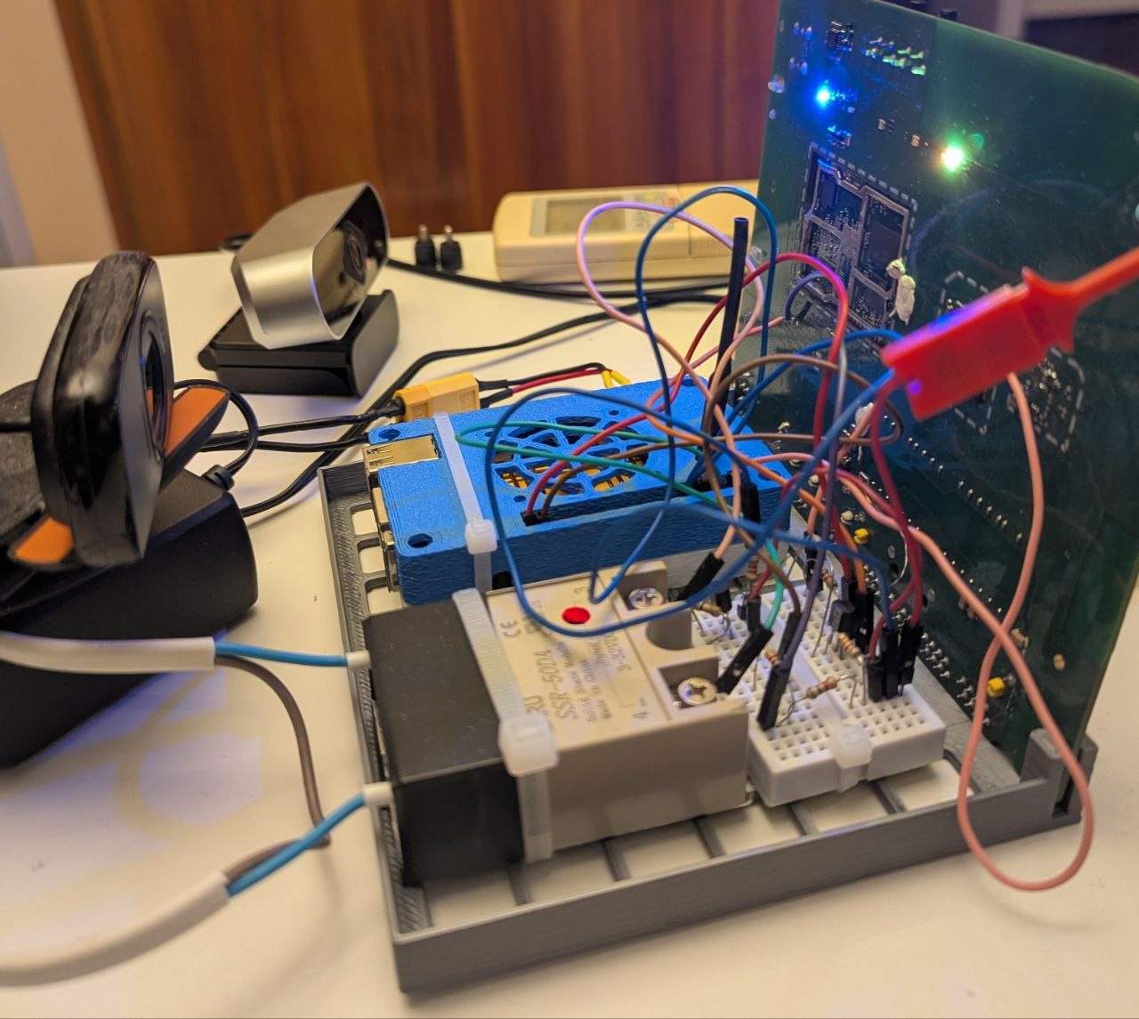

Most coding agents stop at `git commit`. This one has a power switch, an EDL strap, and a UART. Porting OpenWrt to a new target is normally a stubborn human-in-the-loop process: change the kernel or device tree, build an image, put the target into recovery mode, flash it, power-cycle it, watch the serial console, identify the next failure, and repeat. The human sitting at the bench becomes part of the toolchain. This project tries to compile that human out. The target is an LTE router built around a platform with no existing OpenWrt port. I soldered wires to its serial console and EDL pads and routed them to an Orange Pi. Another GPIO controls a solid-state relay that switches power to the router. Together, these connections form a small hardware-in-the-loop lab that a coding agent can operate directly.
The test bench was built from what I had in the cupboard: an old Orange Pi PC Plus running an ancient Ubuntu, a Chinese SSR, and a level shifter using a single NPN transistor (the modem's UART is 1.8 V and the Orange Pi's GPIOs are 3.3 V). I also added a transistor key to short the EDL testpad to the common ground. To hold everything together, I 3D-printed a simple chassis and secured everything with nylon ties.

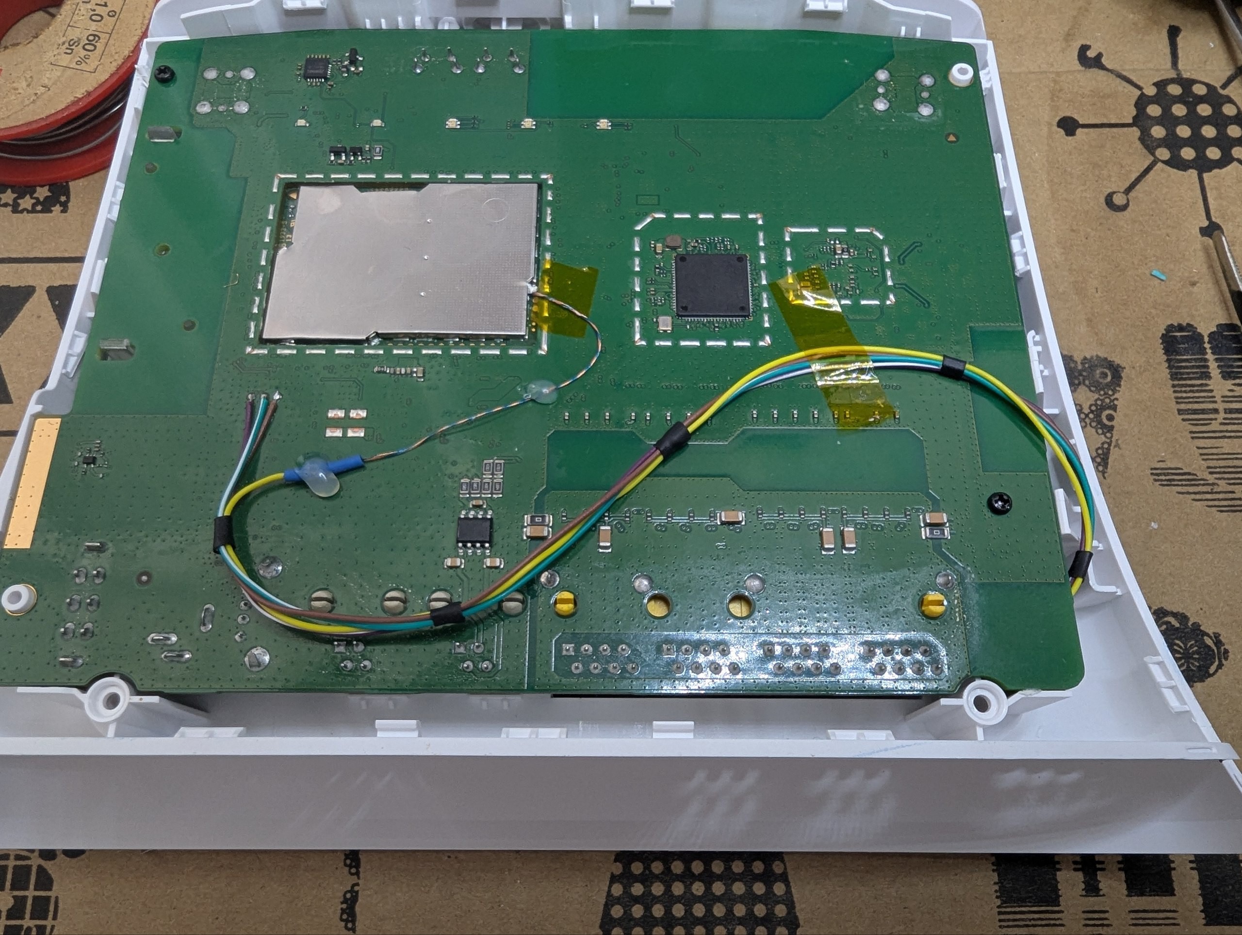

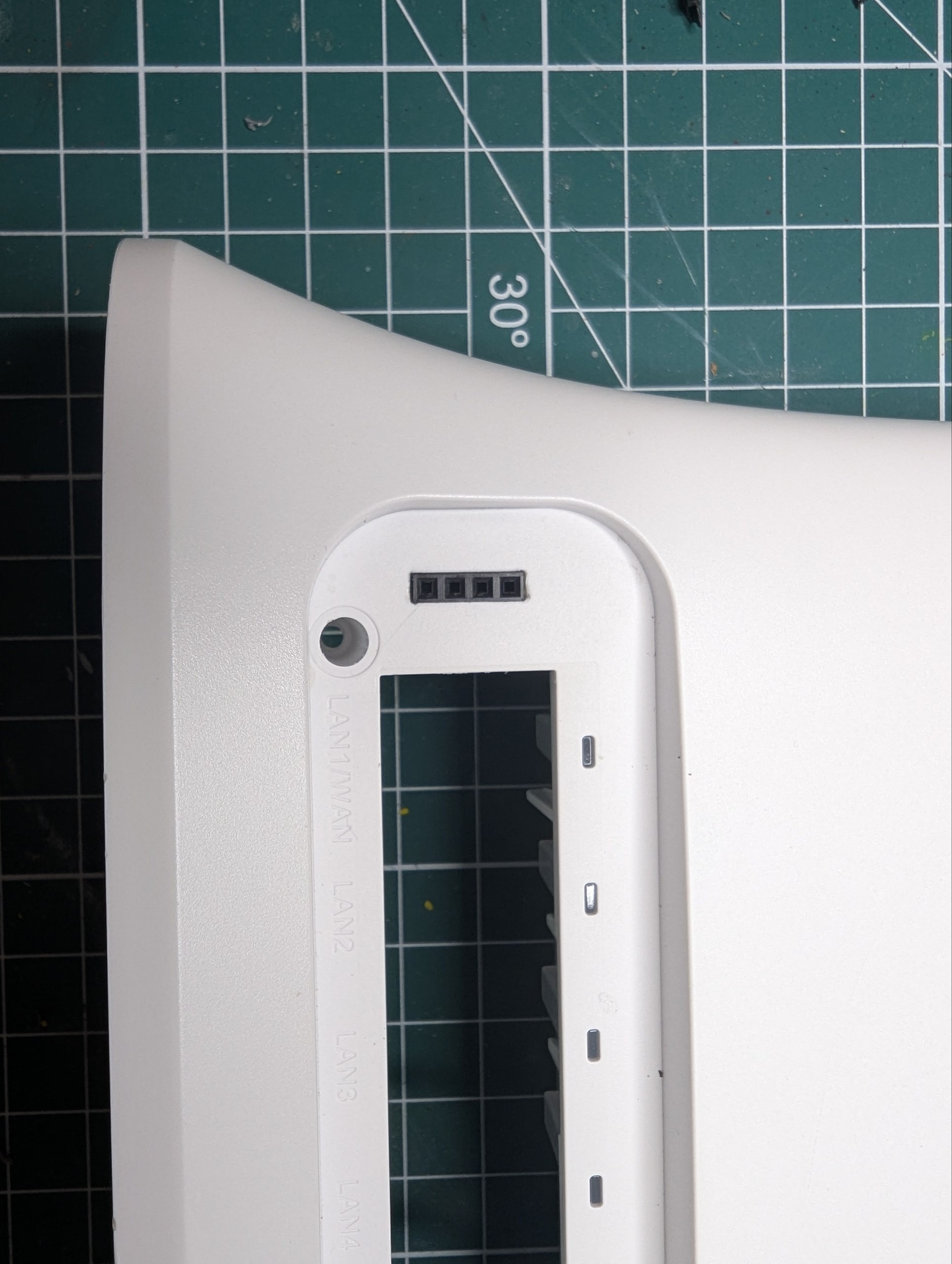

    It's time for me to do something Sol cannot do by herself (yet?): return the router PCB to its housing. My interest in this project isn't purely academic: I'd like to use this device as a backup channel to access my home network when I'm away and the main channel is down. The "PCB on the table" is good for the initial R&D phase, but not for something that is supposed to work unattended. Still, I wanted to keep development moving.
    So I sent Sol to write a wiki page about the device on the OpenWrt website (and she did quite well!) and started some hardware work in the meantime.
    I found an unoccupied space on the back panel and laser-cut a hole for a 4-pin DuPont connector. Then I wired GND, UART, and EDL strap to the connector and solemnly reassembled the housing. The device is now ready to be used is intended, but for now it's still strapped to its harness, and the research goes on.

    During last night's autonomous session, Sol ate up her weekly allowance of tokens. I hoped she'd be sleeping for some time, giving me some rest, but inexorable Tibo reset the limits out of the blue, and here we go again. We're waiting for the base PR to be accepted, and we haven't much to do with the main functionality, so it's time for fun stuff: the LEDs.
    "Okay, Sol, let's do those LEDs we have on the roadmap. I see five LEDs on the PCB; their function and behavior are described on a user manual page I photographed, you can find it in `photo/led-doc.jpg`. Now some big news, Sol: you've got eyes. I connected a web camera to the host you're running on, it is directed at the PCB, toward the LED side. You can do shots with `ffmpeg -f v4l2 -i /dev/video0 -frames:v 1 shot.jpg`.  Update the autonomous lab protocol with that. Then calibrate: take a shot with the modem powered off, then turn it on, and you'll see the power LED that seems hardwired to the power rail. Then boot the stock firmware and try to figure out the LED control and to implement its support in our DTS and firmware."
    The LEDs are blinking right now, sometimes exposing colors I've never seen on this router before. I wonder what comes next.

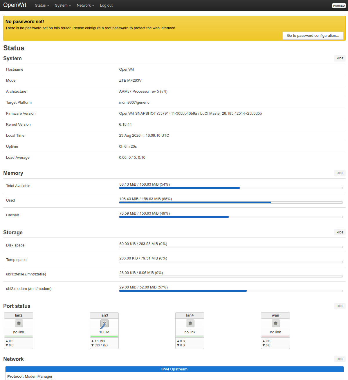

  • Say hello to LuCI!
    Someone Unknown • 08/23/2026 at 18:18 • 0 comments
    We've got LuCI up and running! So now we have a fully functional web UI with LAN/WLAN/WWAN working out of the box in a very user-friendly manner.
