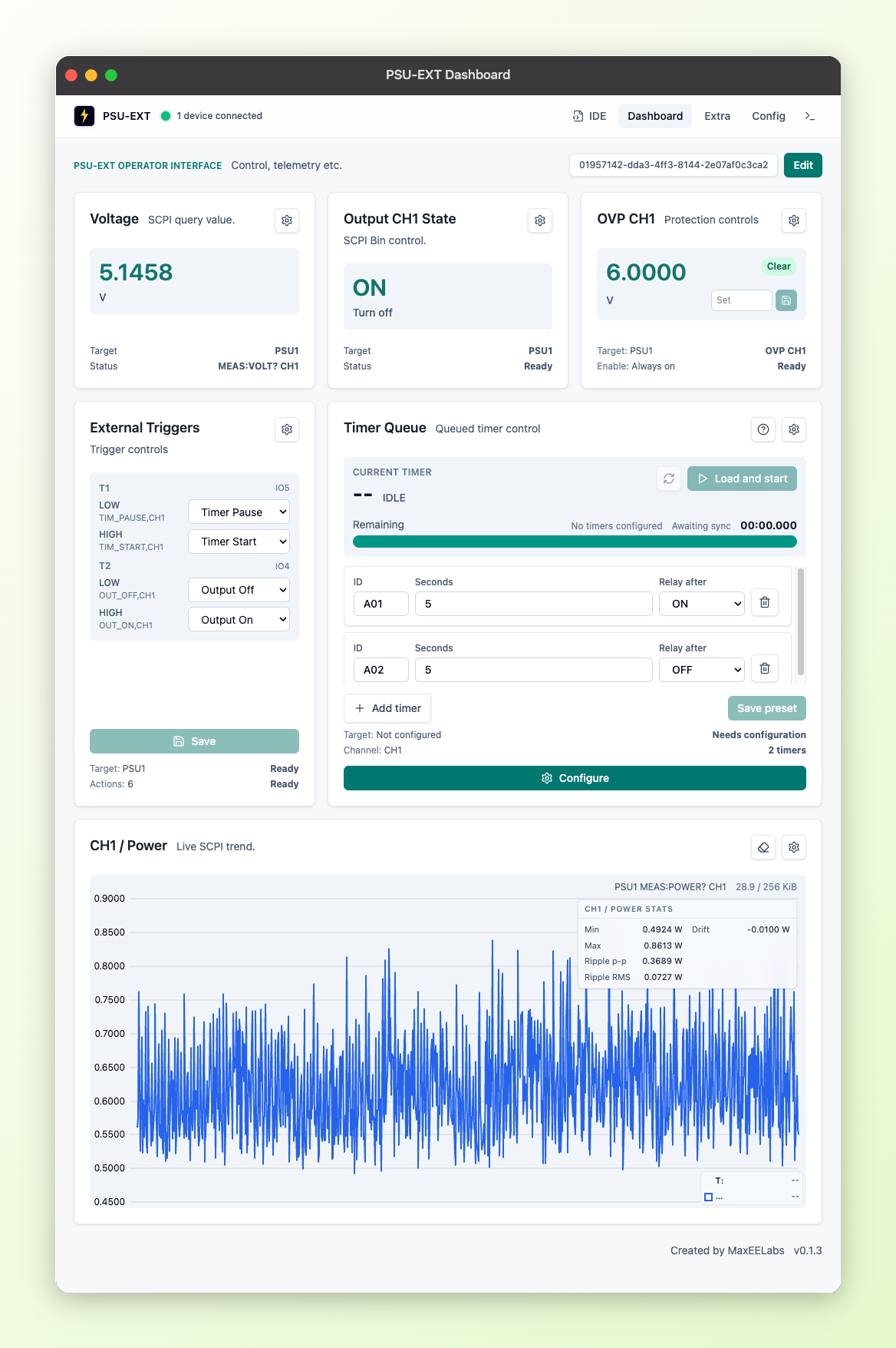

Overview
PSU-EXT sits inline between a bench power supply and whatever it's powering. It measures voltage, current, and power, switches the output on and off through a relay, and speaks SCPI — the command language bench instruments use — over both USB and Wi-Fi/TCP.

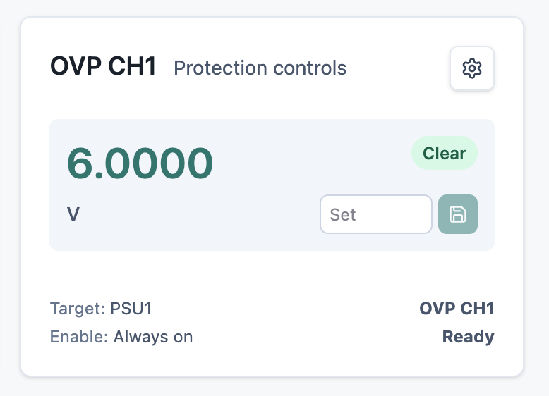

A browser dashboard sits on top: live telemetry widgets, OVP/OCP protection controls, a raw SCPI console, and a JavaScript scripting IDE for running sandboxed automation sequences against the device. Hardware, firmware, and the dashboard's backend and frontend are all in the open.

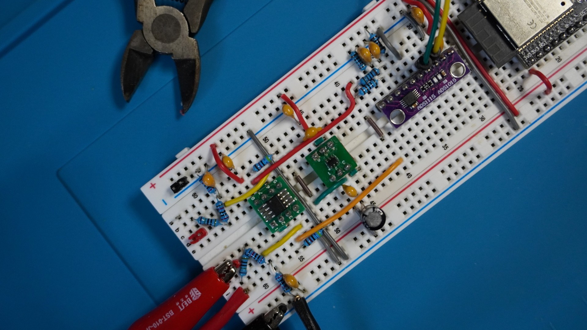

✔  April 2026 — First prototype on breadboard

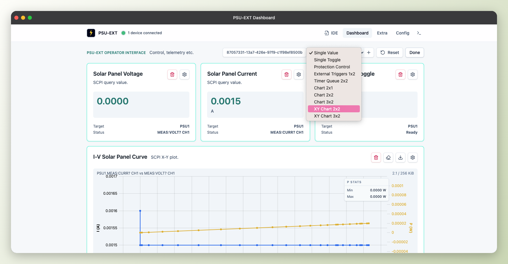

    The New X-Y Chart widget
    X-Y Chart in the catalog

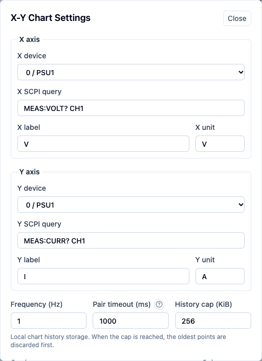

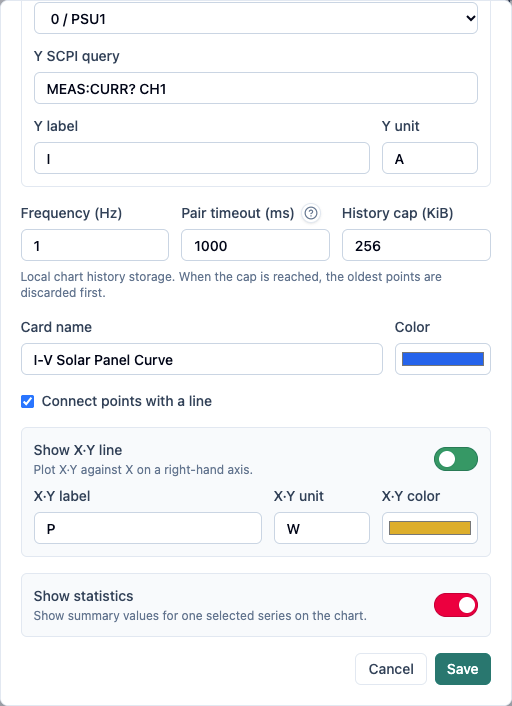

    The X-Y chart sits in the dashboard catalog next to the time-series Chart, as a 2x2 or 3x2 card. The main things to configure:
    • X and Y axes:  each gets its own device, SCPI query, label, and unit, so the two can even come from different connected devices.
    • X·Y line: an optional second trace that plots X × Y against the same X on its own right-hand axis. With voltage and current, that's power.
    • Sampling: a shared poll frequency (0.1 Hz to 100 Hz), a pair timeout for matching each X with its Y, and a maximum point count.
    • On the card:  Clear, Export PNG, and drag-to-zoom (double-click to reset). Points live in the browser and are gone after a reload.
    Setting it up for an I-V curve
    • X: "MEAS:VOLT? CH1", Voltage, V.
    • Y: "MEAS:CURR? CH1", Current, A.
    • Sampling: 1 Hz frequency and a 1,000 ms pair timeout, both the defaults. One point per second is plenty for a hand-turned sweep.
    • Show X·Y line: enabled and labeled for Power, W. Its peak is the panel's maximum power point (MPP).
    X-Y Chart Widget Settings 1
    X-Y Chart Widget Settings 2

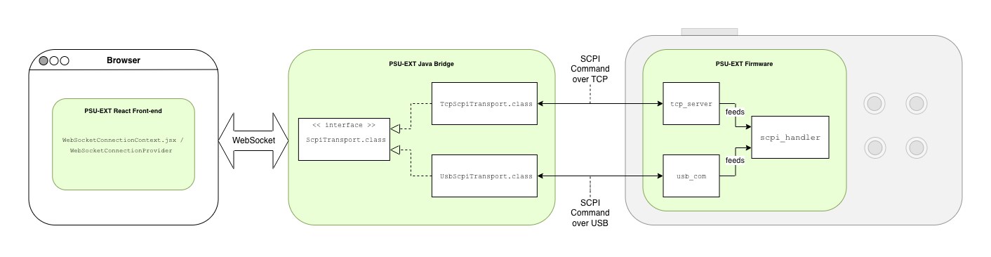

    Overview
    Our dashboard, backend, and firmware all speak SCPI, the standard ASCII command language for test-and-measurement instruments. Two transports and one WebSocket bridge carry that command language between browser and device — nothing here invents a protocol of its own.
    That choice matters in practice. One shared command language means every dashboard widget and script talks to PSU-EXT the same way, regardless of how it's connected. Exposing that language over two transports instead of one means a USB-tethered setup on a workbench and a Wi-Fi-only deployment across the room run on identical firmware, with nothing to swap out between them.
    One query, one bridge, two possible transports, one firmware dispatcher.

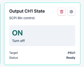

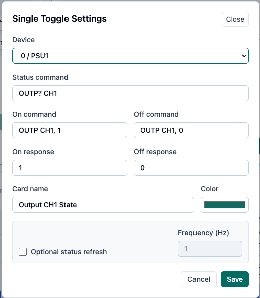

    Output
    `OUTP`)
    "OUTP CH1,1" energizes the output relay (after clearing latched protection and checking the input-voltage condition);
    "OUTP? CH1" reads the relay state back.

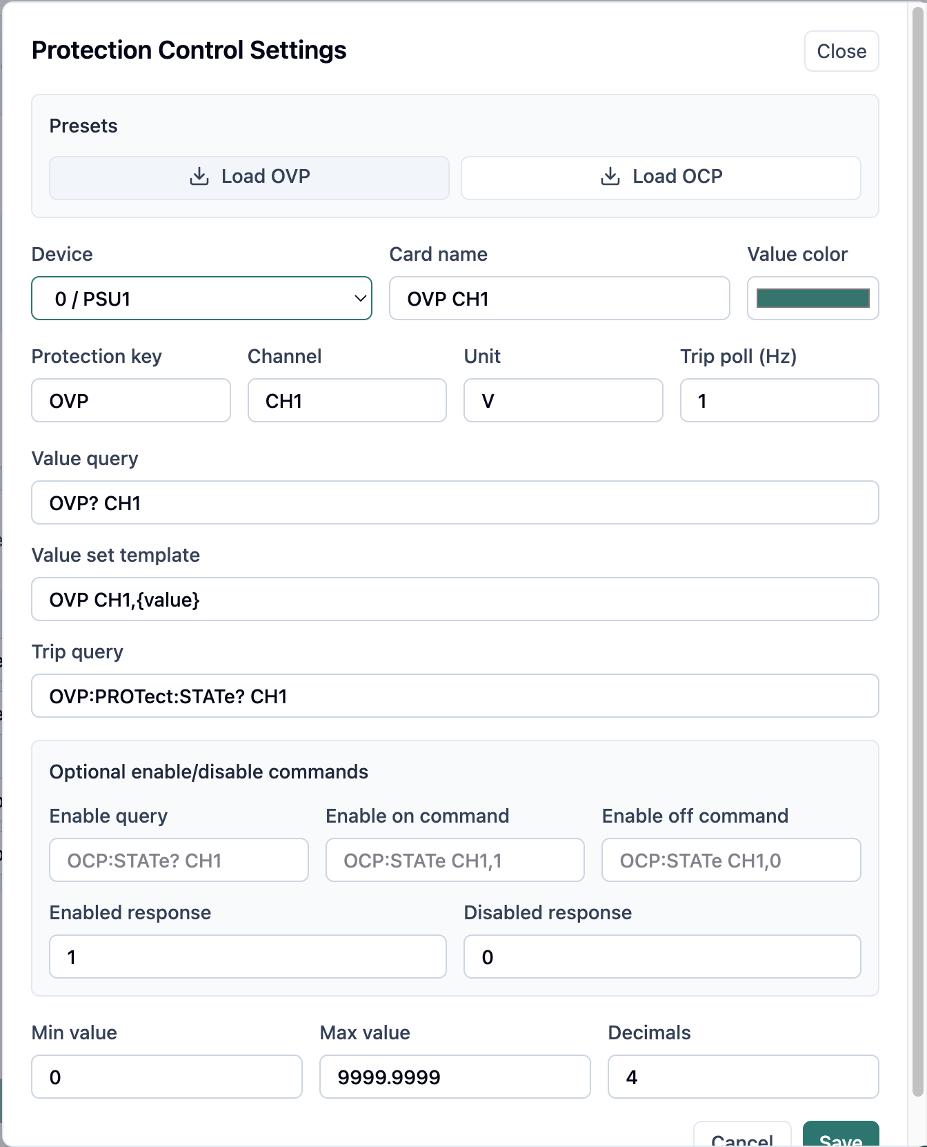

    Protection
    `OVP`/`OCP`)
    "OVP CH1,<value>" sets the over-voltage threshold;
    "RESET:PROTect CH1" clears a latched protection trip

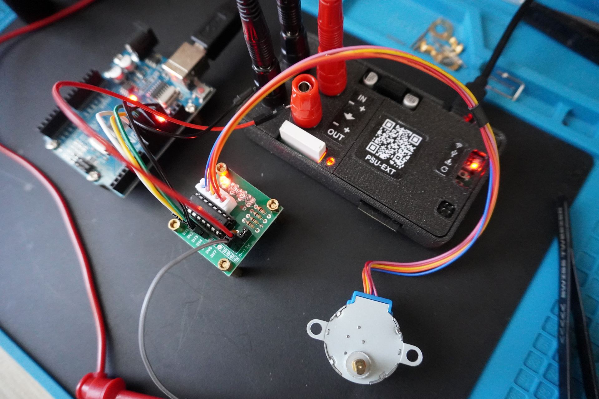

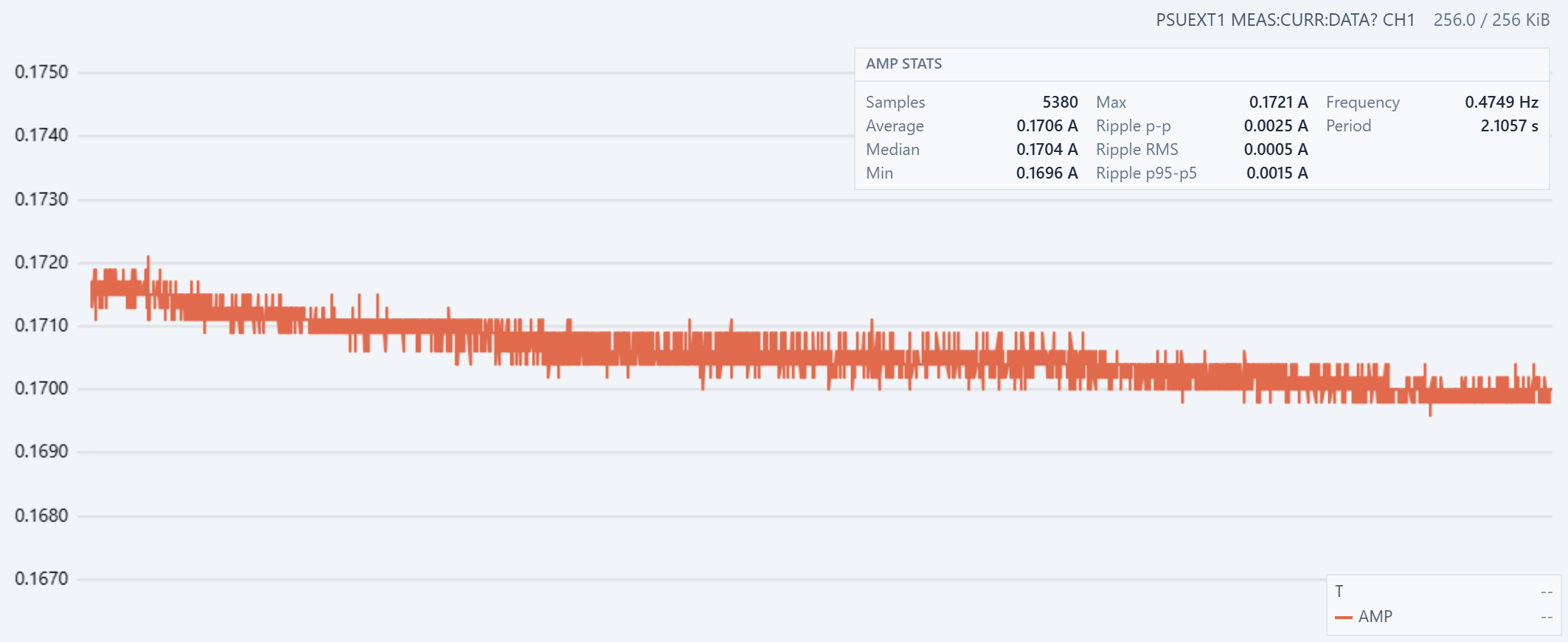

  • Step Motor Current and Power Profiling
    Maxim Pavlov • 09/02/2026 at 04:50 • 0 comments
    Driving a stepper motor is often one of the first practical electronics experiments. The 28BYJ-48 motor and its ULN2003 driver board are inexpensive, widely available, and simple to control from an Arduino. Paul Gallagher's 28BYJ-48 project in LittleArduinoProjects provides a useful introduction to the motor, the driver board, the coil sequence, and the required connections.
    This article examines the same circuit from a power perspective. We use PSU-EXT to measure its current and power consumption in different operating modes, including holding with one or two energized coils and running the motor at different step rates.

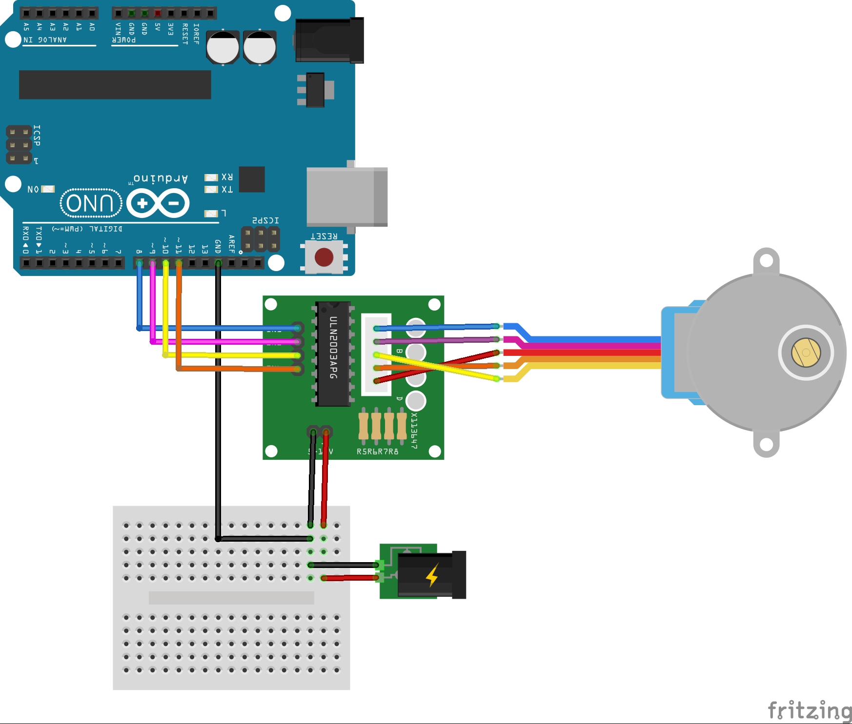

    Setup
    Figure 1. Basic 28BYJ-48 and ULN2003 wiring. Copyright © Paul Gallagher. Image from LittleArduinoProjects, used under the MIT License
    The Arduino ground is connected to the ULN2003 module ground, as shown in Figure 1. The Arduino and PSU-EXT are each powered over USB. The motor receives 5 V from the bench power supply through PSU-EXT.
    A Rigol DM858E digital multimeter is connected in series with the motor circuit. It provides an independent current measurement for comparison with the PSU-EXT reading. The complete current path is the bench power supply, PSU-EXT, ULN2003 driver, 28BYJ-48 motor, DM858E current input, PSU-EXT return, and bench power supply return.

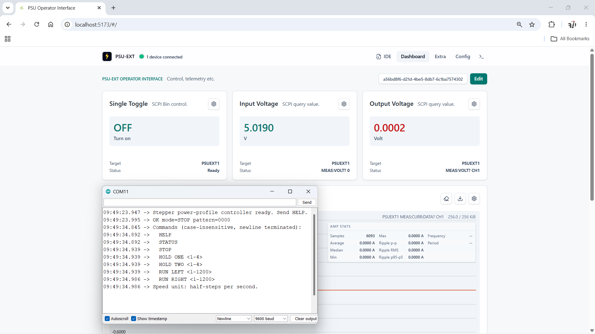

    Arduino Control Sketch
    The Arduino sketch drives the motor with an eight-state half-step sequence and accepts newline-terminated commands over a 9600-baud serial connection. This lets us select a repeatable coil state or running speed while recording the electrical measurements.
    CommandFunction
    HELPLists the available commands.
    STATUSReports the current mode, coil pattern, direction, and speed.
    STOPDe-energizes all four driver inputs.
    HOLD ONE <1-4>Holds one of four positions with one coil energized.
    HOLD TWO <1-4>Holds one of four positions with two adjacent coils energized.
    RUN LEFT <1-1200>Advances through the sequence at 1 to 1200 half-steps per second.
    RUN RIGHT <1-1200>Traverses the sequence in reverse at 1 to 1200 half-steps per second.
    The running range starts at one half-step per second because zero represents the stopped state and cannot be used to calculate a step interval. The upper limit of 1200 half-steps per second was selected as an experimental ceiling. A common 5 V 28BYJ-48 datasheet specifies a no-load starting frequency above 600 Hz and a no-load running frequency above 1000 Hz. Extending the test range to 1200 half-steps per second lets us examine the motor near and beyond that documented region. It is not a guaranteed operating speed, and the sketch applies the requested speed without an acceleration ramp. The observed shaft direction depends on the motor wiring and the side from which it is viewed.
    Testing Hold Modes: One or Two Coils
    The sketch provides one-coil and two-coil hold modes. Each mode has four selectable electrical positions. These numbers identify positions in the drive sequence, not absolute positions of the geared output shaft.
    CommandIN1IN2IN3IN4Energized coils
    HOLD ONE 110001
    HOLD ONE 201001
    HOLD ONE 300101
    HOLD ONE 400011
    HOLD TWO 111002
    HOLD TWO 201102
    HOLD TWO 300112
    HOLD TWO 410012
    One-coil hold provides the lower-power reference. Two-coil hold energizes two windings at the same time and should draw more current while providing greater holding torque. Measuring all four positions also shows any differences between the individual windings and driver channels.
    HOLD ONE 1
    The
    HOLD ONE 1
    command keeps the first ULN2003 input active and energizes one motor winding continuously. The motor remains stationary while the energized winding produces holding torque.
    Figure 2. PSU-EXT current measurement during HOLD ONE 1. The recorded minimum is 0.1696 A, the maximum is 0.1721 A, and the average is 0.1706 A.
    The full recorded span is 2.5 mA, or about 1.45% of the maximum. The sustained current level falls by less than this because the minimum and maximum include...

    The Tour
    From there, here's where the dashboard itself stands today: a three-column grid built from a catalog of six widget types:
    • Single Value (displays a live SCPI reading);
    • Single Toggle (switches something on or off using SCPI commands);
    • Protection Control (watches a threshold and flags whether it's tripped);
    • External Triggers (hardware input pins to SCPI actions);
    • Timer Queue (runs a queue of timed relay actions);
    • Chart (plots SCPI query over time)
    PSU-EXT Dashboard WIth All Types of Widgets

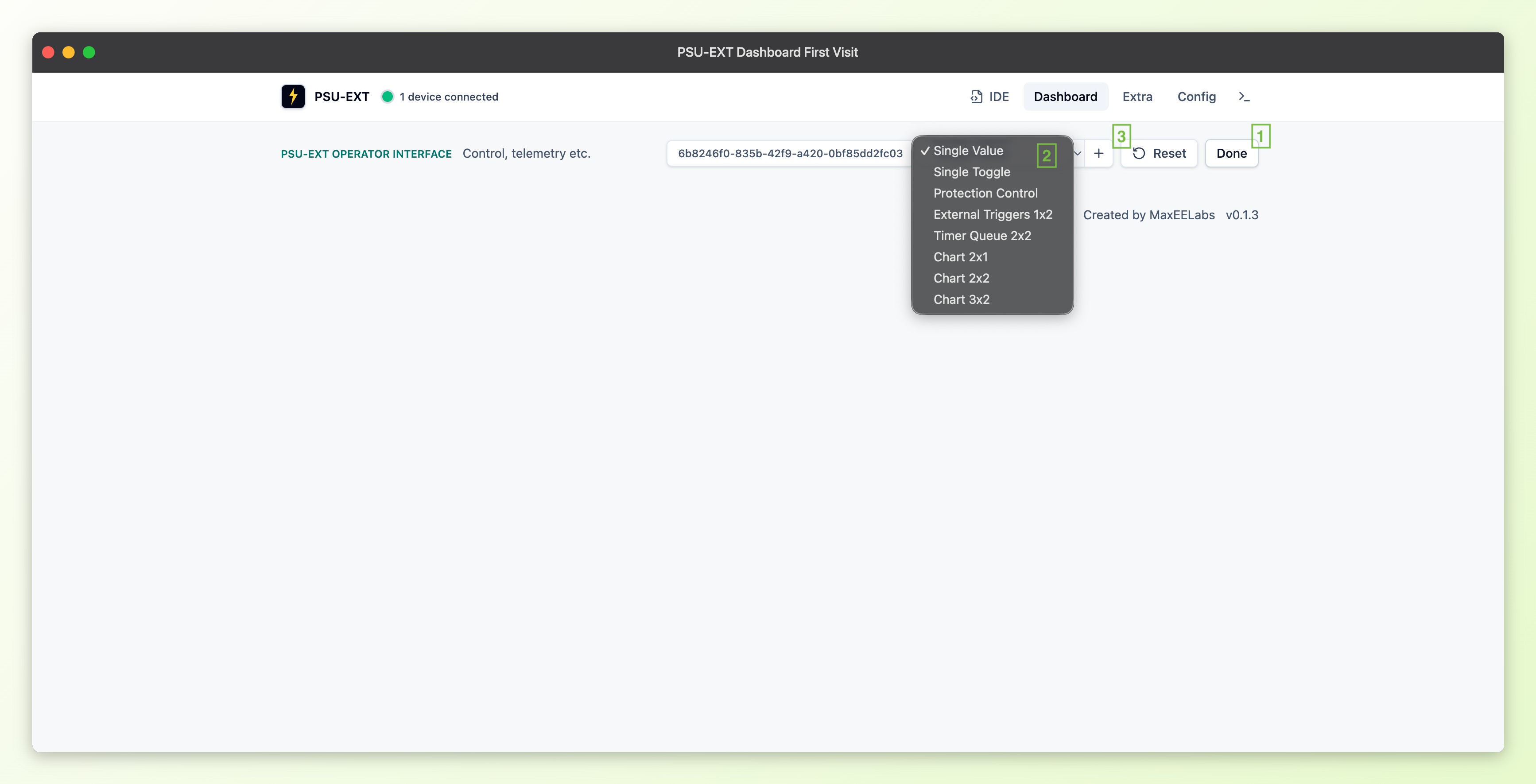

    Getting the Grid Ready to Look Around
    A toolbar "Edit"/"Done" (1) button unlocks dragging, deleting, and adding widgets. The Add widget catalog (2) lists eight entries mapped to the six widget types (three of those eight are the chart's fixed sizes). "Reset" (3) restores the default layout
    Whatever layout you build persists locally in the browser.
    PSU-EXT Dashboard First Visit
    One fact applies to every widget type before we tour them individually: each widget picks its own target device independently, so a single dashboard isn't locked to one PSU-EXT unit. You can mix cards pointed at different connected devices on the same grid.

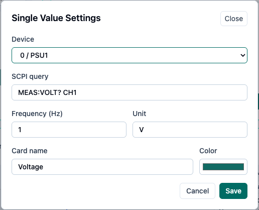

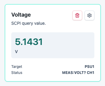

    Single Value and Single Toggle are the two simplest widgets on the grid, both sized 1x1.
    Single Value is a read-only display of one cached SCPI query result: a number plus a unit label, for example "5.1431 / V".
    Single Value Widget
    Single Value Widget
    Single Value Widget Settings
    Single Toggle is a button that turns something ON or OFF — enabling a channel's output, say — and shows which state it's currently in: it checks a SCPI status query to know whether the thing it controls is ON or OFF right now, and clicking it sends one SCPI command for ON and a different one for OFF.
    Single Toggle Widget
    Single Toggle Widget Settings
    Protection Control
    Protection Control is a 1x1 widget for one threshold — a voltage or current limit, set in an editable field with a Save button next to it. The PSU-EXT decides when that threshold's been crossed; the widget polls the device's reported trip state and shows it as a Tripped/Clear badge.
    Each widget instance is single-purpose: it's tied to one protection key and one SCPI query/set-command pair. Watching OVP (over-voltage protection) and OCP (over-current protection) on the same channel takes two separate widget instances on the grid, not one widget with two thresholds.
    Protection Control Widget
    Protection Control Widget Settings

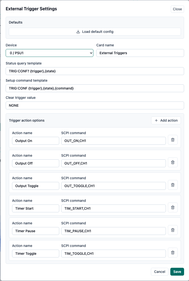

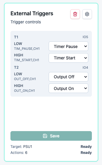

    External Triggers: Reading Hardware Inputs Into SCPI Actions
    External Triggers is a 1x2 widget that reads two physical trigger inputs  placed on PSU-EXT device — T1 on IO5 and T2 on IO4 — into SCPI actions. Each input has a LOW state slot and a HIGH state slot, four slots total, and each slot picks an action from a configurable list (defaults include Output On/Off/Toggle and Timer Start/Pause/Toggle) or None.
    On the board itself, T1 and T2 are broken out at connector J4: a 4-pin (2x2), 2.54 mm-pitch header, silkscreened "T1" and "T2," so the two inputs are easy to find by eye.
    External Trigger Widget
    External Trigger Widget Settings

    What PSU-EXT Is: One Module, Firmware, and a Dashboard
    Concretely, here's where that thinking has landed so far. PSU-EXT sits inline between a bench power supply and a load, measures voltage, current, and power, and controls the output path with a relay. That's the current physical shape the five points above have taken.
    "PSU-EXT" isn't just that board, though — it's three pieces that work together, each its own repo:
    - Hardware — the module itself
    - Firmware  — runs on the module
    - Software  — the companion stack that talks to the firmware over USB or the network
    Separate repos, one product, moving in parallel.
