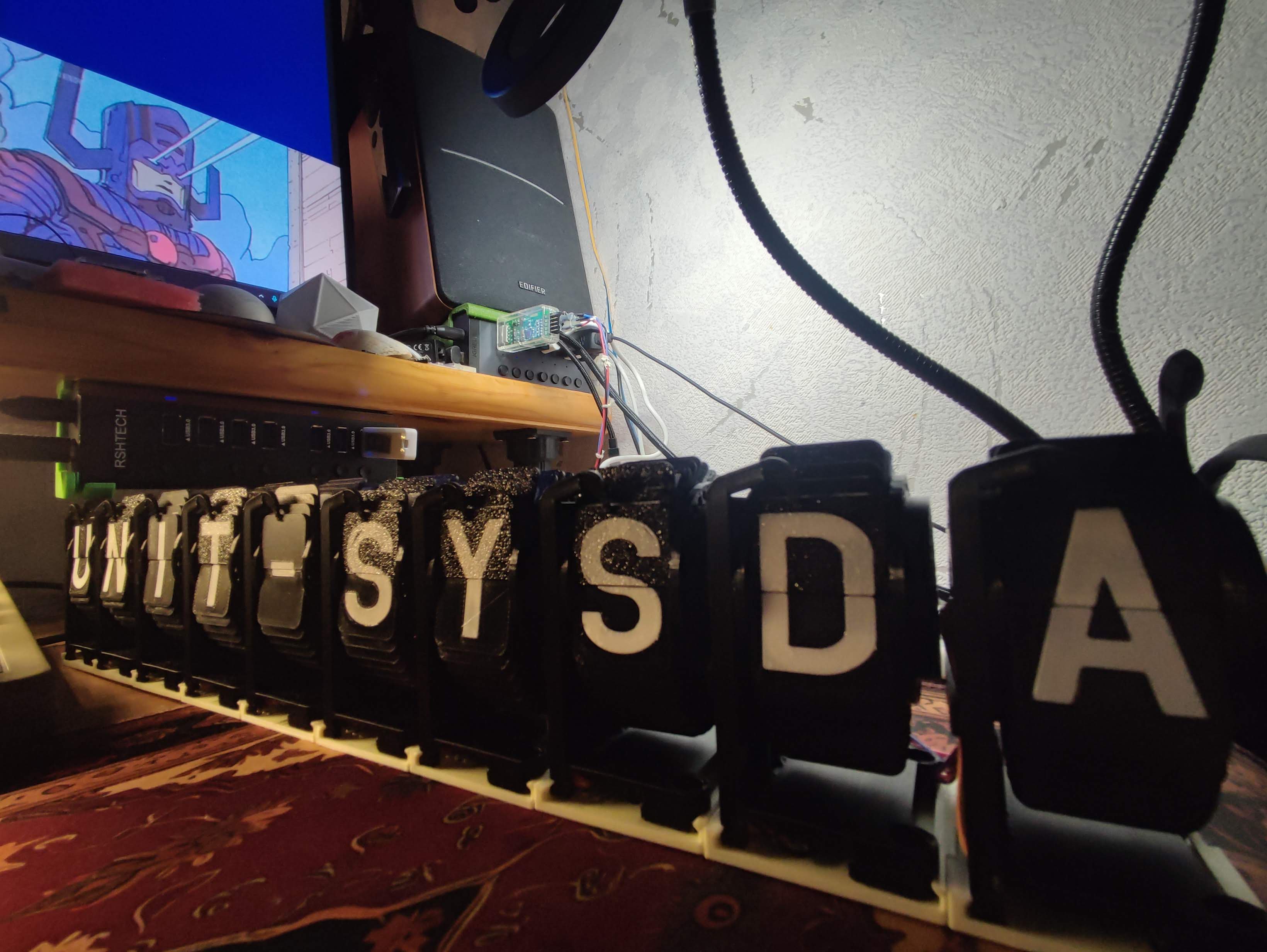

    Split flaps make for a pretty sight so here's a video.
    This pretty much wraps the project. Maybe I can make small improvements regarding reliability or put it in a nice box, but nothing revolutionary is going to happen to it at this point.

  • 10 units
    svofski • 09/03/2026 at 22:57 • 0 comments
    Finished the last 4 units tonight, making it 10 units total.
    I guess that's it. Definitely do not want to build more.
    Going one by one with 10 characters is painfully slow so I tried to implement power budgeting. 3 at once for homing, 2 for typing. Nice when it works, but less reliable than displaying one character at a time. Clearly either there is not enough juice, or there is some cross-talk. FWIW it could be even mechanical cross-talk.

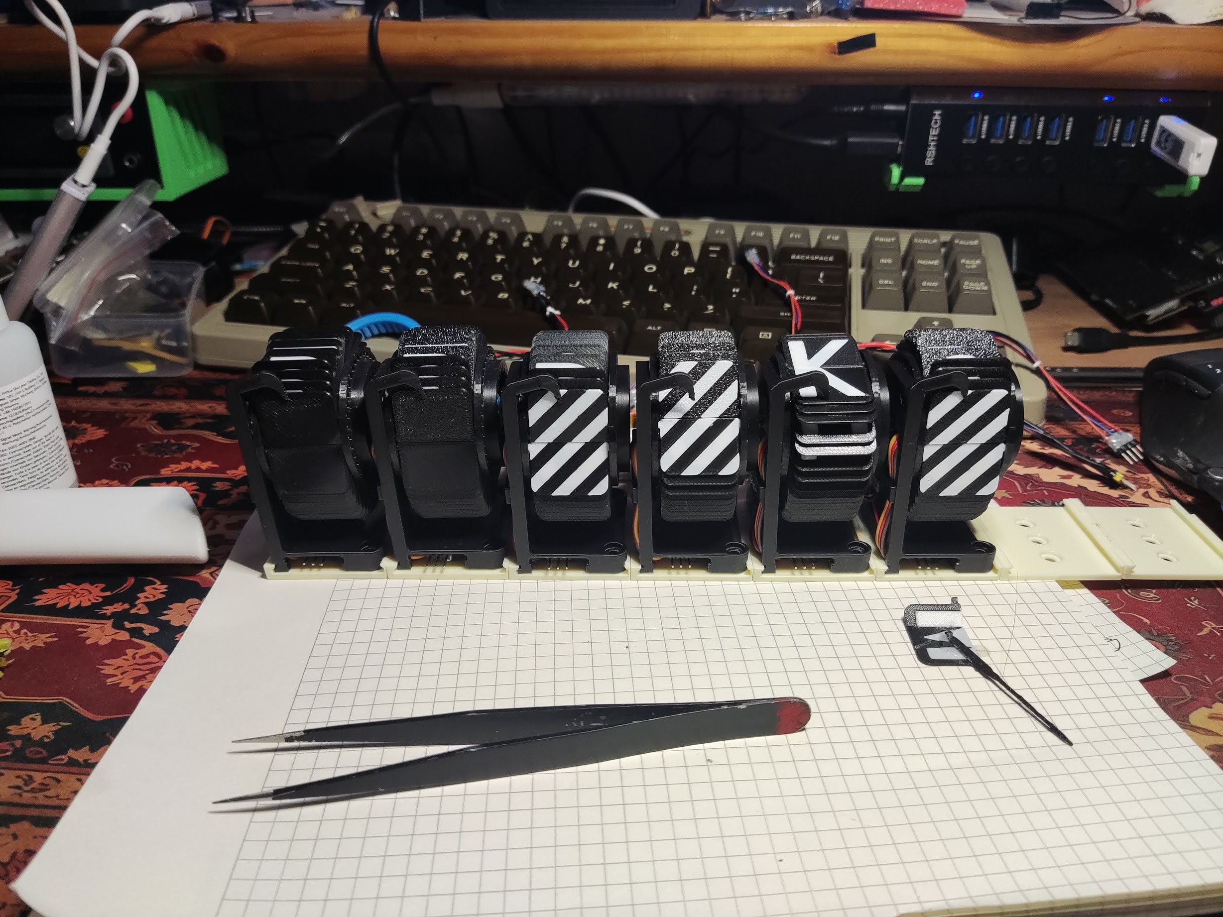

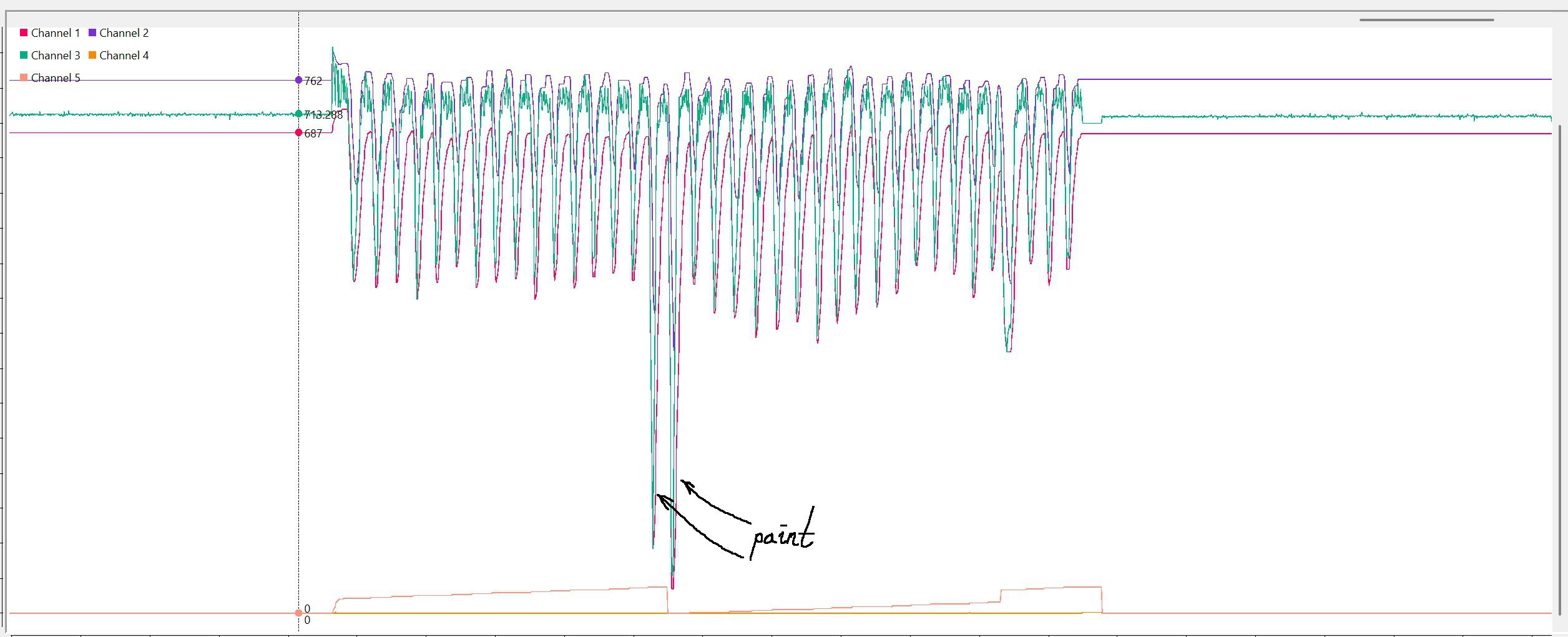

    Printed new wheels using slightly wet filament and had a couple of minor defects in the white ticks so I touched them up using white acrylic paint. Thought nothing of it, didn't even take a picture.

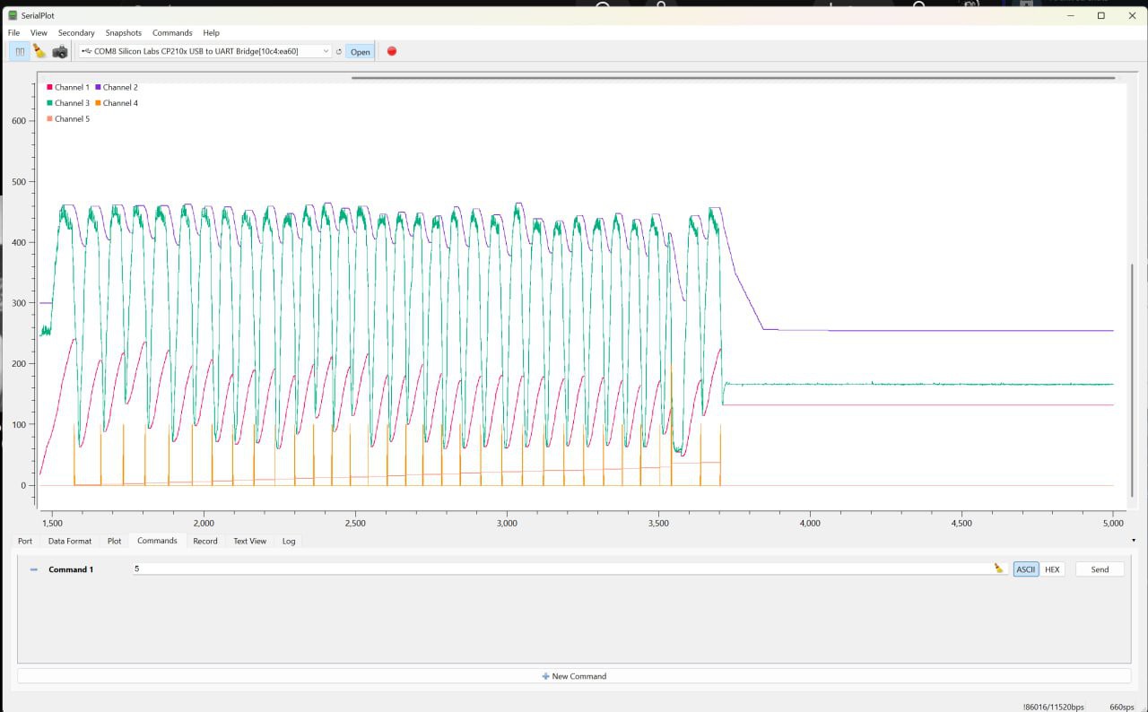

    Here's what sensor reading looks like when passing the touch-up points:
    This is a great contrast and I would like to have it for all tick marks, but unfortunately my white filament seems to be rather dull from QRE1113 point of view.
    For comparison this is the regular code wheel without touch-ups (this graph is from a sensor with 200K collector resistor, so absolute values are different).

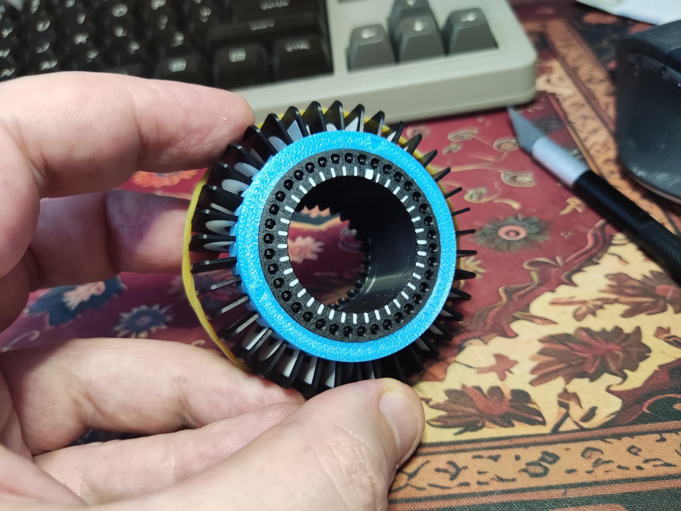

    The tick marks on the code wheel. A thick one represents home position.
    Luckily my simple algorithm turned out to be robust enough to cope with irregularities. I decided to add another tunable parameter, the tracking divisor. It adjust min/max leakage rate. The larger the value, the slower the peaks decay towards the middle. It proved to be quite useful when tuning individual displays.

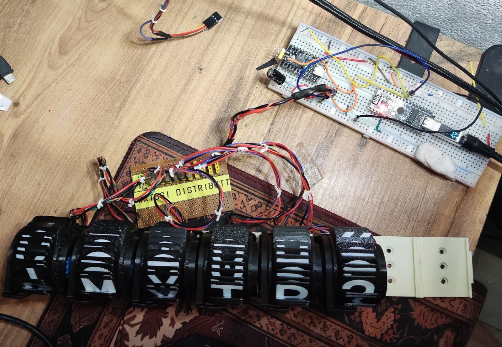

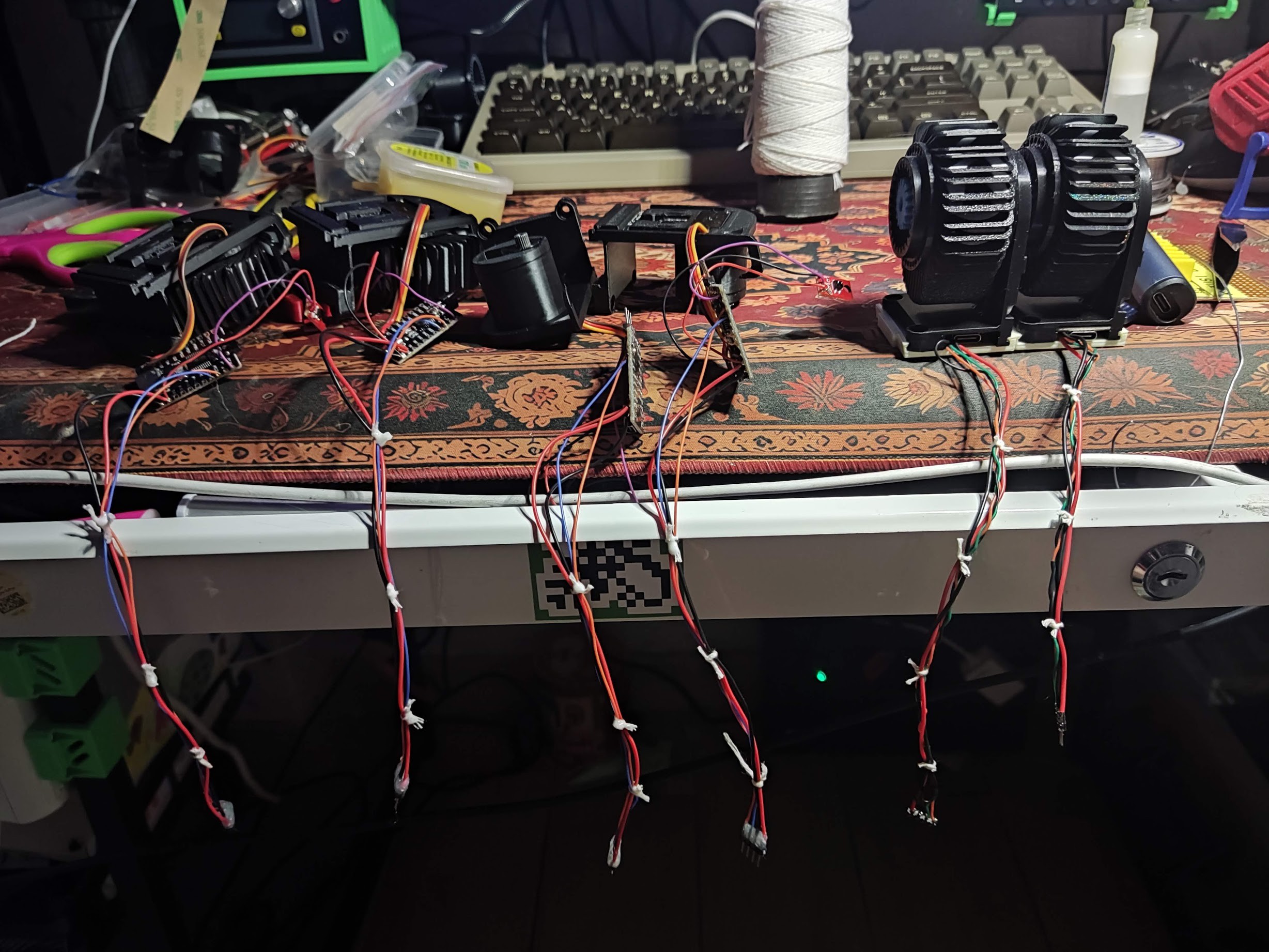

    svofski • 08/30/2026 at 00:07 • 0 comments
    If I were less lazy and made custom PCBs there would be so much less cable work. But I'm using store-bought breakout boards here so it's a lot of wire. I'm trying to measure the lengths and braid them. Takes a lot of time, but I think the results look ok.
    Put together 6 units, of which only 4 are moderately tested. The scale is pretty terrifying. Despite me calling them "mini" they are not as small as I thought they would be.
    I still would like to have at least 8 characters before I call it quits, 10 would be amazing. And I literally have nowhere to put this huge thing once it's complete.
    Two left-most characters are already tested and they mostly work.
    Others, they will probably require some creative debugging.

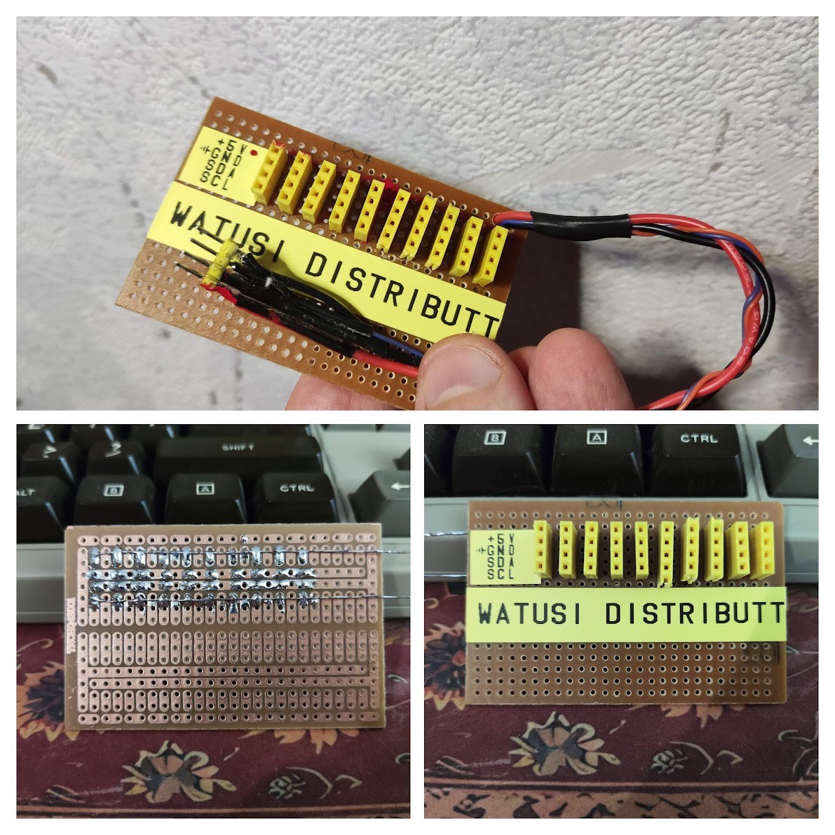

  • I2C/power distribution board
    svofski • 08/28/2026 at 10:27 • 0 comments
    This is probably the least exciting but necessary part of the project.
    I had these very barebones by modern standards boards waiting to be used for something and finally that day has come. Just 4 strips: 5V, GND, SDA and SCL.
    I was on the fence about using I2C vs implementing multiple UARTs on a Pi Pico. I2C won because I had a 5V Arduino Nano on my desk already and the letters are driven by 5V micros as well so it seemed like one potential headache less at the moment.

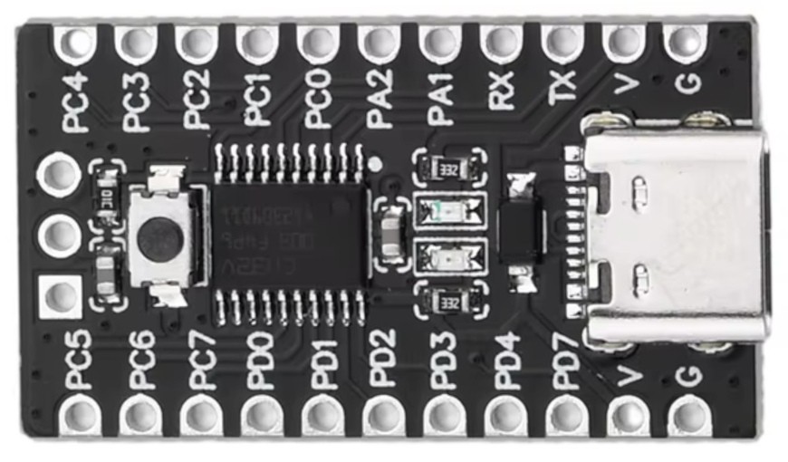

    Why UARTs could be better? Look at this board:
    What you see on the right is a connector that's USB-C mechanically, but it is in fact connected to RX/TX pins on the MCU. It would be convenient to use one connector for everything, even though it's not standard. But you can't use star topology with conventional UART so I had to give it up.
    I2C is mapped to PC1/SDA and PC2/SCL. In fact I'm not sure if I2C can't be remapped to RX/TX pins. Something to check out as it could save a lot of soldering. It can't be remapped to PD5/PD6 pins used for TX/RX.
