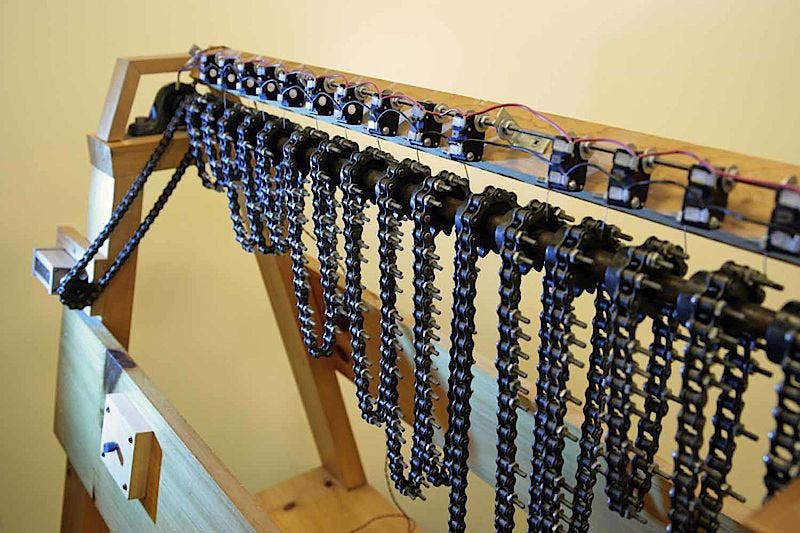

Each musician in that room is one physical part in a number sieve. In 1928 the Lehmers used 19 musicians: 19 bicycle chains on a common shaft, one chain per modulus, with a twist of chickenwire at each accepted link tripping a microswitch. The switches were wired in series, so a candidate nobody rejected completed the circuit and stopped the motor. A person then read the revolution counter and did the arithmetic.
Bicycle chain sieving machine reproduction - computer history museum

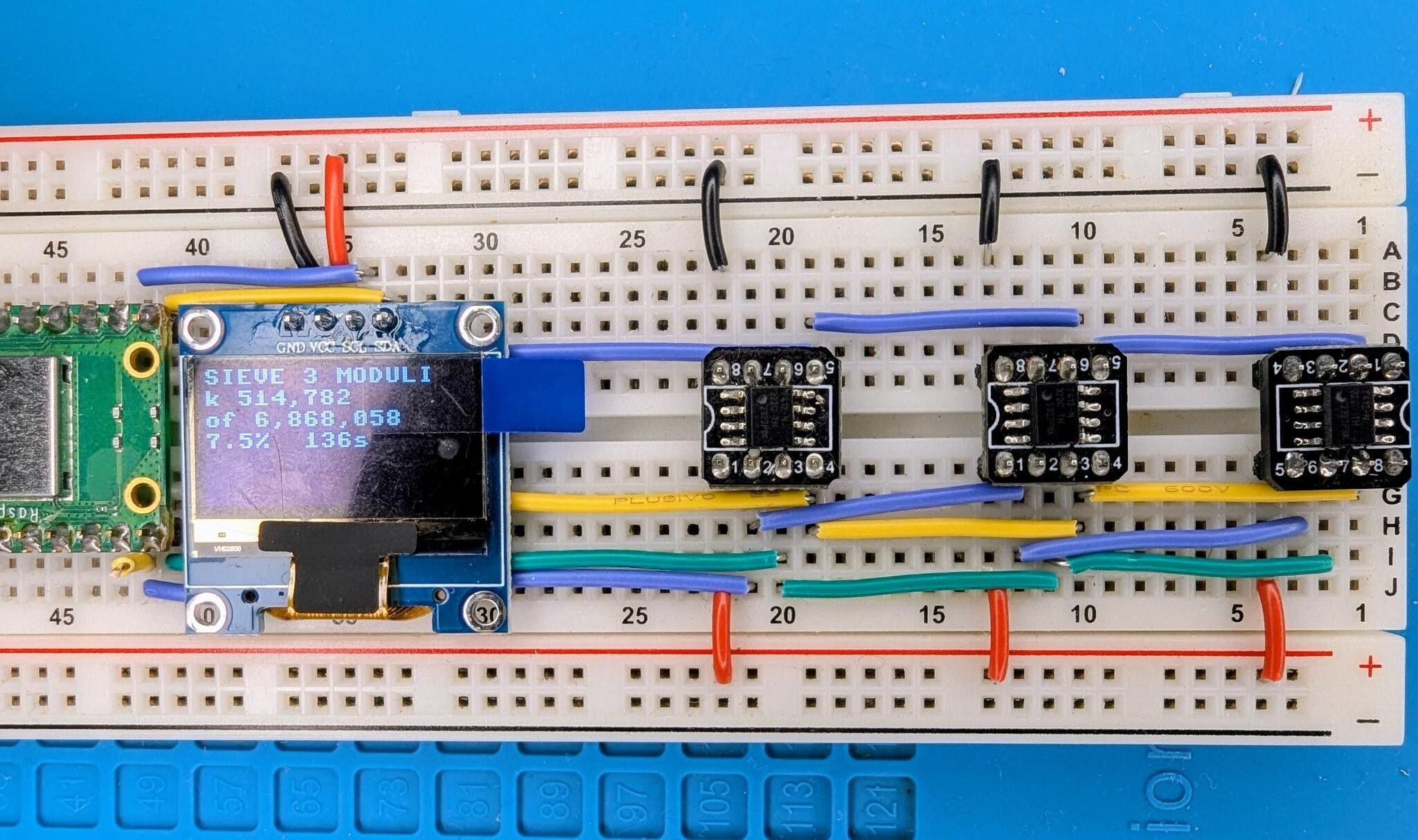

    Back on the breadboard, I'd factored 5,283,065,753,709,209 with three ATtiny moduli. It took 25 minutes, about as long as Lehmer's 1932 gear machine, even though the breadboard sieve can run ten times faster. Having only three moduli let through 740,000 survivors, which the Pico has to check. This left the sieve idle over 90% of the time waiting on the Pico.
    With 30 moduli the same problem now finishes in under two minutes, about ten times faster than the gear machine, as expected. Only two candidates survive, and both are real solutions. Two of Lehmer's gears accept every value on this problem and do no filtering at all, so those two cards stay dark for the whole run. He couldn't swap in different moduli because they were fixed by the gears he had, but the remaining 28 still filtered enough. My current sieve is also ten times faster than the breadboard version, so at its full rate of 500,000 numbers per second the same run takes 11 seconds.

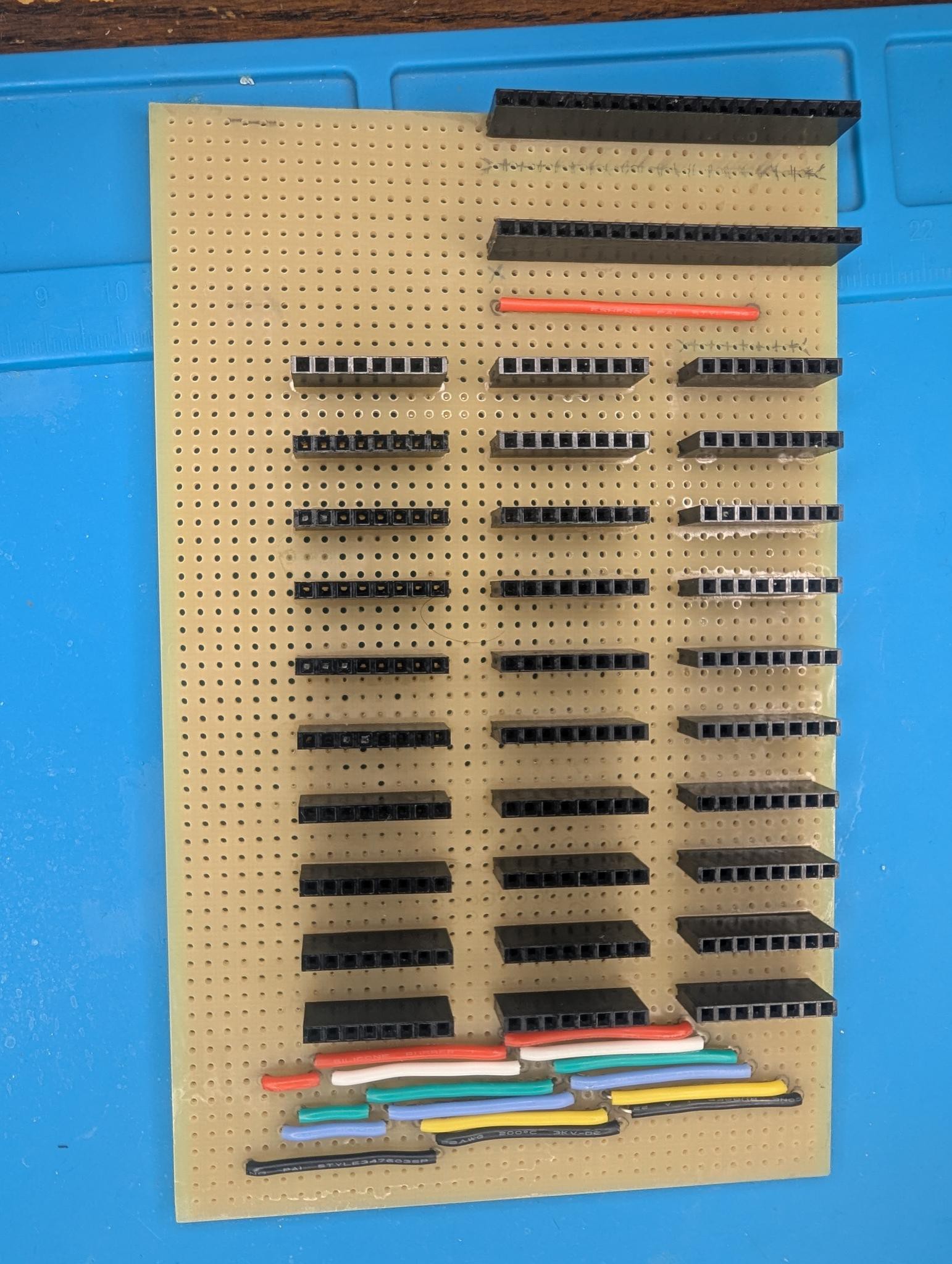

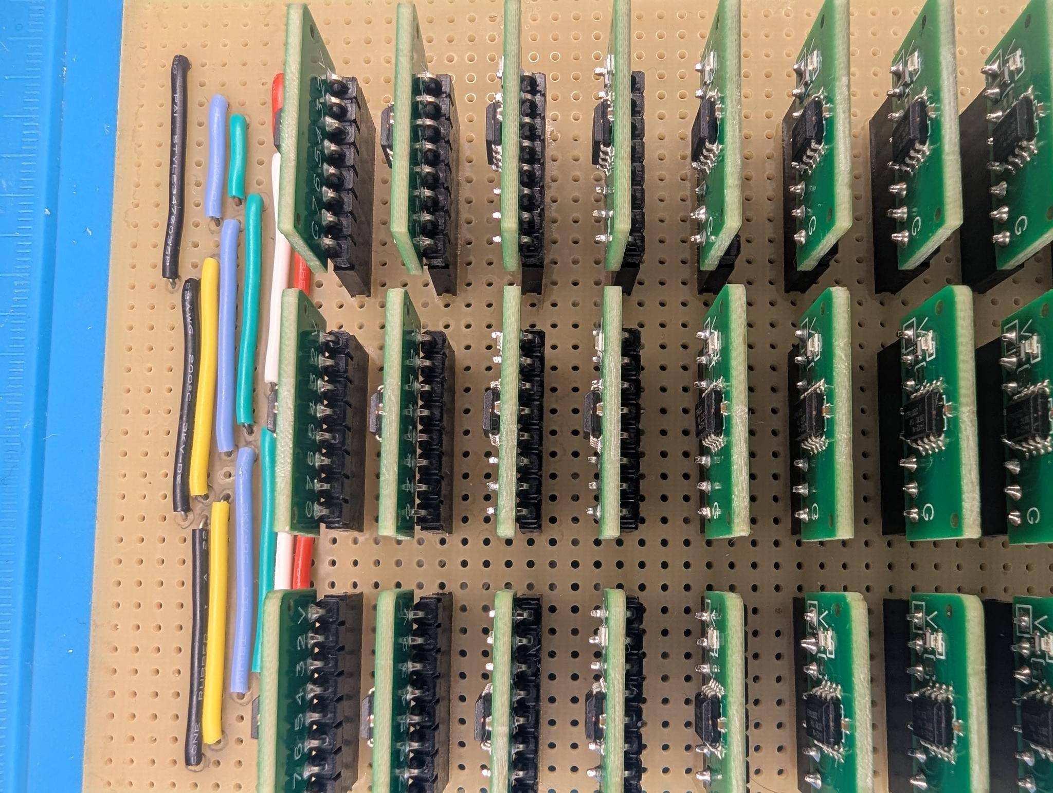

    Here is a self-test running across all thirty cards on a stripboard backplane. Each LED lights in slot order while the OLED reports the address it is checking.
    Last time, I tested the cards one at a time. They now sit in a stripboard backplane with 30 headers, which brings its own failures. A cold joint or a bridge on the backplane, or a card not seated far enough into its header. A card that incorrectly holds the shared VOTE line low rejects candidates that should pass. This causes the run to silently fail, as every valid solution is discarded before verification by the Pico. The machine now checks itself before it starts. I also wanted to know how fast it can run, so I measured two things on VOTE with all 30 cards fitted: how long after a REQ edge a card pulls the line low, and how long the line takes to return high once every card has released it.

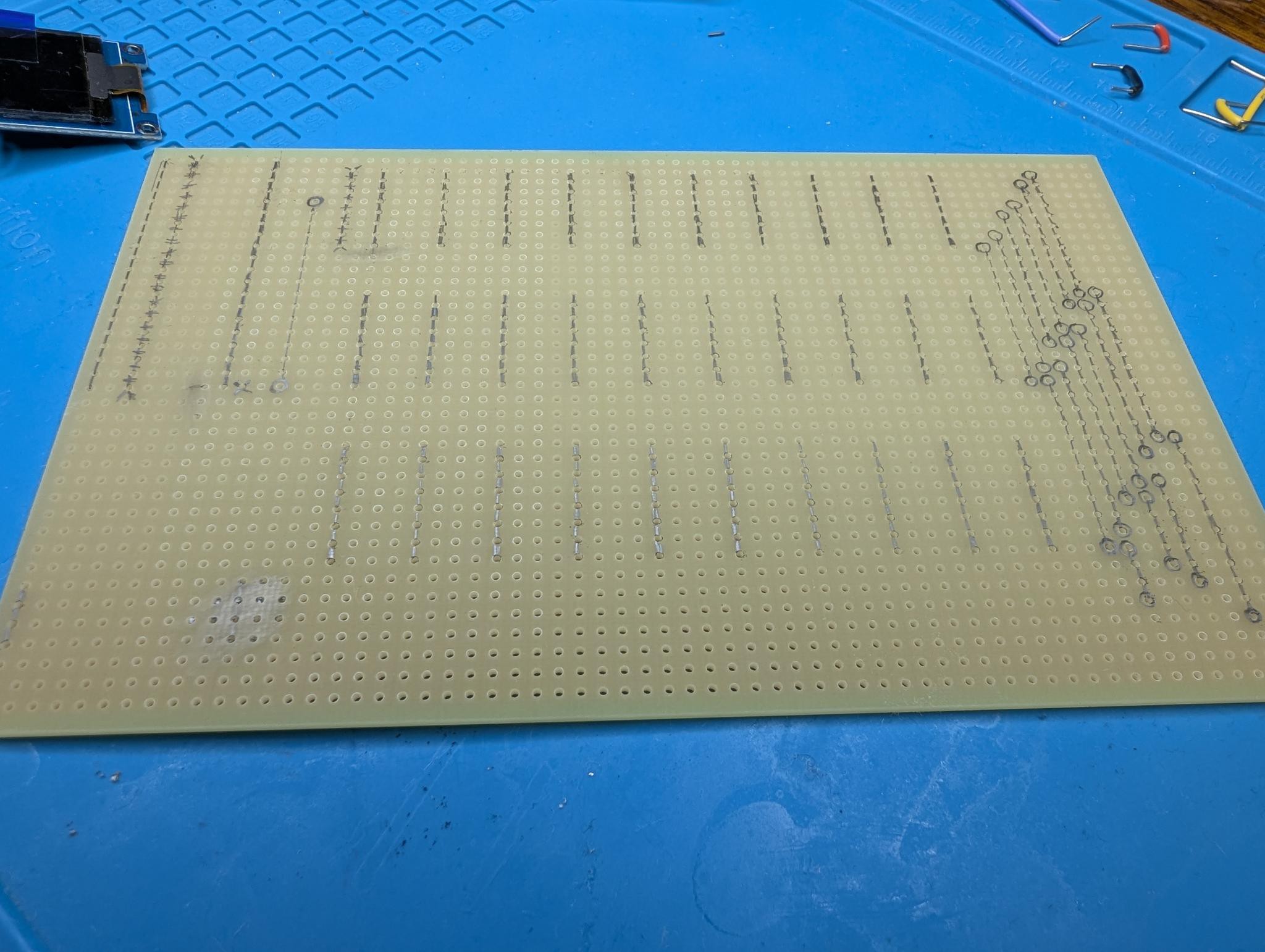

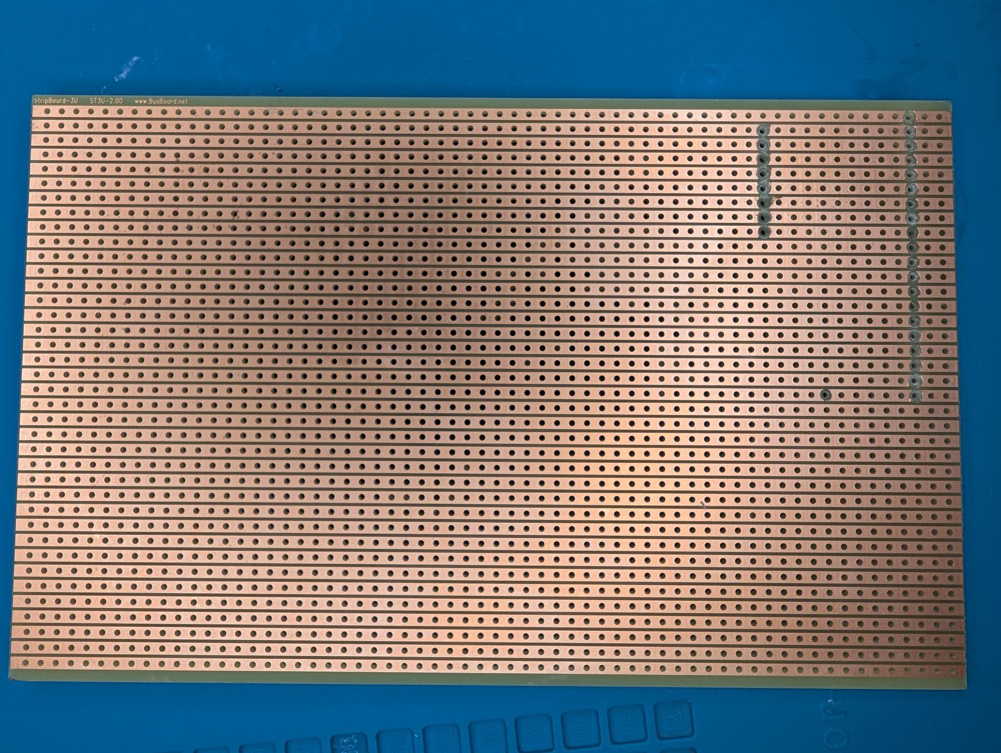

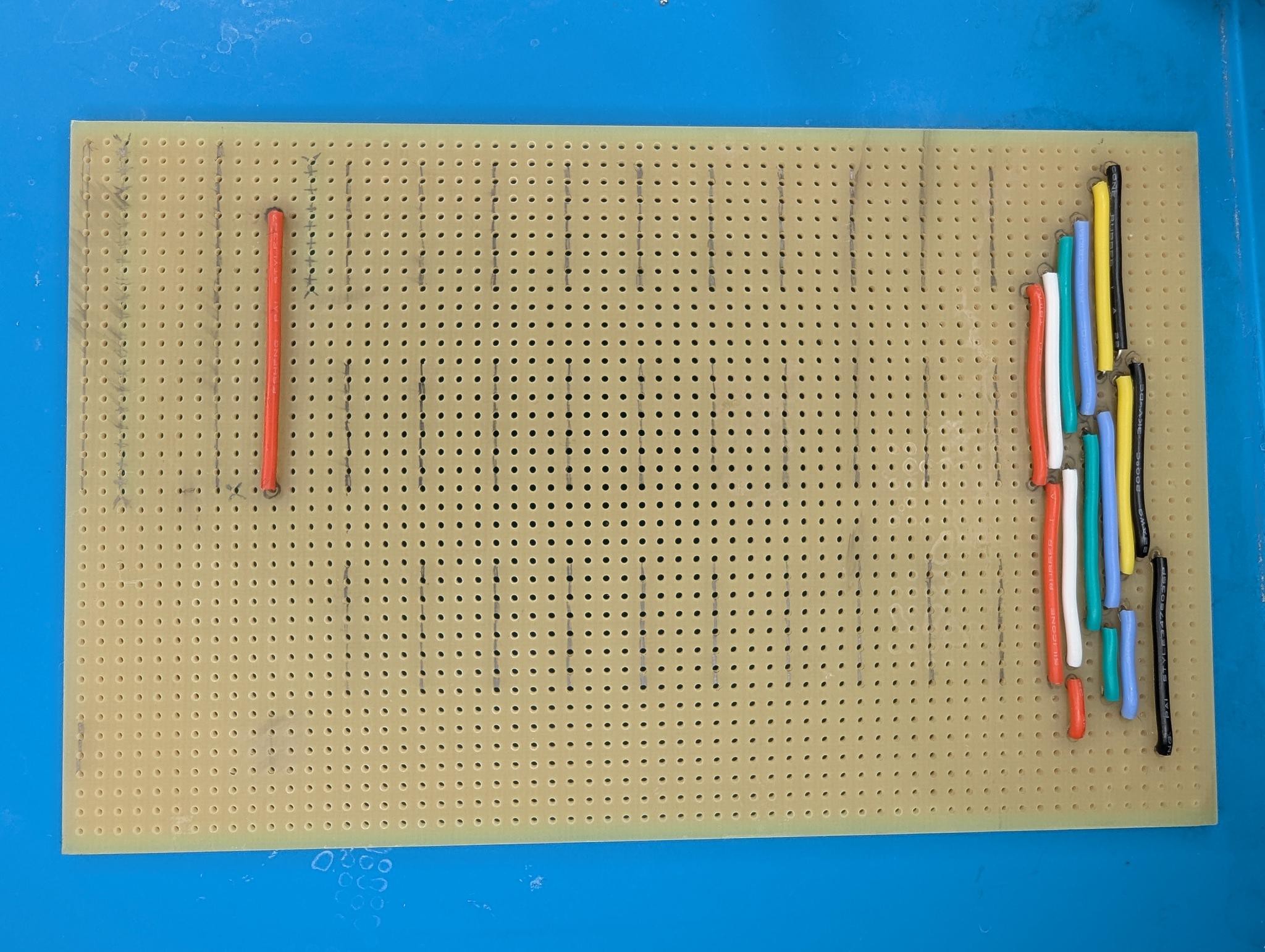

    The stripboard backplane

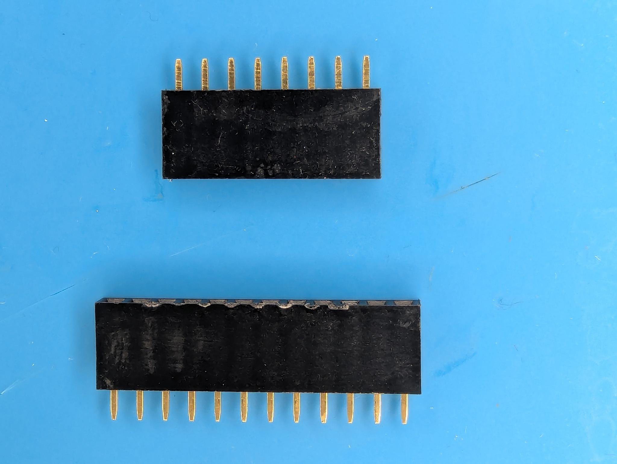

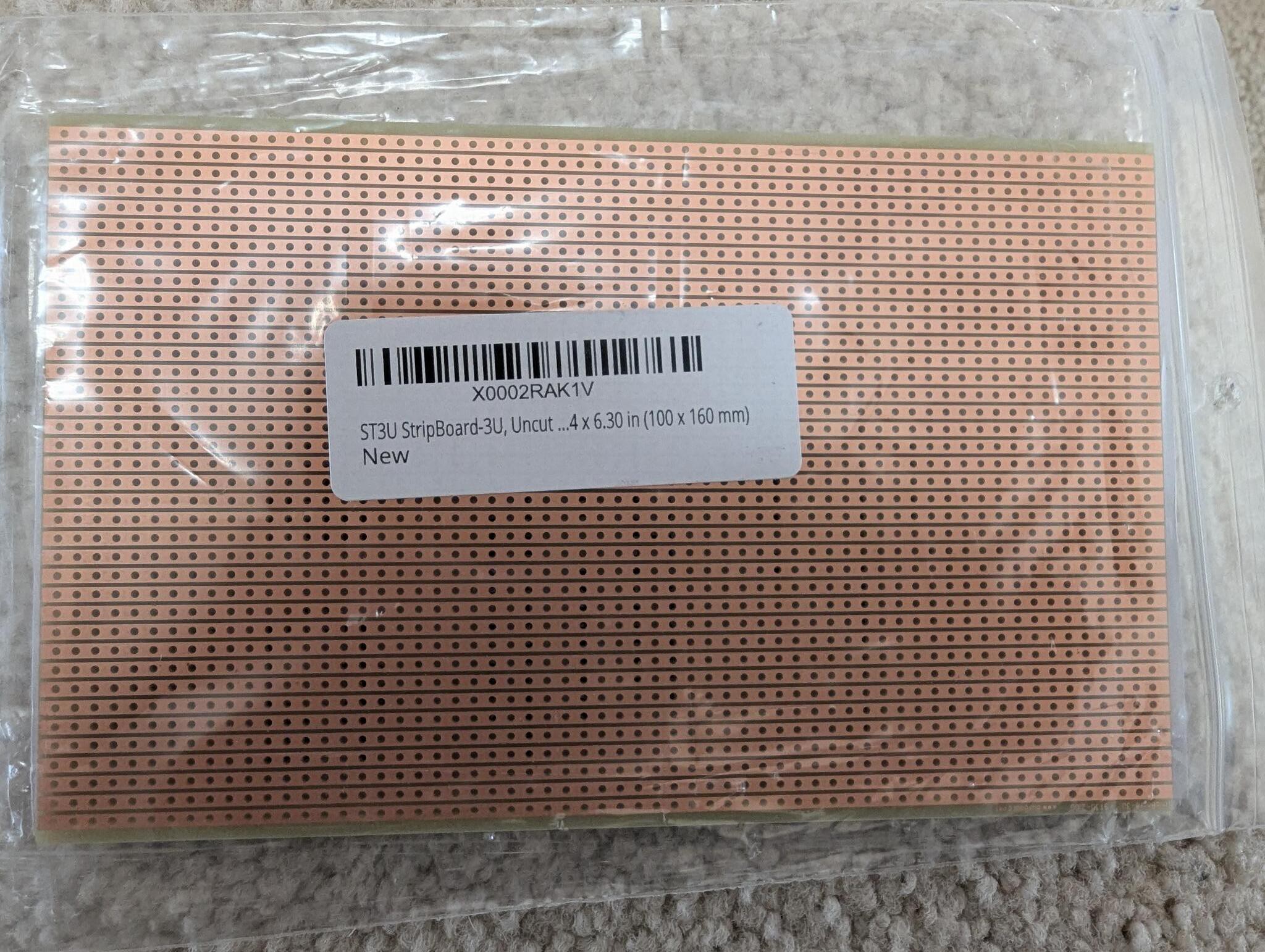

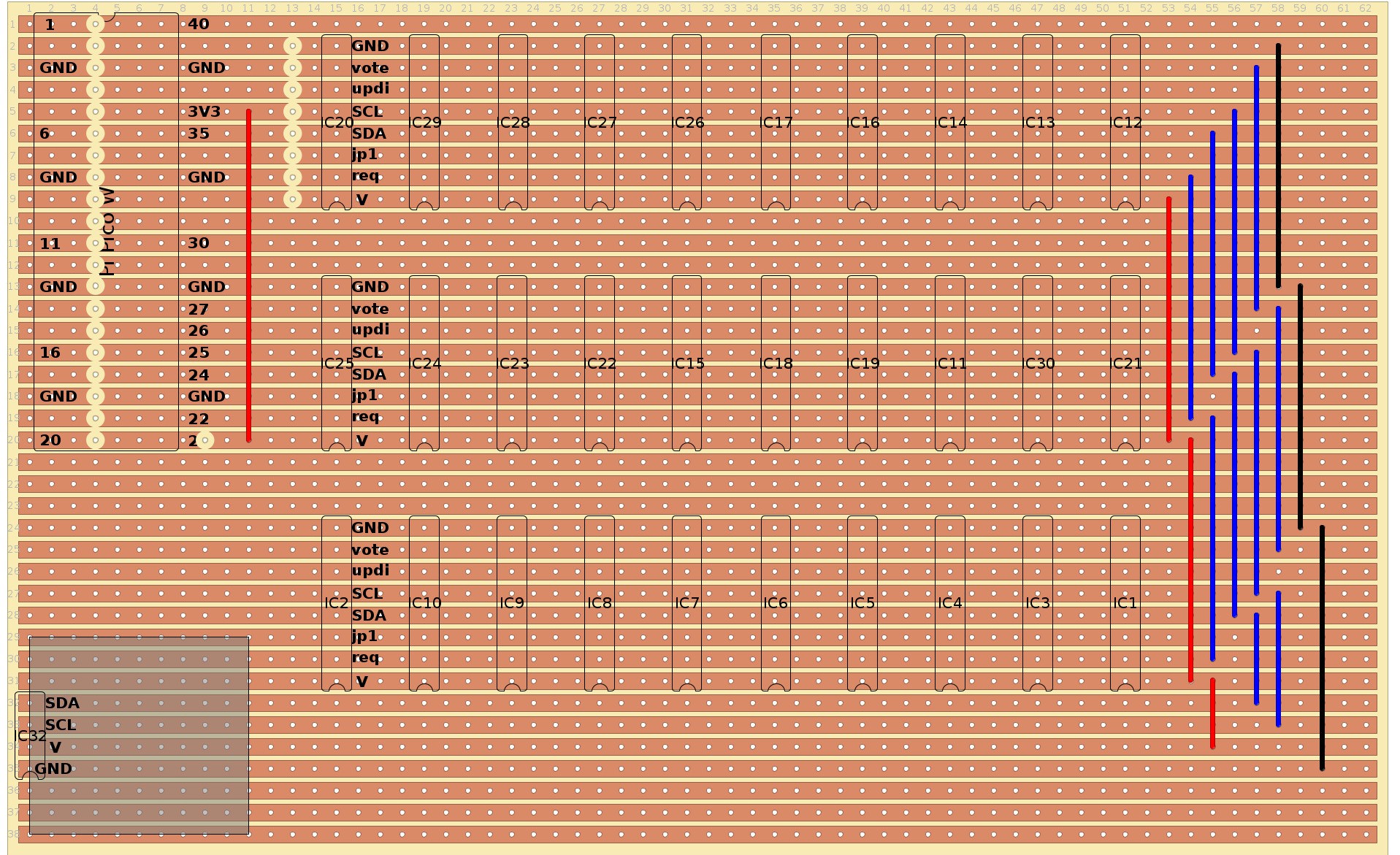

    I built it on a 3U Eurocard stripboard, with 62 holes along each of 38 copper strips.
    Fitting thirty 8-pin daughter cards, a Pico and an OLED is tight. I tried several layouts in diylc before settling on three rows of ten, with the Pico on the left and the OLED in the corner beside it. The Pico's right-hand column of pins lands on the same strips as the first card slot, so ground, SDA, SCL, VOTE and REQ reach it directly. Vcc is taken off a jumper from the 3V3 pin on the Pico.
    An ATtiny412 draws 2.7 mA running at 10 MHz, and each LED about 1 mA, so thirty cards with every LED lit come to roughly 111 mA. The OLED takes an additional 20 mA or so. The Pico's regulator is rated at 800 mA, so the 131 mA total leaves plenty of margin.
    The strips are on the underside, so everything is mirrored once the board is turned over to work on them. I drew the component outlines on the top side first, and poked a wire through each hole to confirm a position before cutting anything.
    To break a strip I spot-face a hole. I place a drill bit at a hole and gently turn it by hand until the ring of copper around it is gone, then verify that the two sides of the break are no longer connected. Stripboard has no solder mask, so solder spreads about one hole's width along the strip from every joint. If you solder first, cutting through it can be difficult. So I made the breaks first, then the jumpers while nothing tall got in the way, and the headers last.

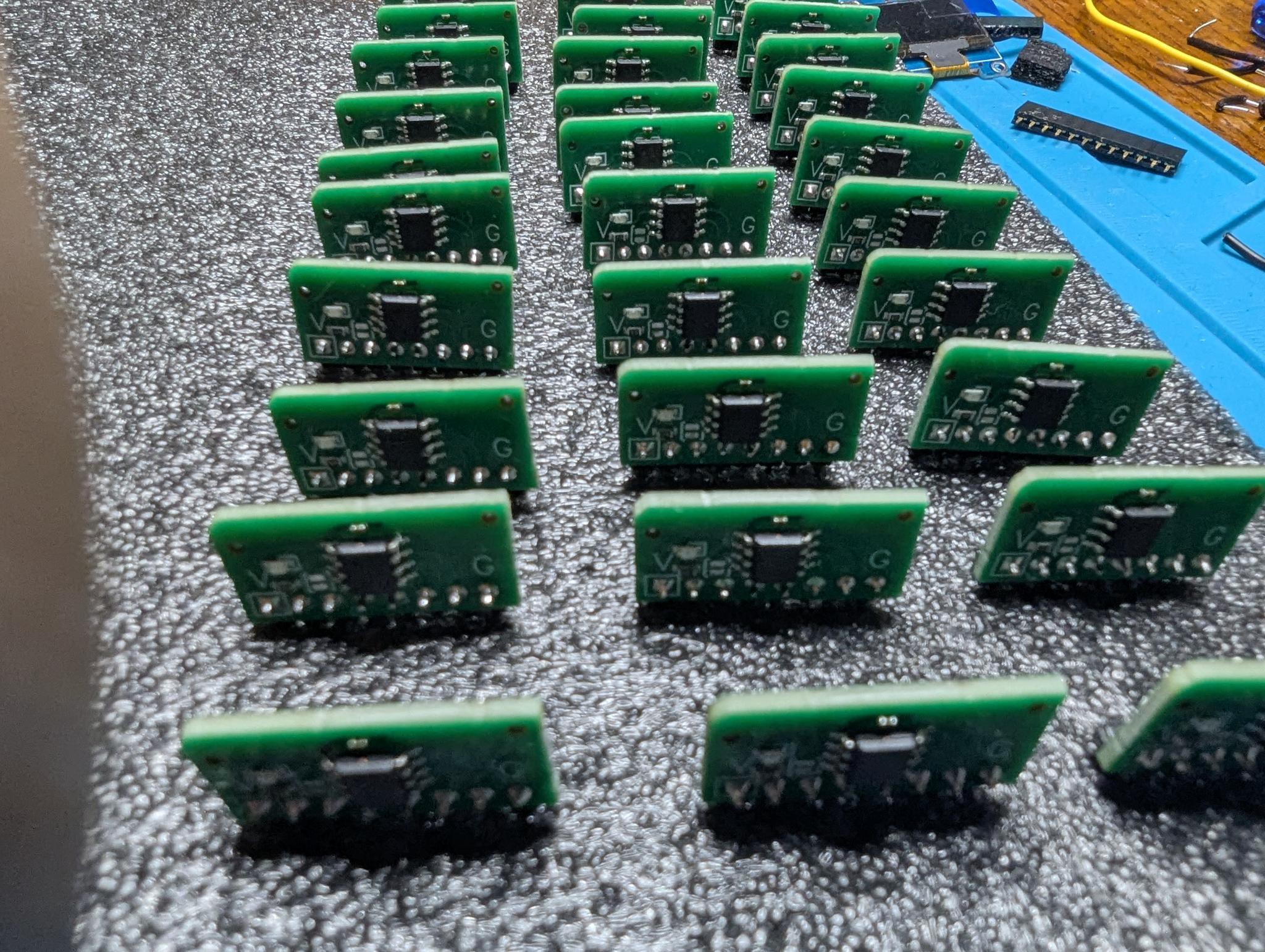

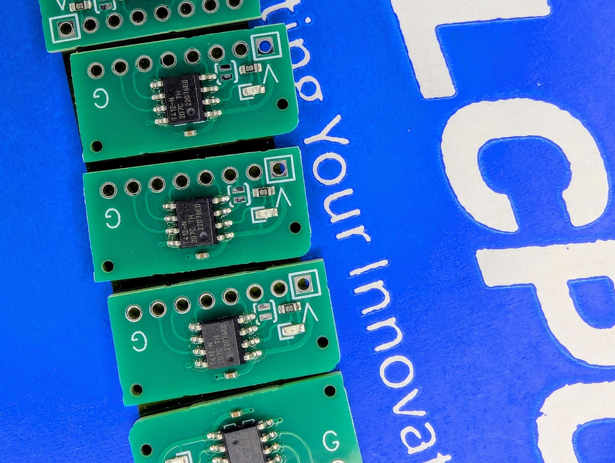

    The boards are here, and they are smol!

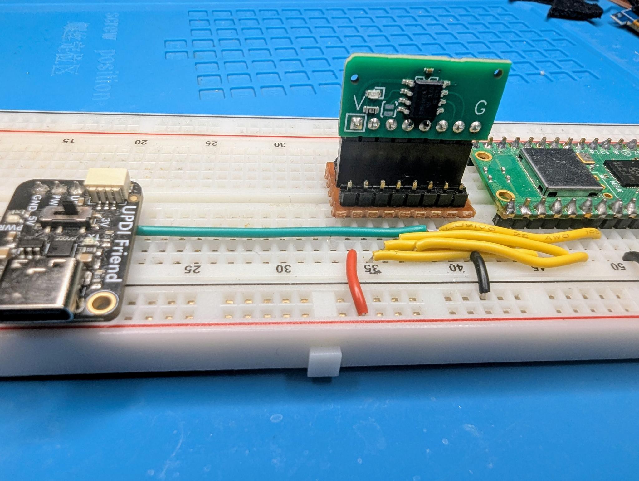

    Soldering headers across 30 cards is 240 joints, and any one could break the sieve silently. An open joint only costs time. More candidates survive, and the Pico has to check each one. A bridge to ground on VOTE is worse. The card will reject candidates that should pass, and the run ends without a solution.
    On a shared bus, any of the thirty could be the culprit. I have to flash each card individually anyway, so I can also test each in isolation before flashing it.

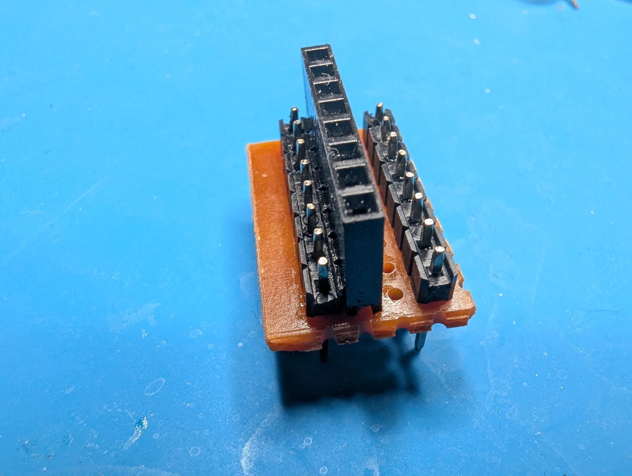

    Soldering headers

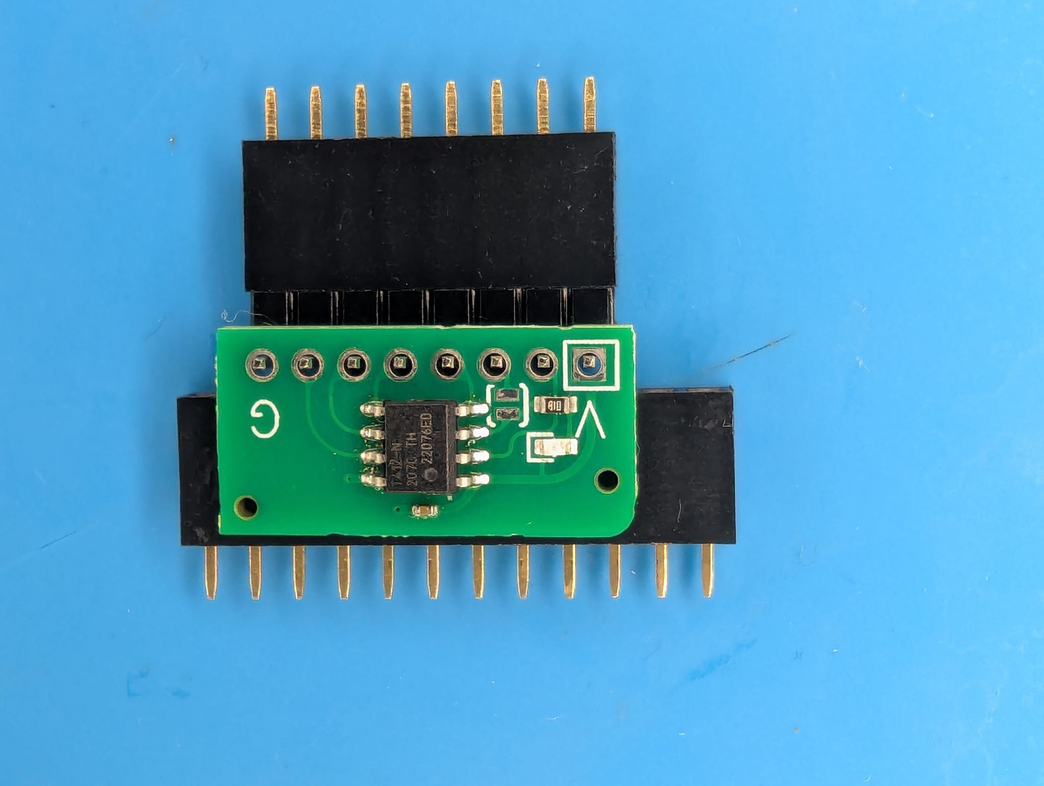

    Soldering a right angle header on a small board like this can be tricky to keep the pcb aligned with the pins. I used a sacrificial female header under the ground side of the pcb, which is component free and flat. I inserted the right angle pins in another female header, which keeps the pcb in the same plane as the pins, and then solder the headers.
    The test jig
    The jig is just a small stripboard with two 8-pin male headers to secure it to a breadboard and a female header for the card under test. A Pico to test for open/shorts and a UPDI Friend to flash the code stay on the breadboard. The cards are never inserted or removed from the breadboard directly, avoiding damage over 30 cards.
    The test software
    I first flash test code that just leaves the four bus lines in high-Z with pullups, and blinks the LED as a visual check it works. The Pico drives each line low in turn and checks the others are still high. This find bridges between lines. It then releases everything and checks all lines are high. The pullups are in the tiny, so any open connection would stay low.
    Here's a successful run.

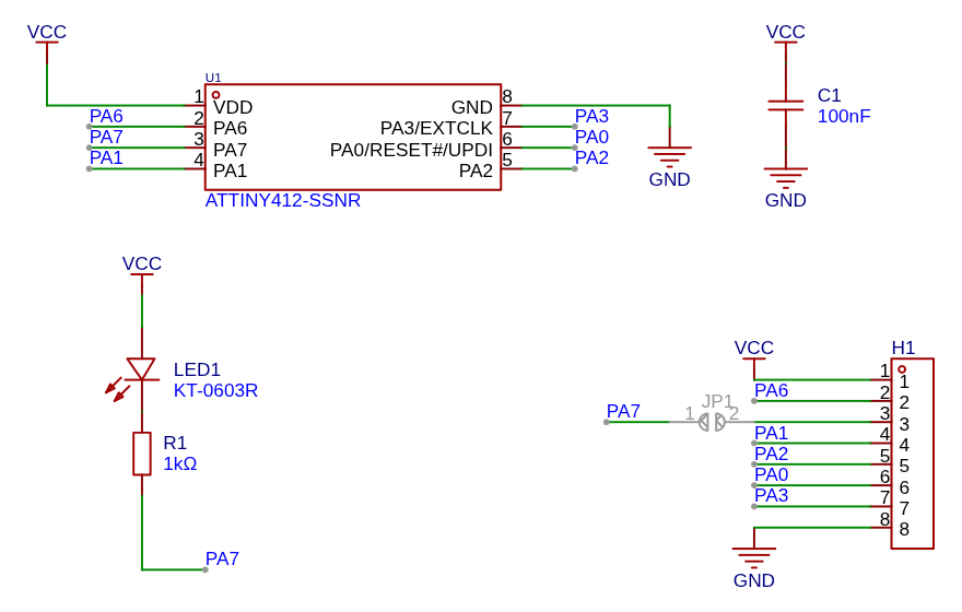

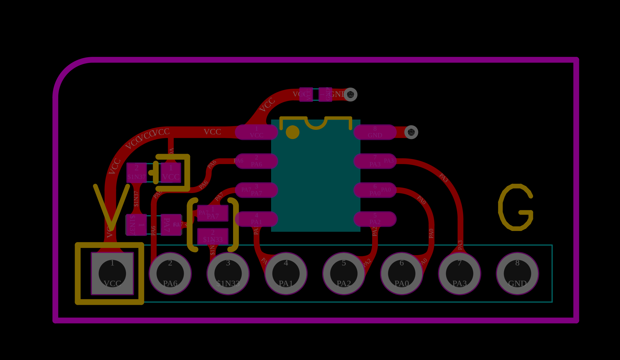

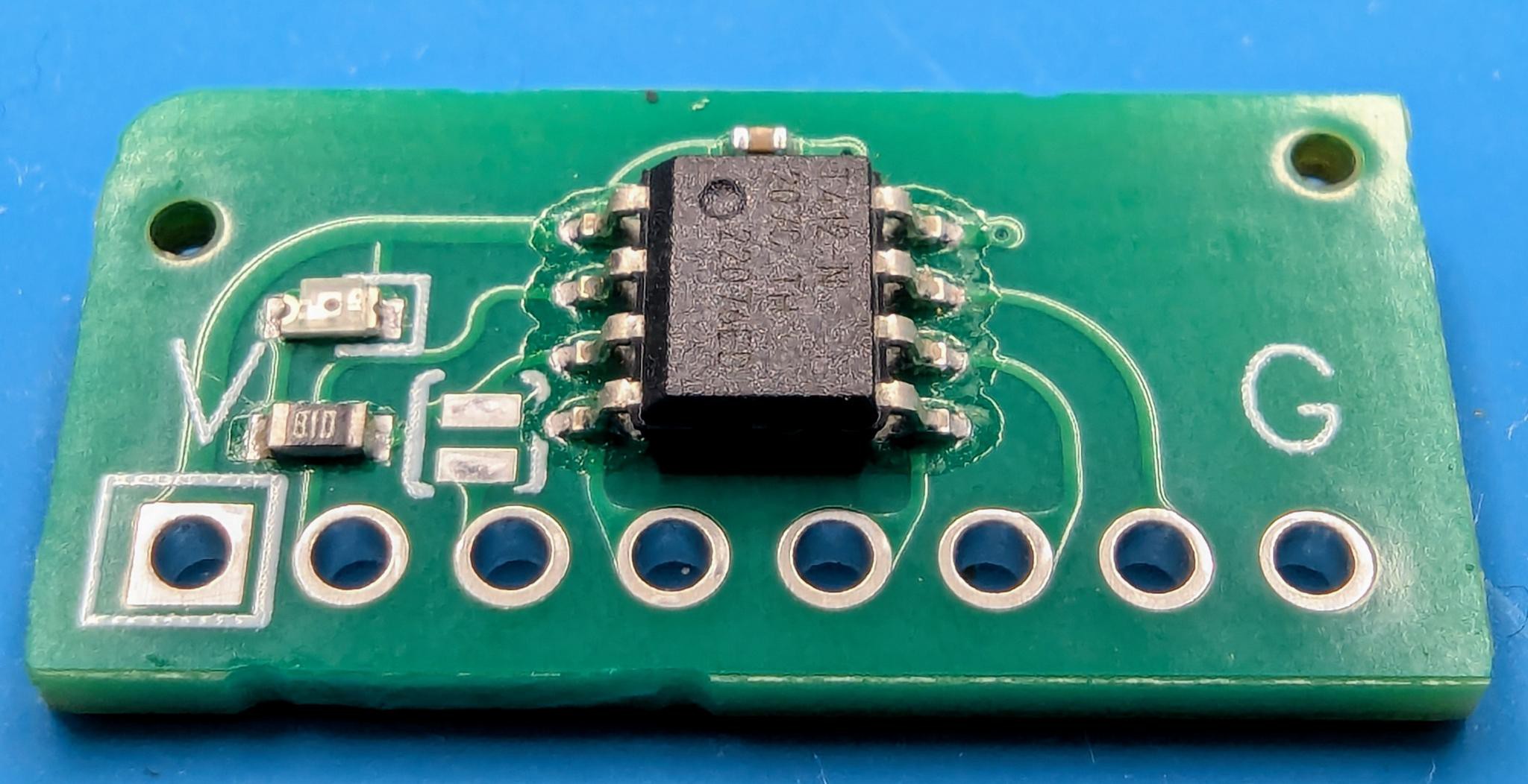

    My plan is a stripboard bus with female headers, with each modulus an ATtiny412 on a card standing vertically in it. All pins come out to one edge, with a decoupling cap on the card. I want to keep the UPDI programming pin free. SDA and SCL sit on PA1 and PA2. That leaves PA3, PA6 and PA7 for REQ, VOTE and one spare. PA7 has the peripherals I'm least likely to need, so it drives an onboard LED and each card blinks its own vetoes.

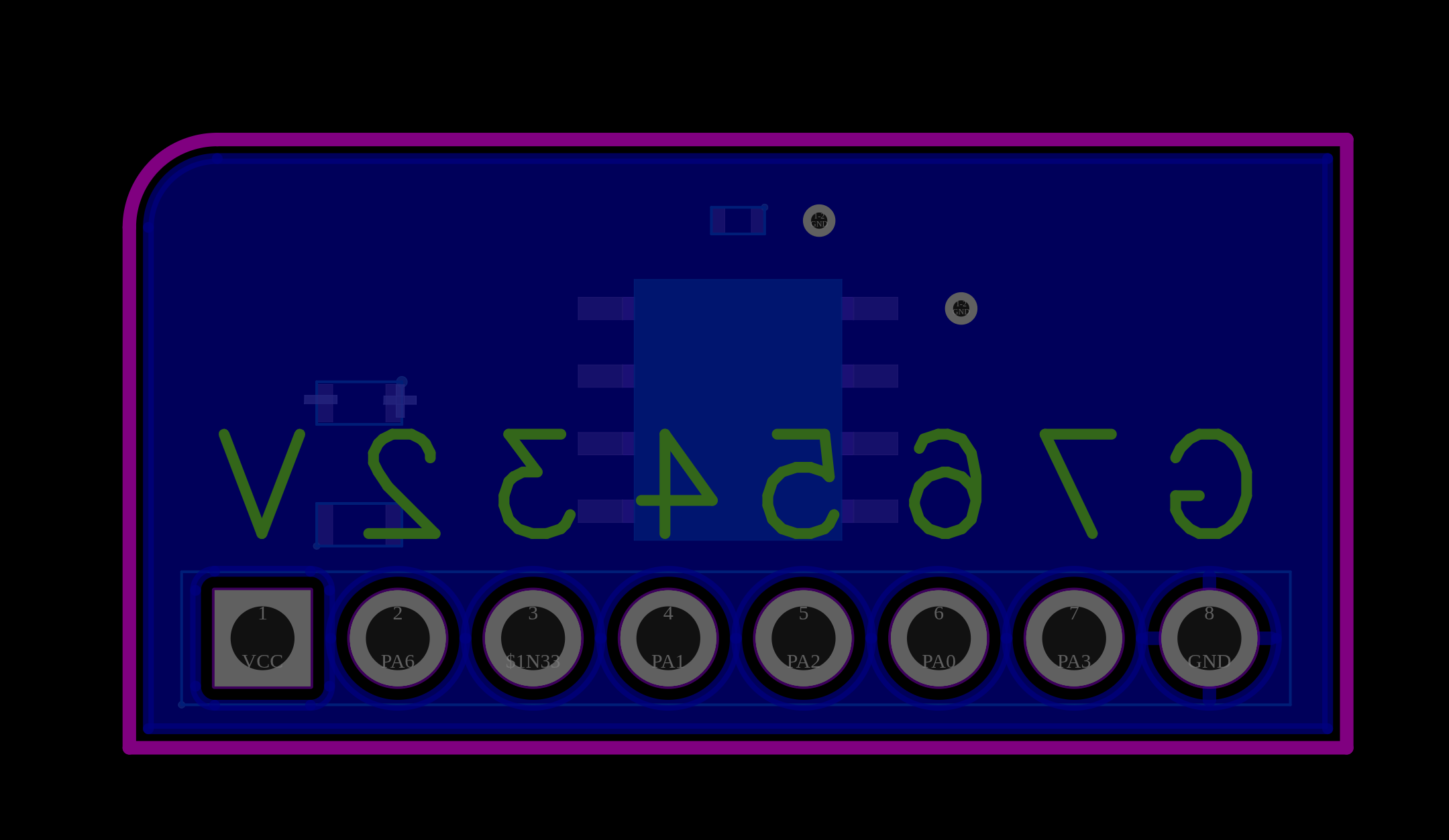

    The schematic is an ATtiny412, a decoupling cap, an LED with its resistor, and a header. The one addition is a jumper that ties PA7 to a header pin, in case I want that line off the card instead of the LED.
    Routing fits entirely on the top layer. I rounded the traces for the look of a hand-drawn PCB, and rounded one corner so I can check that 30 cards are all seated the same way.
    I drew the schematic and board in JLCPCB's online editor and picked parts they stock so the boards arrive assembled. Hand-soldering 30 sets of SMD parts is not something I want to do, so the header pins are all I have to solder.
    Thirty boards came to $81 with shipping and tariffs, or around $2.70 a modulus. Each board is identical, since the modulus is loaded over I2C at the start of a run.
    Gerbers, Altium source and the JLCPCB BOM are in the GitHub repo  if you want to order your own.

    Got these three ATtiny412s and a Pico to factor 5,283,065,753,709,209 - the number D.H. Lehmer's gear machine factored in 1932.
    The sieve scanned 5.6 million candidates in 113 seconds and rejected 87% of them. The Pico spent 23 minutes testing the 740,000 that survived. The sieve is idle for 92% of the run, waiting for the Pico to check survivors.
    So a sieve which scans ten times faster than Lehmer's 1932 gear machine, takes about as long to factor the same number. The difference is the number of moduli. The three moduli let through around one in eight candidates. Lehmer's thirty let through so few that a human could hand-check the survivors without adding much more time to the process.

    In 1928 the Lehmers built a sieve from 19 bicycle chains on a common shaft, one chain per modulus, with a twist of chickenwire at each accepted link tripping a microswitch, and a revolution counter for the current number. The switches were wired in series, so a candidate nobody rejected completed the circuit and stopped the motor. Then a person checked if the candidate was a solution.

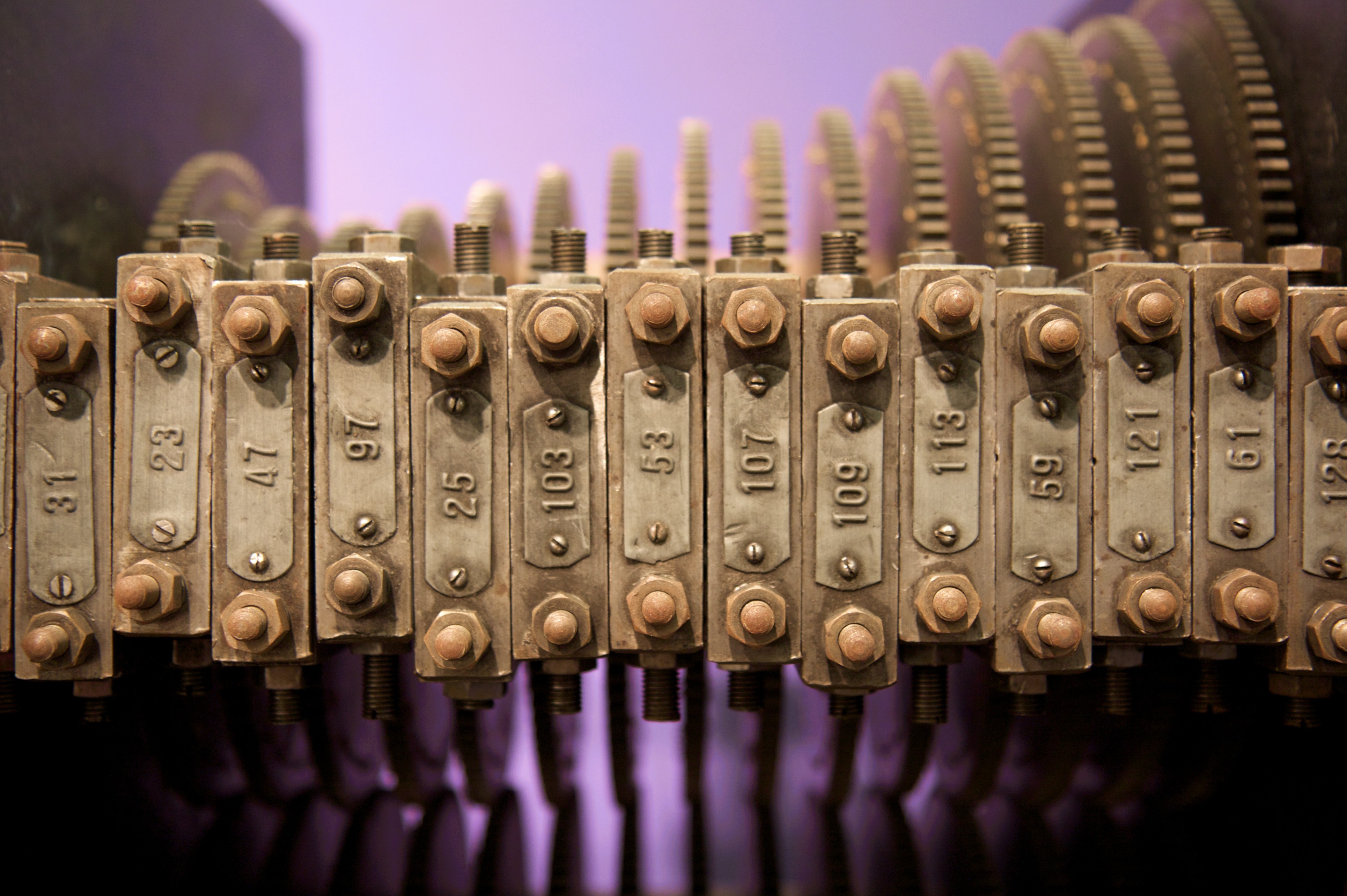

    Some of the moduli in the gear sieve
    Some moduli in the 1932 Lehmer gear sieve: Photographer: Marcin Wichary (CC BY 2.0)

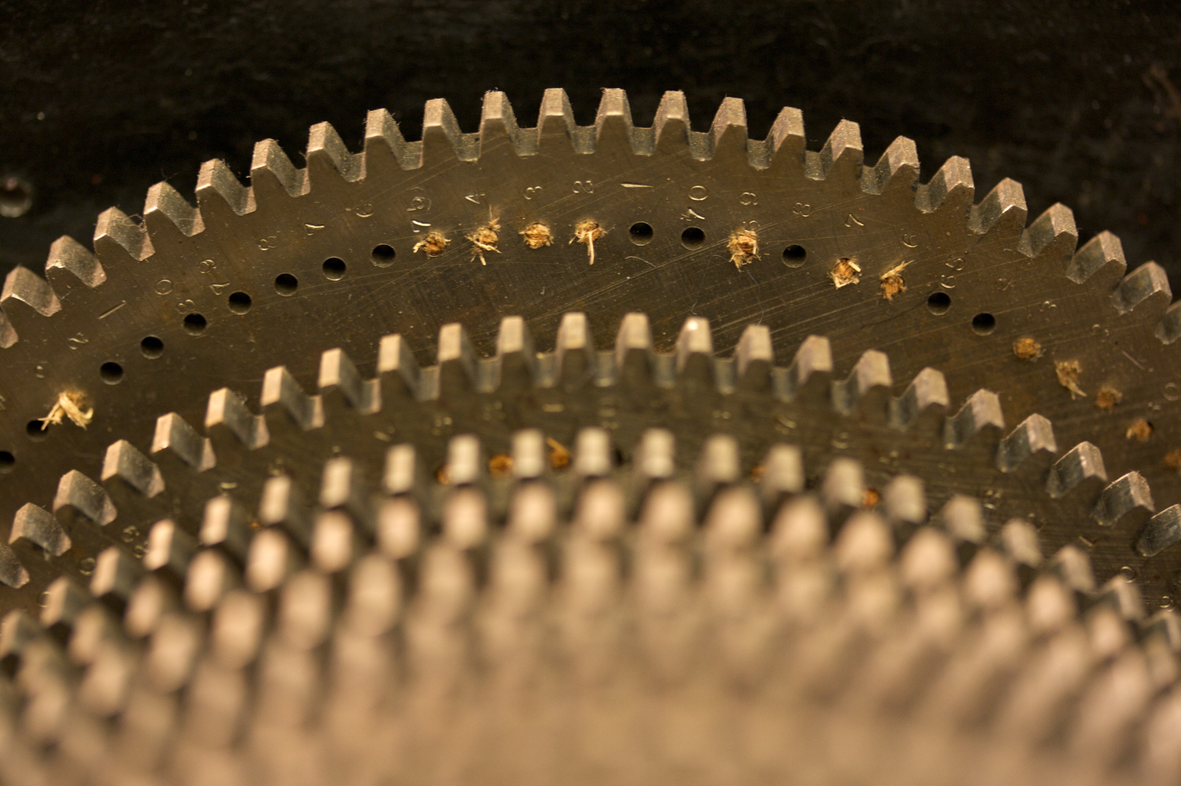

    Rejected positions plugged up with toothpicks
    Rejected positions plugged up with toothpicks: Photographer: Marcin Wichary (CC BY 2.0)
