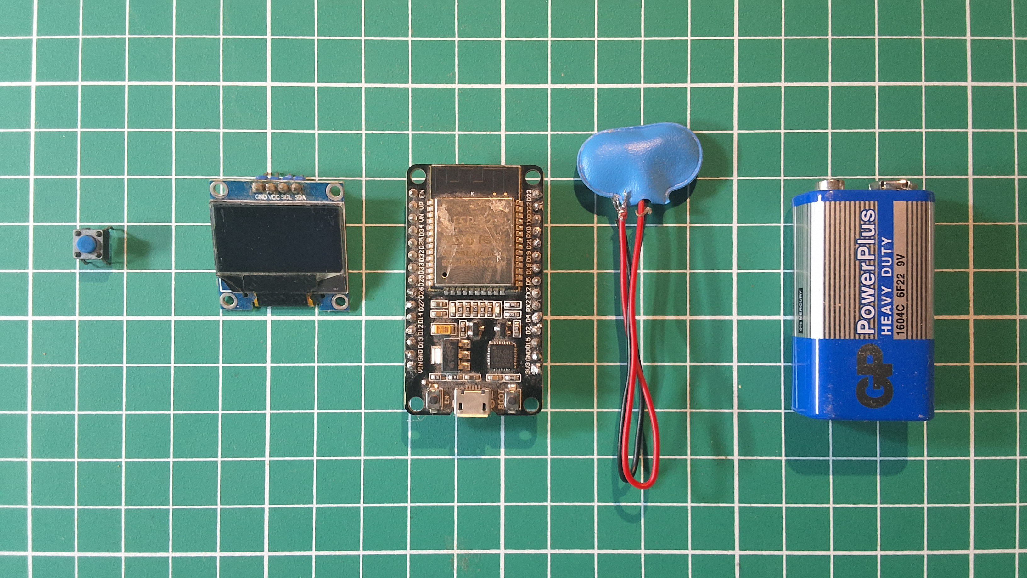

    Electronics:
    1. 1× ESP32 Dev Module — any standard 30/38-pin dev board works; this runs the Morse engine, display, and ESP-NOW beacon
    2. 1× SSD1306 OLED, I2C, 0.96", 128×64 — the standard 4-pin I2C version (SDA/SCL), not SPI
    3. 1× momentary tactile push button — the only input on the device
    4. 1× buzzer, passive or active (optional) — passive is preferable since it can tone at a specific frequency rather than just clicking
    5. 9V battery, or USB power for bench testing
    6. Jumper wires, breadboard for initial wiring

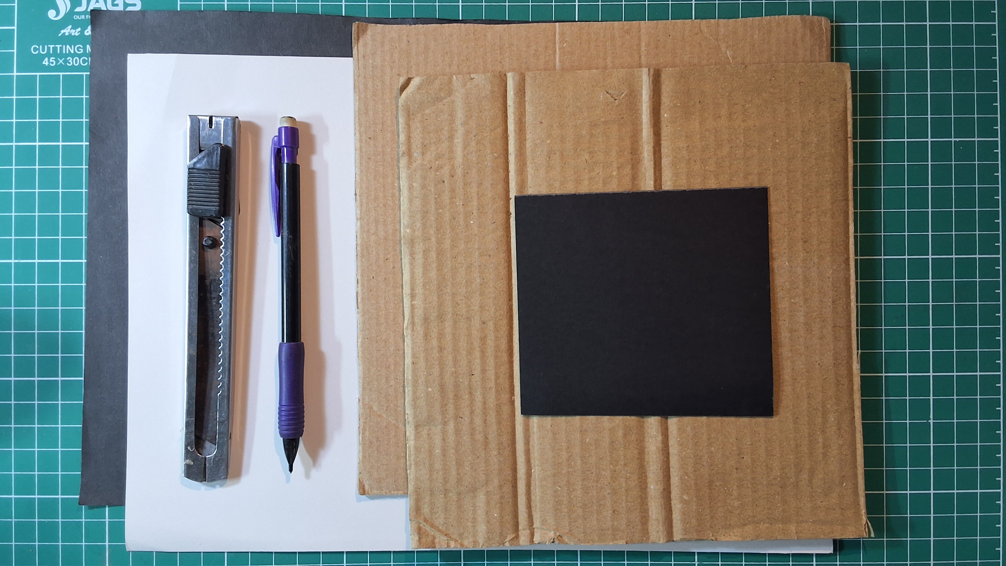

    Enclosure (cardboard prototype):
    • Corrugated cardboard (an old shipping box works)
    • Black and white paper for the panel finish
    • Hot glue gun + glue sticks
    • Craft knife and a pencil for marking cutouts
    The same electronics stack drops into a PVC or 3D-printed shell later with no changes to wiring or firmware.

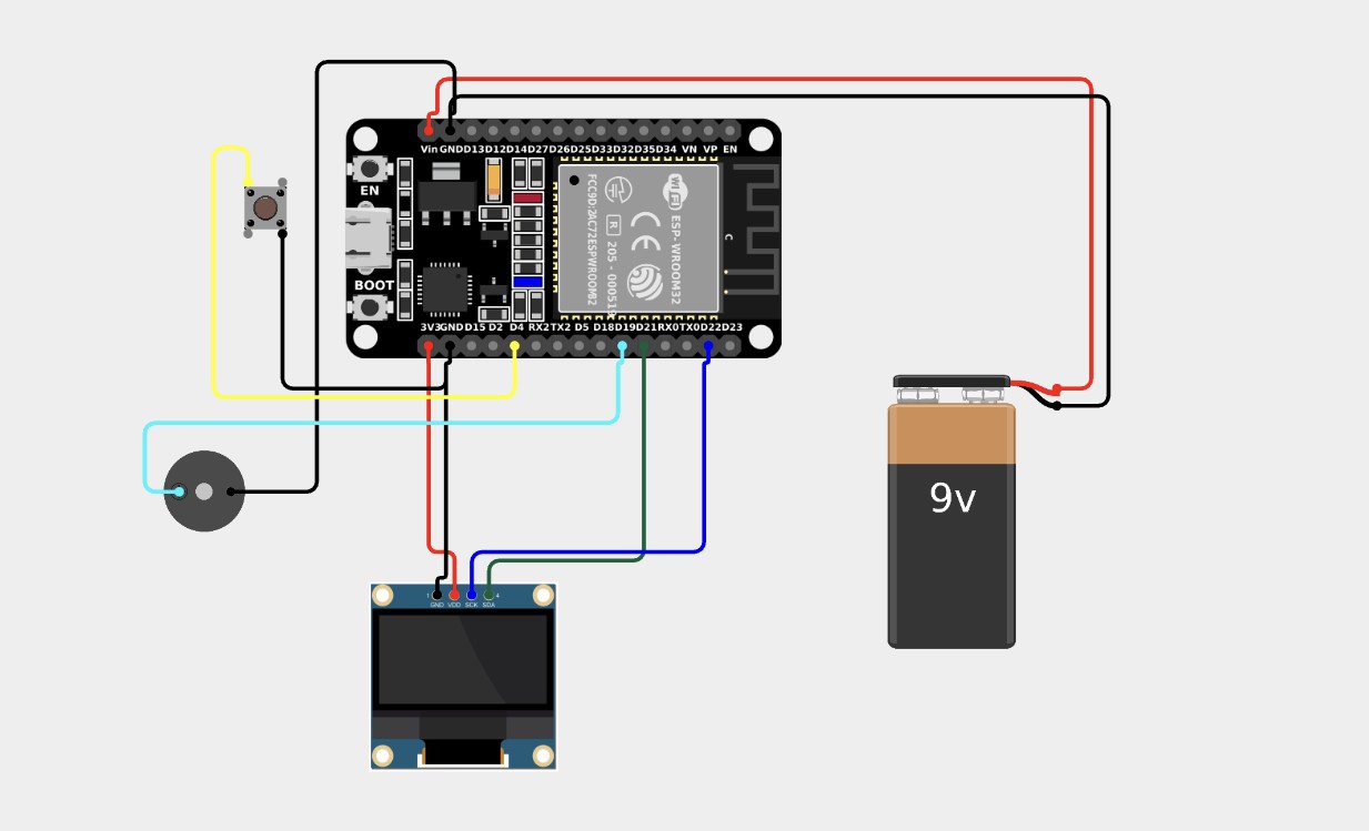

    Wiring
    _________________________________________
    |    Component      |	 Pin	| ESP32 |
    |OLED VCC           |	  —	| 3V3   |
    |OLED GND           | 	  —	|GND    |
    |OLED SDA           |	  —	|GPIO 21|
    |OLED SCL           |	  —	|GPIO 22|
    |Button leg 1       |	  —	|GPIO 4 |
    |Button leg 2       |	  —	|GND    |
    |Buzzer + (optional)|	  —	|GPIO 19|
    |Buzzer − (optional)|	  —	|GND    |
    The button relies on the ESP32's internal pull-up resistor, so no external resistor is needed — it just needs to pull the pin to ground when pressed. If using a passive buzzer, polarity generally doesn't matter; active buzzers are sometimes polarized, so check the datasheet if unclear. A quick continuity check with a multimeter before powering on is worth doing to rule out shorts.
