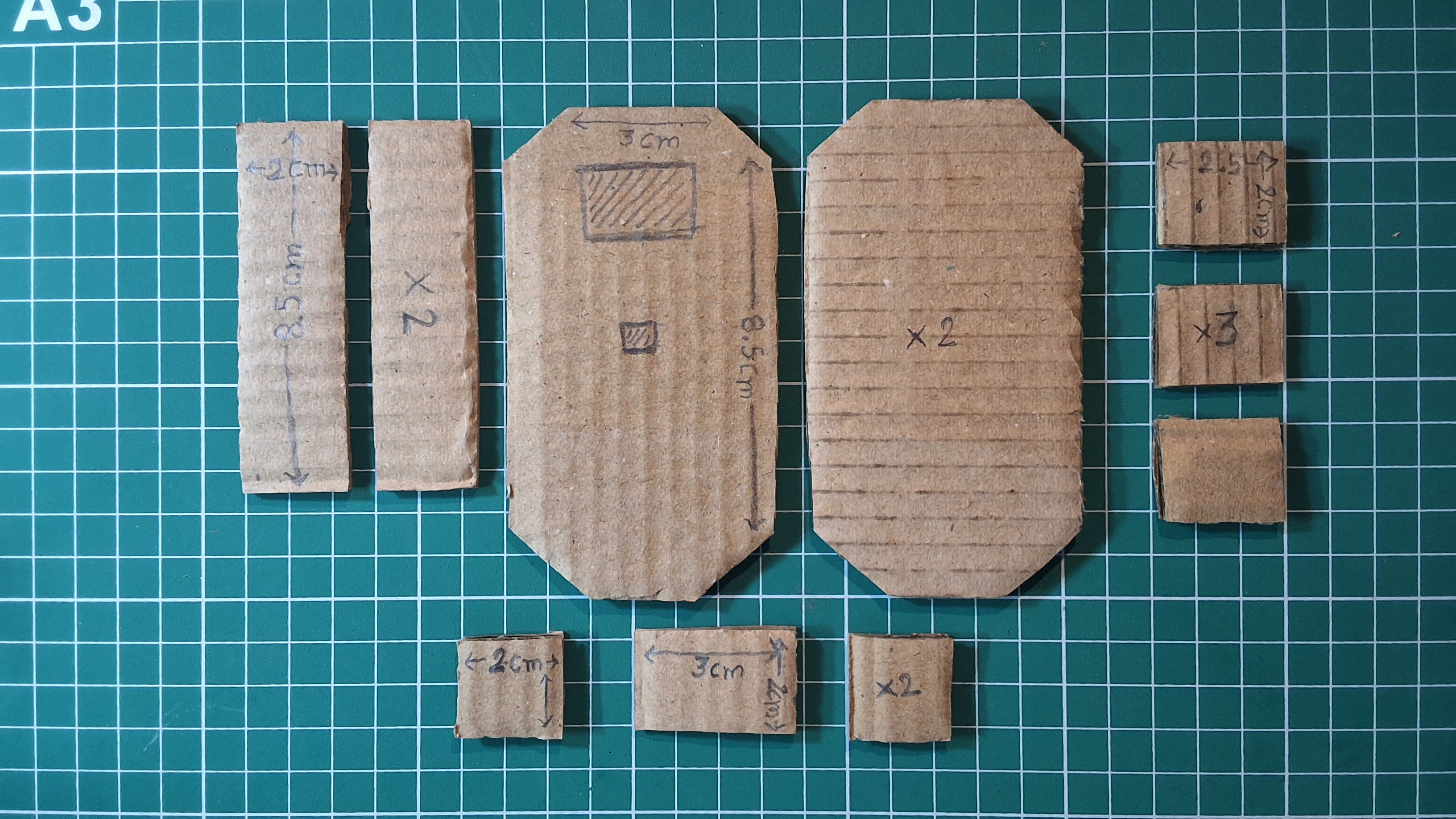

4Cutting the enclosure
Cut from a single sheet of corrugated cardboard against a cutting mat:
- 2× side strips — 2cm × 8.5cm (left/right walls)
- 2× plain panels — 3cm × 8.5cm (front and back, corners clipped at an angle for a cleaner, sturdier profile)
- 3× small squares — 2.5cm × 2cm (internal standoffs)
- 2× small squares — 2cm × 2cm (additional standoffs/reinforcement)
- 1× small rectangle — 3cm × 2cm (buzzer mounting tab)
Rather than working from fixed measurements, trace the actual OLED module and button cap directly onto the front panel before cutting — component sizes vary enough between suppliers that a fixed template will fight you. The OLED window sits centered near the top of the panel; the button cutout sits below it, sized just under the button cap so it seats against the cardboard.

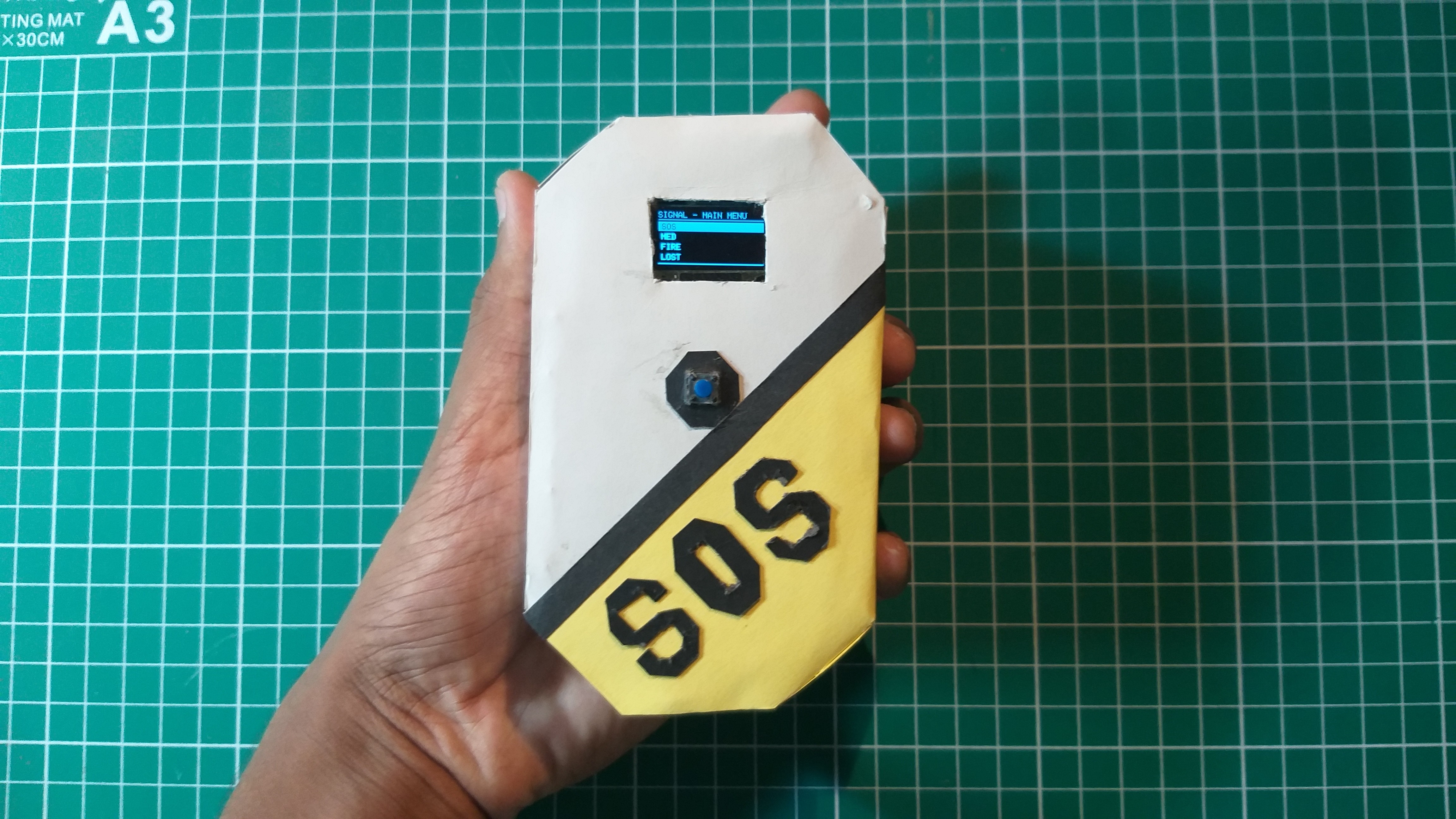

5Powering on and testing the menu
- Glue the two side strips to the base panel first, standing upright along its long edges.
- Attach the front panel (with cutouts) and the plain back panel, aligning the clipped corners so seams sit flush.
- Glue the small squares in as internal standoffs, holding the electronics stack at the height where the OLED presses flush against its window.
- Mount the buzzer against its grille cutout using the mounting tab (skip this if building without a buzzer).
- Glue the OLED into its window cutout, and the button through its hole.
- Mount the remaining electronics (ESP32, wiring) to the back panel, then dry-fit and power on before sealing the final seam — much easier to trim cardboard than add it back once glued.

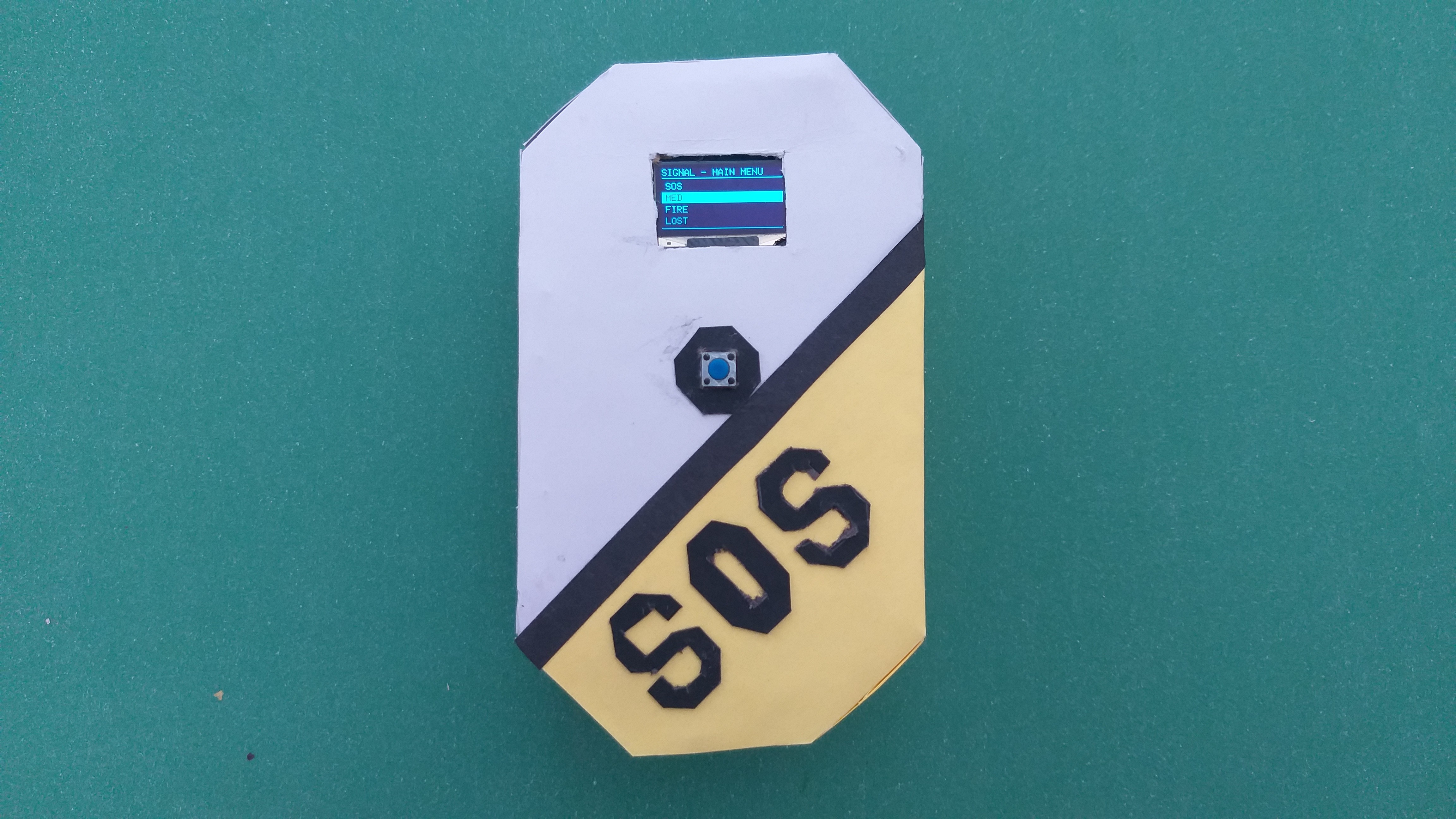

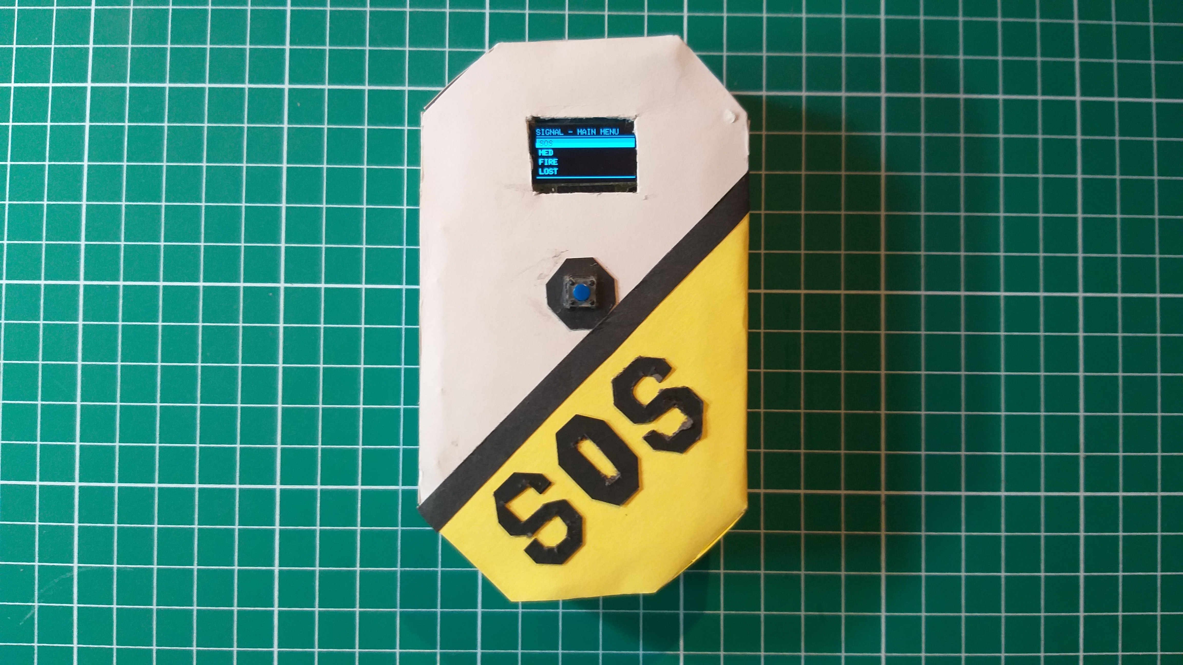

6Assembly
On boot, the OLED shows the SIGNAL splash screen, then drops into the main menu — SOS, MED, FIRE, LOST, HERE, OK, and 2.4G BEACON — with the selected preset shown in an inverted highlight bar. Single-click cycles through the list; a long press (~600ms) activates whichever preset is highlighted; a double-click at any point returns to this menu.

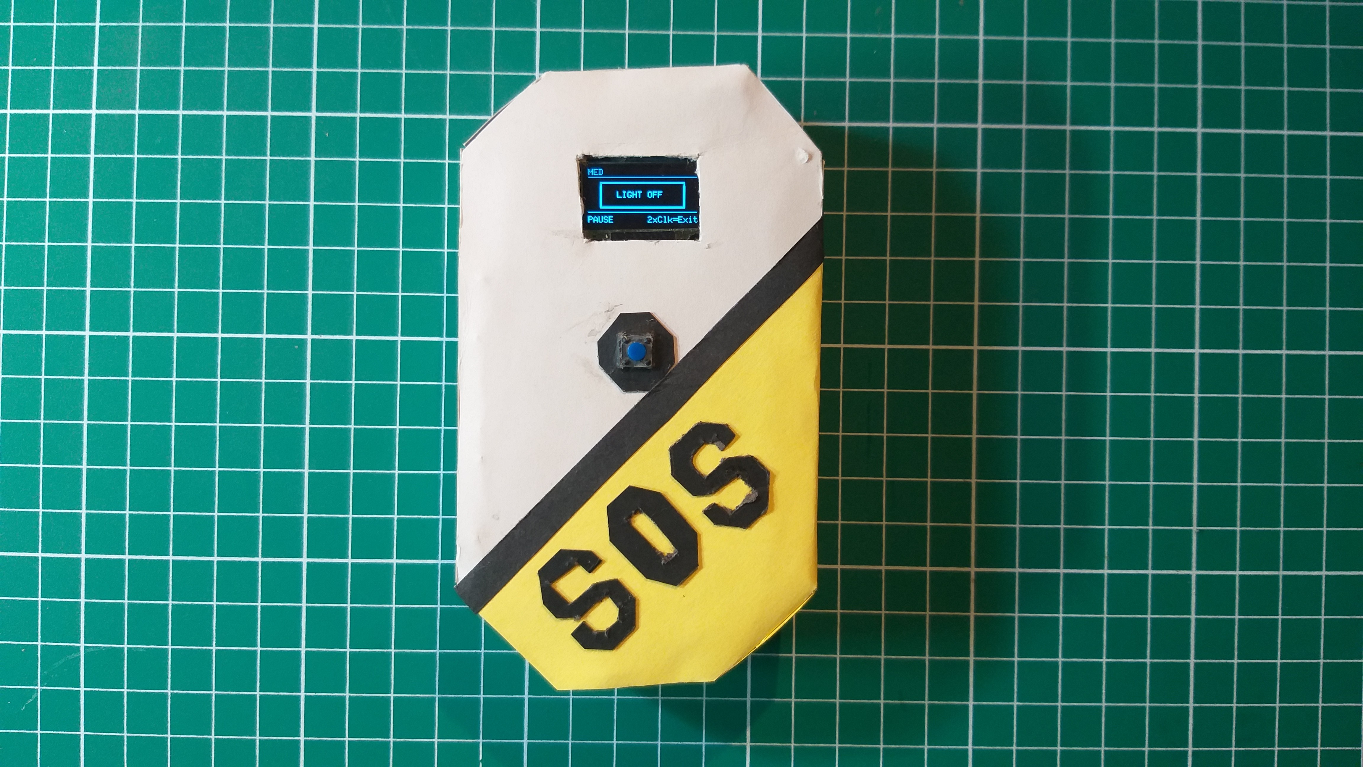

7Morse pacer in action
Once a preset is activated, the display switches into pacing mode. The top bar shows the active message; the center alternates between a filled "LIGHT ON" block and an outlined "LIGHT OFF" box, synced exactly to that message's Morse timing. Hold a flashlight and toggle it in time with the display — SIGNAL handles the Morse translation and timing, so no prior knowledge of the code is required. The bottom of the screen shows the current symbol (dot, dash, or pause) for reference, and the buzzer (if wired in) beeps in sync with the same pattern. The message loops continuously until double-clicked to stop.
