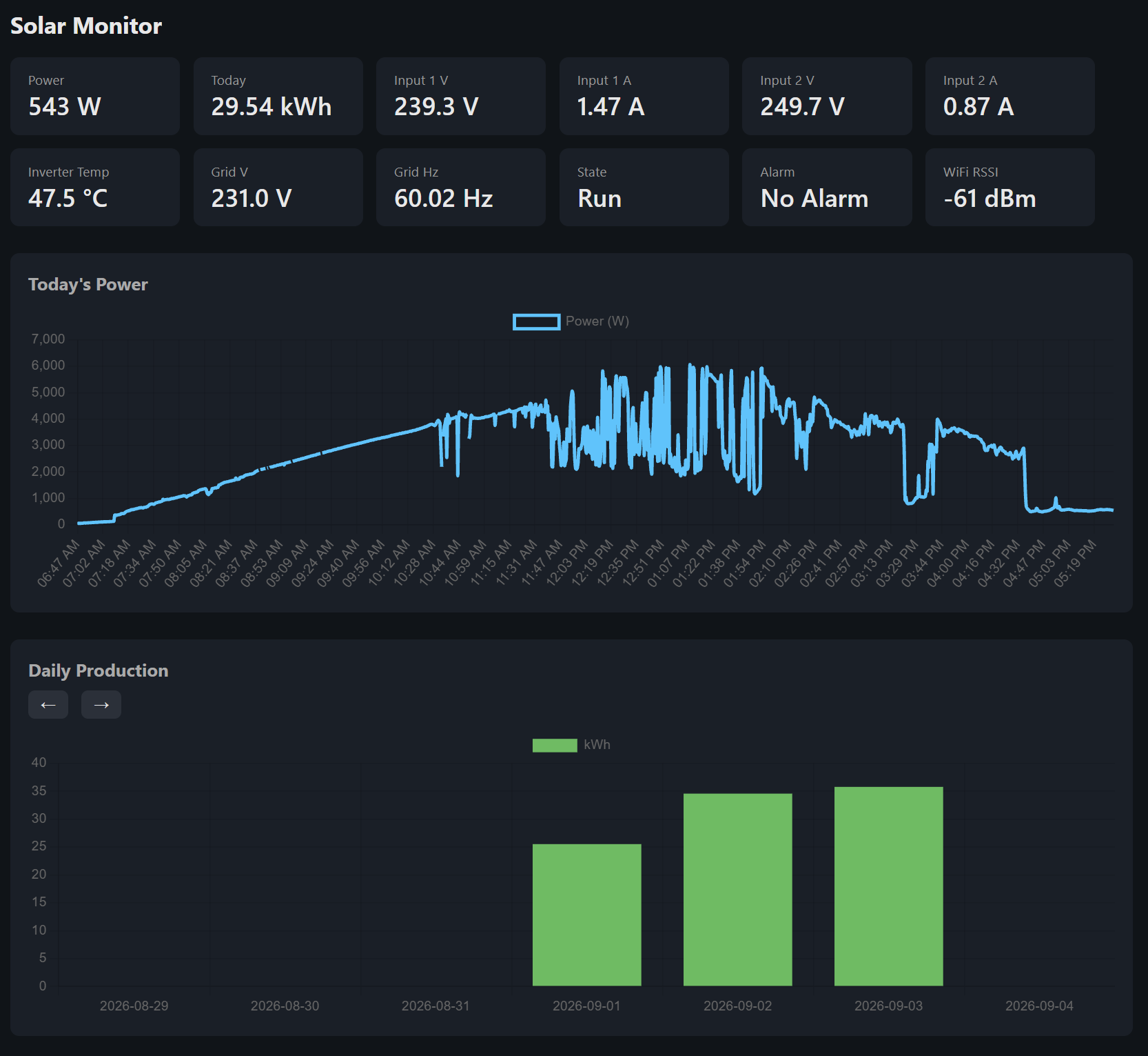

The webserver code gets json data from the ESP32 board and makes it available to view on a webpage accessible from my wifi network. The webserver is written in Python, using bottle, and resides on a Raspberry Pi 2 attached to my wifi router with a short ethernet cable. Here's the resulting webpage snippet after a few days of operation:
Today was a bit cloudy, but no rain. Still it produced nearly 30kWh. Daily/weekly/monthly totals are stored by the Raspberry Pi and made available to view on the webpage, and the data is scrollable.
There are two arrays: a larger one facing south and a smaller one facing west. I don't know with any certainty, but the total peak wattage is around 7kW. The inverter is rated at 6kW, but will derate its output if overloaded, which probably never occurs.
