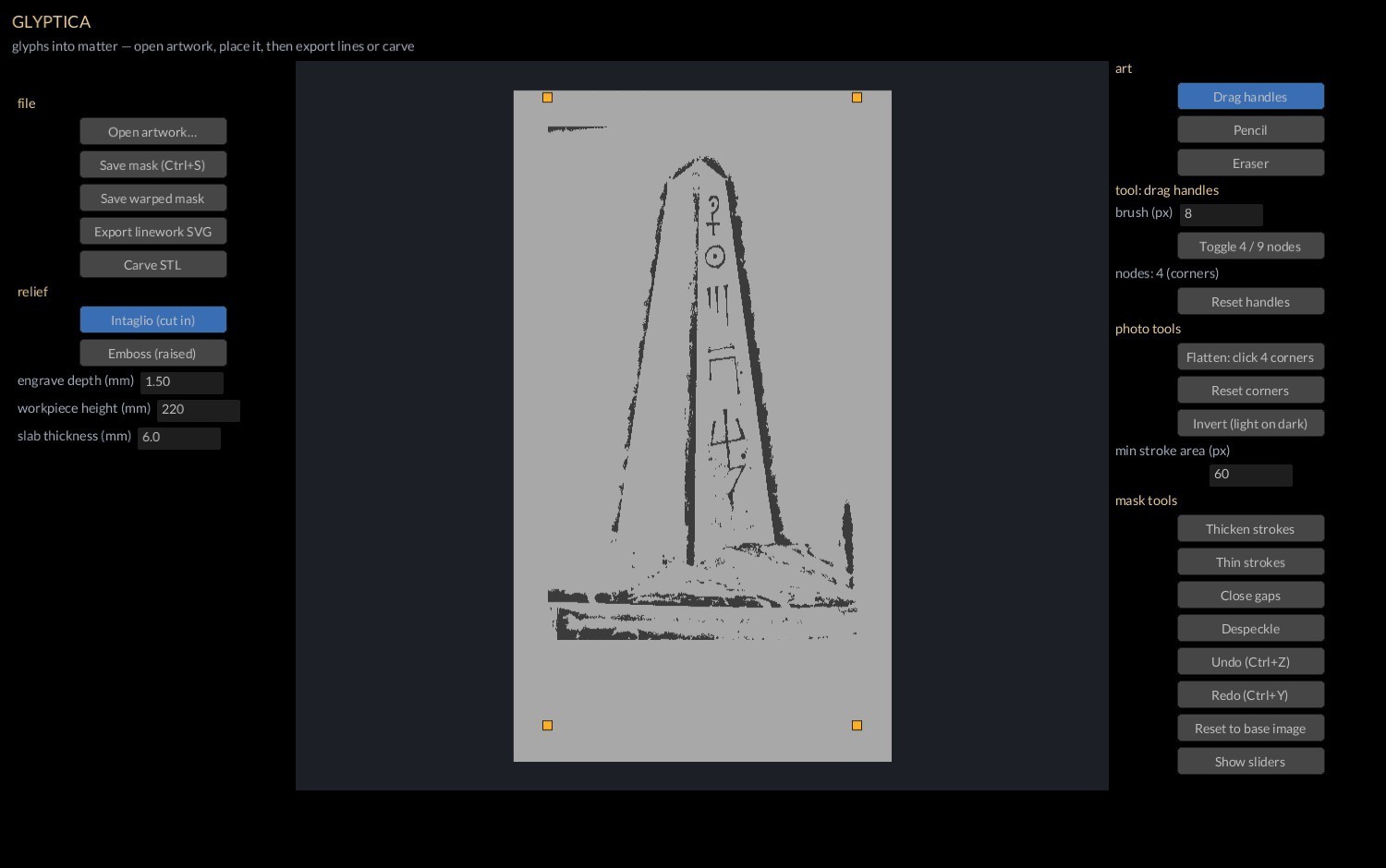

    **Glyptica** is the module that turned a thirty-year-old pencil drawing into the sigils on
    the Obelisk. Photograph a page, click its four corners and it un-warps flat, the
    linework comes off the paper, you clean it and place it, and it hands you two things a
    machine can make: SVG linework for a laser or plasma cutter, and a carved STL in the
    artwork's own shape, intaglio or emboss, ready to print or to boolean onto a part in Structor. Named
    for
    glyptics, the old art of cutting figures into stone. Any Debian box, no GPU.

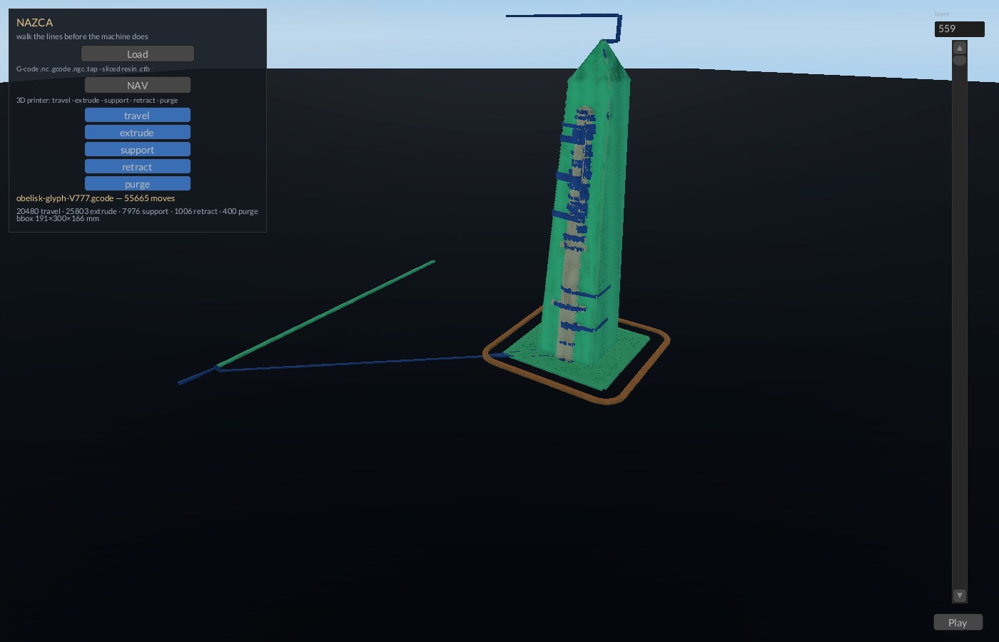

    **Nazca** is the viewer. Load the G-code your CAM wrote or the .ctb your slicer packed and
    walk the path in 3D before any iron moves or resin cures. It reads the file to tell
    what machine it's for, printer, router, laser or plasma, and colours every move by what
    it does: travel, cut, plunge, pierce, extrude, retract. Scrub by layer or by move, hide a
    class, play it through. Sliced resin files scrub and play layer by layer too, with a stack
    view that grows the print under the camera. It reads; it never writes.
    Named for the lines on the Peruvian plain that people walked as preparation.
    Both ship the way GilgaMESH did: working test prototypes with the rough edges in the
    release notes rather than hidden. Glyptica's photo detection is a mid-tone heuristic, so
    a very dark or very light page may need the Invert switch; its slab is flat, and curved
    faces are Structor's boolean job. Nazca walks G0 to G3 with arcs and doesn't simulate
    offset or incremental dialect codes, so a file leaning on those won't preview true.
    Both are pre-beta and may have issues. Say what breaks.
