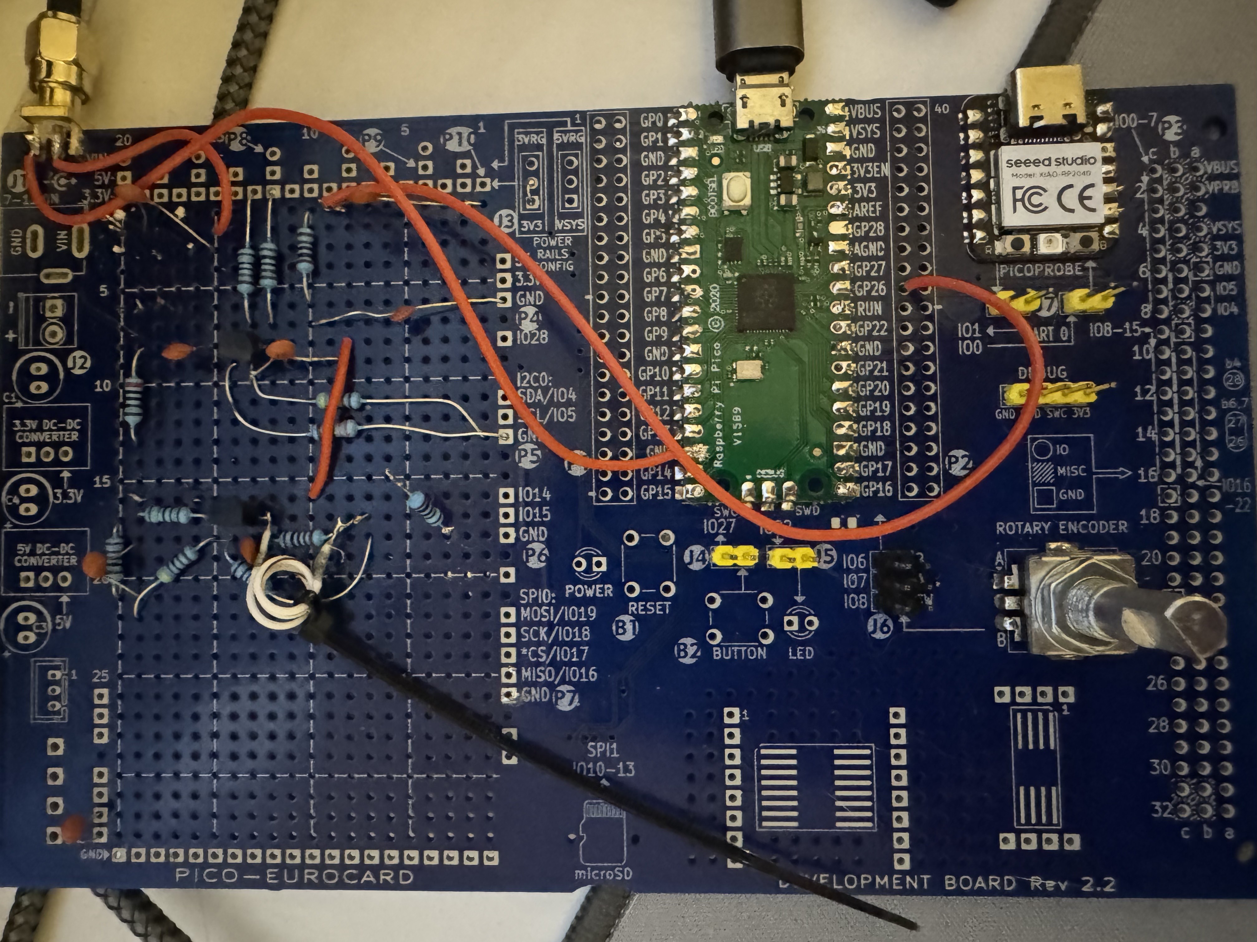

  • The first audio I like enough to share!
    Oleg Kulyk • 09/09/2026 at 19:25 • 0 comments
    I managed to get the first audio that I intended to receive.
    The final solution includes 2 cheap transistors: one for RF amplification and one for mixing.
    The whole project idea isn't novel, but most PicoSDRs require some sort of LO that is stable enough and usable, so they build it around a SI5351 or similar synth IC. I wanted to prove that I can do it more easily and more cheaply, so Raspberry Pi Pico's PLL is used to generate arbitrary LO to drive the mixer.
    The only caveat is that the integer dividers are stable enough to use as LO. Still, other options would just lead to more noise, which is doable, but isn't great.
    The trick is that I was using the HackRF to tune the analog part a lot. It was quite difficult to tune the RF amp collector load, but luckily it is pretty good enough.
    The testbench was:
    HackRF sends signal via coax -> 30db attenuator -> my crude SDR
    This way, I was able to use the RP Pico ADC to test all the samples after my changes and kind of characterize the RF frontend.
    Once RF amplification was tuned on my crude board, it was just a matter of DSP magic on the RP Pico side to demodulate FM and send chunks via USB to the computer.
    You can find a reception sample in the files of this project.
    So yeah, if you have 2 transistors, a bunch of time and passives, together with some MCU that can both digest hundreds of kHz via ADC and produce the needed frequency (harmonics count) - you can build an RF receiver.
    I'm interested in experimenting with higher frequencies and different modulations, as LoRa shouldn't be something hard for RP Pico-like hardware.
    The current version looks like this.
    While experimenting, I improved SNR by 1.2dB just by connecting the ground wire directly to the RP Pico pin, so this is a successful attempt at creating hardware bad enough for further DSP experiments.

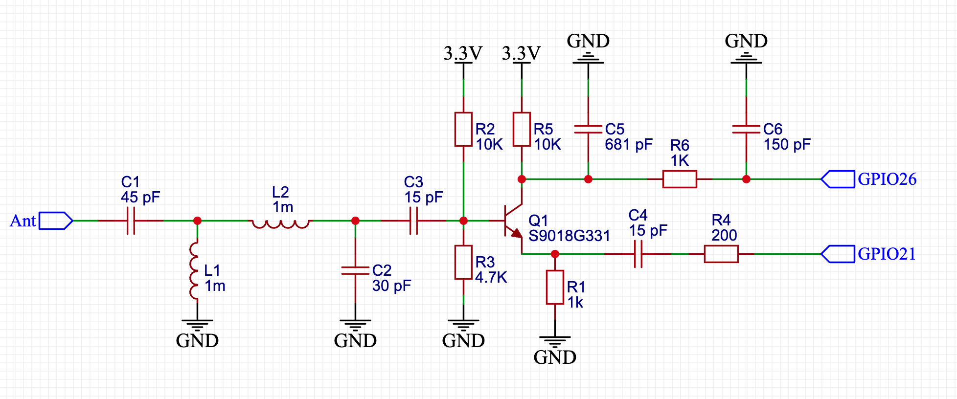

  • Schematics and HackRF results

    I made myself document the current schematics, since I did a few experiments and found that some passives could help a lot and ease my life while I'm trying to get audio from an FM broadcast using my Raspberry Pi Pico and one BJT transistor.
    It's a well-known superheterodyne, but crude.
    Initially, I was experimenting with the transistor alone, with almost no passives, since I was able to detect LO±RF on the ADC.
    The goal then is to extract IF from the frequency soup on the BJT's collector and DSP it using affordable hardware, aka RP Pico.
    A band-pass filter on the antenna was added later, as I got quite good results extracting melody sent from HackRF as FM broadcast via coax, but failed to pick up a live station.
    Since I'm trying to limit myself to only 1 transistor now, I would test the RF bandpass first, and later on, the next candidate for amplification could be an IF stage, which sits on the collector, as I'm trying to avoid things like oscillations while building an LNA and amplifying RF.
    The funniest part is that, while testing tone transmission with HackRF, it managed to pick up a real station when HackRF's TX was off. So band-pass could do ok, as the ADC doesn't seem to be a limiting factor.
