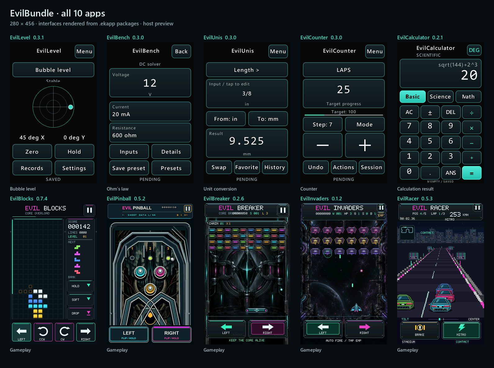

    I originally needed a FIDO2 key. It now has a scientific calculator and plays pinball. Apparently, I cannot be trusted with spare flash storage.
    EvilBundle now contains ten apps, loaded from microSD as .ekapp packages.
    The useful half
    • EvilLevel — an IMU-based bubble level, angle and slope measurement, with zeroing, hold and saved readings.
    • EvilBench — electronics calculations: Ohm’s law, LED resistors, voltage dividers, RC filters, 555 timers and component markings.
    • EvilUnis — unit conversion, including editable expressions, favourites, history and custom units.
    • EvilCounter — multiple counters, adjustable steps, targets and timed sessions.
    • EvilCalculator — a scientific calculator with powers, roots, trigonometry, logarithms, combinatorics, memory and an expression editor.
    The “yes, this was necessary” half
    EvilBlocks, EvilPinball, EvilBreaker, EvilInvaders and EvilRacer. Because debugging firmware apparently wasn’t enough of a time sink.
    The screenshot sheet below shows actual .ekapp output captured in the firmware host renderer. It covers the current interfaces; it does not replace testing each app on the physical device.
    EvilBundle remains in a private repository for now. This is a progress update, not a public bundle release.

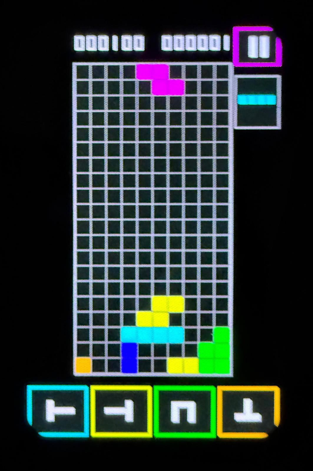

    WHAT RUNNING AN APP LOOKS LIKE
    Copy a .ekapp file to /evilkey/apps/ on a FAT microSD card. In the normal FIDO USB role, open Settings → Apps, select it and press RUN. There is no install database or uninstall command: replacing or removing the file on the card does the job. Swipe right while an app runs and the firmware asks Yes/No before leaving it. Apps, Settings and the screensaver also remain available when USB power comes from a charger rather than a computer.
    THE BOUNDARY BETWEEN AN APP AND FIRMWARE
    An .ekapp contains a small WebAssembly module plus a header declaring its ID, version, owner, license, ABI and SHA-256 digest. The current package format is revision 2 and the public interface is ABI v3. The app has zero imports. Firmware calls app_init and app_step; each step receives elapsed time and raw touch coordinates. The app defines its own controls and returns a list of drawing commands in its memory. Firmware checks the complete command list before displaying it and enforces memory, drawing and execution limits.
    The current ABI deliberately exposes display and touch only. It does not give an app filesystem, USB, network, NVS, FIDO credential or native pointer access. The package digest detects corruption; it does not prove who wrote the app. Each app can carry its own rights owner and license. The ABI v3 specification (https://github.com/mwr666/EvilKey-firmware/blob/v0.4.0/apps/ABI_V3.md) and minimal MIT SDK declarations (https://github.com/mwr666/EvilKey-firmware/tree/v0.4.0/apps/sdk) are public. The AGPLv3 firmware repository contains the interpreter, but does not bundle any separate application source or package.
    WHAT THIS OPENS UP, AND WHAT IT DOES NOT
    Games, visual tools and interactive utilities using the existing screen and touch interface can be developed and copied to the card independently of firmware releases. This greatly widens the palette of experiments I can try after hearing your ideas. Requests that need the IMU, USB behavior, persistent app storage or another new device capability would first need a considered ABI and firmware change. I want that boundary to stay explicit, especially on a device that also holds FIDO credentials.
    Preview: EvilBlocks running on EvilKey hardware during testing. This separate app is not included in the public firmware v0.4.0 release.
