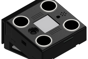

NeuroMouse V2.0 from above in a maze cell.
