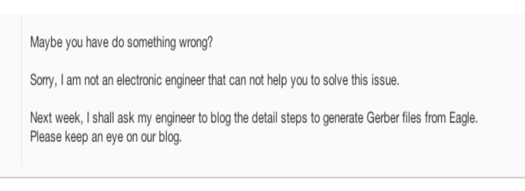

    Also if you read my last log entry you will notice I had some trouble getting a .GKO from the CAM job provided by ITEAD studios.  A .GKO is a board outline file.  Unfortunately, the CAM job provided by ITEAD does not produce a .GKO but it does produce a .do and a .GML which appear to be similar.  I was unsure which file I should send in to I emailed ITEAD's customer service.
    ITEAD opened a service ticket and immediately closed it.  I did not get a response from them.  Two days later I sent them a nasty gram and I got this response.
    Maybe I am doing something wrong, but this customer service sucks.  I used ITEAD once before and I think I just renamed my .GML to .GKO.  I'll try it and see what happens.
