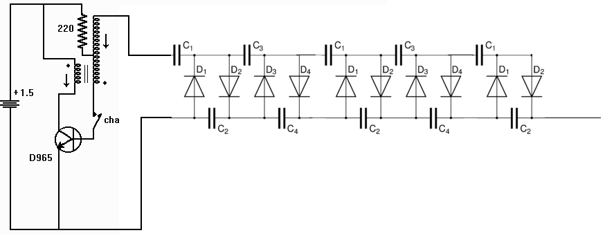

    One way of generating a high voltage source is to use a voltage multiplier with a high voltage AC source. I bought some 0.01uF 3kV caps from China as spares after fixing my scope. I also bought some 1N4007 high voltage rectifier (1000V) as they were cheap.

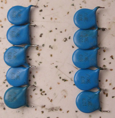

    I made some "springs" out of the trimmed leads. The caps are divided into two groups. They are laid out side by side and solder just enough to hold them together.
    A voltage multiplier looks like this. There are two rows of capacitors that are interconnected with diodes. 10 caps and 10 diodes makes a 5X multiplier.

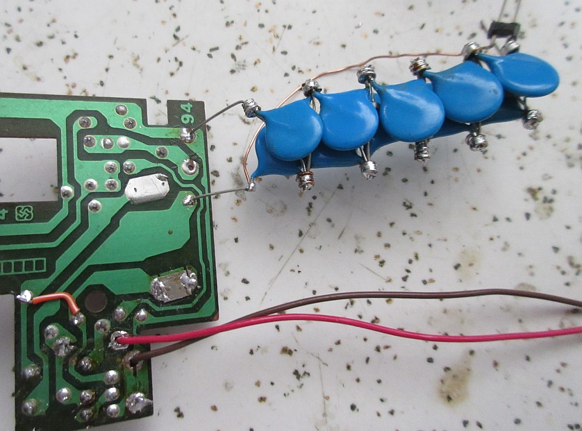

    The springs are used to hold and connect the leads together in this free form multiplier. The second row of capacitor goes on top in the opposite direction.
    I guess I should have connected the bare wire to the lower left terminal instead of top.
    I stripped off some of the parts (large capacitor, flash tube) for safety. I also desoldered one of the leads of the rectifier to disconnect the rest of the high voltage circuits.
    I connect the multiplier to the AC output. The resistor in mine is 82R instead of 220R. The following shows a 5X multiplier. The multiplier can be extended to a certain point by just adding more diodes and caps.

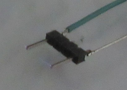

    I swapped the header I had previously as the spacing was a bit too close so I could not control where it sparks. I bent the pins to form a spark gap of about 0.1". I also connected the bare wire to the right terminal this time.

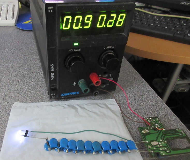

    I hooked up my bench supply and started getting sparks at around 1.2V. Each arc discharges the capacitor and the charge has to build up again. At around 1.5V, the current was 0.4A.
    So according to this chart from here, the output is a bit below 5kV. My guess is around 3-ish. This means that the (loaded) AC output from the flash circuit is around 600V.
    With the additional block, I now have a 10X multiplier. I have to change the spark gap a couple of times to now 0.3" (7.62mm). :)
    It starts arcing at around 0.9V, so the output is round 9000V at this point.
    This shows the corona discharge just below the threshold for arcing.
