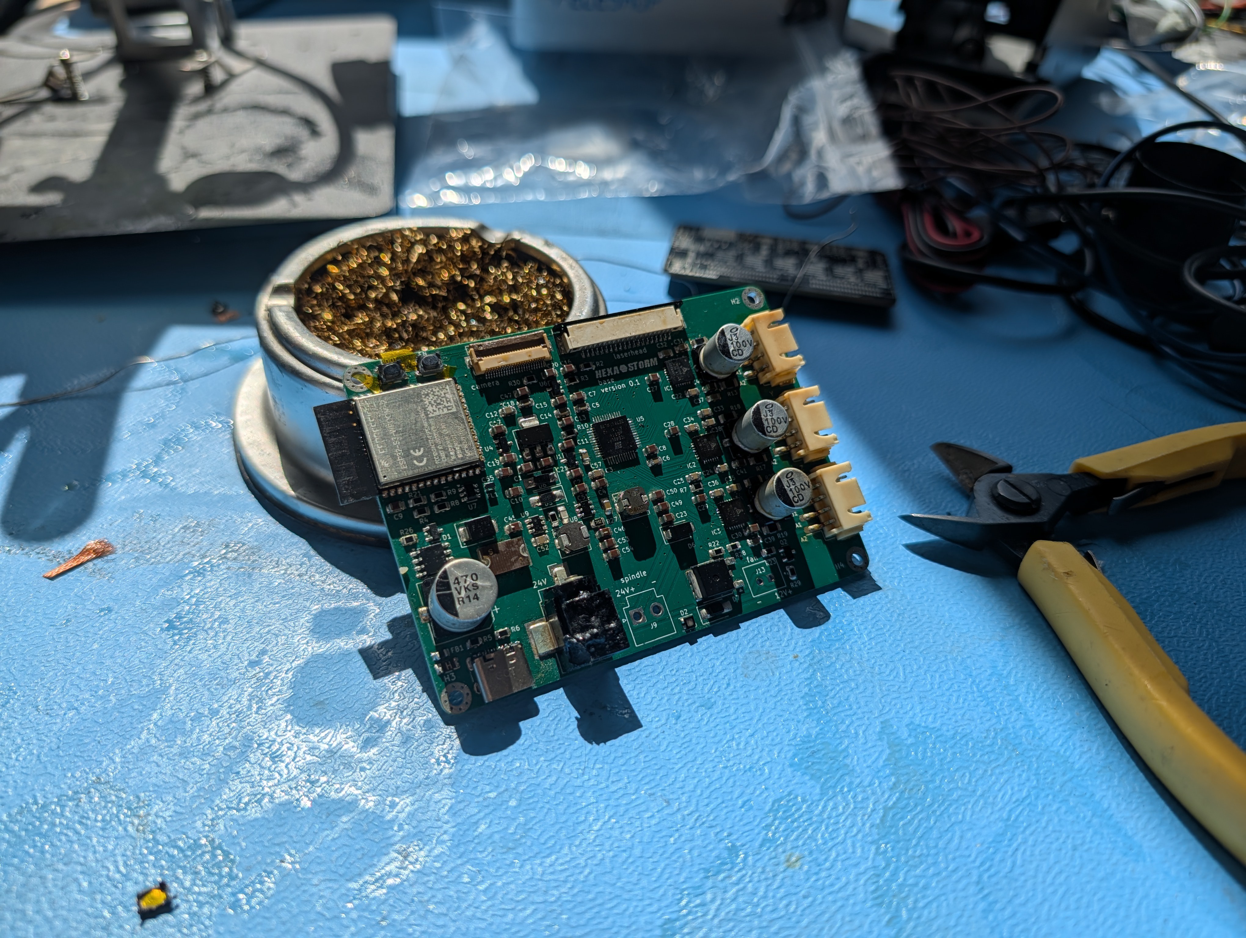

  • new board working
    Hexastorm05/30/2026 at 18:46 0 comments
    The newest revision of the Open Hardware Laser Scanner board is finally alive! Upgrading to a 4-layer design packed with extra safety features was 100% the right call.
    Of course, getting here wasn't without its hurdles. Here is a quick rundown of the crazy bugs I ran into getting this revision off the ground:
    The Rogue Power Supply: My Vevor DC power supply completely failed and suddenly started dumping 48V into my 24V rail (I'm pretty sure that violates a regulation or two). Luckily, my TVS diode did exactly what it was supposed to do and saved the board. In my confusion ("wait, why is this broken?"), I measured 24V, removed the diode to test, and accidentally hit the unprotected board with 48V. Incredibly, the board survived! Note to self: always trust the TVS diode.
    The Silent TMC2209s (An ESP-IDF Gotcha): My TMC2209 stepper drivers still weren't communicating, which was actually one of the main reasons I spun this new board in the first place. It turns out the culprit was a sneaky change in the ESP-IDF toolchain that altered the UART protocol. Previously, the protocol would let the transmission line float after a successful transfer; now, it actively ties it to 0V. Because of the high drive strength of the ESP32-S3, the standard 1K resistor used between TX and RX for single-wire UART isn't enough anymore. Bumping that resistor up to ~5.4K ohms fixed the issue completely.
    A Hot Camera Mistake: I learned the hard way that the camera FFC connector I used was a top-contact style, not bottom-contact. I plugged the ribbon cable in backwards. Fortunately, the camera survived the ordeal, though it got alarmingly hot before I caught the mistake
    Minor Schematic Gremlins: The schematic for a basic button was incorrect. A minor inconvenience compared to the rest, but fixed nonetheless.
    All in all, the V2 board is a massive step up. The 4-layer stackup makes routing so much cleaner, and having those extra safety features already paid off. Onward to the next step of the build!
    Board was purchased from PCBway. We thank PCBway for the sponsorship of the previous board and they will be featured in upcoming video. For now it was easier to simply purchase instead of relying on sponsorship.

    The boards sponsored by PCBWay are shown below. Progress in the last days has been good.
    Following things are working: prism motor (spins), laserdiode (can turn on & pogo pin system works), TMC2209 communications work, ESP32 and ICEUP5K (FPGA) work.
    Progress has been as follows:
        -  9 december:  received boards
        -  14 december  boards populated & compute board working
                                  numbers of some parts where wrong, which required extra shipment from mouser
        -  19 december extension board populated (after receipt parts)
                                 I encountered a bug.
        -  30 december  bug has been resolved
                                  Two issues: - schema error (5V connected to 3.3V, this has been mitigated with soldering tricks)
                                                      - stepper motors communicate via UART1 which can create issues with UART0 (micropython repl)
                                                        this is a bug upstream but can be mitigated by a trick in the boot.py script.
      -  2 january       Destroyed laptop (applied 12V over USB input)
      -  6 january       Mounted motor, encountered issues moved to different board
      -  7,8 january     Changed code, ESP32 communicates with FPGA,  spinning of prism work
      -  9 january        Laser works (forward diode voltage of 2.5V)
      - 13 january        Laser can be calibrated while on (pogo sytem works good)
                                 Laser diode prism test --> pass
     - 14 january         Stability test / Mounting on machine
                                  laser reaches stability criterion
                                  mirror position without cylinder lens does work
                                  mirror position for cylinder does not work
                                      (cylinder lens might work, mirror position not optimal, needs testing)
    -  18 january         x and y motor work, homing switches work
