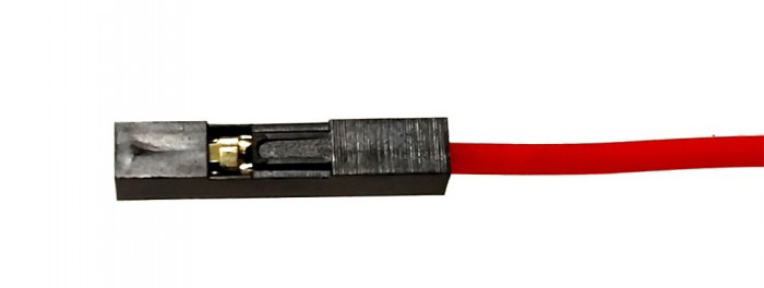

- Cables to connect. I have used a combination of fastons and female pins to make cables.Notice that there are two buttons, so with four fastons and four pins you have it done. It can also be welded, etc.
| Faston (for the side of the microswitch) |
- Fastons (3.00 € / 100 units) is perfect. Pines (2.69 € / 150 unidades) Plastic covers (3.00 € / 100 units). EYE: When you buy the button, look at the width of the microswitch to buy the faston that corresponds (there are of 6.3mm, 4.8mm, etc). The cable any finite cable is worth.

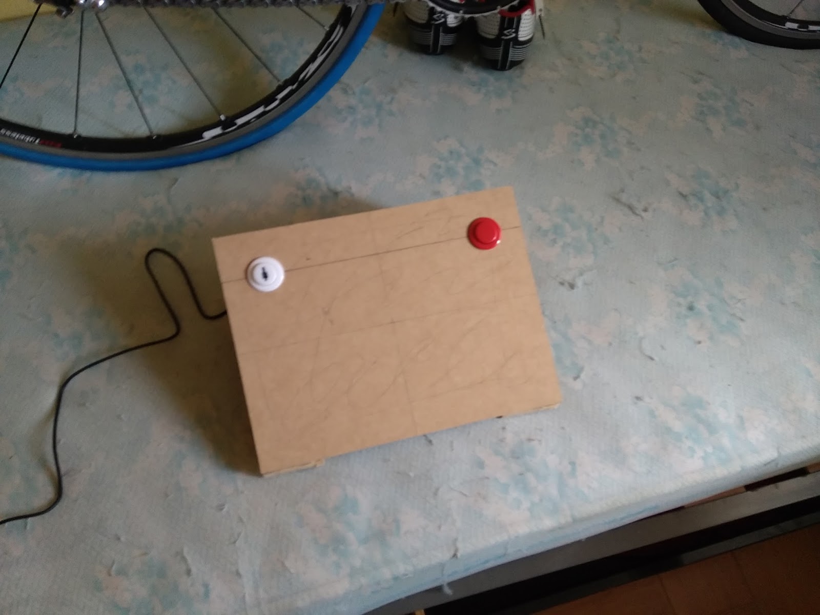

The first thing is to make the furniture . To do this, I pulled a pair of scrapbooks I had for DM house of 1cm thick. It can be made with any type of wood, but ideally it is resistant, mechanized well and can be joined without much mess. In my case, the DM will stick well with hot glue (the typical bar guns) so the design is simple: an iron in which we make two holes for the buttons, one side to raise it to the desired height, and a pair Of feet to give stability. Each one that is made to your measure, since each is comfortable with a certain height, etc. There is also the option of using a manufactured footrest and make two holes.
| The furniture seen from above |
There is not much magic, I cut the slats with the manual saw, I make the holes with the crown drill, I glue with the hot glue gun helped with a few cats and ready. To prevent it from sliding (and sliding) I have pasted four legs of those of anti-slip rubber, as can be seen in the next photo. As you will see, DIY is not very complicated.
| The antidilding feet and the assembly of the furniture. |

The cables are prepared as follows: on the side of the Arduino, we mount a pin connector. For that we peel the cable, crimpamos the part of metal, and we put its plastic fuse. At the other end (the part of the microswitch) we put the plastic hood on the cable, and crimp the faston. Ready. We make four of these, which are what we are going to need. The length of the cable is important, so keep in mind how far you have drilled the holes and where you are going to pull the USB cable.

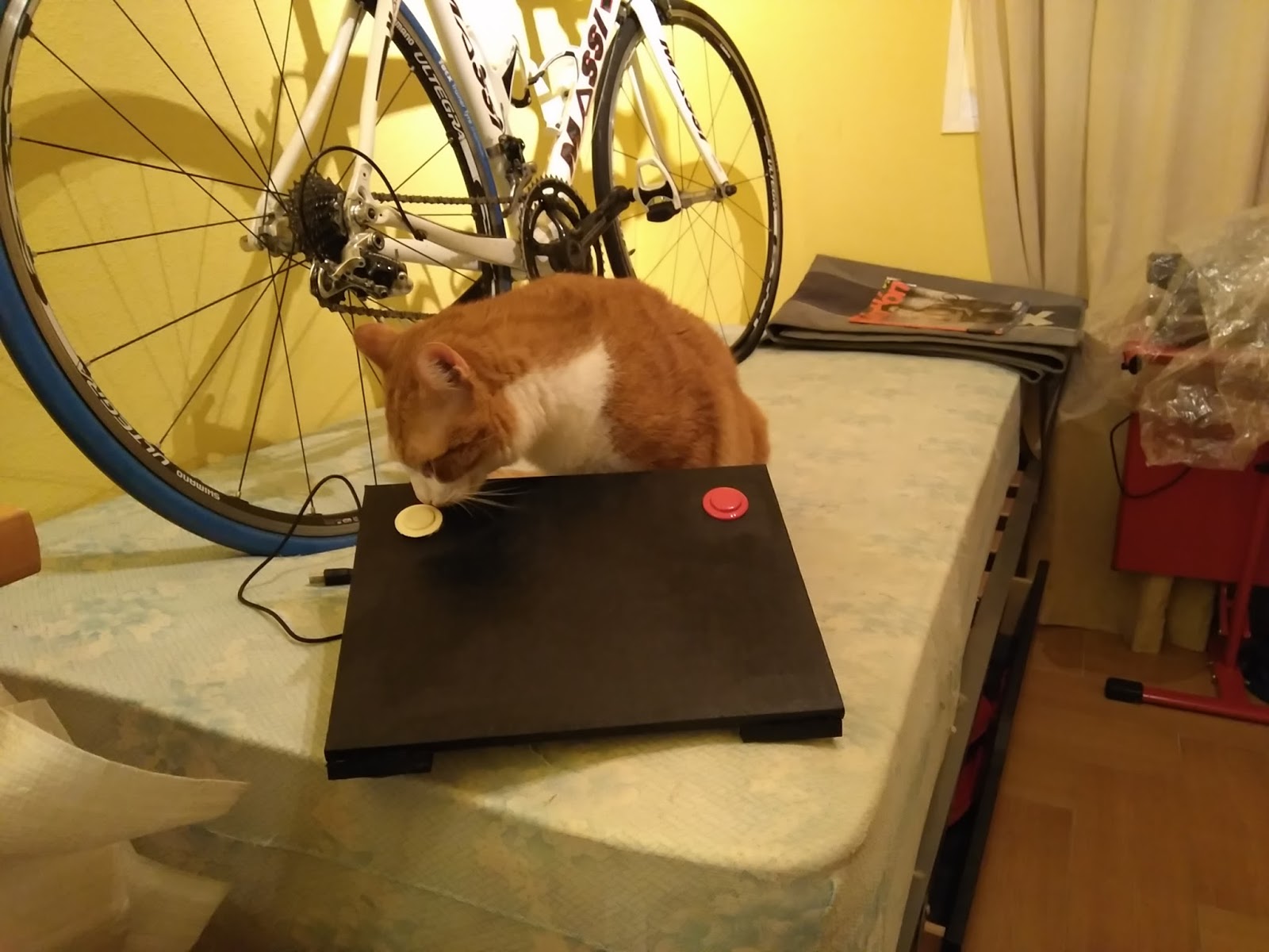

We tested on a notepad that by giving the buttons the letters Q and E are written ... and we already have it done. We open Rainbow Six Siege, we go to the configuration, Controls, we look for Incline and we configure it like Hold. And with that and a cake ... there we have it working! Let's enjoy it!.
After a little painting, the thing is much cooler.
| Already painted. |
| Quality Control by Firulais |
| All right! |
