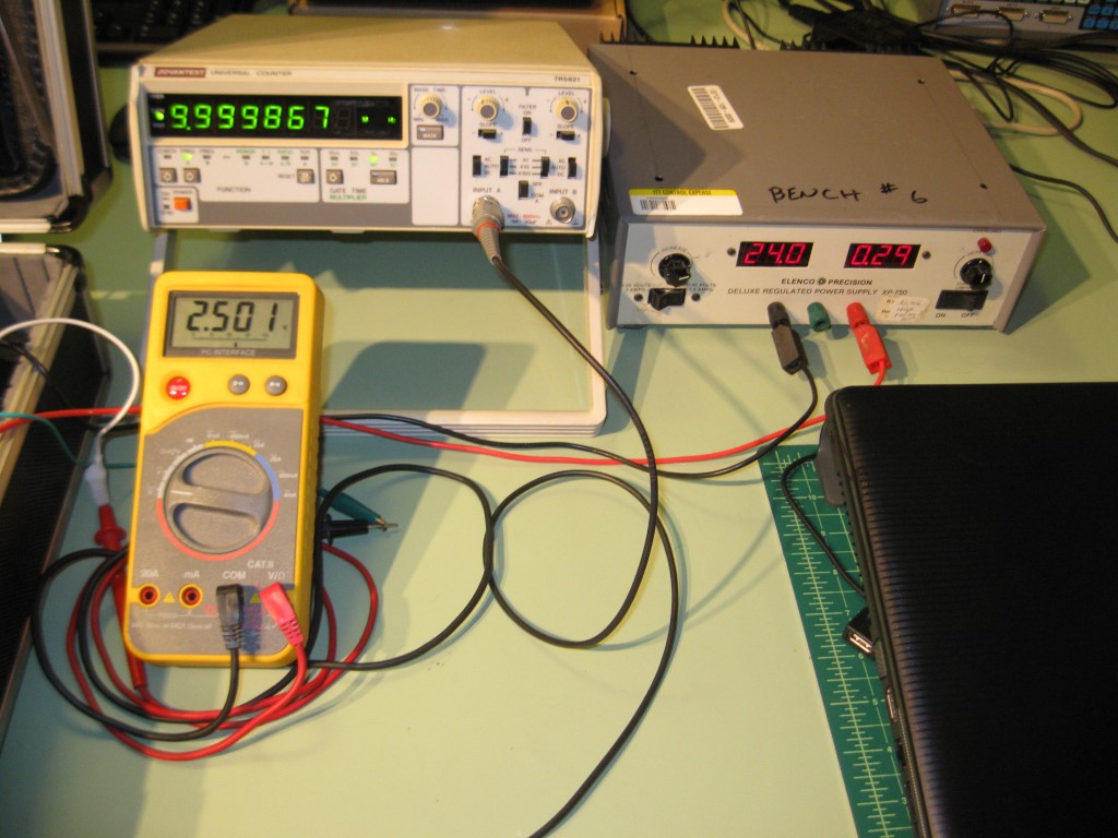

Pin 5, Heater Voltage and Pin 3 Output

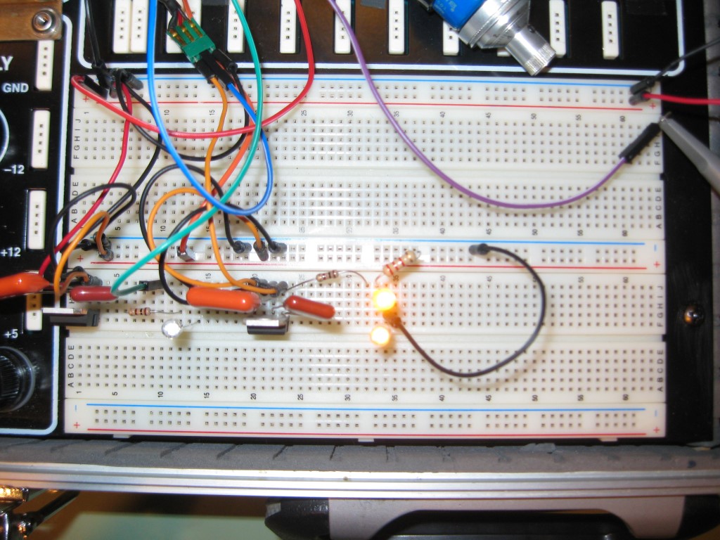

So, is it +24V or +15V? I breadboarded a 7815 and a 7805 – for the heater and EFC, respectively – and brought the +15v to Pin 5. I routed Pin 3′s output through a 50k precision 10-turn potentiometer as a voltage divider to apply a variable voltage to the EFC pin, Pin 2.

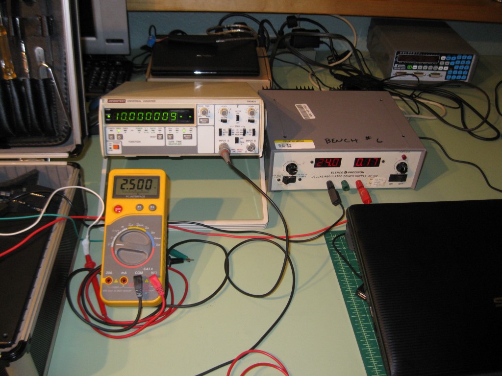

Upon applying 24 volts, the oscillator began operation and Pin 3 showed 5.12V. So far so good; the pot dividing the pin 3 voltage was adjusted to put 2.5V to the EFC pin and the oven was left to settle. About five minutes in, the frequency began to drop very quickly and I discovered that the EFC voltage had inexplicably dropped to 200mV in an instant. Pin 3 measured <0.5V at this time. Hmmm…
In an attempt to lower the time spent on this endeavor, I routed Pin 3 to the board and wired in an LED and resistor to act as an indicator. I also brought the 7805 output to the voltage divider pot and rebalanced it to 2.500V. After allowing the oven to cool slightly, I reapplied power and the Pin 3 LED immediately illuminated, only to fully extinguish less than a minute later. So. Pin 3 is in fact a TTL level oven indicator and NOT a voltage reference.
Timing the oven runtime on a coldstart, the 15V input is fully sufficient to get the oven up to temperature and keep it there indefinitely. As much as I would like to, I won’t be simplifying my power supply and running it on 24V. I do, however, wonder about that Pin 3. After the initial warmup, it does not go high again. Ever. But I know that oven has to be running intermittently to maintain the temp. Curious.
Pin 6, Output Level
Pin 6 does indeed output 2Vp-p
Supply Draw
At 24.0V, the OCXO draws 280mA during warmup and 170mA during constant operation. Keep in mind this is with the 15V and 5V regulators taking their source from the 24V supply as well, so there’s a reasonable bit of that wasted as heat.
