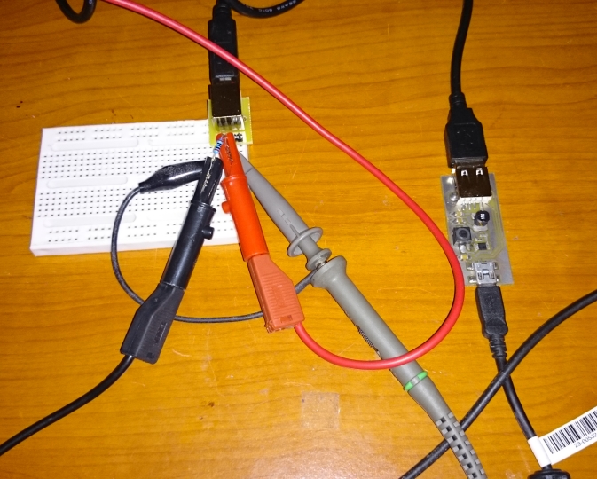

    Created a second board, now with the corrected USB connector pinout:
    And I built it:
    The problems started here.

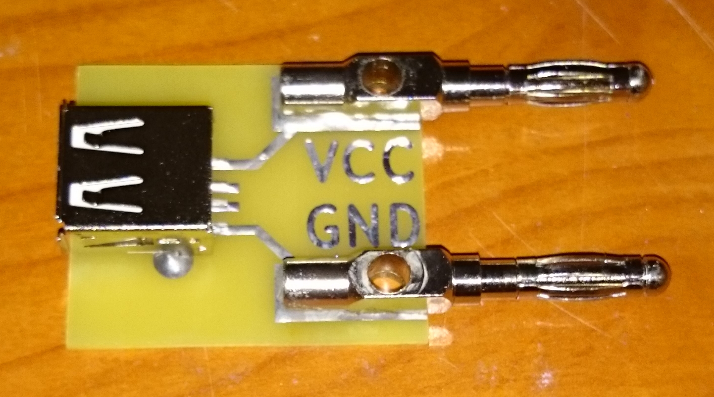

    The first thing, I wanted to test it. To test it it is not enough to connect it to some random USB source. I wanted a variable source.
    I've a lab supply, but it has no USB out. As I didn't wanted to cut any USB cables, I designed and built this small "tool":
    After this the testing went to a complete disaster.
    1. It was working from ~2V to 4.3V correctly, but when I went above 4.3V the output voltage just went above 5V. I was thinking this can be the result of miss of the minimal load, what usually required. So I setup the circuit with some (~50mA) load:
    Testing..
    At 2.0V:
    Looks good
    At 4.3V:
    Still looks good
    At 4.4V:
    Not so good anymore. :-(
    In addition, if I change the voltage, sometimes the whole circuit gets unstable. So the result clearly useless.
    I've possible explanations to the things above:
    - I've a crap layout - I'll try to enhance it in the next version
    - I've some sort circuit(-is) things in my build. I can admit that using solid groundplane around the surface mount inductors without insulating solder mask wasn't my best idea
    - The boost regulator is unable to handle the >4.3V in 5V out situation even if the datasheet just said Vout>Vin as a requirement
    Here are the possible solution for the next try:
    - Create a new board, with different layout and definitely with a cutout in the groundplane around the inductors
    - Use the pass trough capability of the chip (this will require some kind of external comparator)
    - Use a different (buck-boost or SEPIC) circuit - I may try the LM2621 what I ordered already for one of my other projects
    - Keep the current boost converter (rising the output voltage to - let say - 6 volts) and use it as a pre-regulator for an LDO. As It suggested by The Big One.
