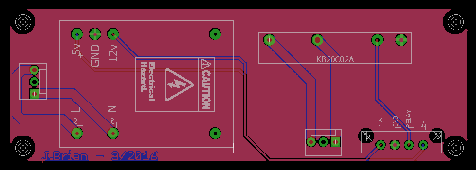

  • Power Box
    jlbrian703/08/2016 at 20:55 0 comments

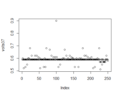

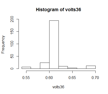

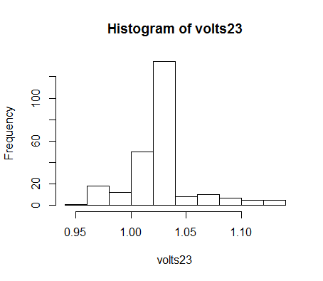

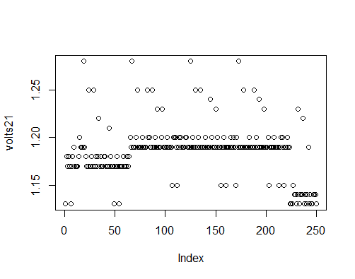

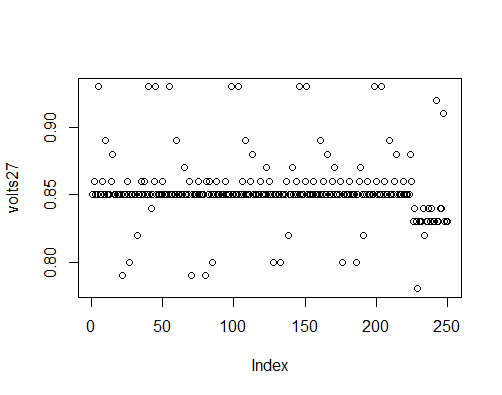

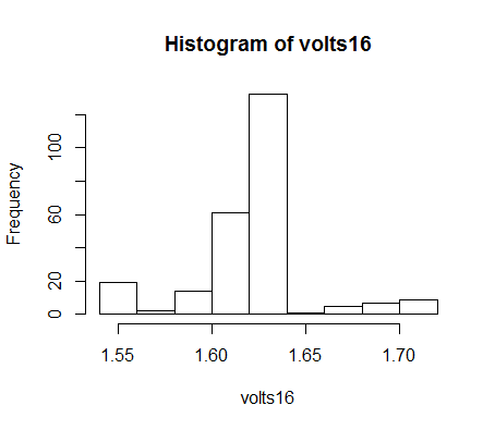

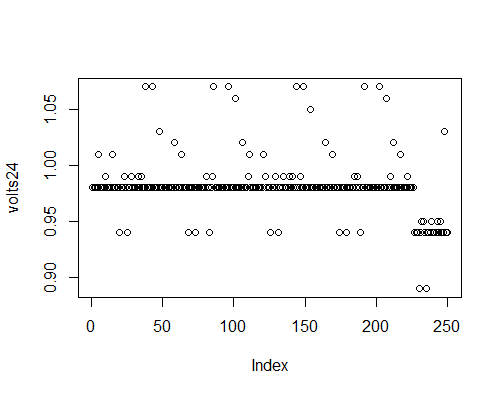

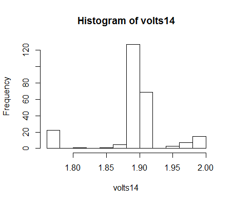

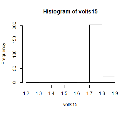

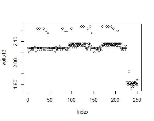

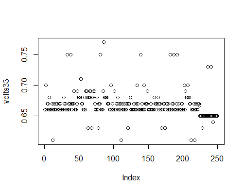

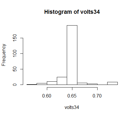

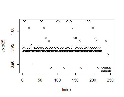

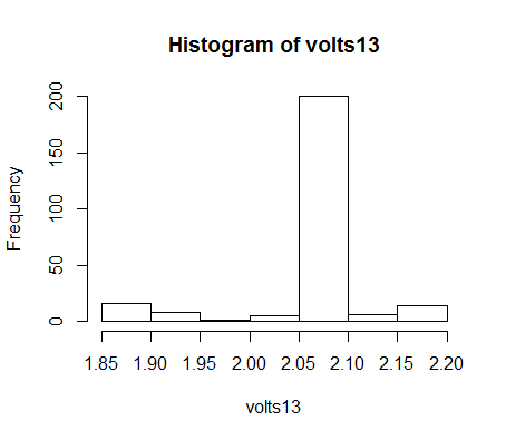

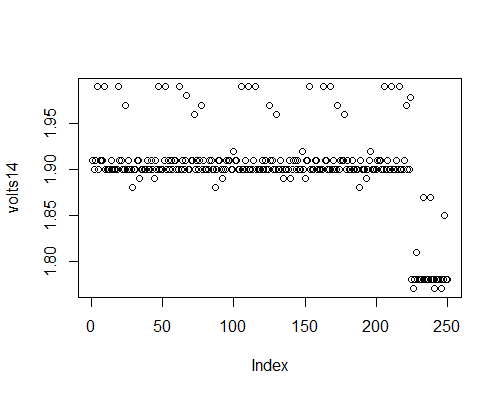

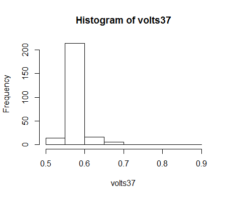

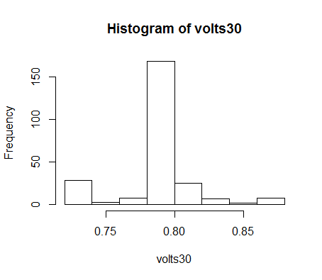

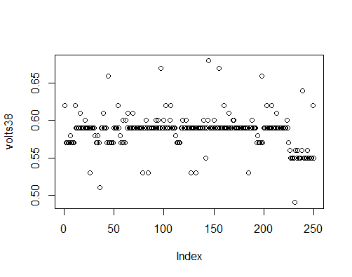

    Since it looked to me that the median value was the correct distance measurement, that is what I went with.
    I am using the code from this blog post http://forum.arduino.cc/index.php?topic=53081.msg1160999#msg1160999
    The code did not handle the float values for voltage measurement, so I used the raw analog input, resampled the data, and plugged the raw input into the fast mean code.
    Here is the data from the raw analog numbers:
    This is the data with some outliers:
    This is the data with the large outliers removed:

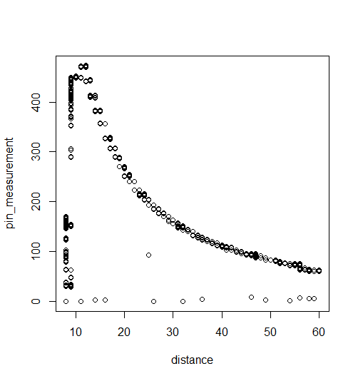

    and because I wasn't having much luck getting a good measurement with distances less than 10", this is the data from 10 to 60in:
    From this I was able to fit a polynomial regression line:
    Call:
    lm(formula = newPinData$distance ~ newPinData$pin_measurement +
        I(newPinData$pin_measurement^2) + I(newPinData$pin_measurement^3))
    Coefficients:
                        (Intercept)       newPinData$pin_measurement
                          8.992e+01                       -6.168e-01
    I(newPinData$pin_measurement^2)  I(newPinData$pin_measurement^3)
                          1.796e-03                       -1.805e-06

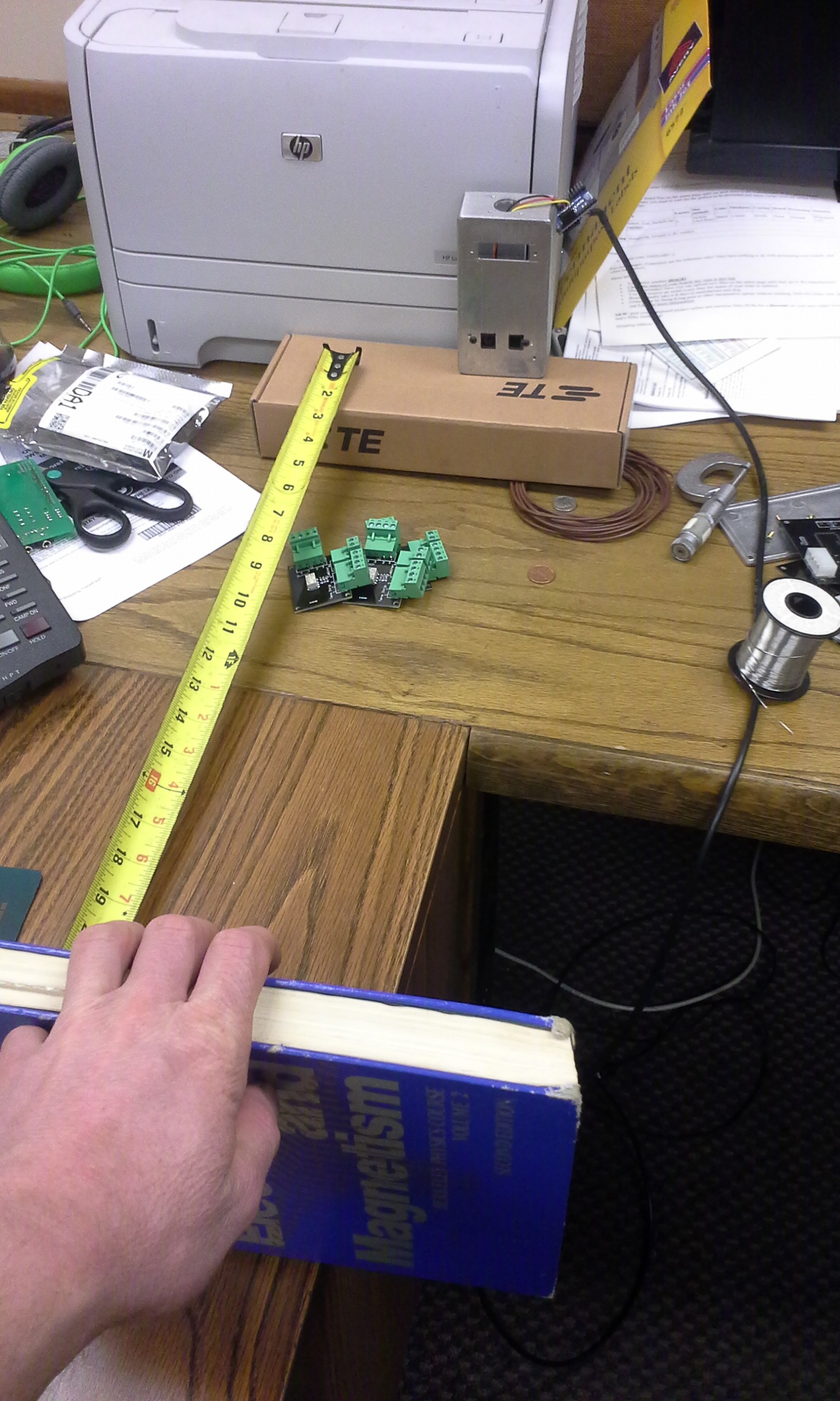

  • Test Setup
    jlbrian702/05/2016 at 13:01 0 comments

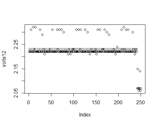

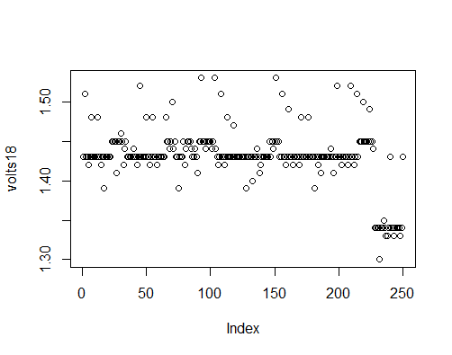

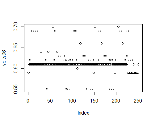

    This is the test setup:
    I believe that some of the reason for the variation in the data, other than the outliers, is from the book not being parallel to the sensor, or my wobbling it back and forth, but none the less it worked well enough.
    250 samples were taken at each inch.

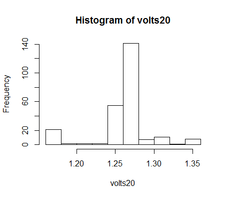

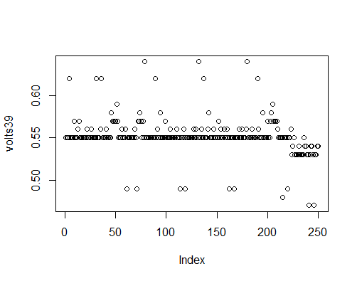

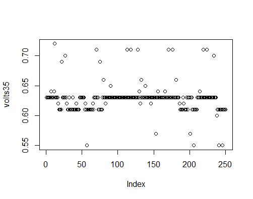

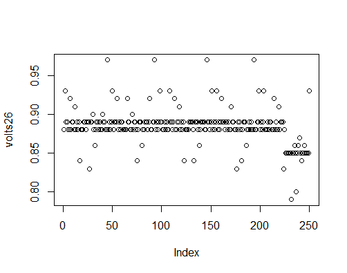

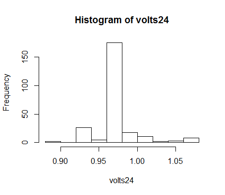

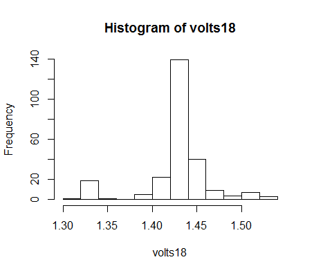

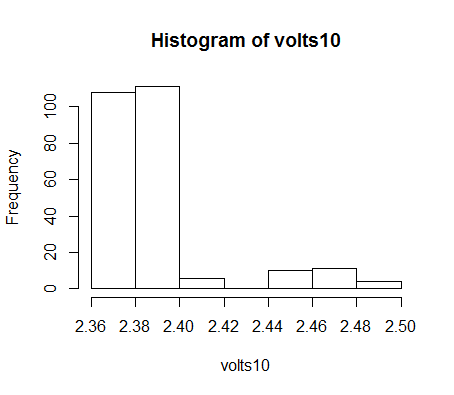

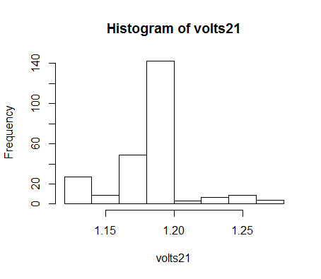

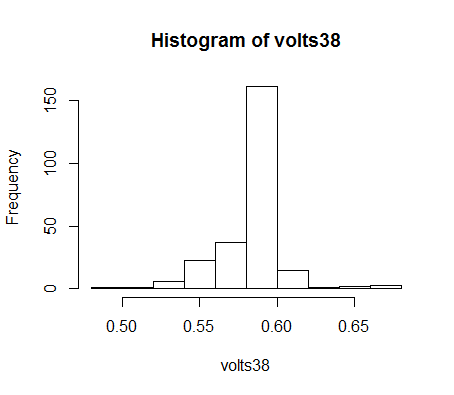

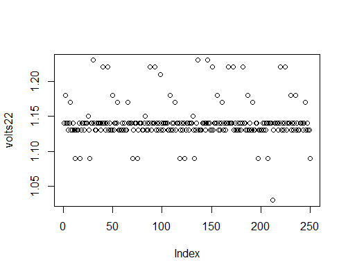

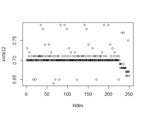

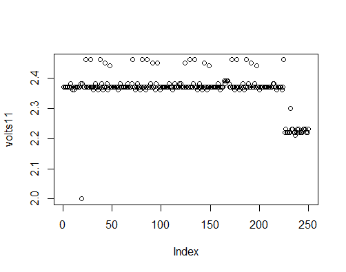

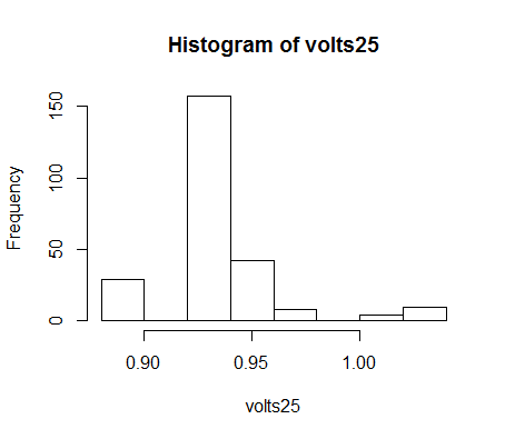

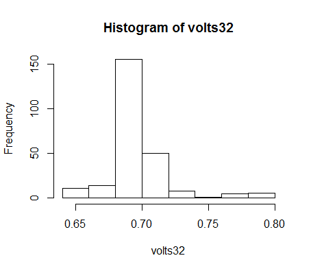

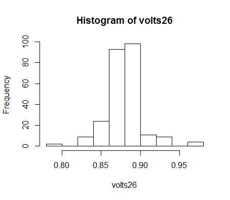

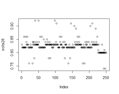

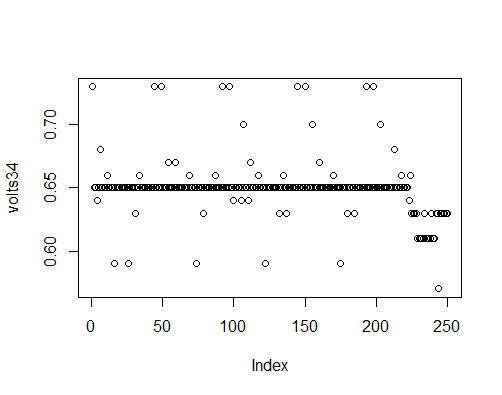

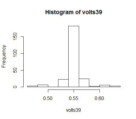

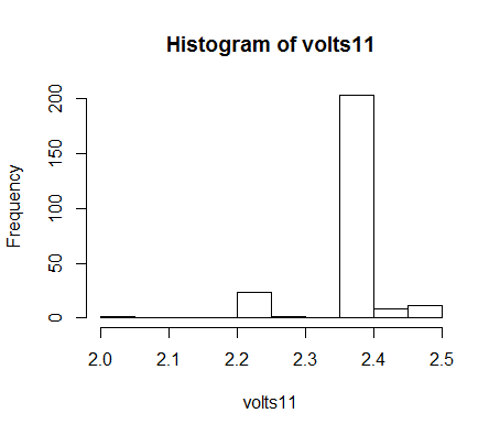

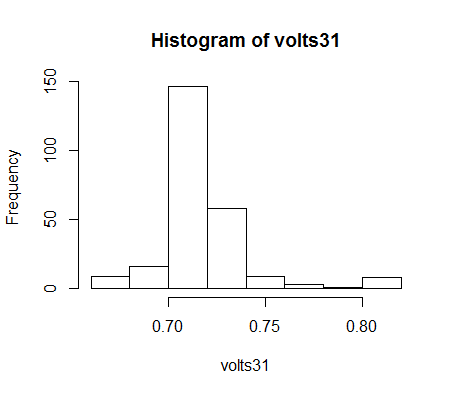

    Because there were problems with compressed air being able to cause mis-reads with the ultrasonic sensors I am trying out the
    Sharp GP2Y0A02YK0F.
    Because there is a wide variation in the output between sensors each sensor has to be calibrated. What I did to get the calibration curve:
    Just plugging the sensor in and looking at the raw values it was clear that it would spit out a constant value most of the time with a little noise in the system, so I captured the data between 10 and 39in. because this is the area that I plan on using the sensor in. I calculated the voltage values to check that it was with in spec., and I didn't have something hooked up wrong.
    Data:
