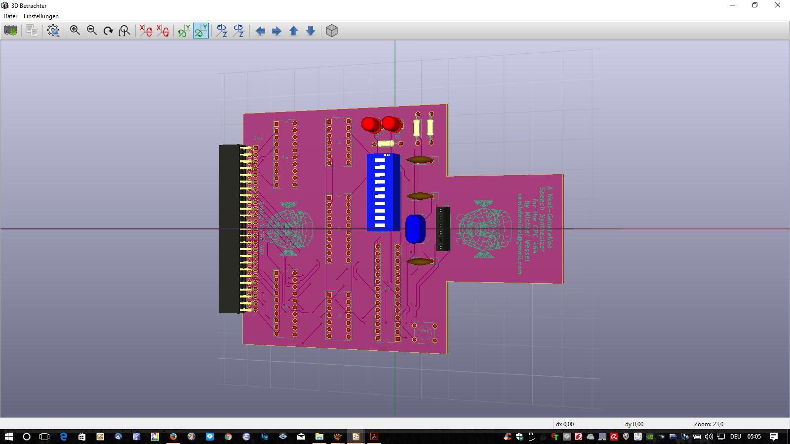

  • Step 4 - PCB Design with KiCad
    Michael Wessel05/24/2017 at 16:54 0 comments
    Well, what can I say - this wasn't easy for a newbie! I must say "Getting to Blinky 4.0" from Contextual Electronics helped tremendously - thank you guys so much for putting this together!!
    Getting to Blinky 4.0 from Contextual Electronics
    Being an absolute beginner with KiCad and PCB production, I wanted to summarize some of the errors I made in that process such that other newbies can benefit from it - I actually had to generate the Gerbers 5 times, because I was finding errors in the PCBs again and again - it was quite a humbling experience, but great fun also! Here are some tips / hints, solutions to obstacles that I faced, and errors I made, hope it is helpful to others:
    A. ESchema:
    • When you connect PINs to a bus, make sure that all your pins have labels, otherwise the bus doesn't know which line / track is going from where to where. The pin numbers and names on the chips / components are not sufficient for that.
    • Many components have invisible GND and VCC. during electrical check, KiCad always complained about non-connected VCC and GND pins, even though I had global VCC and GND labels on the corresponding CPC expansion port pins! I tried to put global labels manually to these hidden pins, but to no avail. The right solution is the following, which required quite a bit of web research: First, make sure that KiCad shows the invisible pins. Then, for a bus connector such as the CPC's expansion port, attach a global GND label to GND pins (there can be more than one such pin which gets that label - they will be connected then), and attach a global VCC label to the VCC pin. THis is still not enough, even though the hidden pins have global labels VCC and GND. Next, create and place a VCC and a GND label somehwere on the board, and find the "gnd" and "vcc" components from the component library. Connect them to the labels. This is still not enough to satisfy KiCad's electrical checker. Next, find the "powerflag" component from the library and attach one to each of VCC and GND just just placed on the board. Finally, KiCad thinks the 74x chips are powered and connected correctly
    • Global labels are extremely helpful if you don't want connection all over the board. Just attach the GND or VCC global label and you are done.
    • Don't forget the rule check!
    • It is ok for KiCad to complaint about non-connected components, but carefully check all the errors and make sure that you did not forget any important connections.
    • KiCad is frequently updated it seems. Sometimes, they forget to include certain components. Believe it or not, but my installation didn't have the SW_PUSH little momentary push button in the library! I had to install and download the latest version of the KiCad component library. Likewise, other components might be missing from the standard libraries - in my case, the AMega328p and the Lattice GAL G18V8's. However, with a little bit of Web search I was able to find libraries for these. For the CPC edge connector, I didn't find anything on the Web, but had to create my own symbol and footprint. I could adapt and Apple 2 connector for this.
    B. PCBNew and Gerber generation
    • Really make sure that that you set up the design rules (global and connection-specific!) correctly, before you start with the (auto) routing! Especially if you are using the metric system (mm), and have to convert OSHPark's inches-based design rules, make sure that you convert inches correctly into mm's... that should be straight forward, but in my case, I messed up by an order of magnitude, and the tracks where only one tenth in width of what they should have been.
    • When you import the Netlist, do the "Spread Out". This is only available if you Switch the View to "Standard View" in my version, not "Open GL". And also only as right mouse button context menu with Arrow Tools selected, and the Place Components mode is enabled. Took a while to find this option!! Without auto spread out, all components are messed up in a large pile stacked upon each other.
    • After spread out, place...
