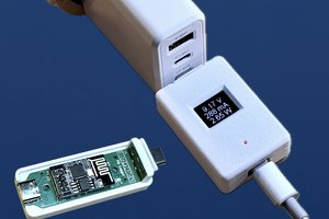

I'm really trying to go for broke here and design the meter to accept any USB configuration:
- Fully USB type-C connection compliant; it has full routing of all the data lines, and it is transparent - i.e. it just acts like a wire, not blocking or distorting any data transmission.
- One plug and one socket, so can be put in-line with any type-C connection
- Compatible with all power specs, including PD, up to 5A and 20V
- Accumulates up to 500Ah and up to 5000Wh of power on the display
- Can run for days without overflowing, i.e. great for long-charging batteries
- Did I mention it is bidirectional? It has little arrows saying which direction the current flows in.
- 5-digit readout with effective 18-bit precision (measured precision better than 1mV and less than 0.5mA!)
- 1% accuracy over the entire range

>5-digit readout
You realize that 1% accuracy gives you only 3 digits (or less) that are reliable.
i.e. for a count of 100, the last digit is within +/- 1 and it get worse from there.
So you have at most 2-3 digits of good values and the other 2 are not.
