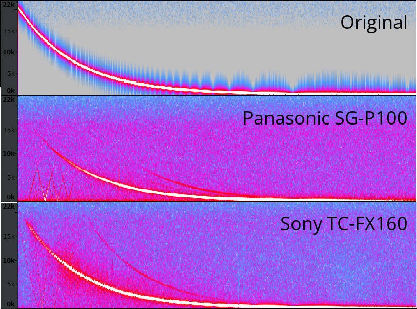

I decided to run the same test as I did on the Panasonic to approximate the frequency response of the Sony deck. The following is a screenshot of audacity showing the spectrograms of a 20kHz to 20Hz sweeps on the decks.
The Sony responds to higher frequencies than the Panasonic. The Sony also sounds better and has much less noise. I'll be using the Sony deck to record the tape tests and the final tape (unless I see something really good out in the wild).
