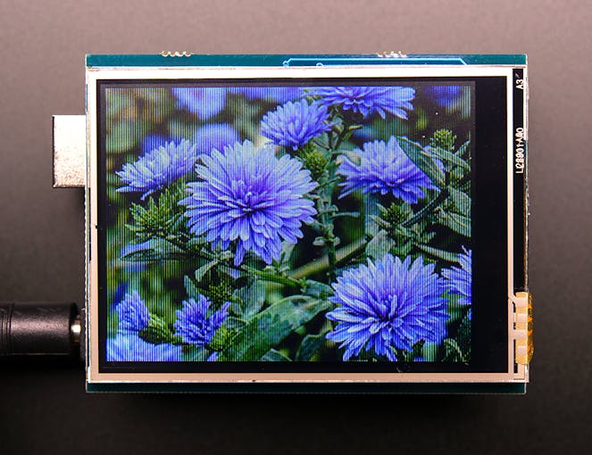

Display a pictures from a SD card
It requires a special format for the displaying picture: 16bit RGBRGB bmp.
You could download the convert tool here: ImageConverter
Why 16 bit, not 24 bit?
There are 2 reasons for converting your images to 16-bit bmp with flipped row order:
  • Size : The image is only 2/3 of the original size and because most embedded displays/drivers uses 16-bit color, the picture quality will be the same.
  • Speed : Most embedded TFT uses the 16-bit 565 format and support the top-bottom write order.
a) The MCU does not need to convert the 24-bit to 16-bit 565, this is already done.
b) If the source format is already in correct order, a faster algorithm for reading the data can be used.
c) There is less data to read (because the image is only 2/3 of an original size)
