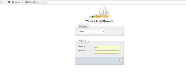

Here we are using PHPMYADMIN that is the web interface of MySQL so for that you have to install that also and the command for that is:
sudo apt-get install phpmyadmin
Your PHPMYADMIN page will look like this
