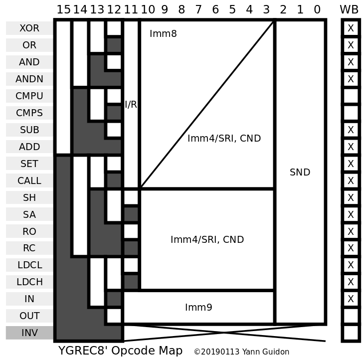

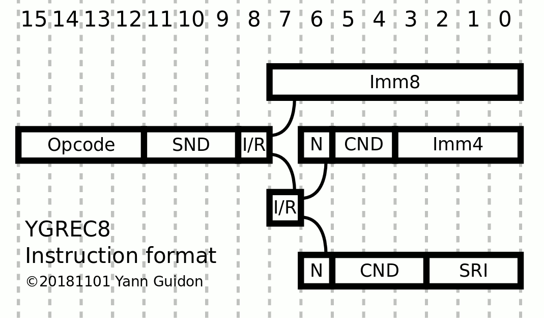

The instruction word is shrunk down to 16 bits. It is still reminiscent of the YGREC16 older brother but I had to make clear cuts... The YGREC8 is a 1R1W machine (like x86) instead of the RISCy YGREC16, to remove one field. Speed should be decent, with a pretty short critical datapath, and all the instructions execute in one clock cycle (except the LDCx instructions and computed writes to PC).
The fields have evolved with time (I have tried various locations and sizes). For example:
20171116: The latest evolution of the instruction format has added a 9-bits immediate field address for the I/O instructions.
20180112: Imm9 is now removed again...
20181024: changed the names of some fields
20181101: modified the conditions to change Imm3 into Imm4
20180112: Imm9 back again ! (for speed/latency reasons, no register operand is provided, an indirect IO register is used instead, and having more IO space is more desirable, otherwise only imm4 is available if a register operand is used)
There are 18 useful opcodes (as many as EDSAC plus INV, and the pseudo-opcodes HLT and NOP), and most share two instruction forms : either an IMM8 field, or a source & condition field. The source field can be a register or a short immediate field (4 bits only but essential for conditional short jumps or increments/decrements).
The main opcode field has 4 bits and the following values:
Logic group :
  • OR
  • XOR
  • AND
  • ANDN
Arithmetic group:
  • CMPU
  • CMPS
  • SUB
  • ADD
Deprecated:
Beware : There is no point to ADD 0, so ADD with short immediate (Imm4) will skip the value 0 and the range is now from -8 to -1 and +1 to +8. (see 17. Basic assembly programming idioms)
Shift group (optional)
  • SH/SA direction is sign of shift, I/R(bit9) is Logic/Arithmetic flag.
  • RO/RC direction is sign of shift, I/R(bit 9) allows carry to be rotated.
Control group:
The COND field has 3 bits (for Imm4) or 4 bits, more than YGREC16, so we can add more direct binary input signals. CALL is moved to the opcodes so one more code is available. All conditions can be negated so we have :
  • Always
  • C (Carry)
  • S (Sign, MSB)
  • Z (Zero, all bits cleared)
  • B0, B1, B2, B3 (for register-register form, we can select 4 bits to test from user-defined sources)
(notice the mnemotechnic trick: ACSZ are in alphabetical order)
Instruction code 0000h should map to NOP, and the NEVER condition, hence ALWAYS is coded as 1.
Instruction code FFFFh should map to INV, which traps or reboots the CPU (through the overlay mechanism): condition is implicitly ALWAYS because it's a IMM8 format.

  • More room for some opcodes
    Yann Guidon / YGDES10/02/2023 at 10:50 0 comments
    As I review and refresh the documentation, I realise that the pressure on the opcode map can be reduced a bit. There is a new prefix opcode (that interacts with the FSM)  but the extra/optional opcodes do not need the conditional/predication bits. This would move a whole block of opcodes to lower bits and free more room. The prefix would have its own opcode and INV will remain untouched. Some reorganisation is required as I refresh the doc...
    SH/SA/RO/RC are 4 optional opcodes that would now be located in the CND field, which is 3 bits wide. This leave 4 more opcodes, maybe for multiplication or whatever. But this frees 3 more main opcodes !
    Maybe LDCL and LDCH could have a 8-bit version though that would be pointless (a SET Imm8 Reg instruction would do the same).
    IN and OUT would have their own main opcode root code, not straddling across bit boundaries
    Update :
    Here are the new versions of the opcode map and instruction format:
    There is now ample room for more opcodes in the future, though they do not seem required now. There is also a separate prefix opcode, a totally independent INV opcode, and IN and OUT have the same opcode binary prefix (unlike previously).
    The PFX opcode uses only the CND and SND fields, more could be used later. It doesn't check the I/R and I/R2 fields... yet. They should be kept cleared so far. More prefixes could appear in the future, for example using the SRI field.
    I know : this will force me to rewire the mechanical assembler... The VHDL assembler will also need some revamp.
    The core diagram has been updated too, implementing the prefix opcode: the output of the condition selector can be routed to the carry input of the ALU on the next cycle, and the writeback address can be delayed so write occurs on the register designated by the prefix and not the current instruction.
