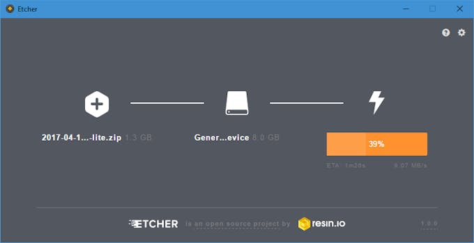

The very first step is downloading Raspbian. I’ve chosen the Lite version, as I’m going to use SSH instead of display.
Things have changed since the last time I did it: now there is a great burning software called Etcher, which works perfectly, and has a stunning design.
After the image burning was completed, I inserted the SD card into my Pi, plugged the LAN and power cables in, and after a while, my router registered the new device.

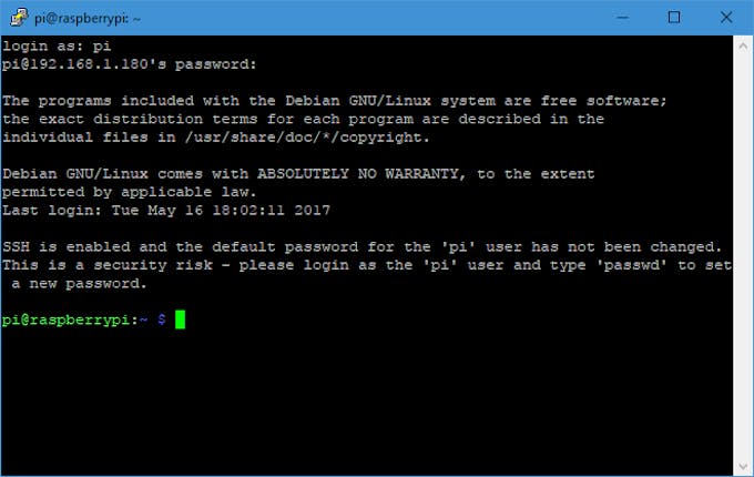

Great! Let’s go on and SSH into it.

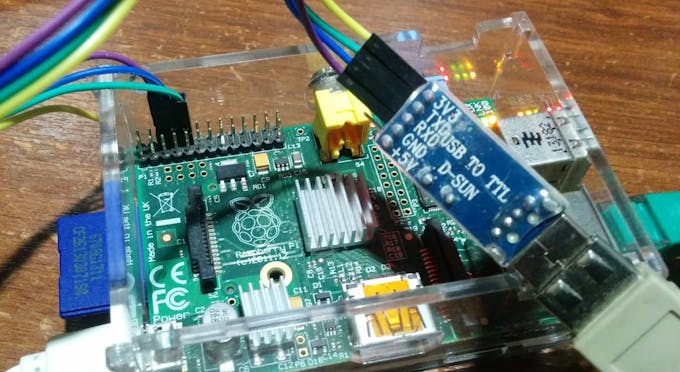

No way! SSH is disabled by default
Security is OK, I like it, but this makes things a bit harder. I’ll use UART-USB converter to access the shell and enable SSH.
Using a display instead of UART makes it much easier.
After rebooting, I’m finally in.

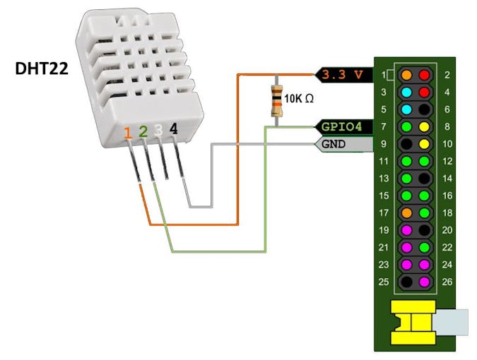

The DHT22 sensor measures temperature and humidity simultaneously. The communication protocol is not standardized, so we don’t need to enable it in raspi-config  — a simple GPIO pin is more than enough.
To acquire the data, I’ll use Adafruit’s great library for DHT sensors, but it may not work as is. I once found a strange constant delay in the code, which did not work for my hardware, and after two years my pull request is still pending. I have also changed the board detection constants because my Raspberry Pi 1 with BCM2835 was surprisingly detected as Raspberry Pi 3. I wish it were true… Thus, I recommend using my fork. If you experience any problems with it, please try the original repository, maybe it works for somebody, but I’m not one of them.
git clone https://github.com/Himura2la/Adafruit_Python_DHT.git
cd Adafruit_Python_DHT
 As the library is written in C, it requires compilation, so you need the build-essential and python-dev packages.
sudo apt install build-essential python-dev -y
sudo python setup.py install
While the packages are installing, connect the DHT22 as shown in the picture below.

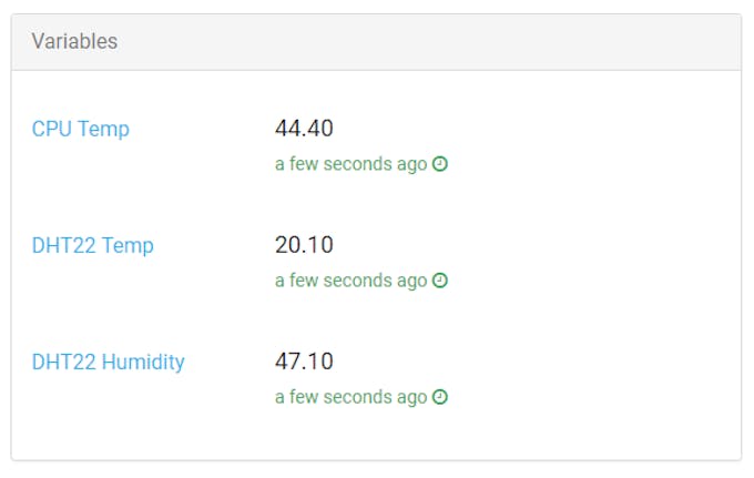

Push the red button to start the data transfer:
python cloud_dht22.py
Then you can check the device page.

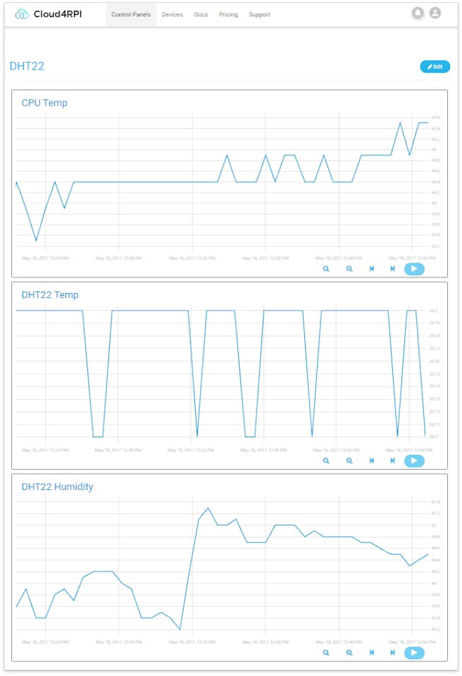

Charts and Alarms
First of all, let’s plot the variables to see how do they change. This can be done by adding a new Control Panel and putting the required charts in it.

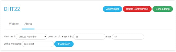

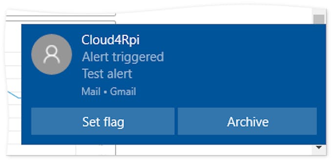

Another thing that we can do here is setting an Alert. This feature enables you to configure the safe range for a variable. As soon as the range is overstepped, it sends an email notification. On the Control Panel editing page, you can switch to Alerts and set one up.
Right after that, the humidity in my room started to decrease rapidly without any noticeable reason, and the alarm soon followed.
