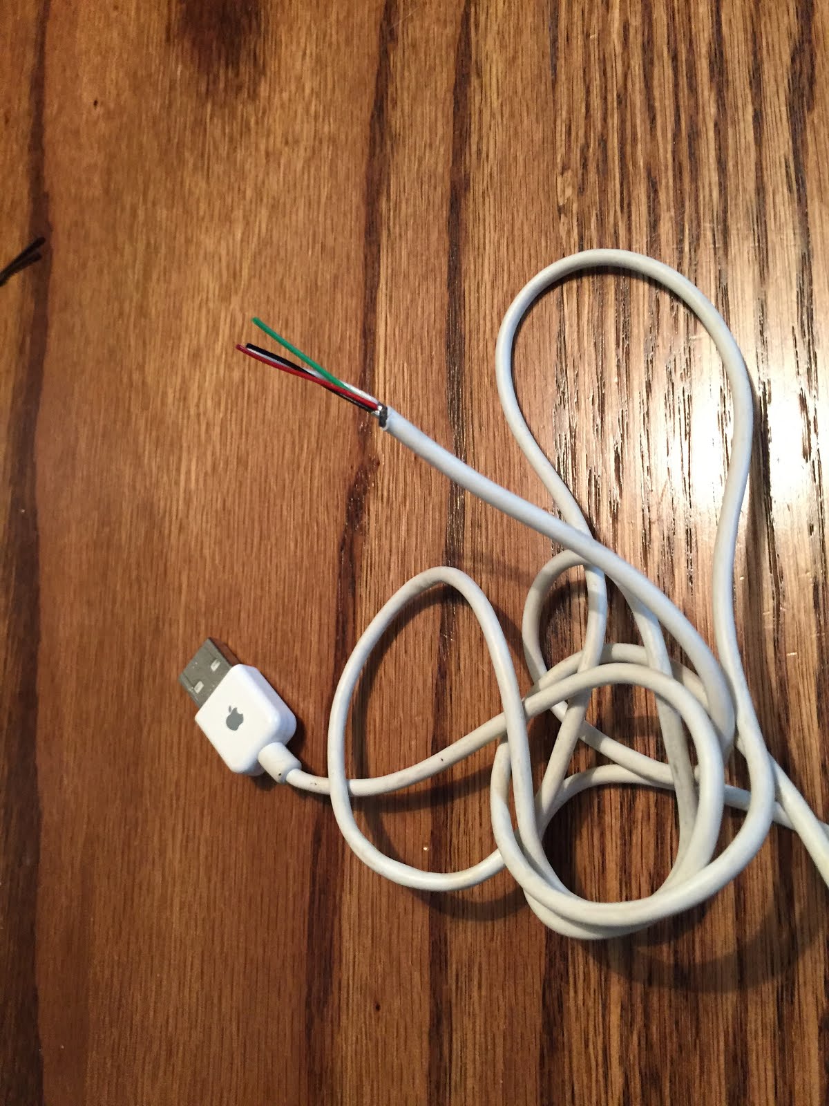

The first thing I did was make my 5V power supply from a usb cable. Using an old iphone cable, I cut the iphone side off and fished out a red and black wire. I soldered some sturdier wires to this, and plugged it into a wall adapter. Checking with a voltmeter, this gave me 5V output.

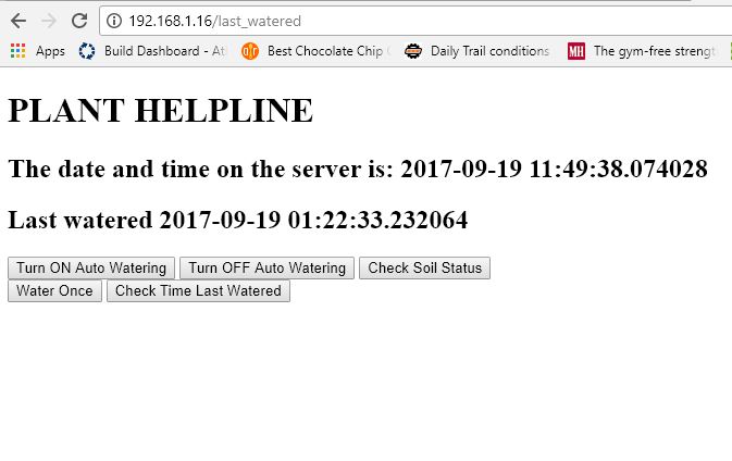

Flask Webserver
The next aspect of this project is to setup the web server. This code can be found here in a file called web_plants.py. This python script runs a web server enabling various actions from the script described above.
You will need to keep web_plants.py in the same directory as water.py described above. You will also need a subdirectory called "templates" containing the html file here called main.html.
You will need to install flask, and psutil as follows:
$> python3.4 -m pip install flask
$> python3.4 -m pip install psutil
Make sure to place the web_plants.py file in the same directory as the water.py script above. You will also need to create a sub-directory called templates, and place main.html in the templates directory.
Now run the following command command to start your web server:
$> sudo python3.4 web_plants.py
Now if you navigate to the ip address of your RPi, you should see a web dashboard something like this:
Try clicking the buttons to make sure everything works as expected! If so, you're off to the races.
