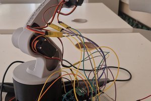

It works. Well, it works inasmuch as the locomotive stays on the track. The crash in the video may be caused the servo being out of trim, or it could be caused by the poor track fit. The video quality is horrendous.
To do:
  • Add servo trim from the remote and save to the uBit's "file system" (flash)
  • I guess I could change the radio settings so it doesn't use the default frequency and group
Build:
  1. Connect the servo to ground and 3v pads, and the data pin to pad 0
  2. Connect the reed switch to the 3v pad and pad 1
  3. Flash the Micro:Bit(s). The main controller works the same whether or not another Micro:Bit is being used. It uses a little more power since it's using the radio, though.
  4. Everything else is MacGyvering. I used a paper clip for the servo rod and cardboard and hot glue for the structure.
