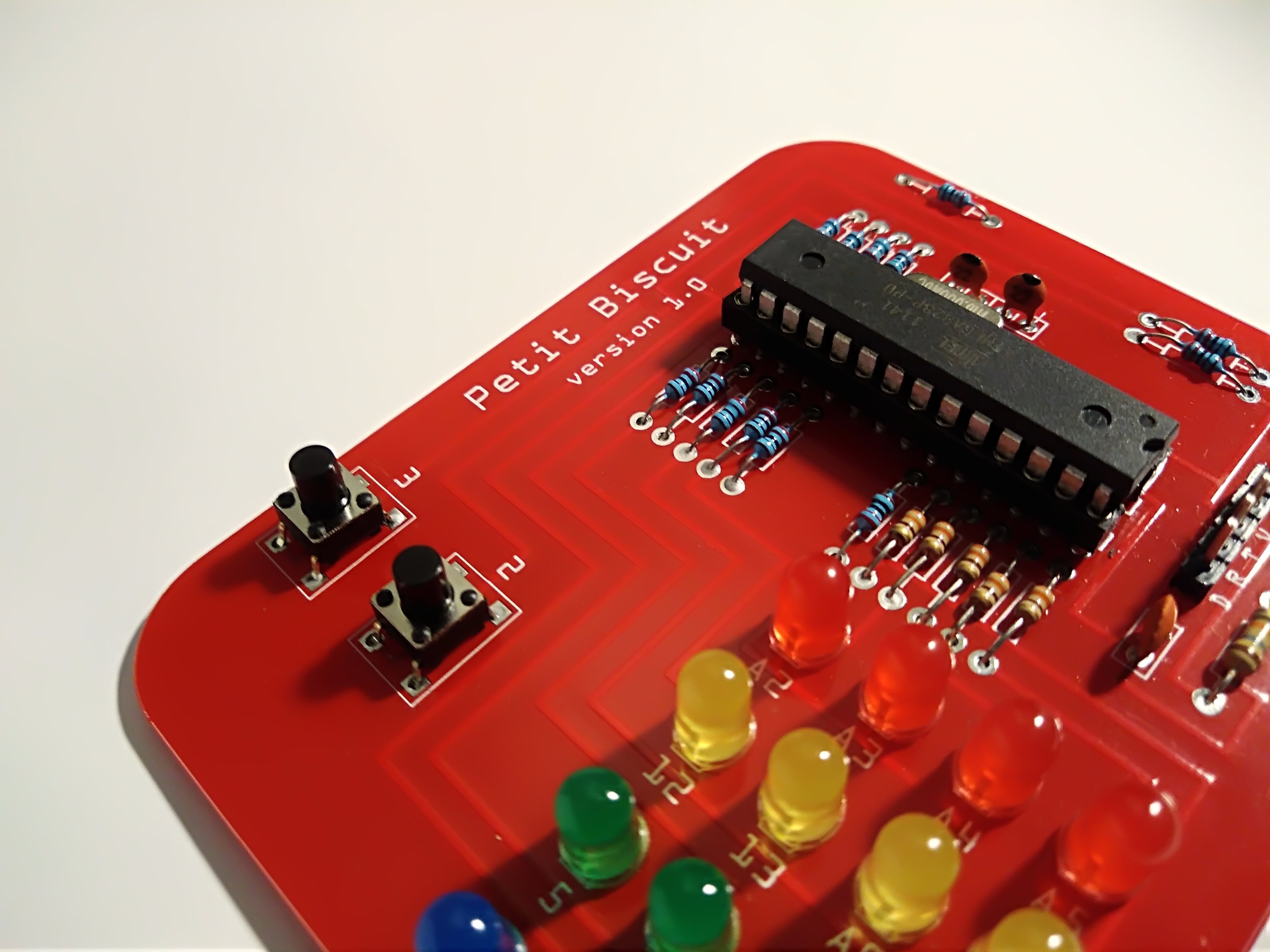

Demo Petit Biscuit
Petit Biscuit is a little Arduino programming board for introduce anyone who want to learn about the basic of an embedded system. It's the best friend for to learn Arduino programming.
Arduino mapping with Petit Biscuit
[ Petit Biscuit ]              [ Arduino ]
  • Button 1         =>       digital pin 3
  • Button 2        =>       digital pin 2
  • Led 1              =>       analog pin A5
  • Led 2             =>       analog pin A4
  • Led 3             =>       analog pin A3
  • Led 4             =>       analog pin A2
  • Led 5             =>       analog pin A1
  • Led 6             =>       analog pin A0
  • Led 7             =>       digital pin 13
  • Led 8             =>       digital pin 12
  • Led 9             =>       digital pin 11
  • Led 10            =>       digital pin 10
  • Led 11             =>       digital pin 9
  • Led 12            =>       digital pin 5
  • Led 13            =>       digital pin 6
  • Led 14            =>       digital pin 7
  • Led 15            =>       digital pin 8
  • Led 16            =>       digital pin 4
Module USB-TTL CP2102 connexion :
[ Petit Biscuit ]              [ USB-TTL ]
  • D               <=>              DTR
  • R                <=>              Rx
  • T                <=>              Tx
  • V                <=>              Vcc
  • G                <=>              GND
