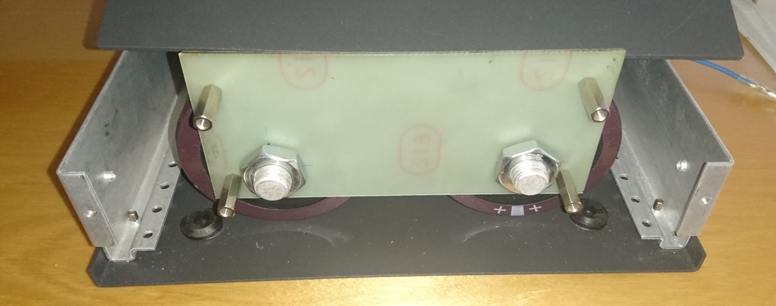

"Create the console for the caps"
This was funny. I don't know why I completely forgot that the outside (and therefore of the mounting screw also) of those large cans are the negative pole of the capacitor. building two caps with different potential on the same conductive (aluminum) mount is not a best idea of the world:
Luckily I realized this before switching on, and exchanged the mounting plate to a plastic one (unused etched FR4):
