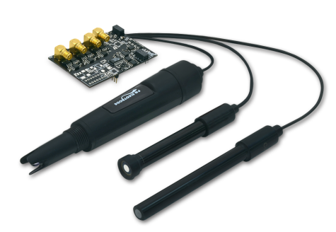

Another solution is to use probes. Probes get immersed in the water, and either return an tension or a value depending on the measured parameter. For automation purposes, it is perfect, since it is what we are used to do with temperature, humidity, etc sensors. However, the downside is that those sensors are expensive (often 100$+ for each sensor) and require a measurement board with amplification to have reliable measurements (often 150$+).
Here is an example of this kind of sensors : http://www.libelium.com/smart-water-sensors-monitor-water-quality-leakages-wastes-in-rivers-lakes-sea/
Atlas scientific also makes sensors that can be used that way : pH kit at sparkfun, dissolved oxygen at sparkfun.
From what i found on the web, it is possible to make a cheap pH sensor (10-30$). However for the other parameters it seems hard to find cheap solution. I once found a project where a guy was measuring water diffraction to determinate some parameters. It would be a perfect solution, but i didn't find a functional prototype. I think that the author of the project had to callibrate his sensor.
Another problem is that sensors have to be calibrated with a solution, i can't find good informations on how often it has to be done. It is not sure either that those sensors are meant to be immersed continuously in the solution. If not, it means that the system must be calibrated each time, then washed...
All in all, sensors are expensive. Unless i find a new solution, classic sensors are too expensive, except for a few. This part thus a low priority in this project, since other less expensive stuff have to be done before. I am still investigating however. Furthermore, if we consider those parameters, dissolved oxygen doesn't really need to be measured (even if it would be cool to know exact values), as we can ensure that we have high levels. For carbon in water, a precise dosing of the product should ensure correct values. On nitrites, phosphates, ammonia and ammonium, we should not need to measure it. Proper maintenance of the aquarium helps ensuring that everything is good. On nitrates, regular water changes keeps the levels at bay. However i'd like to be able to measure it to find way to extract nitrates from water (with alguea for instance). pH won't change if gH or kH are high enough. If they are low, pH can change easily. At last kH and gH are very low in my case, i have to re-mineralize the tap water. So i will be mixing a solution to obtain a specific value from 0. Unless big changes occur in tap water quality, i should be able to have a recipie for my water (x mg of gh/kh powder per litter). I will probably use drops tests to check the solution when i pepare it. In the absence of anything else, it won't change until i put it in the tank. If i prepare 20-30l of water, i can use it for a few weeks.

resolves the issues with cleaning and pumping. Never finished due to lack of interest. The problem with electrical sensors ("probes") other than the cost is that they are all working from a chemical reaction on the sensor head, and so MUST drift over time and fail. The re-calibration at end of life allows a linear fit correction to regularize the data collected, but this does not work in a process control environment as the drift will have already resulted in bad readings and subsequent poisoning of the tank. The only option for using probes is to regularly clean and re-calibrate them in known pH solutions. e.g. once a week. At that point, you might as well just do the manual reagent test... or build a reagent robot. ,o)
