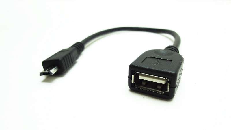

Once you've confirmed that your phone supports OTG, you'll need a USB OTG cable. These are about $2 from Amazon, and you could probably find them locally if you're in a rush. The small/male/micro-B end of the cable goes in your phone, and whatever you're trying to connect goes in the big/female/USB-A end of the cable.
You'll also need a USB terminal app for your phone or tablet. We've had the best luck with USB Serial Monitor Lite, and it gets bonus points for requiring no special permissions to run.
Connect your Mod to its USB cable, plug that into the OTG cable, and plug the small/micro-B end of OTG cable in to your phone. Turn the Mod on, and connect to it in the Serial Monitor app.
