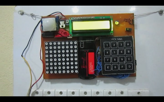

Module-1 (Master):
It consists of 2 ATMEGA16A controller with Dot Matrix display, 4*4 keypad (Calculator), PIR sensor (for security), temperature sensor (IN CASE OF ABNORMAL TEMP) &LCD display. Interfaced with mobile consisting of camera for capturing the Images of House breakers (thieves) & callback to house owner .It is used as calculator, We can control home appliances and door with Laptop or Desktop by Interfacing with Master module. Master module got PIR sensor in it which helps to monitor the home in the absence of owners. In the case of emergency(Fire accidents, homebreak) master module will call the owner and starts taking snapshots continuously with the the help of mobile connected in it.

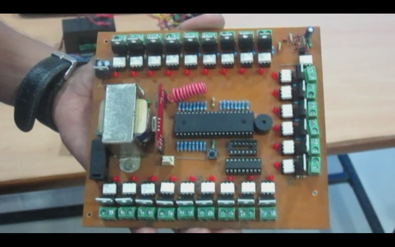

Module-3 (Switch Board RF Rx) :
It consists of ATMEGA16A controller with 24 pair of terminals (OPTOCOUPLER's & TRAIC's), buzzer (for water level indicator). It can control up to 12 AMPERES RMS 600 thru 800 VOLTS. This module can be controlled using PC(with labview), Smart mobiles, Remote module.Module should be installed back of the commonly used Switch boards. Switch Board Module has 24 pair of terminals to which 24 different home appliances are connected and voltage can also varied using remote. It also includes Water level Indicator i.e Buzzer. and
FUSE which prevents home appliances from high currents.

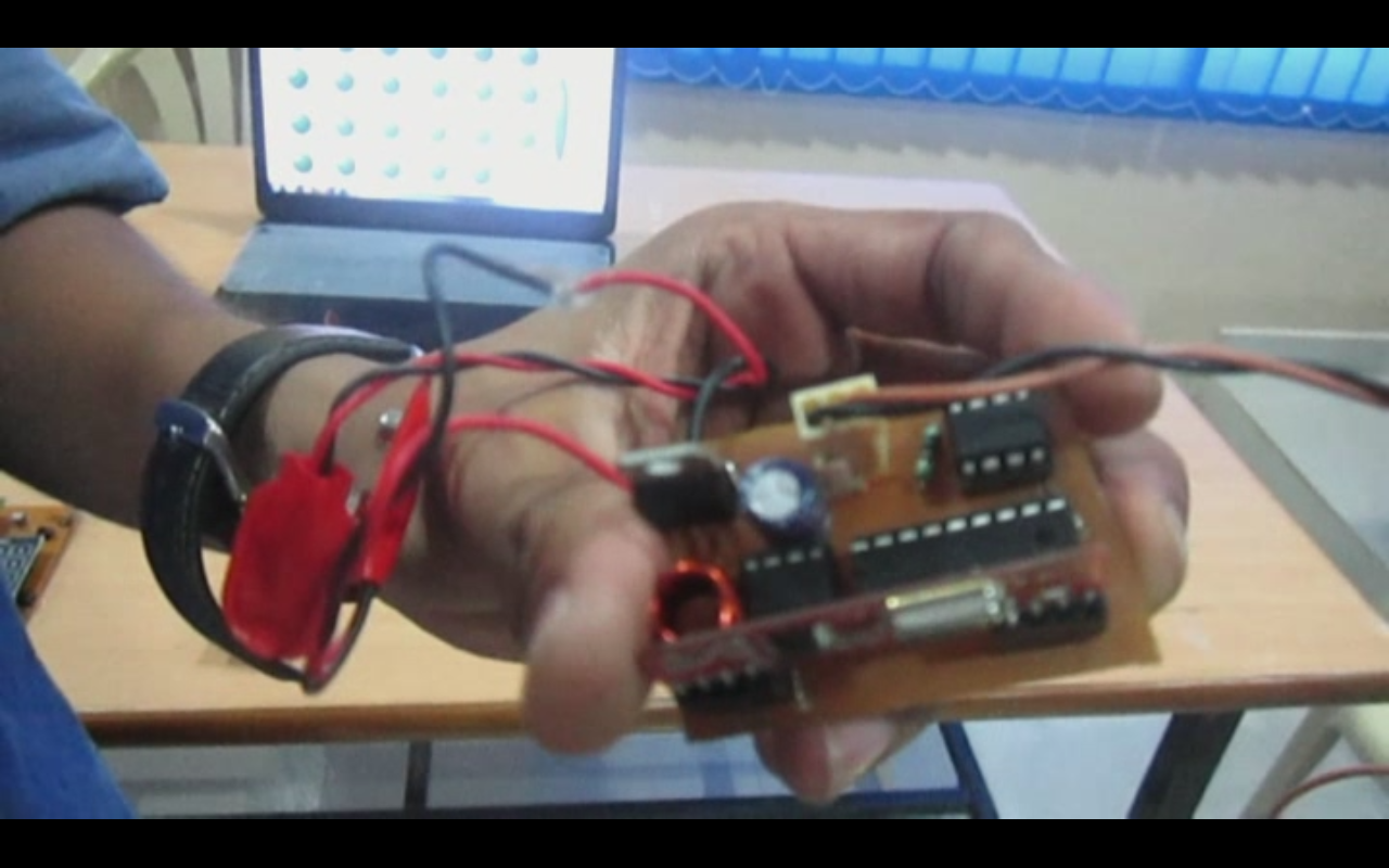

Moodule-4 (Door RF Rx) :
It consists of ATMEGA8A controller, motor driver (to lock & unlock the door), buzzer (to indicate whether the door is in engage ) & LEDS (RED-LOCK, GREEN-UNLOCK). By installing this module to our door,one can access the door by using PC, Smart Phone, Manually by sitting at any corner of the world. These doors are only accessed(locked and unlocked) by authorized persons and authorized phones.
