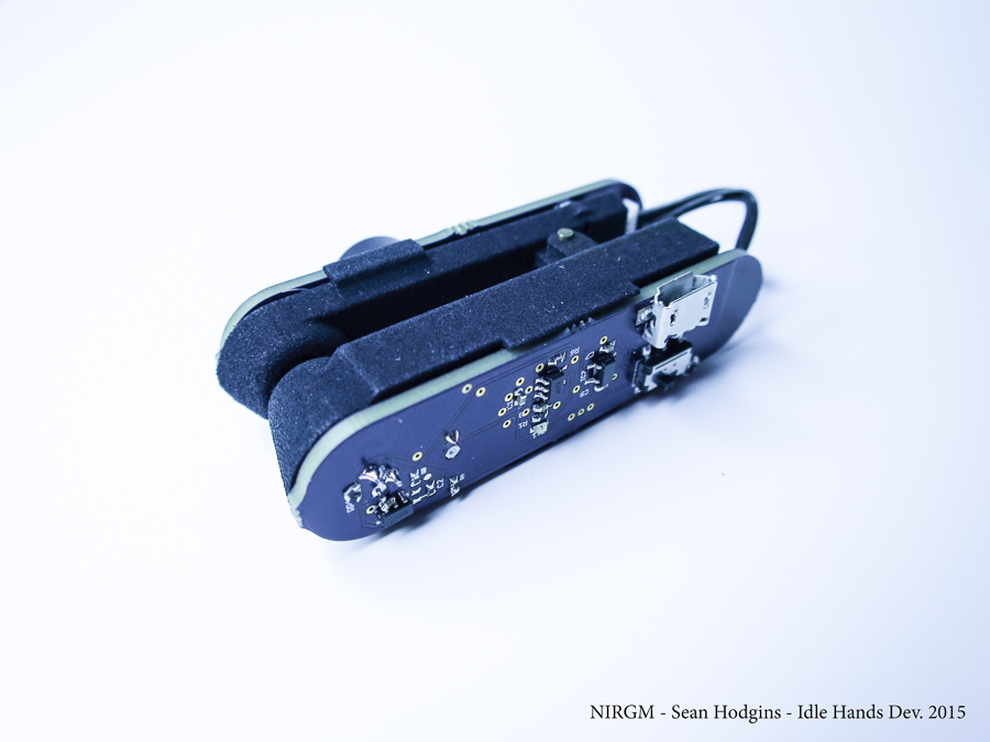

Sean Hodgins wrote 04/15/2015 at 19:48 point
Hey cool, I was actually working on a similar project, but have not advanced very far. I do however have a built working(in a sense, no determining glucose levels yet) prototype. Runs on a Atmega328p.
There is one factor I didn't see you mention. The amount of skin will vary the attenuation of the light skewing the volume of blood present between the sensor the and LEDs. More skin less blood, vice versa. You need to know the volume to get the mmol/l.
I found some research papers(Ill try to dig them up) on using a green LED to determine how much skin is in the way.
My sensor has 8 LEDs, 2xGreen(571nm), 1xRed(631nm), 1xIR(940nm), and 2xNIR(1550nm).
I was having a lot of difficulties getting stable results and I really think its clever software that is needed for something like this. Learning algorithms specifically. I may be moving away from this idea and onto a different technique altogether though. I didn't want to hijack your project, anyone working on this stuff is good news to me(Type 1 D here). Wanted to give some input and show a similar design.
marcelclaro wrote 04/16/2015 at 00:01 point
Cool!! Maybe we can share some data and experiences if you wanna!
I mentioned briefly about the volume of blood and water, which I think is more important than tissue absorption. I plan to measure this by 850 and 940nm wavelength, like an oximeter does. I read about another project using red and green led also, but I'm not sure if this wavelenghts really matter. But, it's only a guess. As you say, only a statistical or a machine learning algorithm could solve this.
Maybe the instabilities of your results cames from signal/to noise ratio, which in this case is really low as the papers says, what type of ADC you use?
Formally, I work with Long Wavelength Infrared (LWIR), wherein the background and signal are comparable or worse and if you not use a lock-in or another trick you will see nothing. Because of that, I will try very long integration time first and lock-in techniques after.
